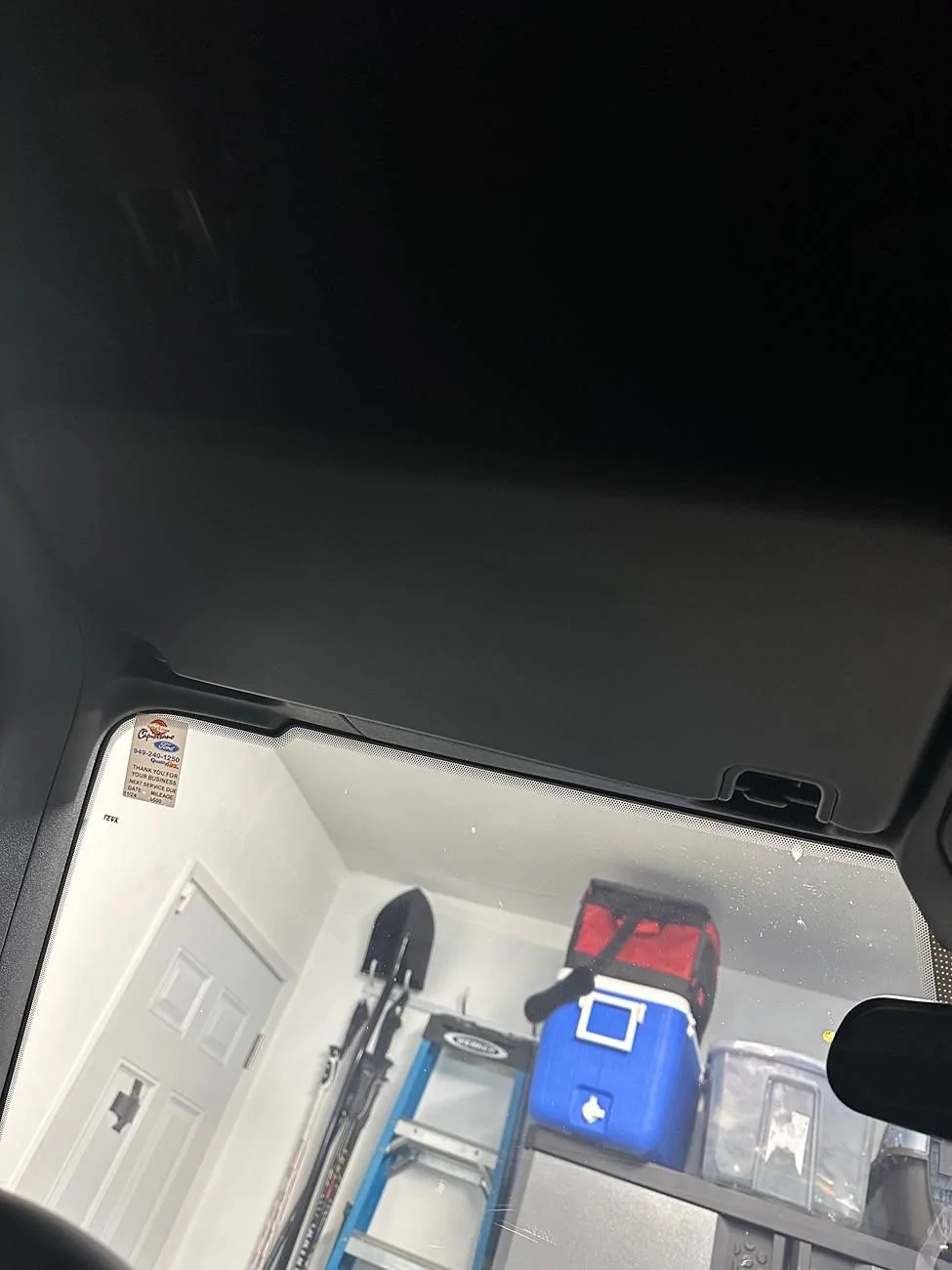

I removed mine after a little bit of patience and less than 30 min. I'll try to upload a pic later. All it took was alcohol or nail polish remover and cotton balls/paper towels and you can barely tell it was there. Took a day or 2 for the smell to dissipate
I think you are the exception. I tried heat, IPA, denatured alcohol, acetone, and a host of other crap and couldn’t get the glue to do anything. Industrial strength goof off finally did dissolve the glue temporarily but it also chemically burned (warped and discolored) the vinyl on the visor
