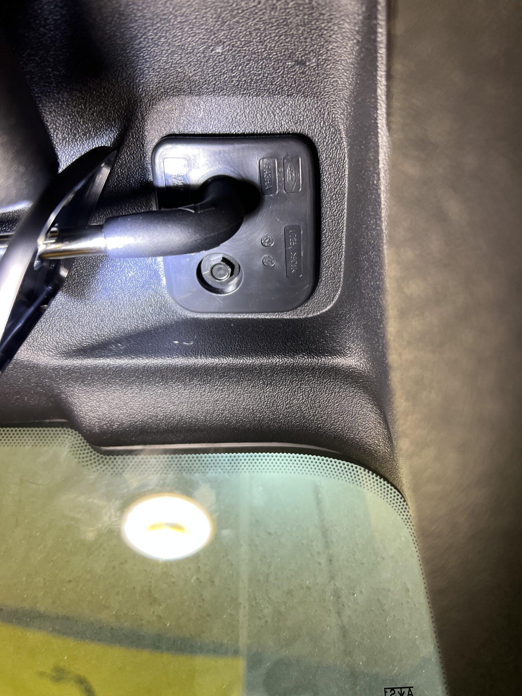

Does anyone have a how to video showing how to remove the sun visor to gain access to the A Pilar aux wire? (other than the one bronco nation posted)
Or can someone explain how to?
Looks like it should just slide out but I’ve tried multiple times and don’t want to brake the thing

at the pivot point is a cover,just pop that off and there should be a screw under it,remove screw and unplug wiring connector.

I don’t see any cap or screws
Looks like the visor is holding up the plastic casing that needs to be loosened in order go gain access to the wire

Here you go;)

You remove the screw and then turn the visor. It has to be at a certain angle in order to slide out. Forgive me for forgetting how much or to what degree I had to turn the visor. Hope that helps.

Yes...i finally figured it out. I got the bracket out, had a heck of a time getting it back in. Never did find a wire, but i didnt take down any other panels. I gave up trying to install my roof light bar; just seemed too complicated.
Had a hella time reinstalling visor brkt...you are right- it has to be turned just right!

hey cat yea after you take the visor down you have you then pull the TRIM panel down
the wire is behind there.
Little scary pulling on the panel but it pops loose

on the medial side (where the visor clips in), I can't figure out what size hex to use to remove that clip, I know you use a flat head to open the little opening that reveals the door, but I can only see the little hex opening. It's deep so I can't easily see what I'm doing. I've tried sticking every hex wrench I have up there (and I have a lot) and I can't get any to fit). My up-close eyes aren't great. is it really a hex? anyone help? just trying to hide that last little bit of wire from my rear dash cam.
