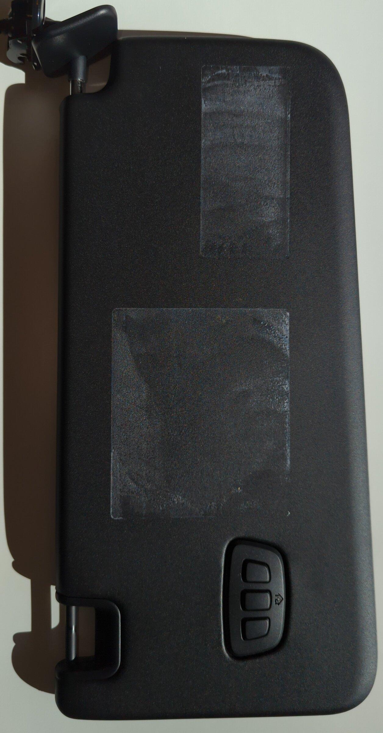

Thanks for posting this, I used what you wrote and modified a bit and joined to share what I tried. I don't have a heat gun. So I used a heat pad like one might use for knee pain. I heated it in the microwave and placed it on top of the stickers. Came back a few minutes later and used my fingernails to pull off the stickers. Here is a picture after I peeled off the stickers.
Ford Bronco Anyone successfully removed stickers from sun visor after_sticker.JPG
Once that was done, I didn't want to discolor the visor so I started testing ways to dissolve the residue with what I thought was the weakest to strongest.

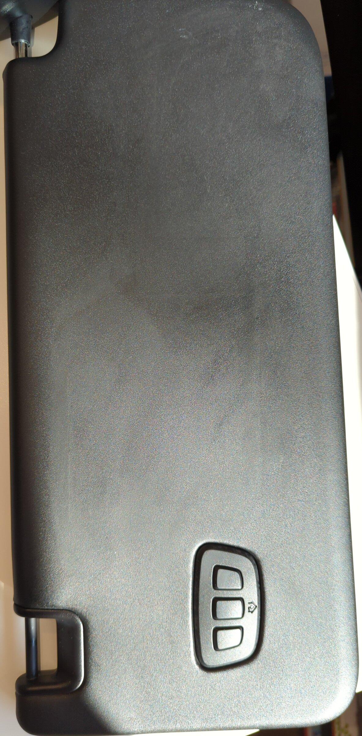

Nail Polish Remover (acetone)Works fast!
I didn't want to try the acetone. Not that I understand exactly why, but everyone else seems fearful. So I used it as quickly as possible, under 15 seconds and then wiped the area clean with a damp cloth. Here is how it looks after that process.
Ford Bronco Anyone successfully removed stickers from sun visor after_clean.JPG
I'm happy with the result. Looking at the picture now, it seems like there is discoloration, but it is just the way I took the picture in the light. If you look really closely, you can see that some of the pattern actually rubbed off. At least, I think it did. Either that or the residue sunk into the pattern. It's quite subtle and, I think, impossible to avoid.
If anyone tries this, some tips I might add are to ensure the stickers are warm when peeling. Once they cool down some, they require more force to pull and may stretch the visor plastic. Once I pulled the sticker off, I place the heat pad back down to let the visor rest back into place. Not sure if that's necessary, but just what I did and there is no deformation.
