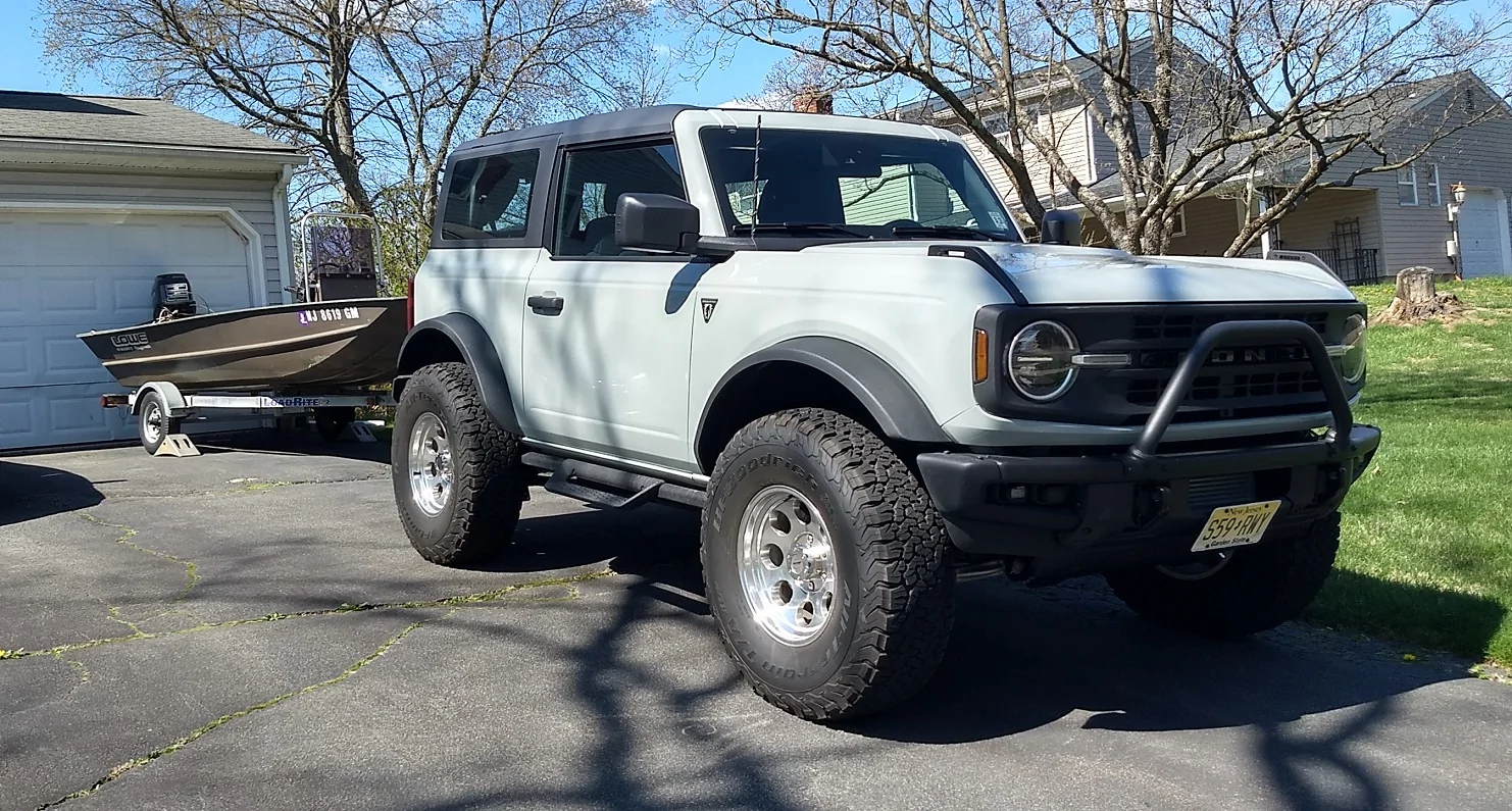

You may want to look at some adjustble coilovers so you can dial in the height the way you want it. I went with the ProComp adj coilovers when there were some good sales going on. I did not end up needing UCA's to get aligned but I'm sure it would have helped. The stock Sas wheels will most likely rub on the inside with 37's, you would need wheel spacers to push them out some. You are better off getting aftermarket wheels that usually weigh 7-10 lbs less than the stock Sas wheels and help offset the heavier weight of taller tires.
Here's my base Sas with ProComp coilovers with about 2" over Sas up front and about 1" in the rear. You will want a rear trackbar relocation bracket as well.
