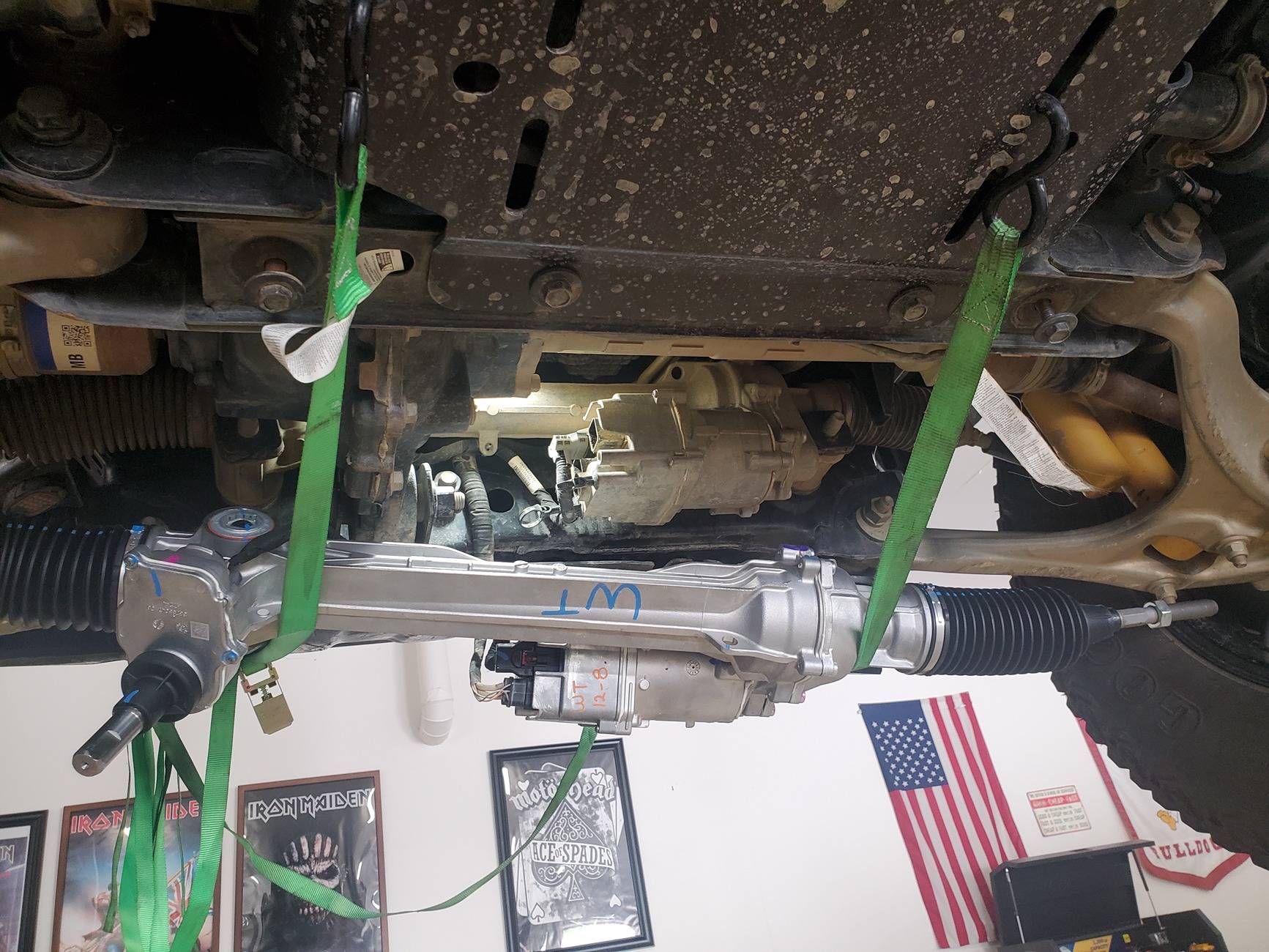

It's installed, the rack is in...tires need put on and test ride then alignment...I'm beat headed to bed...

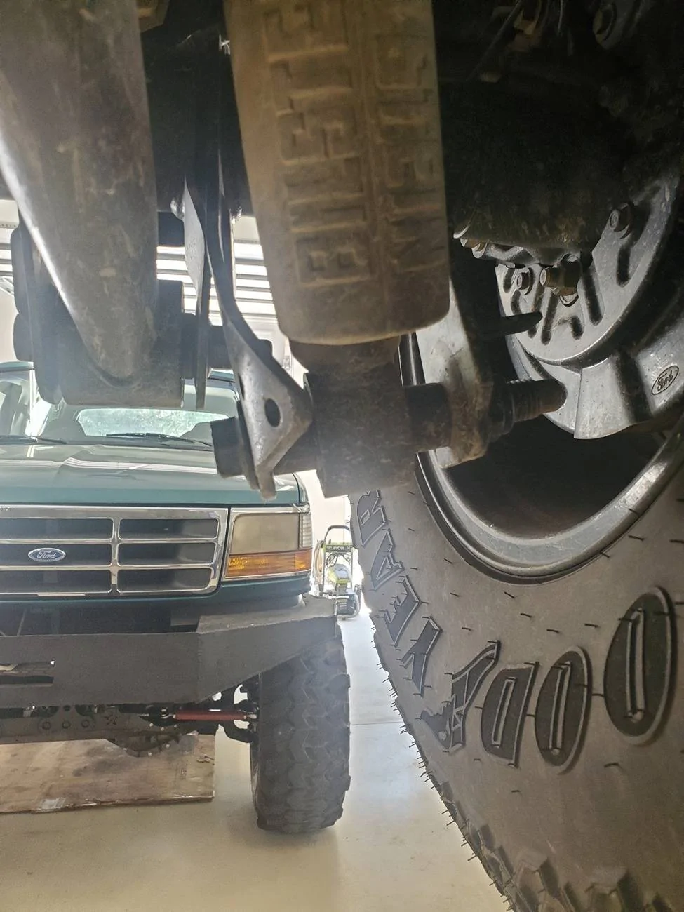

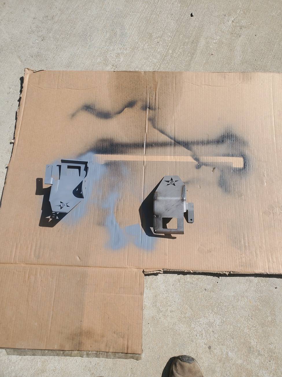

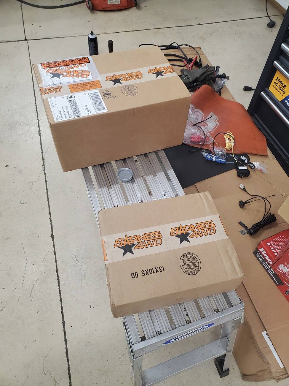

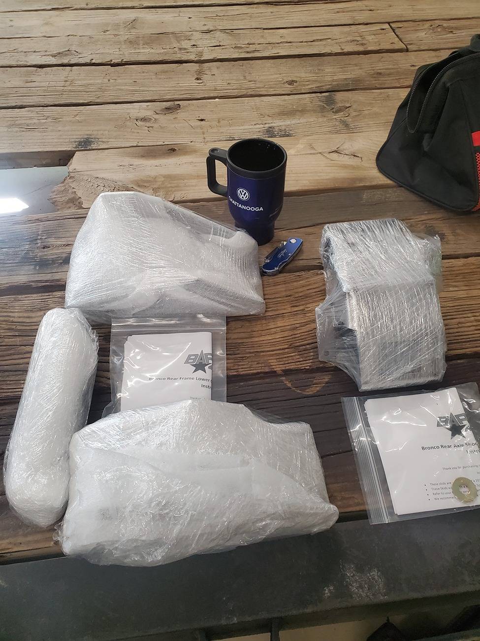

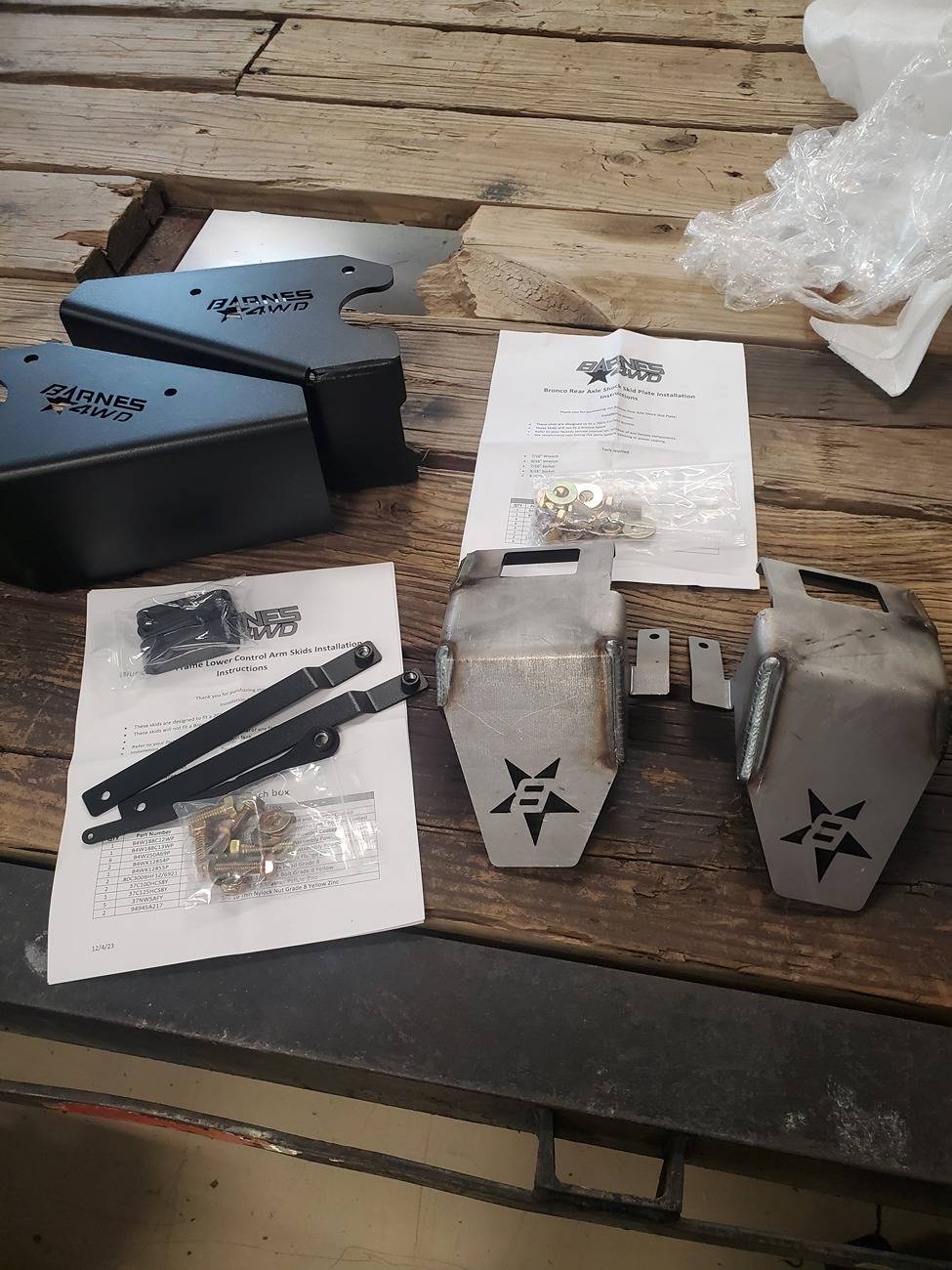

Finally bought some control arm and shock skids from Barnes, they have been sitting waiting to go on. Broke them out and got all the way to attaching the shock skids. This is easier tires off. I did it both ways to see. My drivers side needed some b hammer love first as I have beaten the snot out of these on rocks.
Ford Bronco Valhalla's Long term build thread 20250710_101336
Ford Bronco Valhalla's Long term build thread 20250710_101750
Ford Bronco Valhalla's Long term build thread 20250710_102527
Ford Bronco Valhalla's Long term build thread 20250710_103506
Ford Bronco Valhalla's Long term build thread 20250710_111912
Ford Bronco Valhalla's Long term build thread 20250710_120557

Tomorrow I'll attach the co tr arm skids.

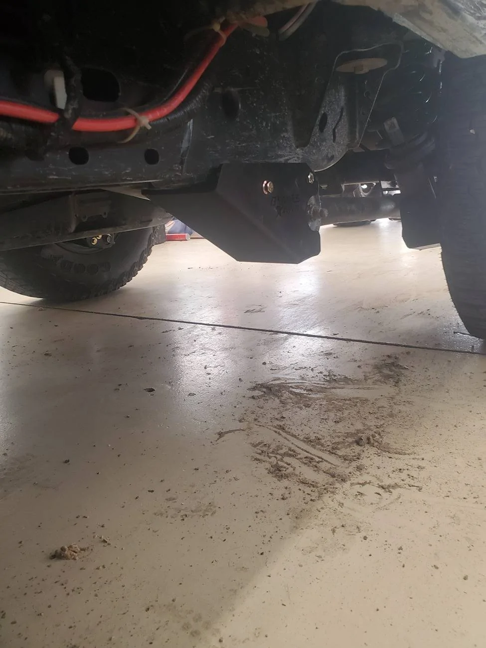

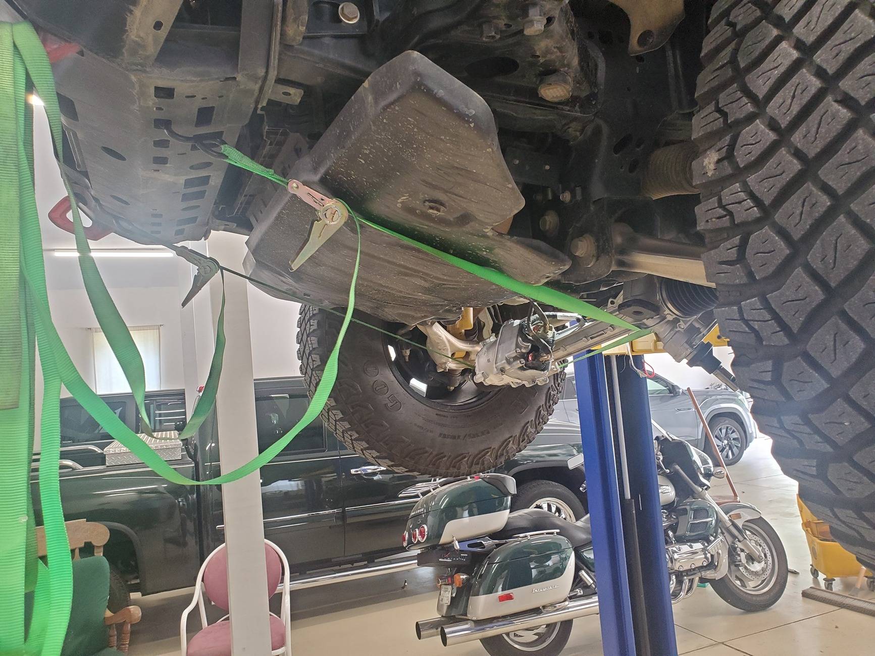

Okay, so
Ford Bronco Valhalla's Long term build thread 20250711_104109
after reading control arm skid instructions I see I need to drop the fuel tank.... nope, full tank have to wait. Idid the driver side. I did have to use liberal amounts of metallic persuader to move the stock metal closer to the right size. This all to make the skid to go on.

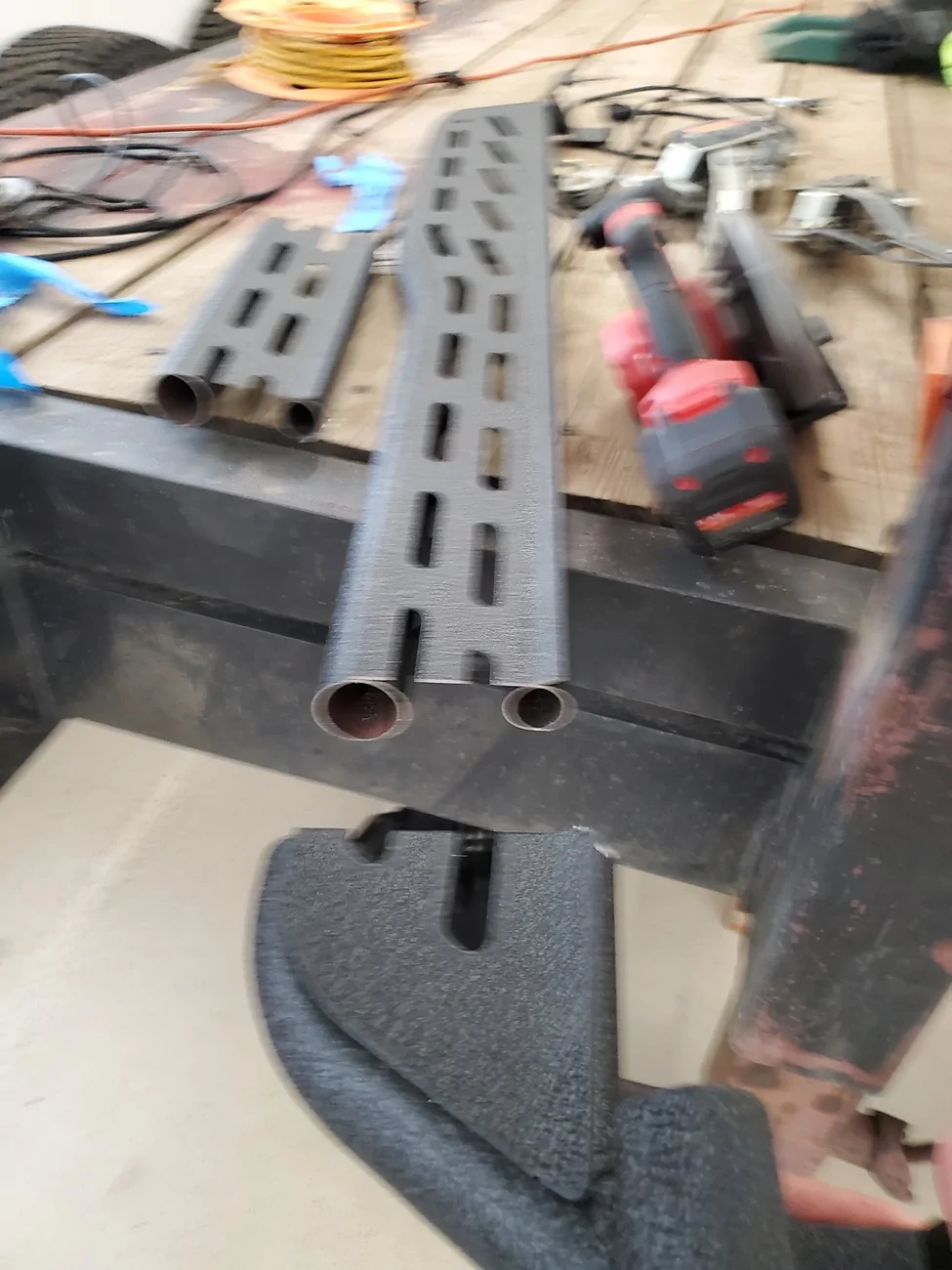

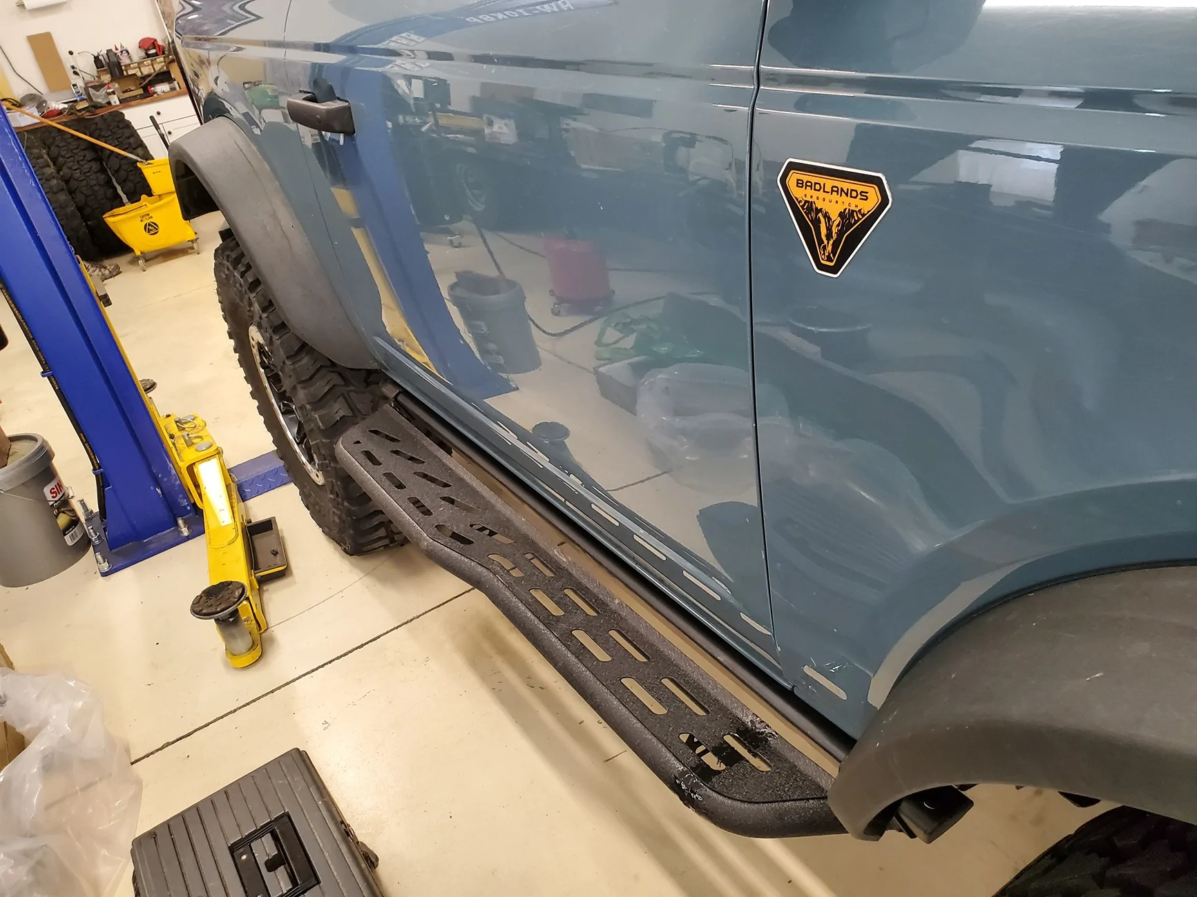

So I chopped a ebay Chinese bar 14 inches to work with my 2 door. I would not trust 16ga offroad, and these are cheapie metal that melts on normal weld settings for this guage. I got them to slap on when not wheeling.
Ford Bronco Valhalla's Long term build thread 20250924_124712
Ford Bronco Valhalla's Long term build thread 20250924_114405

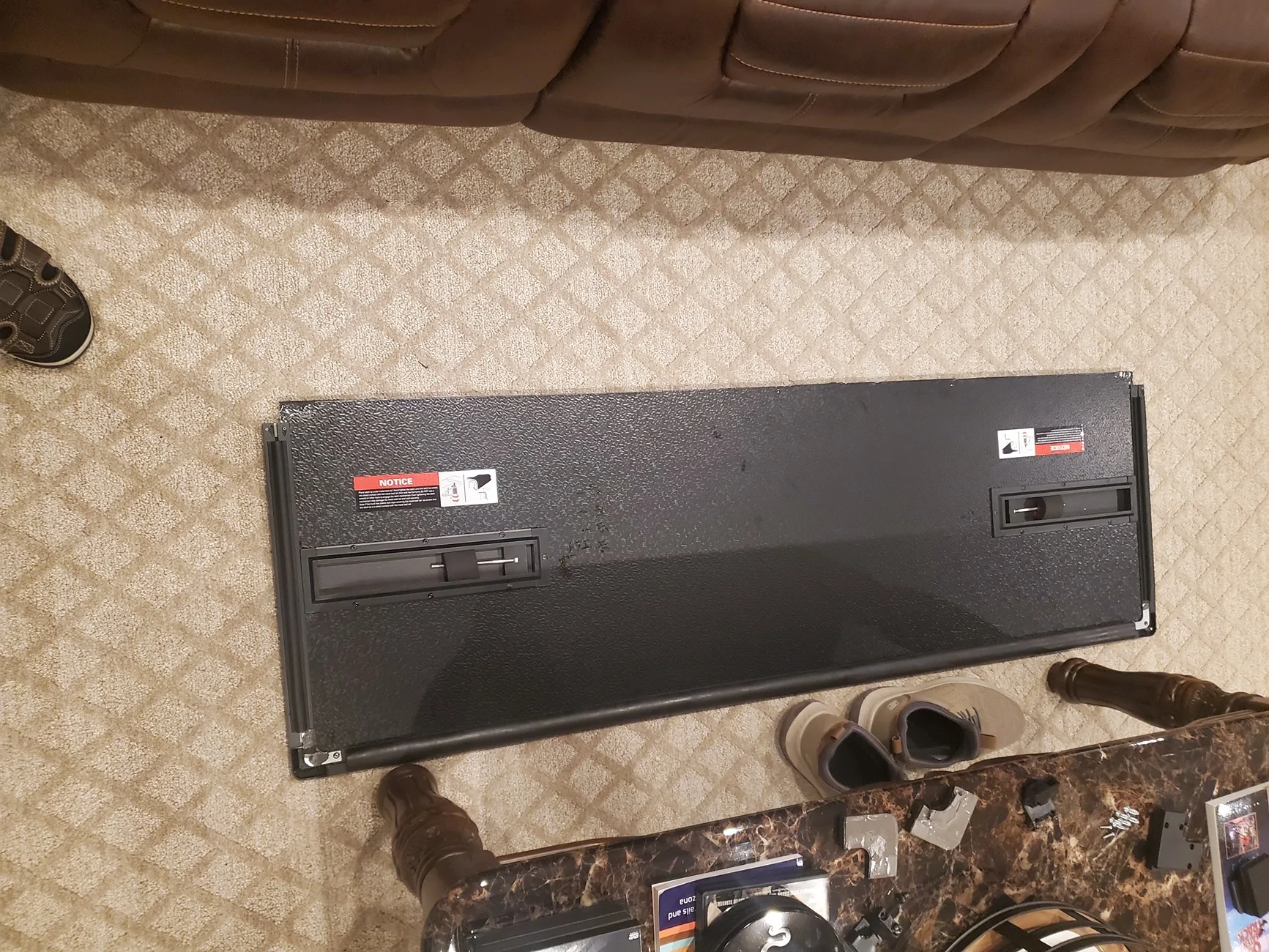

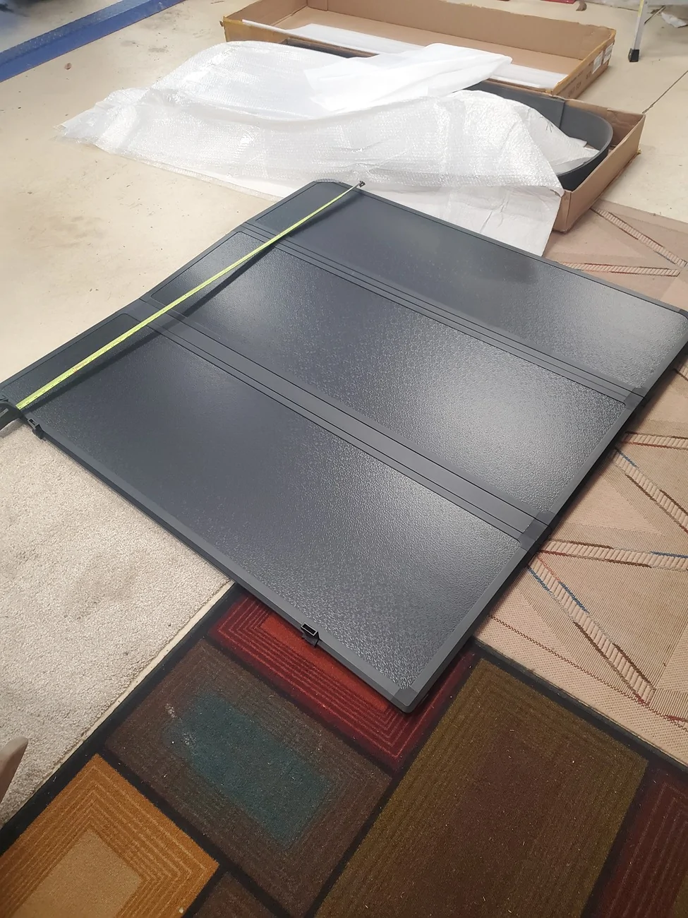

So here we are again. I am going to start posting pics of the install on the Maverick Tonneau cover.
Ford Bronco Valhalla's Long term build thread 20260207_154555
It is longer than the 2 door from the back of the B-pillar to the gate.

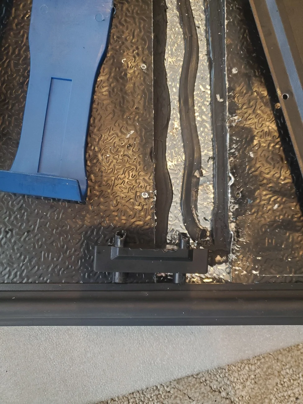

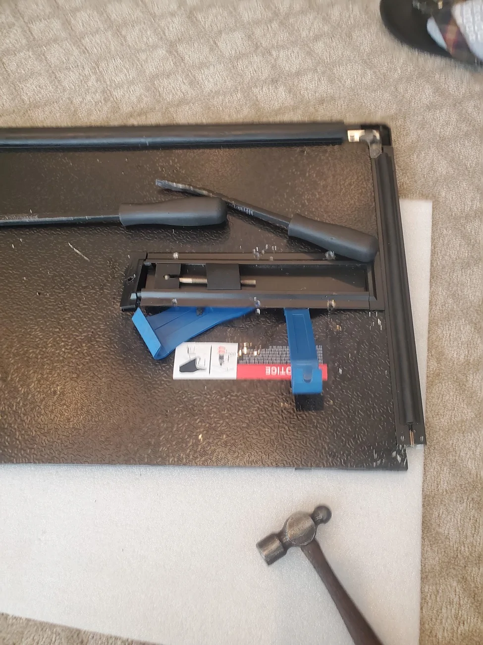

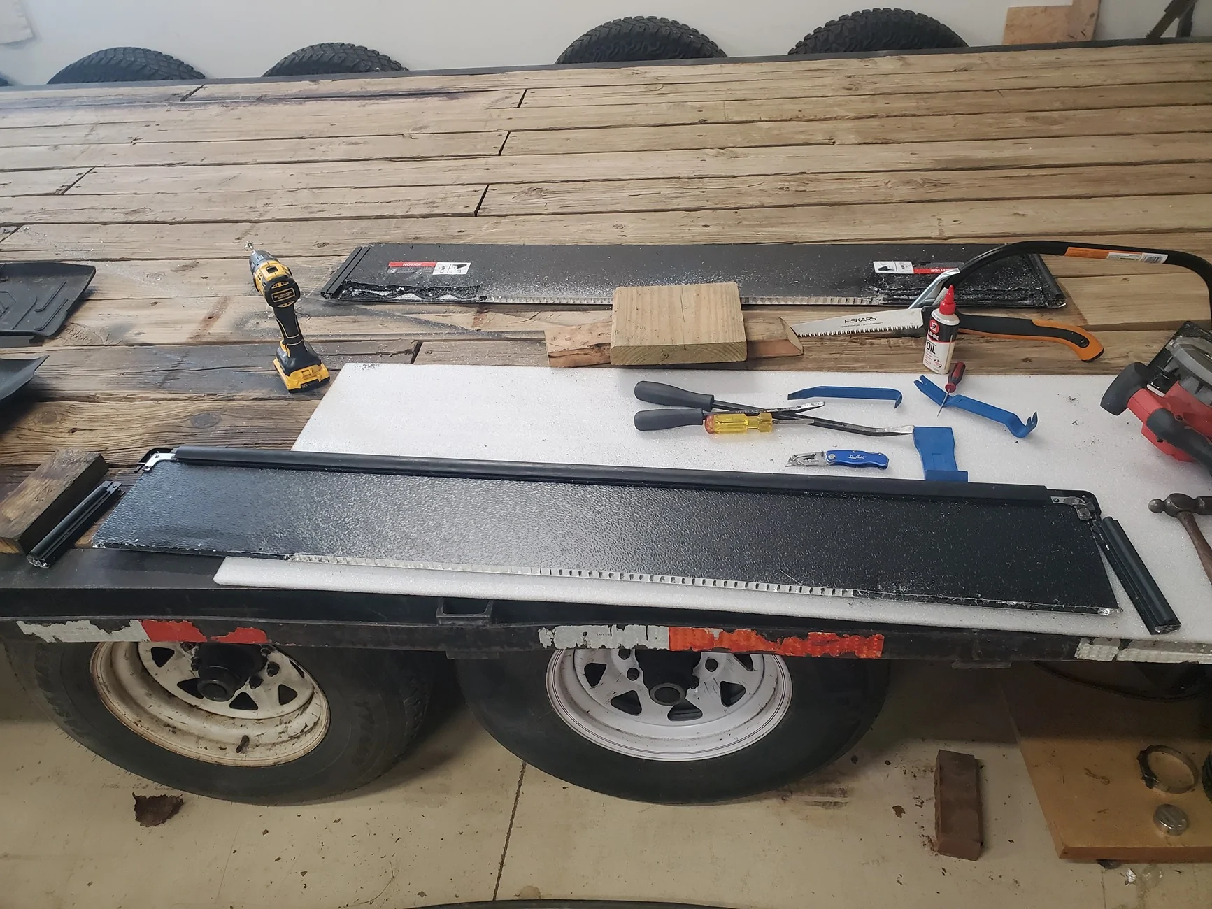

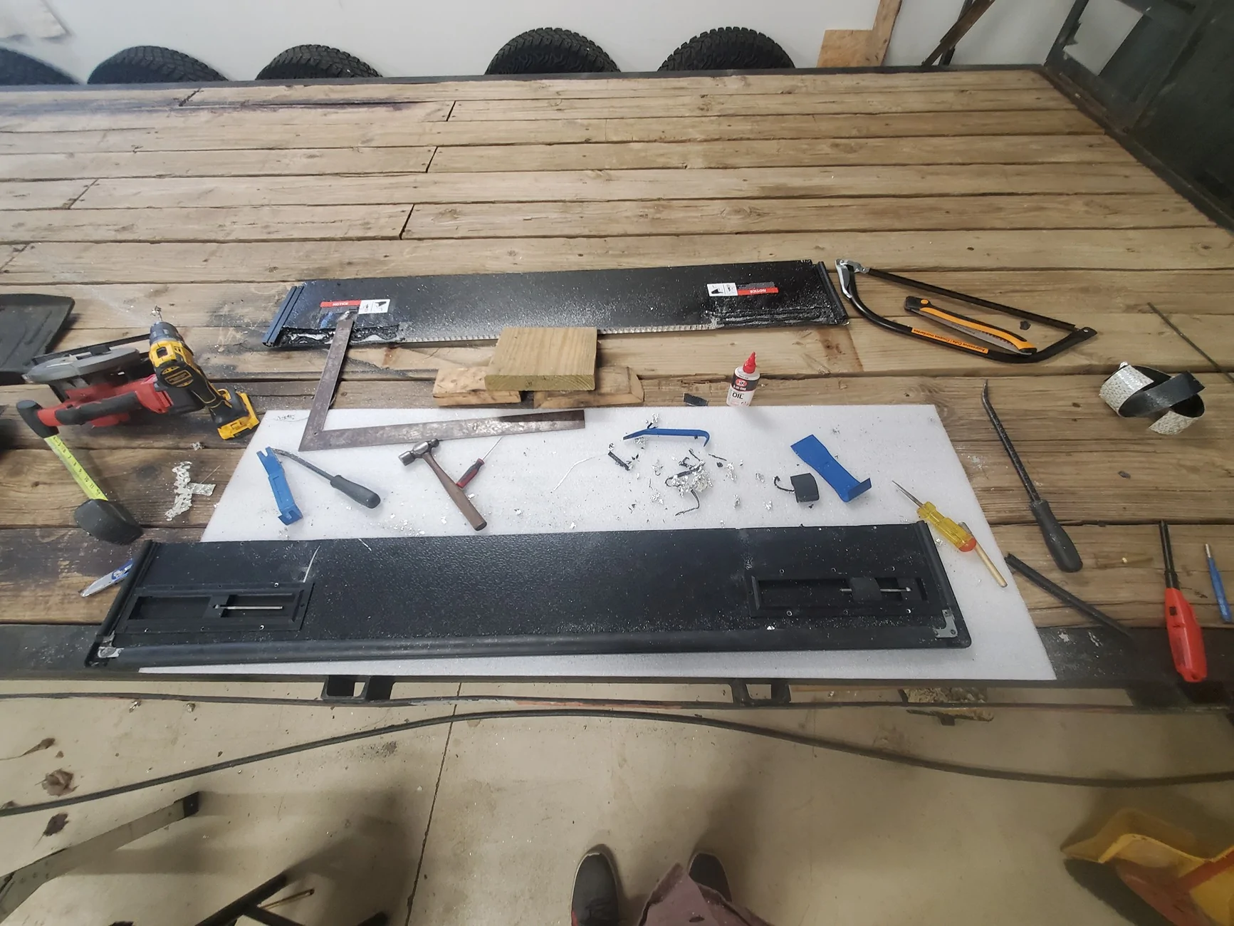

I removed the front trim after pulling the pivot joint apart. Remove the screws on the lead edge and pry the automotive glue loose. (the glue is tricky; I should have tried some heat). I have some cheap Harbor freight trim tools I abuse often.
Ford Bronco Valhalla's Long term build thread 20260207_191103

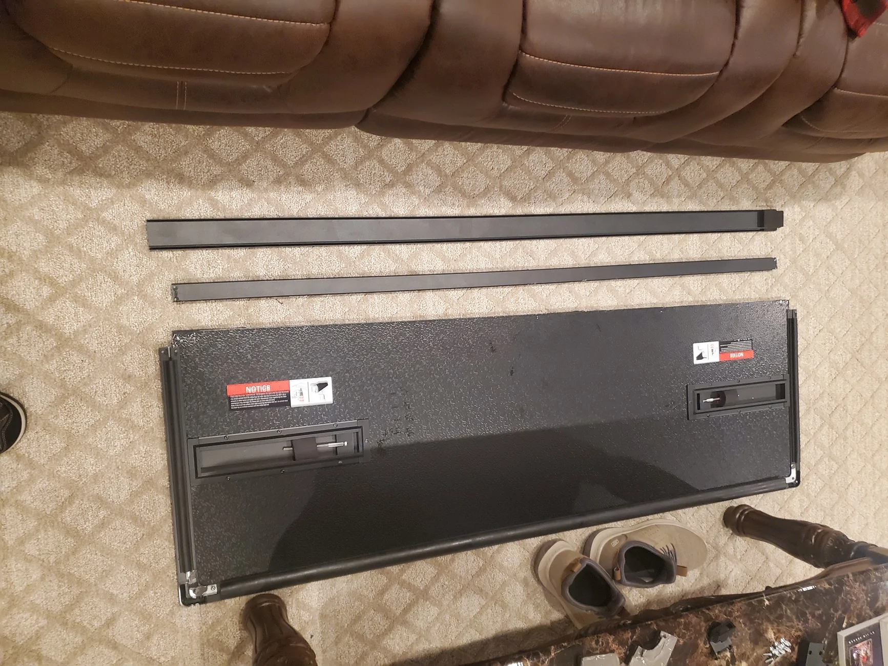

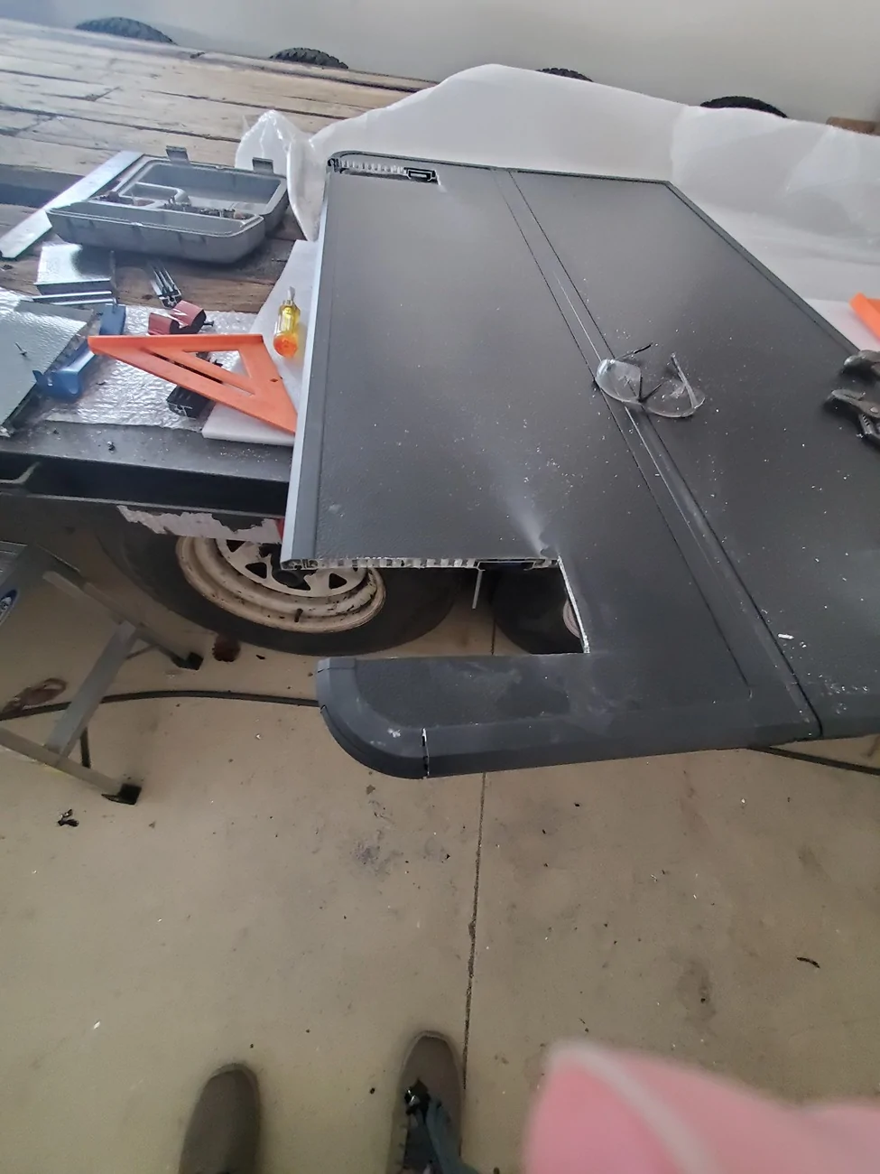

Chopping will come after we disassemble some glue rivets and screws.
Ford Bronco Valhalla's Long term build thread 20260208_124009

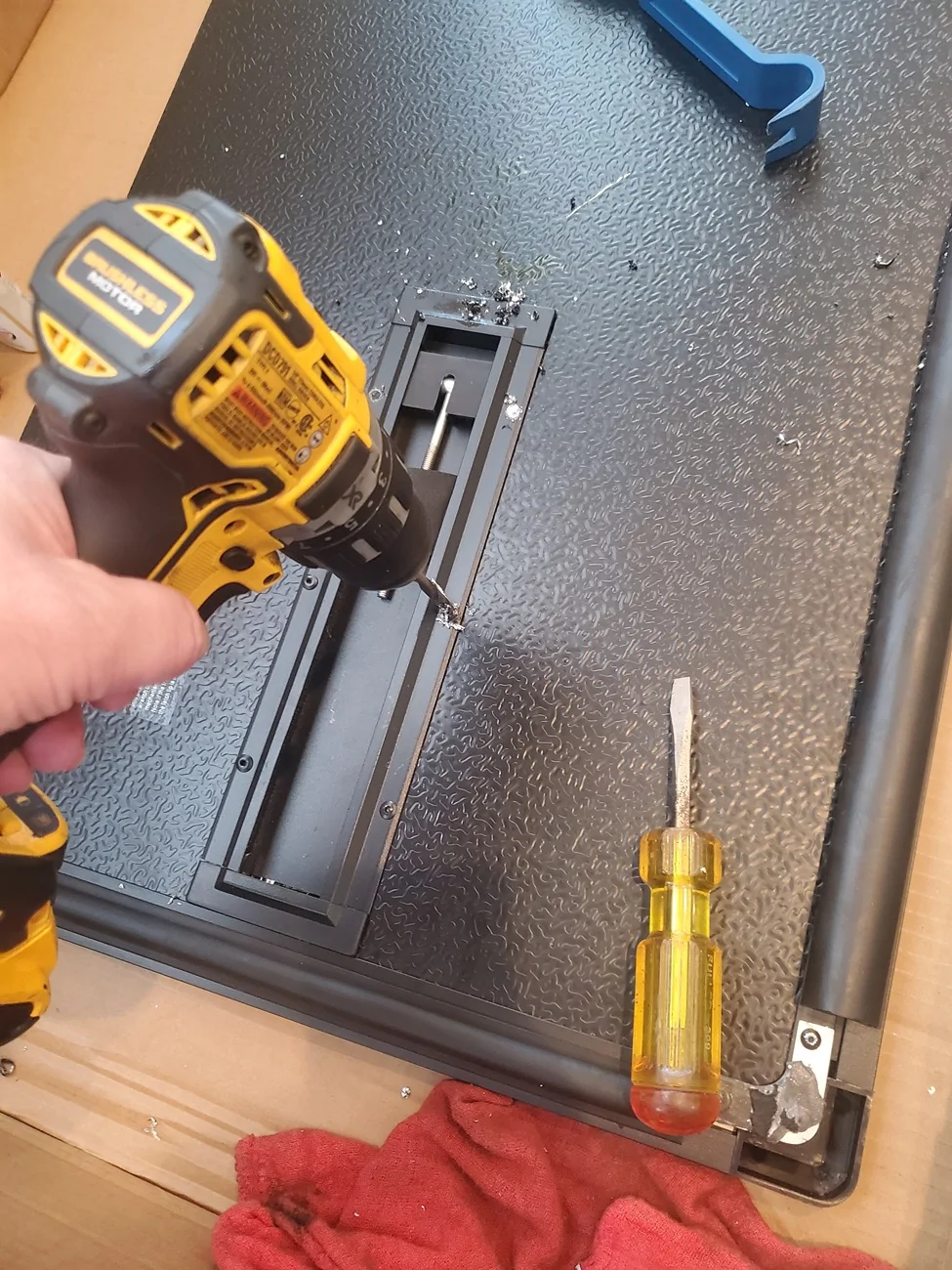

I used a 5/16 bit to drill out rivets.
Ford Bronco Valhalla's Long term build thread 20260208_125453

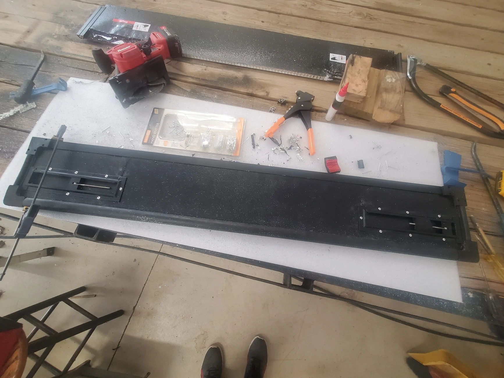

Then I chopped out several inches.
Ford Bronco Valhalla's Long term build thread 20260208_133847
I set the depth low and, on my metal, circular saw I made a new hole for the tie down.
Ford Bronco Valhalla's Long term build thread 20260208_143953
I then glued it together screwed and riveted it. I used a name brand epoxy glue.
Ford Bronco Valhalla's Long term build thread 20260209_124705

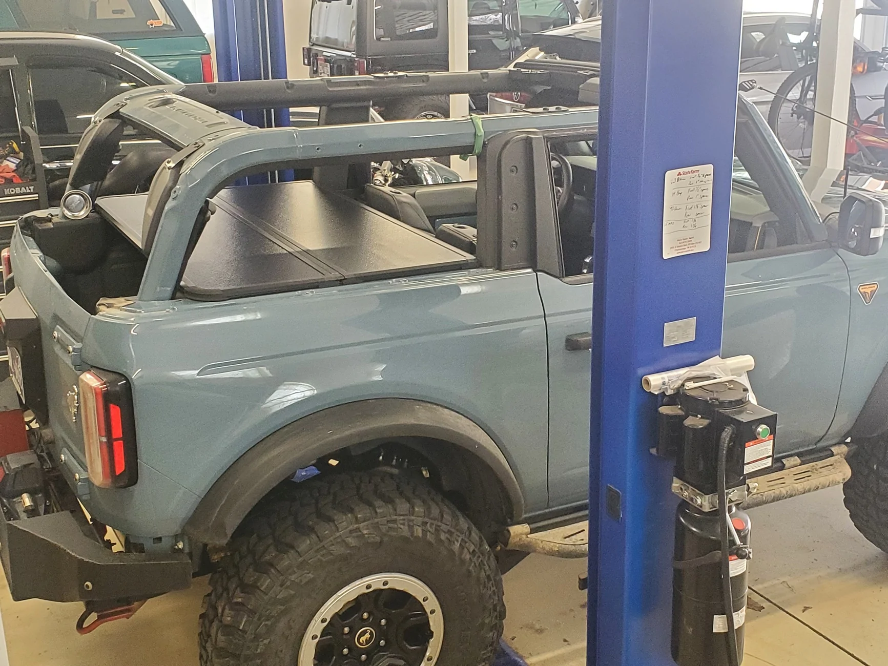

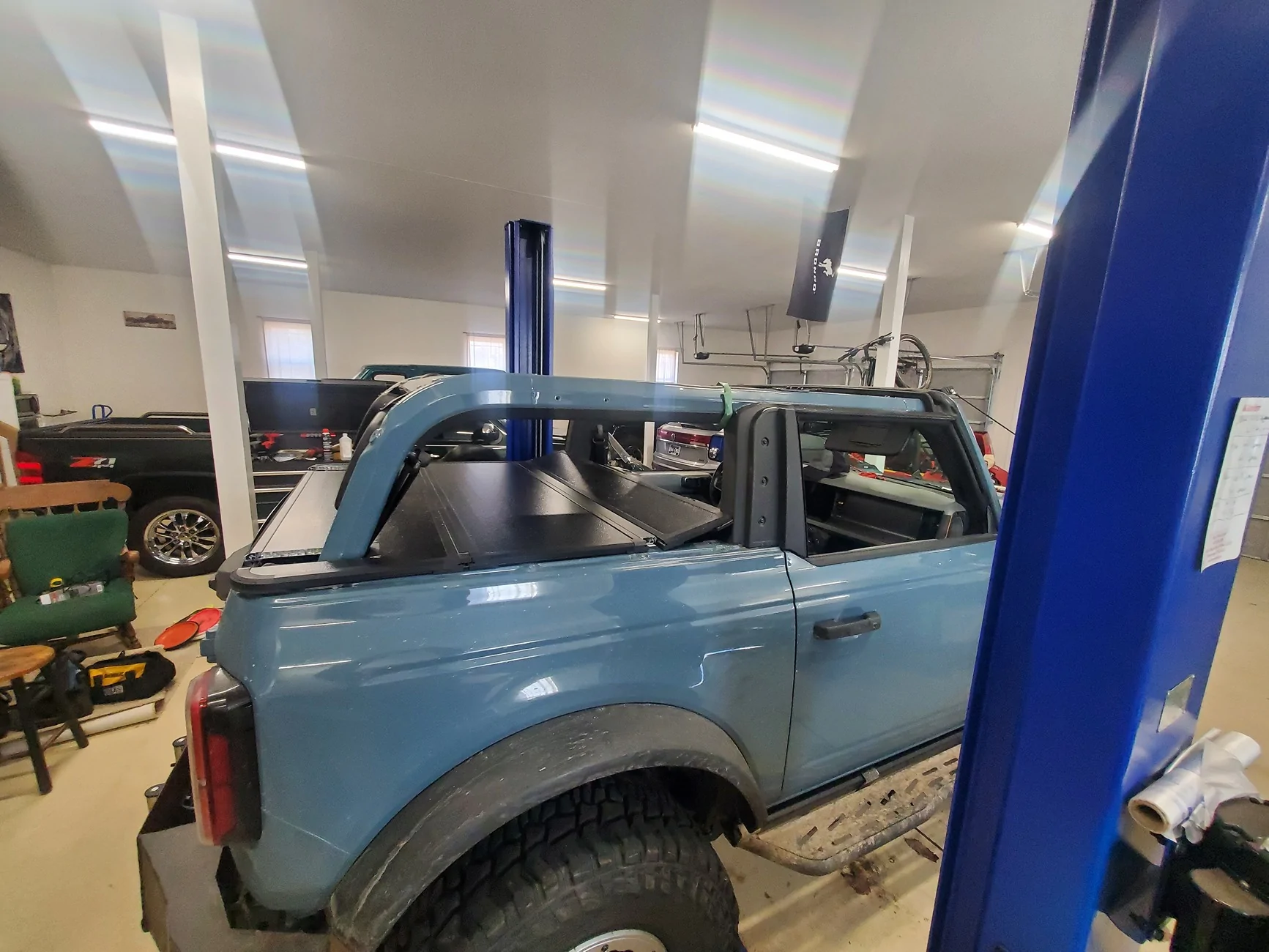

Pulled the Bronco MIC top and test fit. 2 panels.
Ford Bronco Valhalla's Long term build thread 20260210_124009
After cutting a rollbar hole I test fit with all panels on.
Ford Bronco Valhalla's Long term build thread 20260211_124426
I then cut down for the corner (Dremel using corner trim as a guide) and adjusted the hole for the roll bar. My current dimensions are 3.5x7.5x10.75" on the hole.
Ford Bronco Valhalla's Long term build thread 20260211_140715
