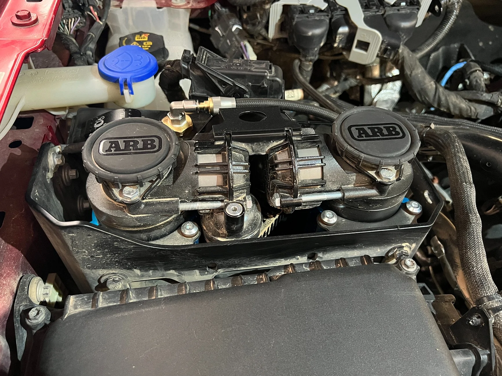

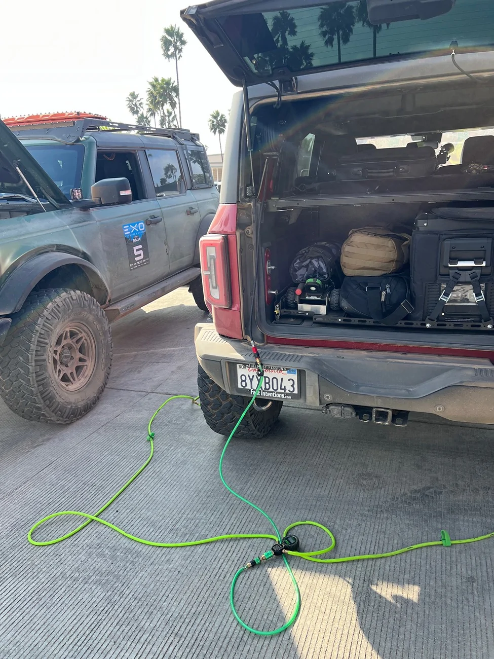

Nice rig! and thanks for posting your pics- they are sweet. I like your Apex reel system. Where do you hide the ARB compressor? Behind the spare (wheel) or do you have it installed somewhere in the interior? Also do you attach the apex to a 4-way hose to air up all tires at once or do you just do one tire at a time? thanks for your time.
Originally, we had installed the ARB compressor under the hood in a Grimm Offroad mount. The plan is to eventually move it to the underfloor storage compartment in the trunk, but we haven't completed that yet.

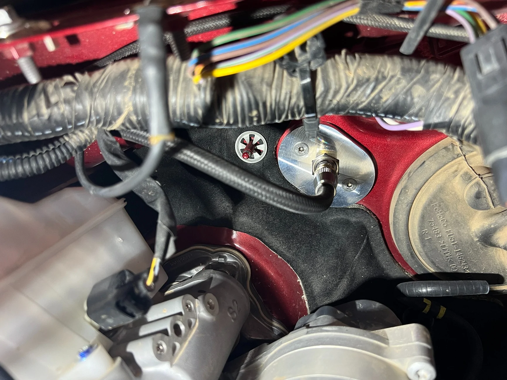

For now, we created a custom firewall pass through to run air to the reel in the trunk. We have the ability to fill each tire individually or connect to a 4-way fill setup.
