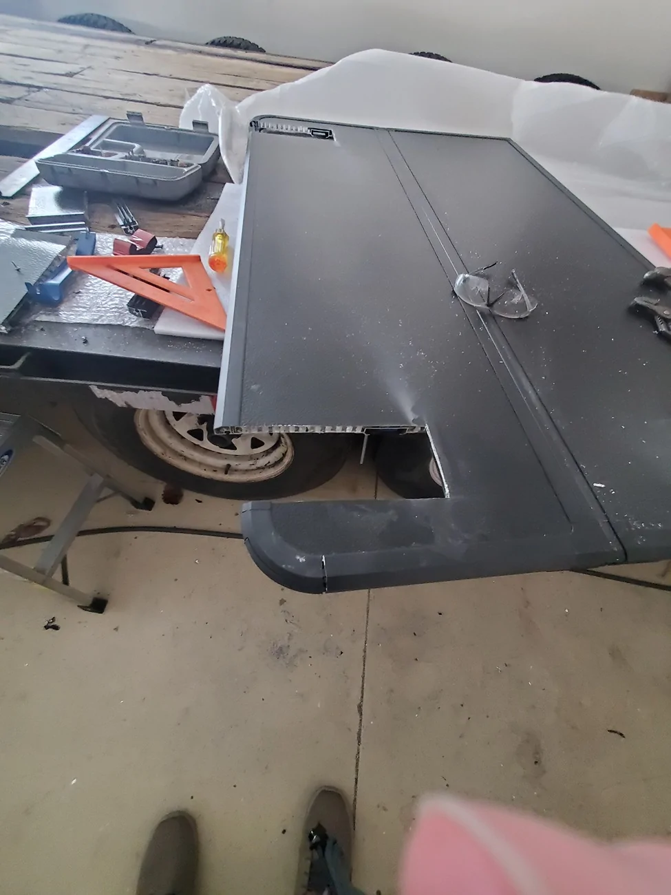

Interesting...I picked up a free F- 150 folding hard bed cover, I need to do similar trimming and gluing.
Thanks for posting.
Trace the bed first, it is oblong down the sides.

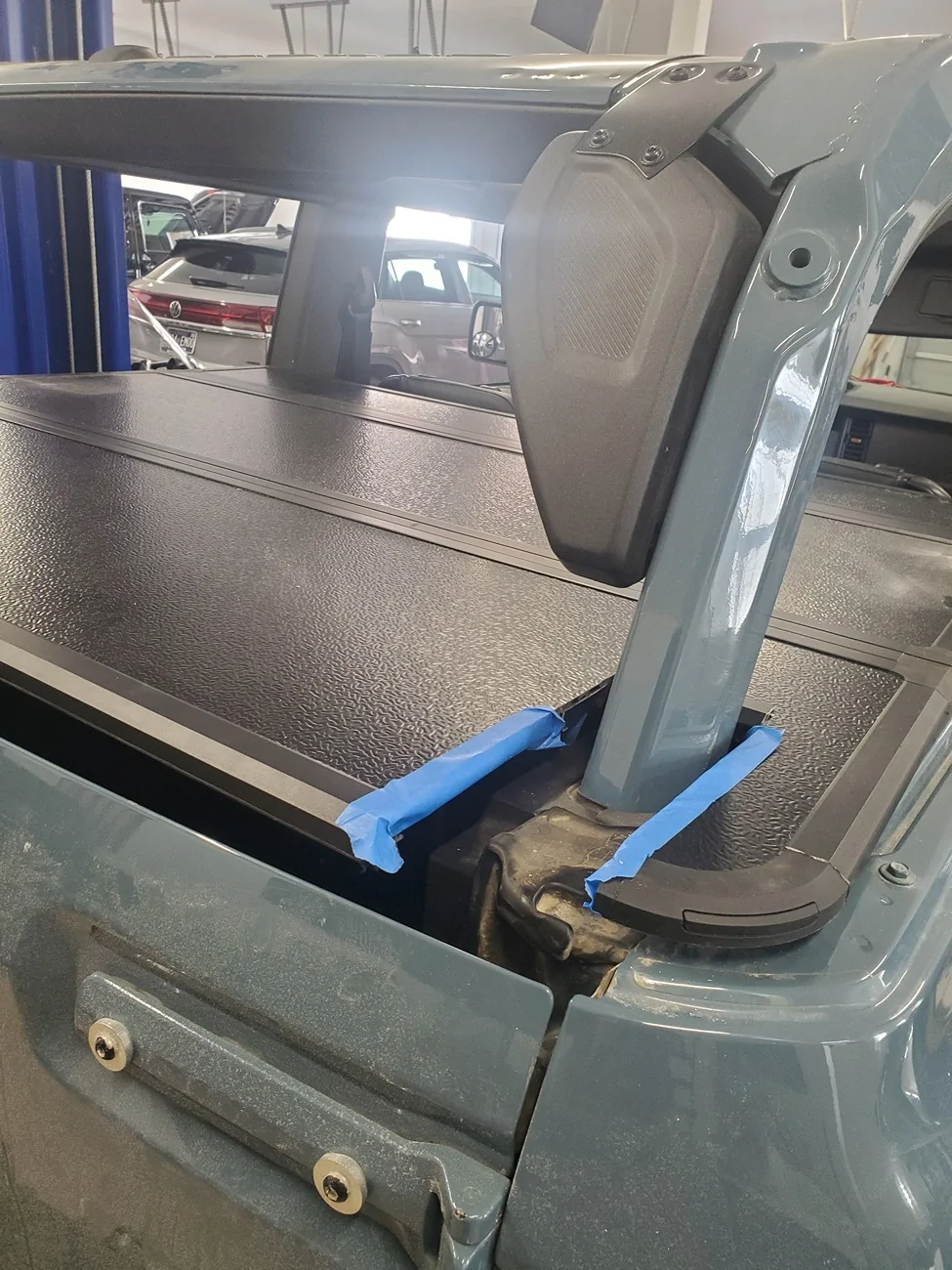

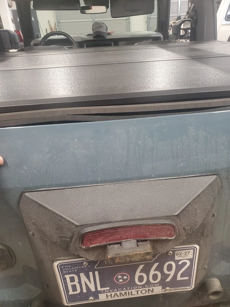

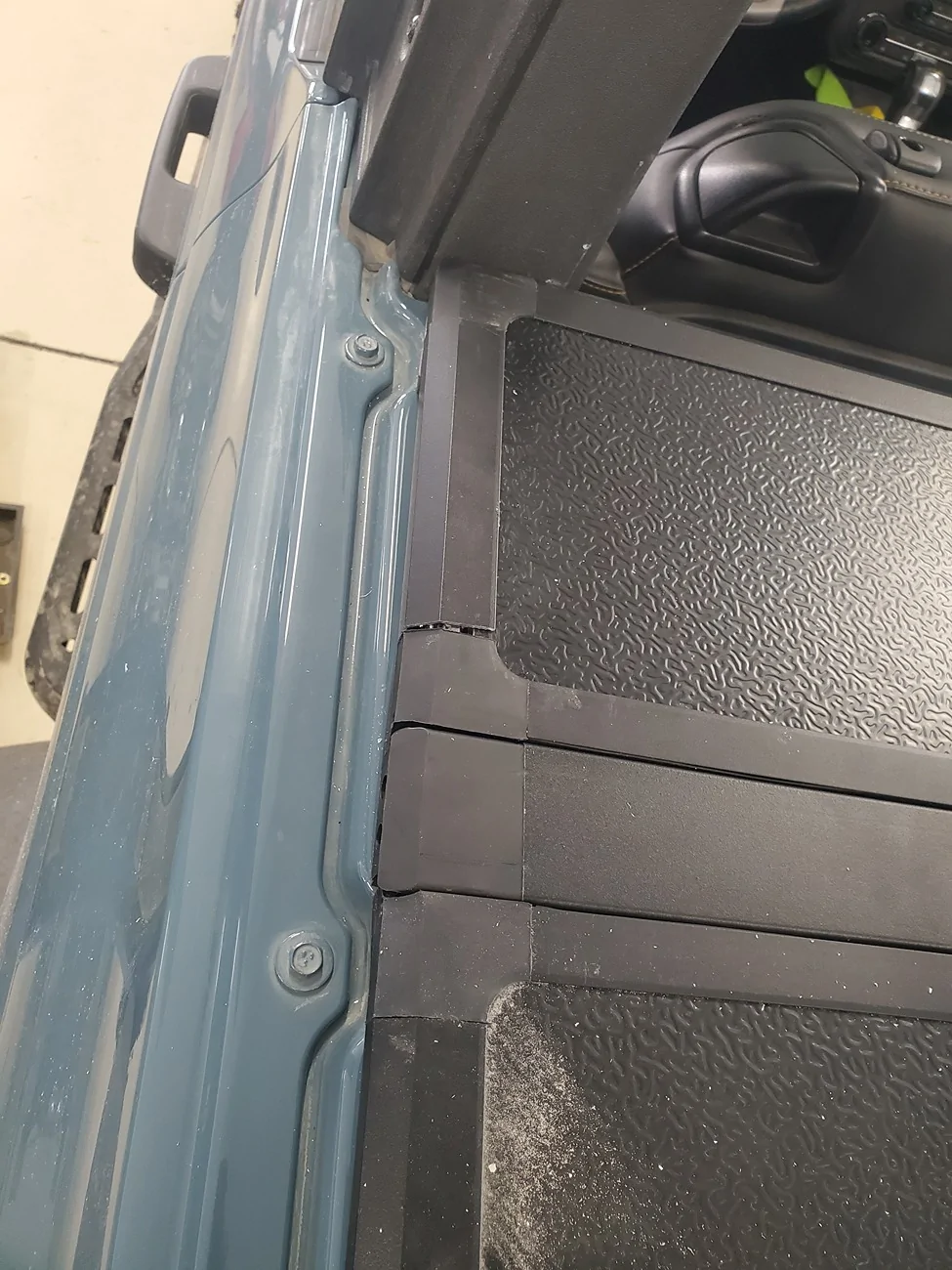

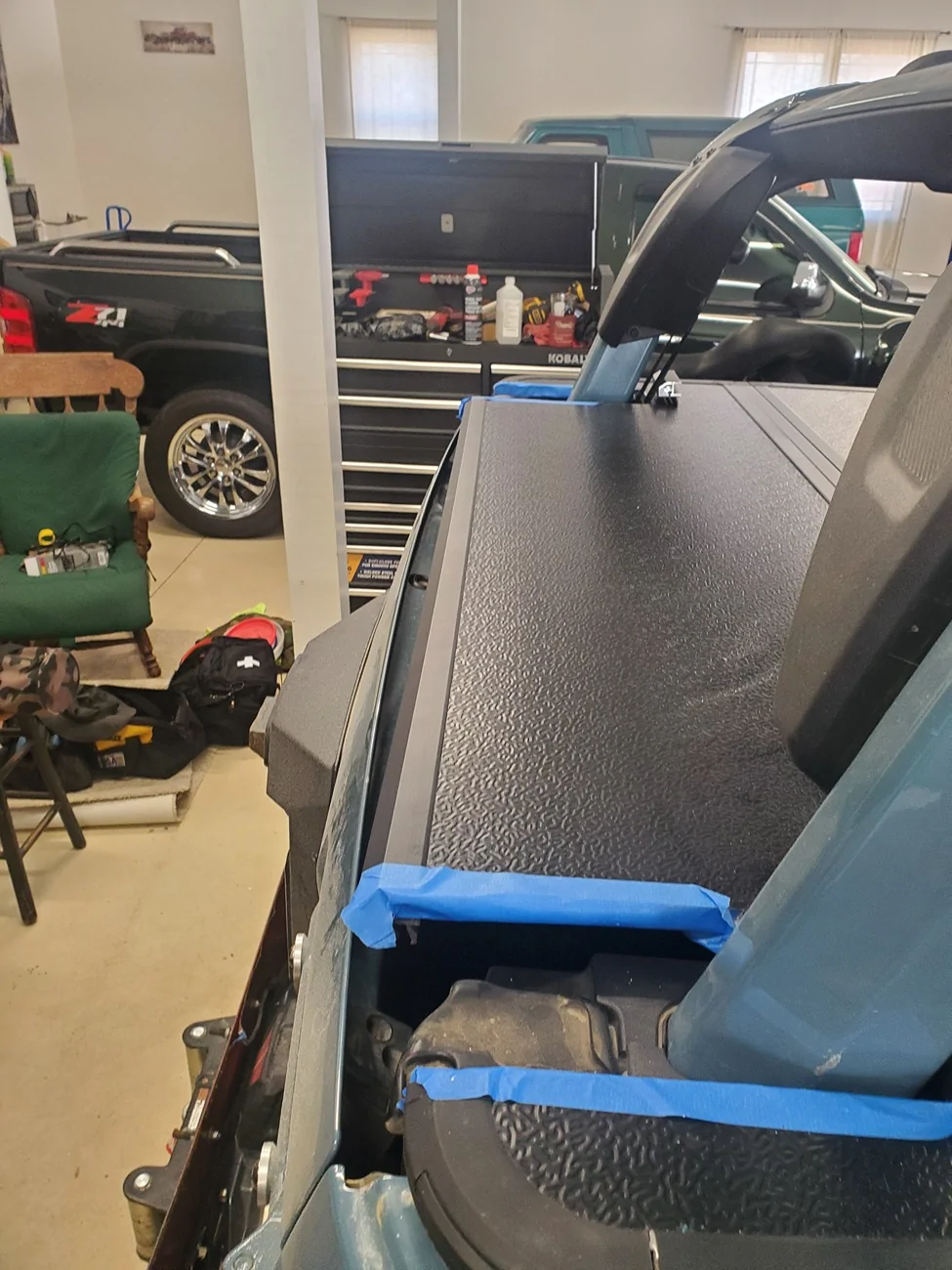

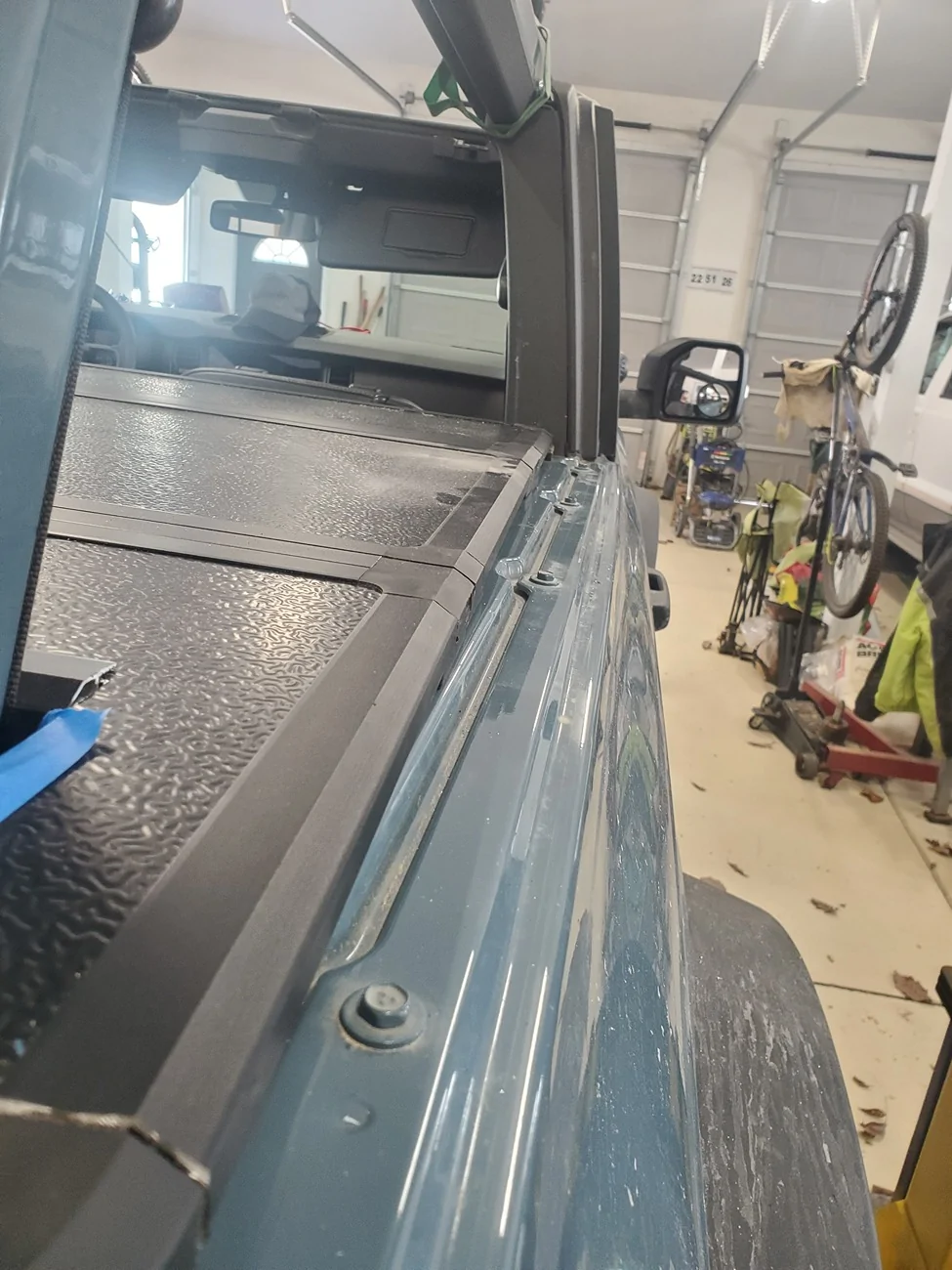

the pictures showing the sides definitely shows the narrowing of the body.
that looks sharp!! have you come up with an idea to seal the gap for the rear of the roll bar? some sort of rubber flap seal?

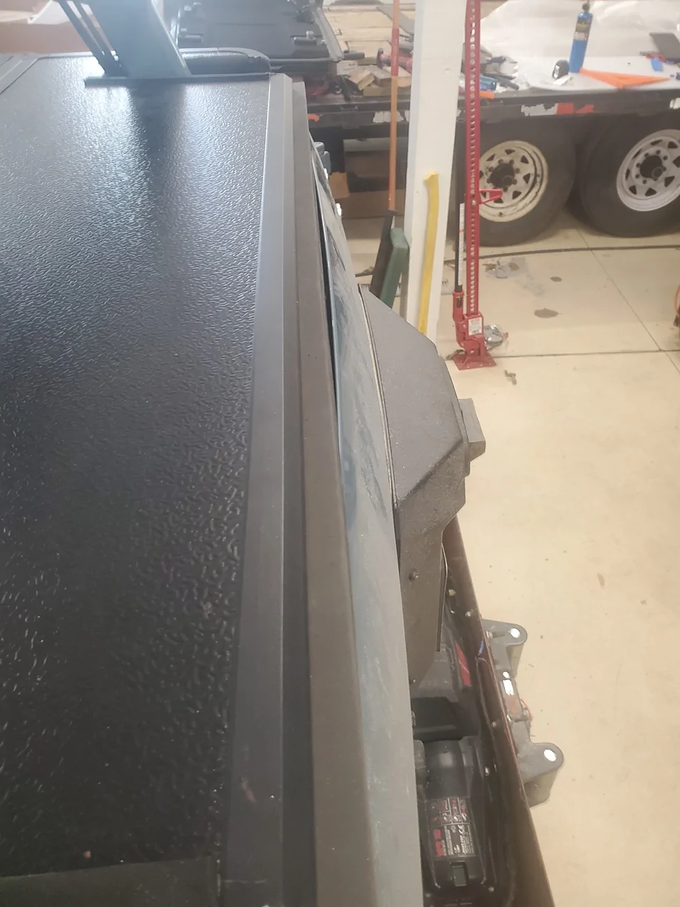

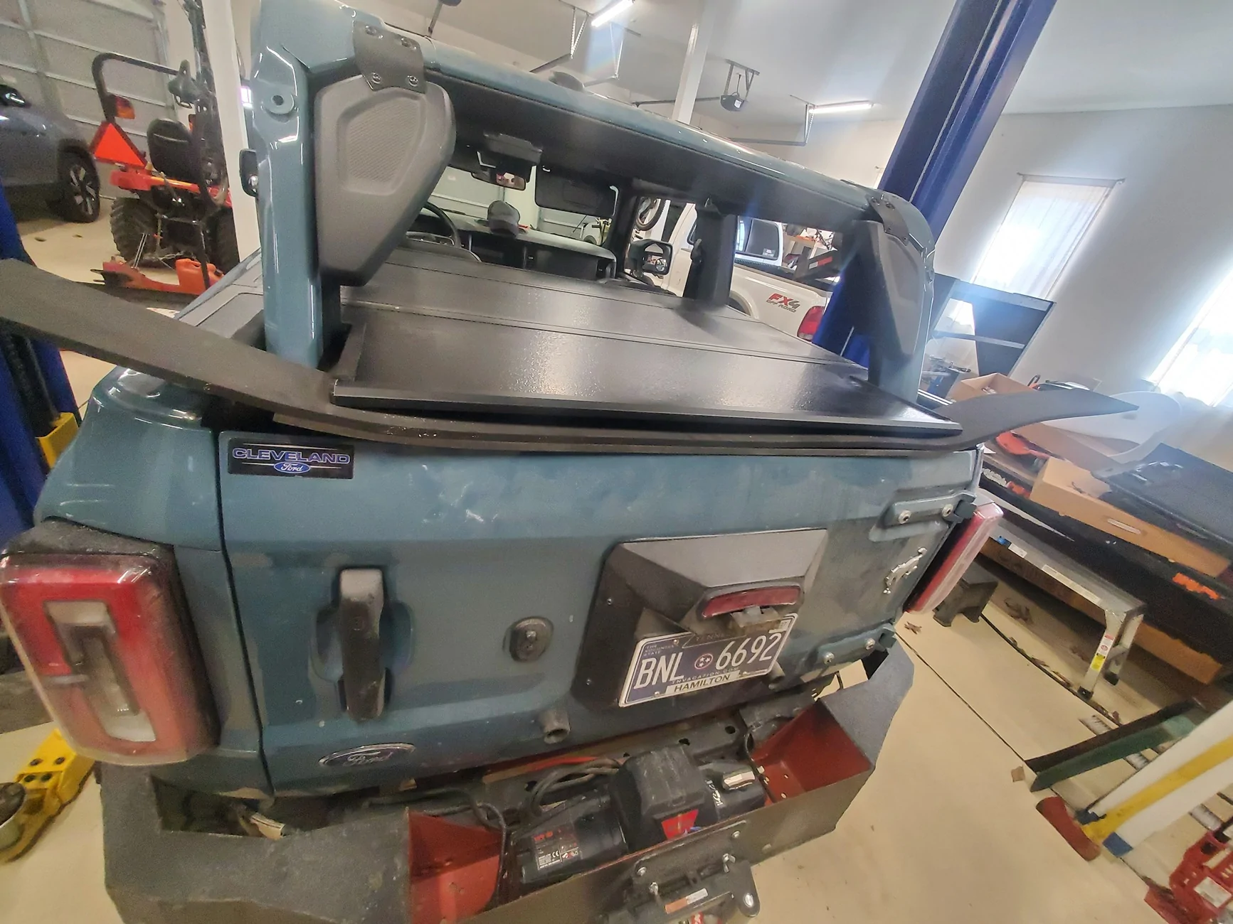

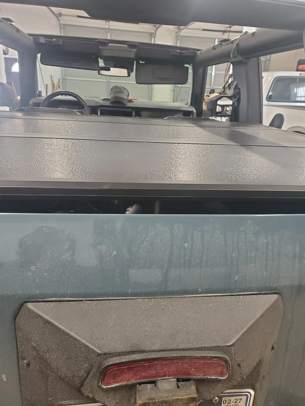

I am less concerned about the roll bar than the rear gate. The way it bows compared to the straight cover is considerable. If I were starting again, I would curve to the gate first. Then make my size cuts after.
I think it will be fine as this company provided some very heavy rubberized packaging that is still and thick. I plan on making an inner lower lip.
As to your question I plan to clean up the edges with rubber seals or use some 1/2 J channel. I will be to the final touches probably next week.

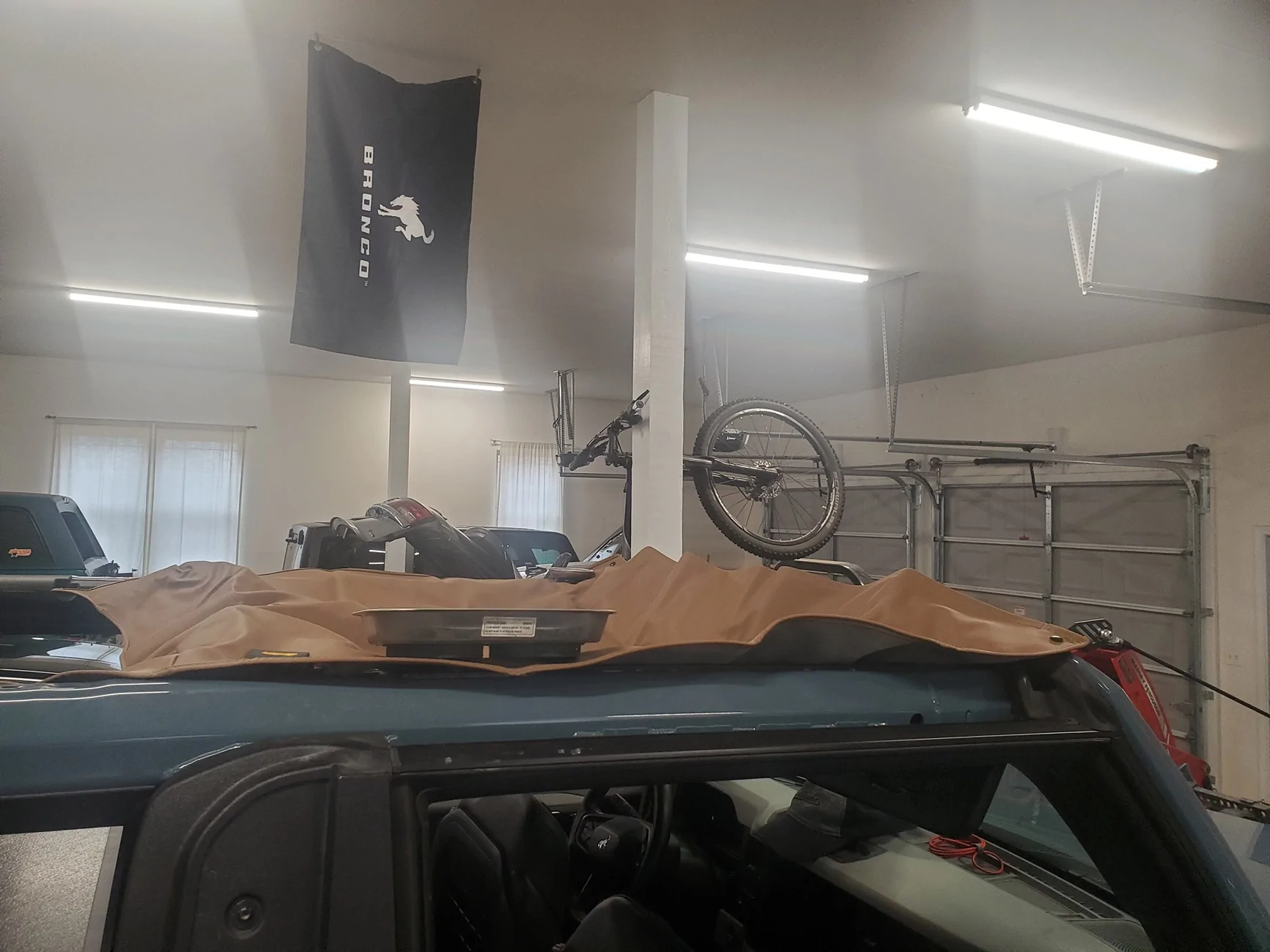

The CJ7 windjammer should work, I will build a bar for it of the cage. The CJ7 Bikini top will definitely work, had to order the front channel as it is not with it.
