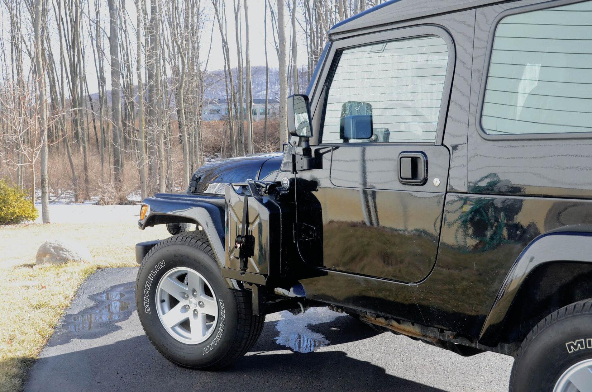

Maybe a side or rear mounted can will do...If and when it's available
Ford Bronco Upgrading Bronco fuel tank capacity Sidegascan

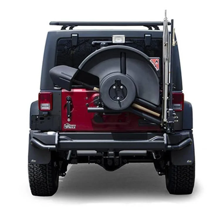

IMPO. There will likely be a few options, timing is the unknown.
Expectations:
- aftermarket rear bumper w/ tire swing gate + single or dual Jerry can cage.
- rotopax offerings (I’ll skip those based on experience)
- Full on long range tank swap??? Who knows.
I’ll be in the market for a aftermarket rear bumper with a swing gate + jerry can(s). Mostly because that’s familiar territory.
The x-factor is that these offerings will take time because....nobody has a Bronco to develop these products around. So anything that I’d be interested in will not be available quite some time.
High clearance bumper with spare and can mounted gate is in my future. I doubt the long term durability of the rear gate to support near 100lbs off road for a couple 100K miles.

I’ve owned & used several different kinds of RotoPax over the years for fuel & water. In some cases they are one of very few options available so I understand they’re popularity. However time and time again I found a traditional jerry to be far superior for fuel & water management.
I despise all things California about gas can spouts and the RotoPax versions are truly awful. So bad that we actually could not get the spout to flow once in the middle of the desert. Resorted to ditching the spout and pouring it out into my buddies jerry, then using the jerry to fuel my truck. So word to the wise, if youI pick up a few RotoPax cans throw that fuel spout directly in the garbage and order some standard water spouts. Yes, I know their for water not fuel, I don’t care. It worked.
Plus you have to burp them in the summer heat and I needed more capacity. So I gave most of them away and switched over to a dual jerry holder / rear bumper. Quick easy access, worked really well for water while camping also.
