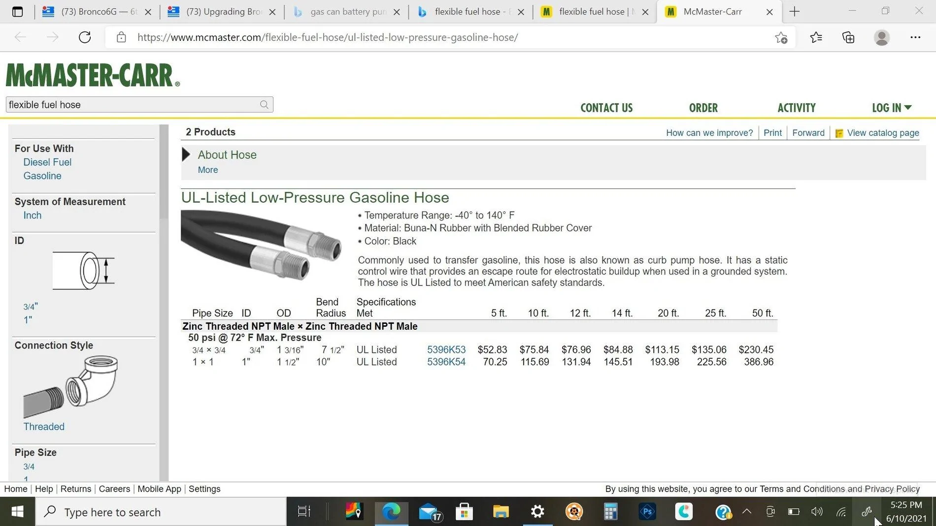

If you want to get all fancy a small inline pump would suffice aswell there is aux switch wiring on the rear. My only concern with a dedicated line is the hinging of the tailgate and pivot wear. Another simple option you be a battery powered drop in fuel transfer pump. But for sure for less than a couple hundred dollars you could plumb in and wire up(safely). Would have to use good fuel hose to resist the elements and flex wear. Have the hose enter the can at the cap and then run down the side and then under to the fuel filler tube. And put a low pressure pump inline just under the body. Keep the hose long for twistability.
Ford Bronco Upgrading Bronco fuel tank capacity KoPF93Z5MiAHaHa?w=205&h=205&c=7&o=5&dpr=1.65&pid=1
Ford Bronco Upgrading Bronco fuel tank capacity hos
Maybe not this exact hose but similar.

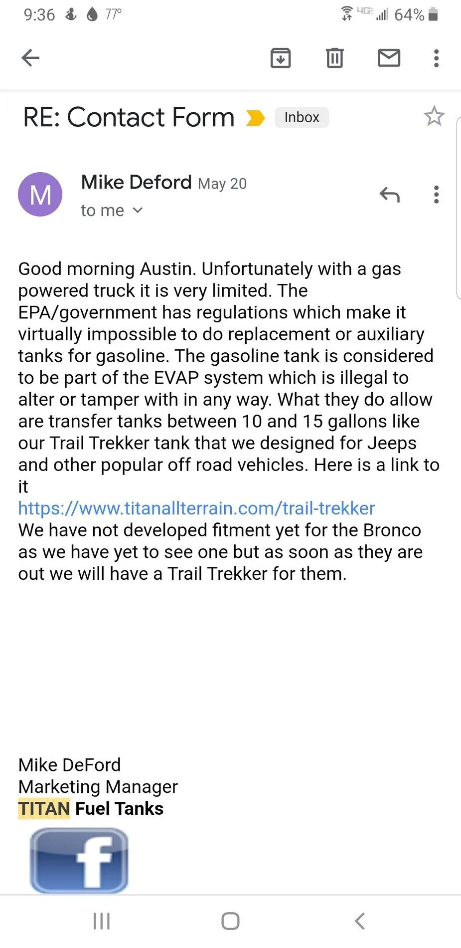

This is based on what? Your market experience as a manufacturer? Titan tanks does exactly what you are claiming will never be done. šŸ™„
Just making sure you saw the previous posts, especially the cut/paste from Titan?
