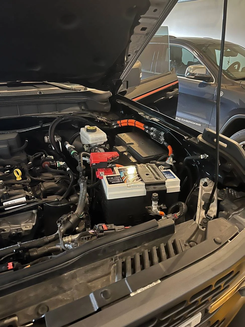

They also added a new upgraded battery and desired beginning there as well. I will pass on your suggestion appreciate it.

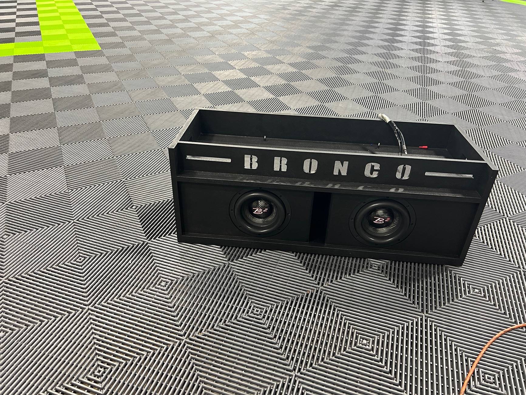

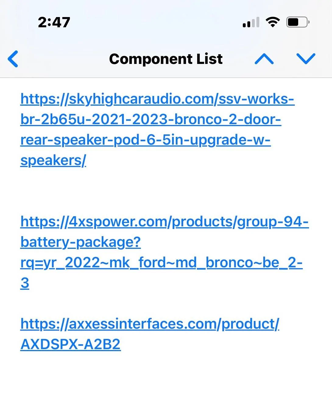

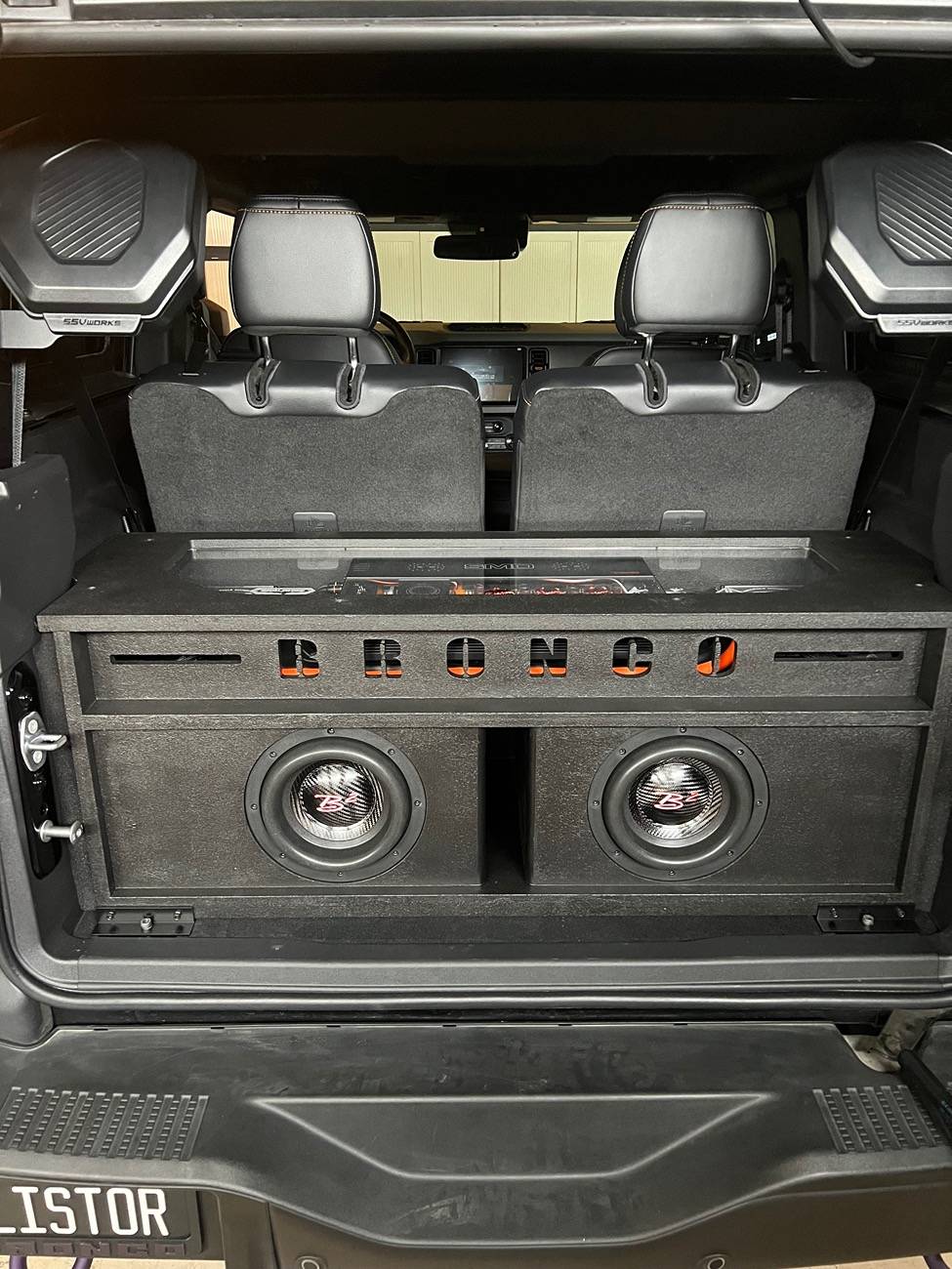

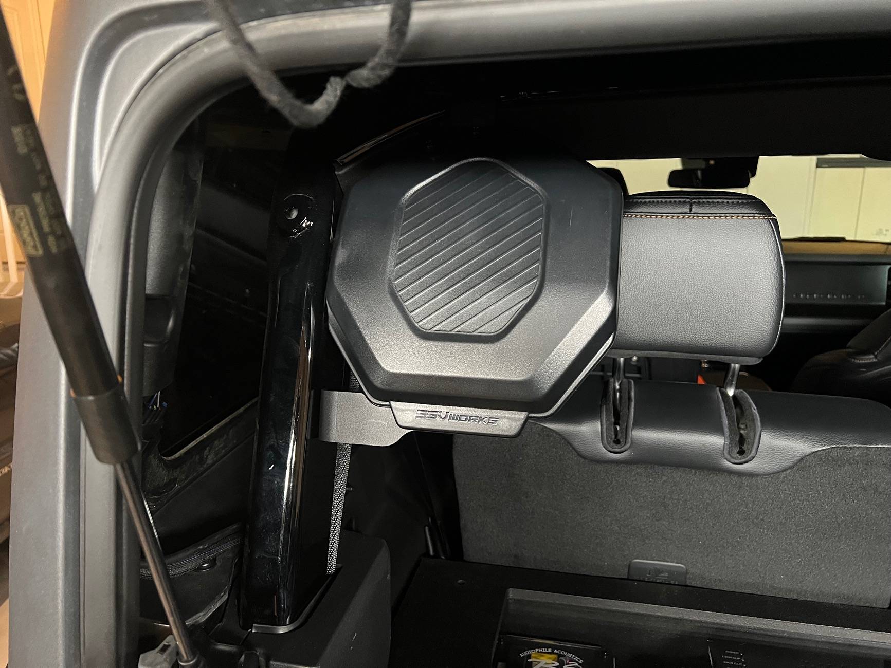

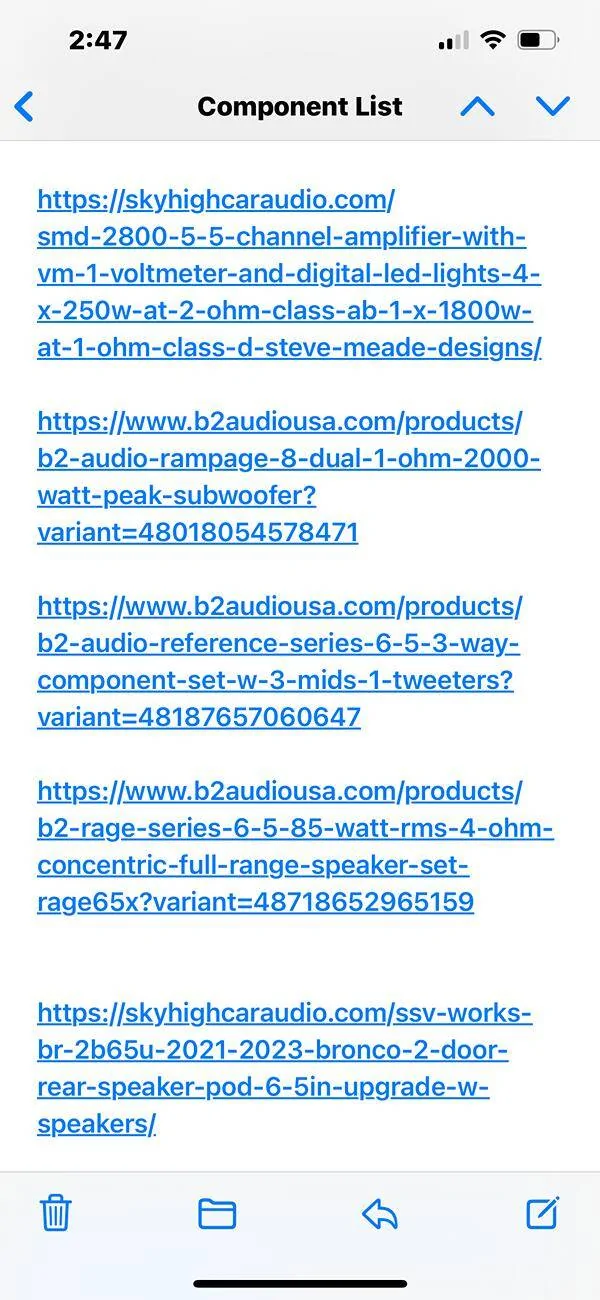

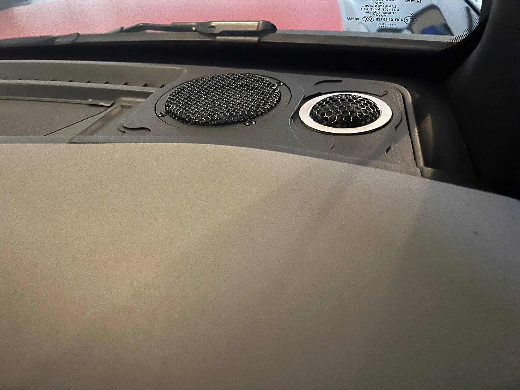

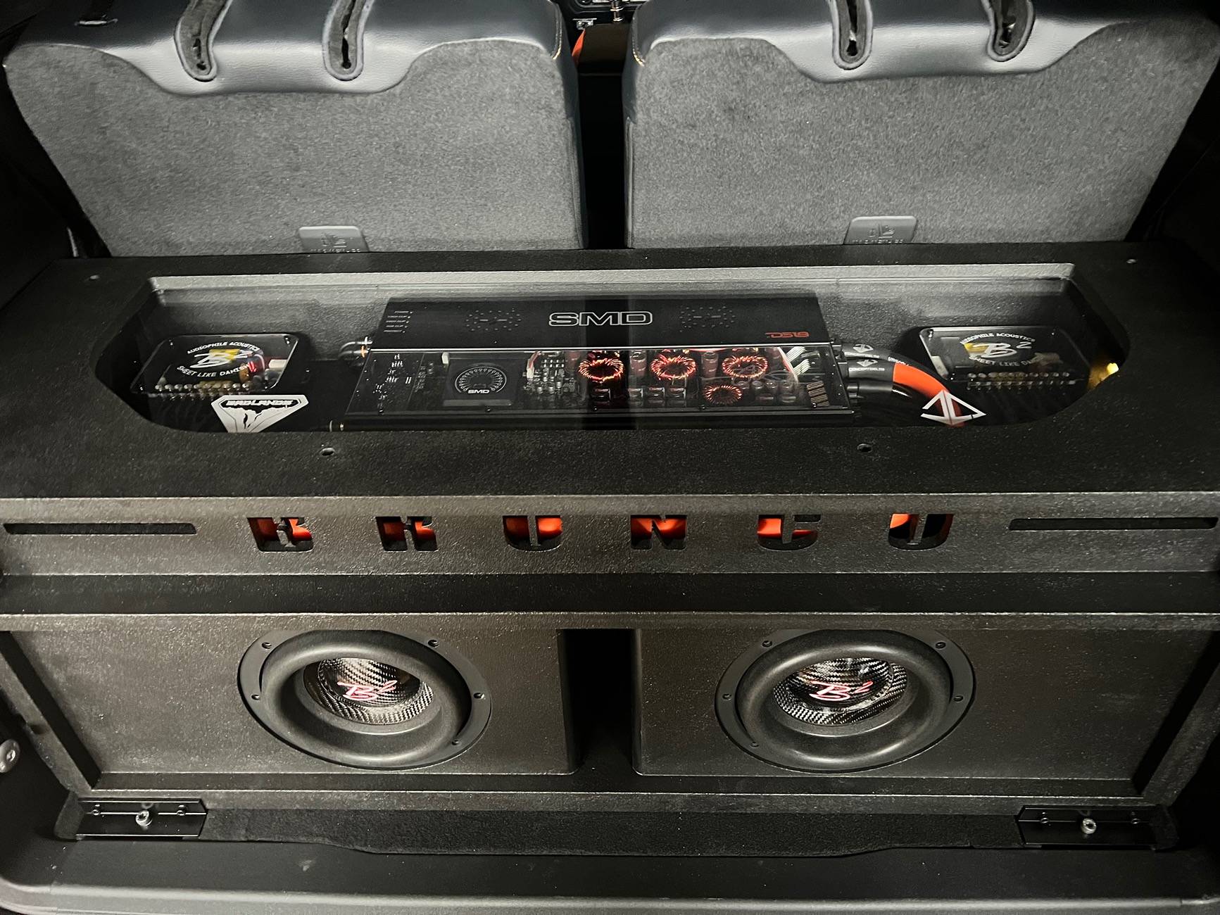

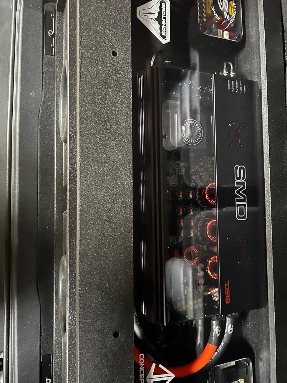

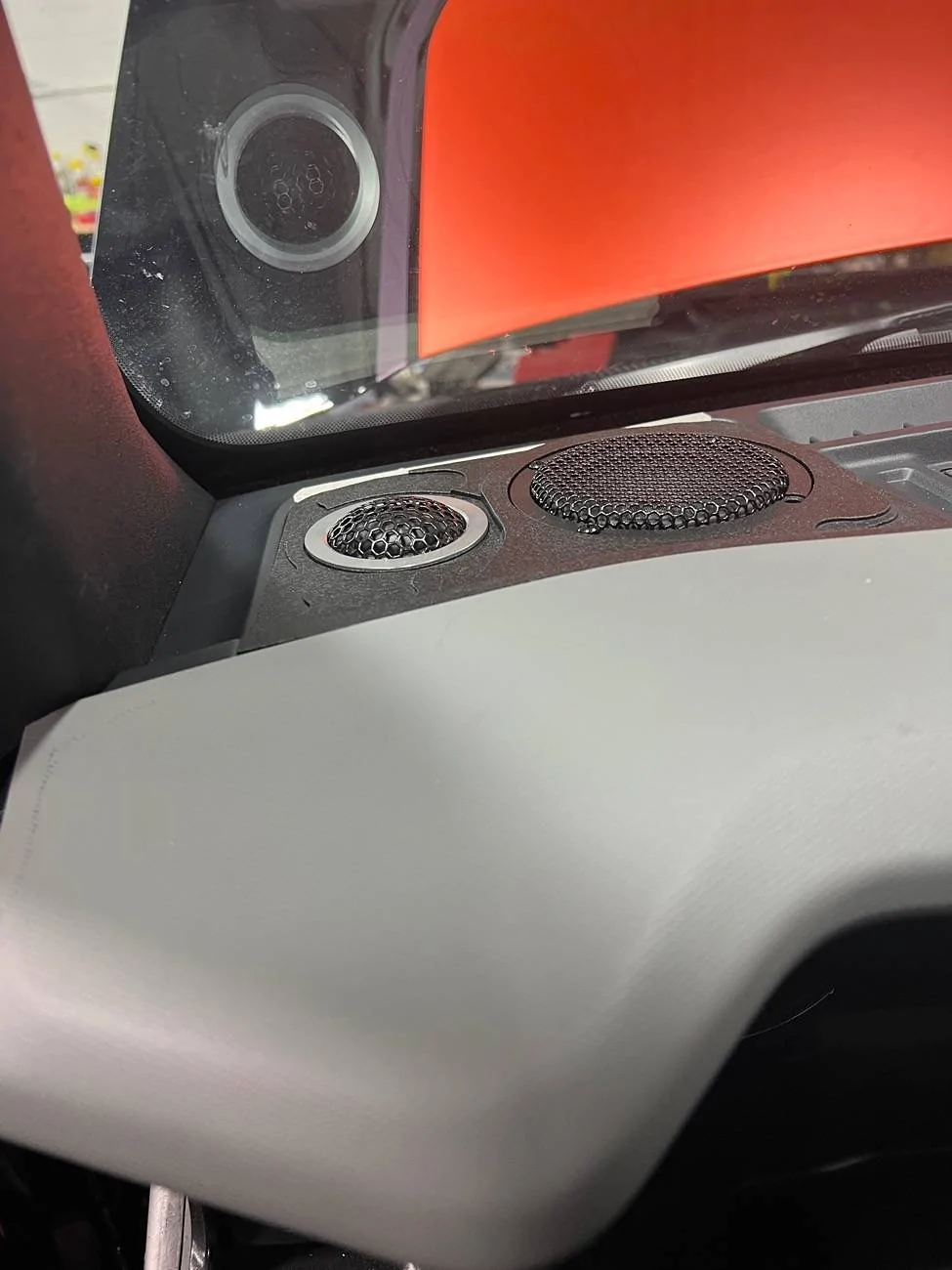

I listed the components and a few pictures

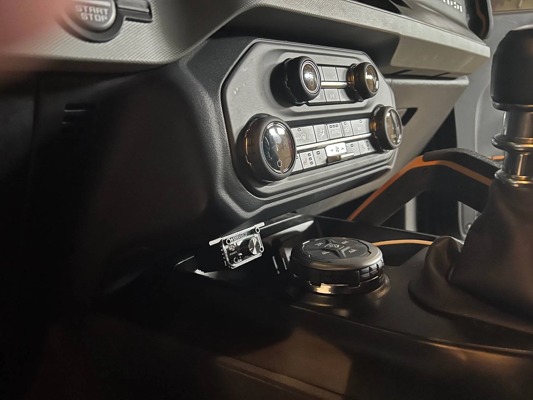

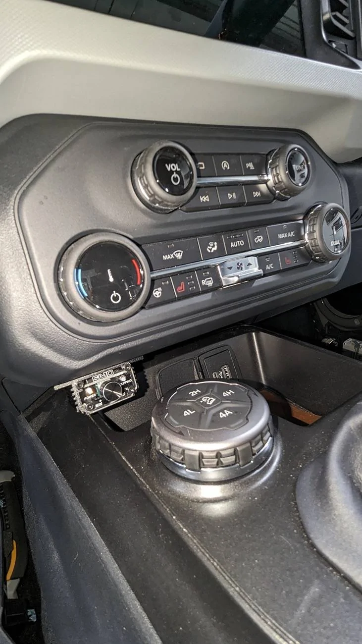

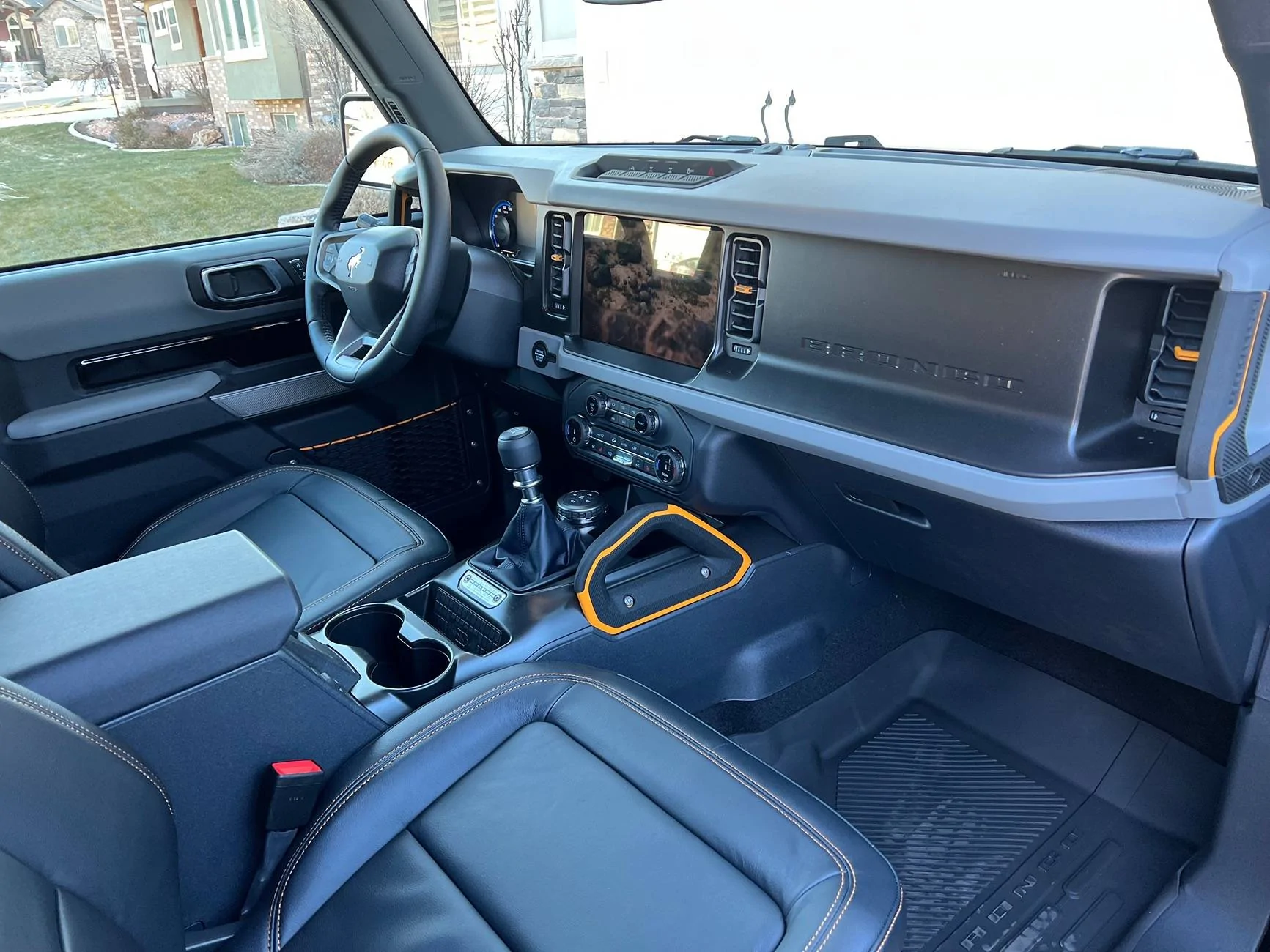

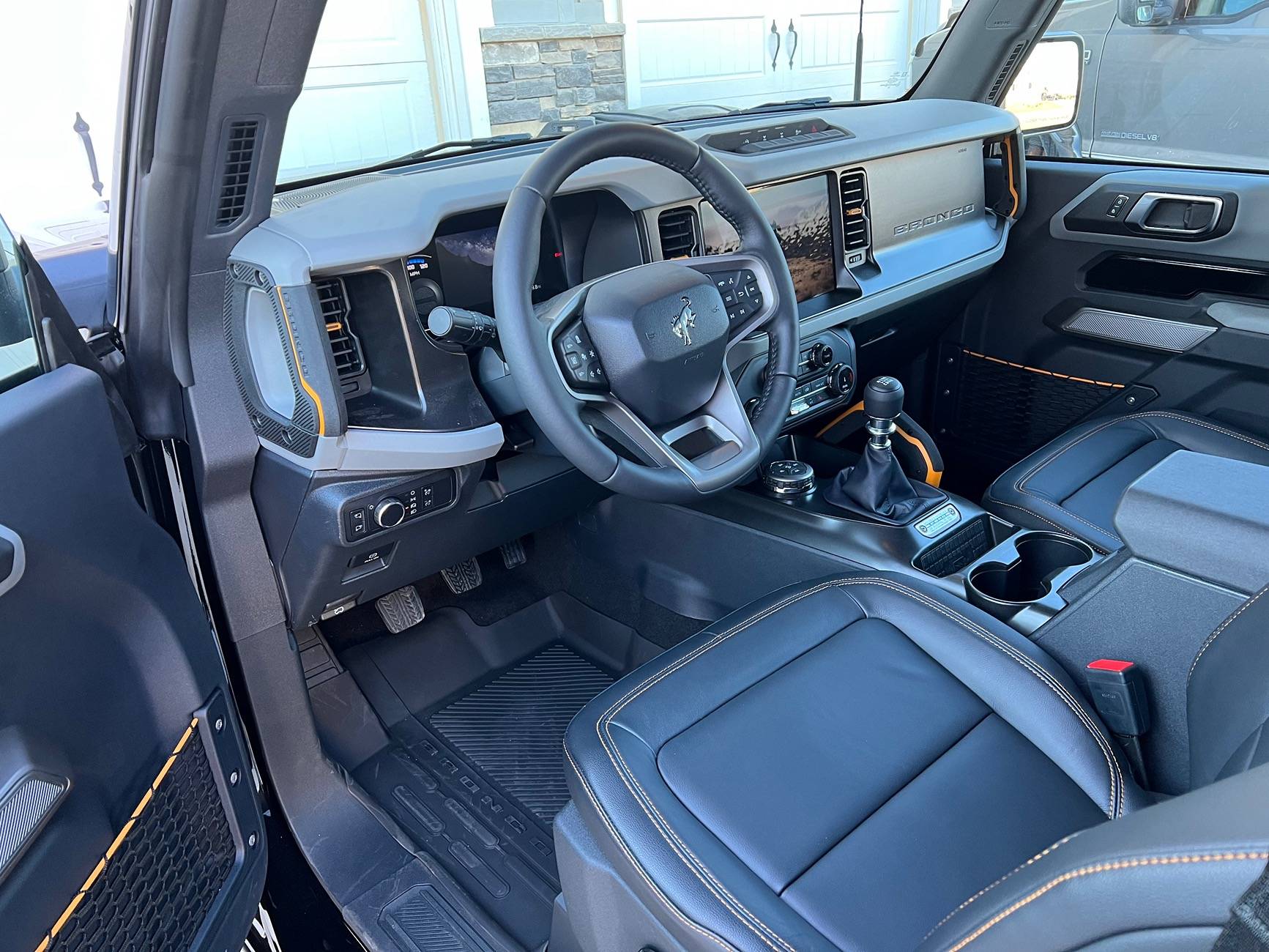

Is it my imagination or has the GOAT dial been relocated forward on the console?
More pics of what that’s all about please
Dawgzz
Jason Johnson
Apr 17, 2023
32
2022 Bronco
It has not been moved, this is where the GOAT mode selector is located in the 2 door with manual transmission.

I want to thank everyone for the input, the dsp was the issue. It was
Ford Bronco Upgraded Audio installer having issues IMG_4682
Ford Bronco Upgraded Audio installer having issues IMG_4680
Ford Bronco Upgraded Audio installer having issues IMG_4679
Ford Bronco Upgraded Audio installer having issues IMG_4678
Ford Bronco Upgraded Audio installer having issues IMG_4675
Ford Bronco Upgraded Audio installer having issues IMG_4676
Ford Bronco Upgraded Audio installer having issues IMG_4674
replaced the install has been completed
