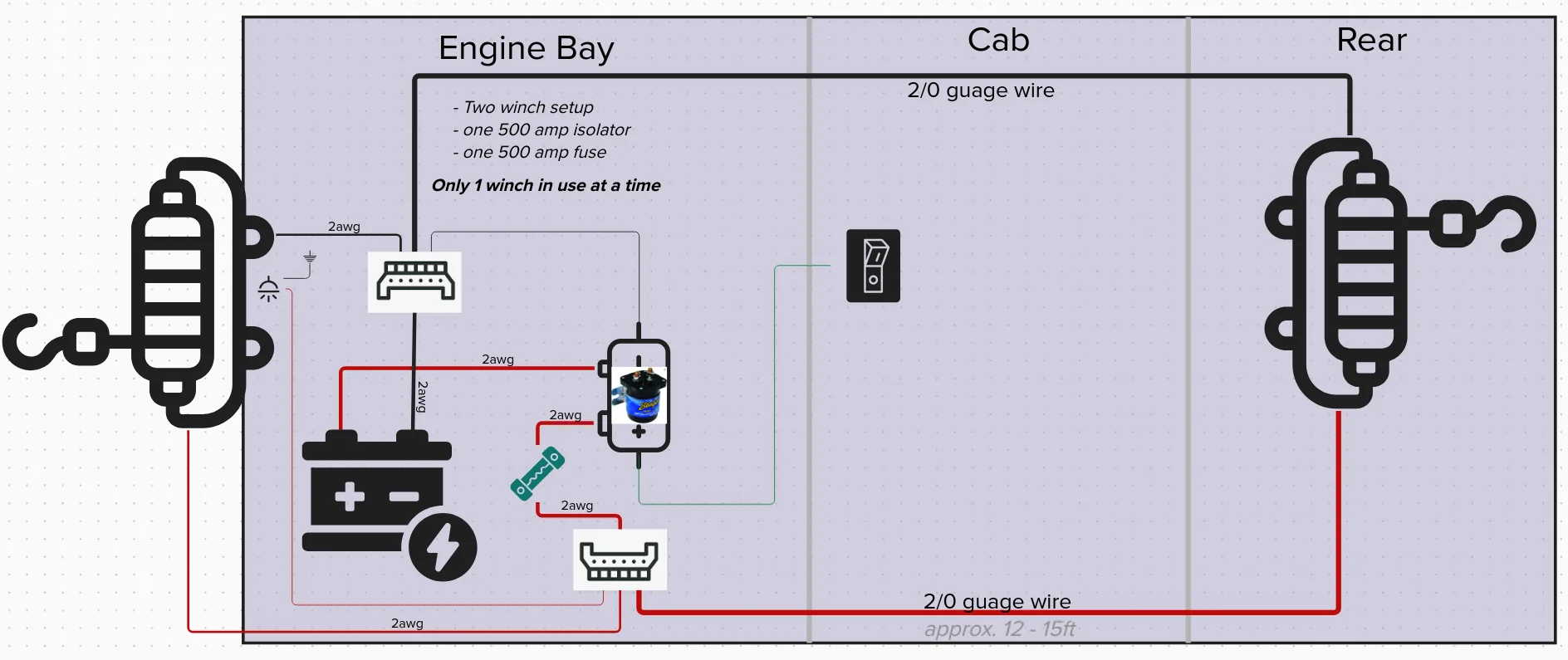

Thanks for all the feedback, here is a revised diagram
changes:
- added bus bars
- moved 500a fuse so its after the isolator
- smaller wire gauge in engine bay
Ford Bronco Two Winch wiring diagram Screenshot from 2025-12-16 20-14-35
No idea where im going to fit the bus bars, but that is a different problem.

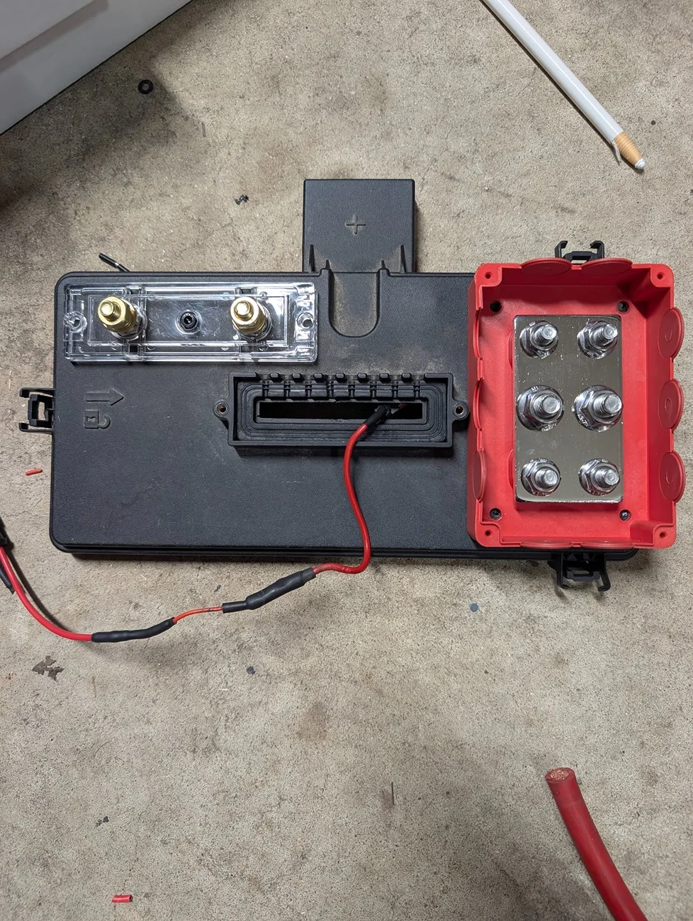

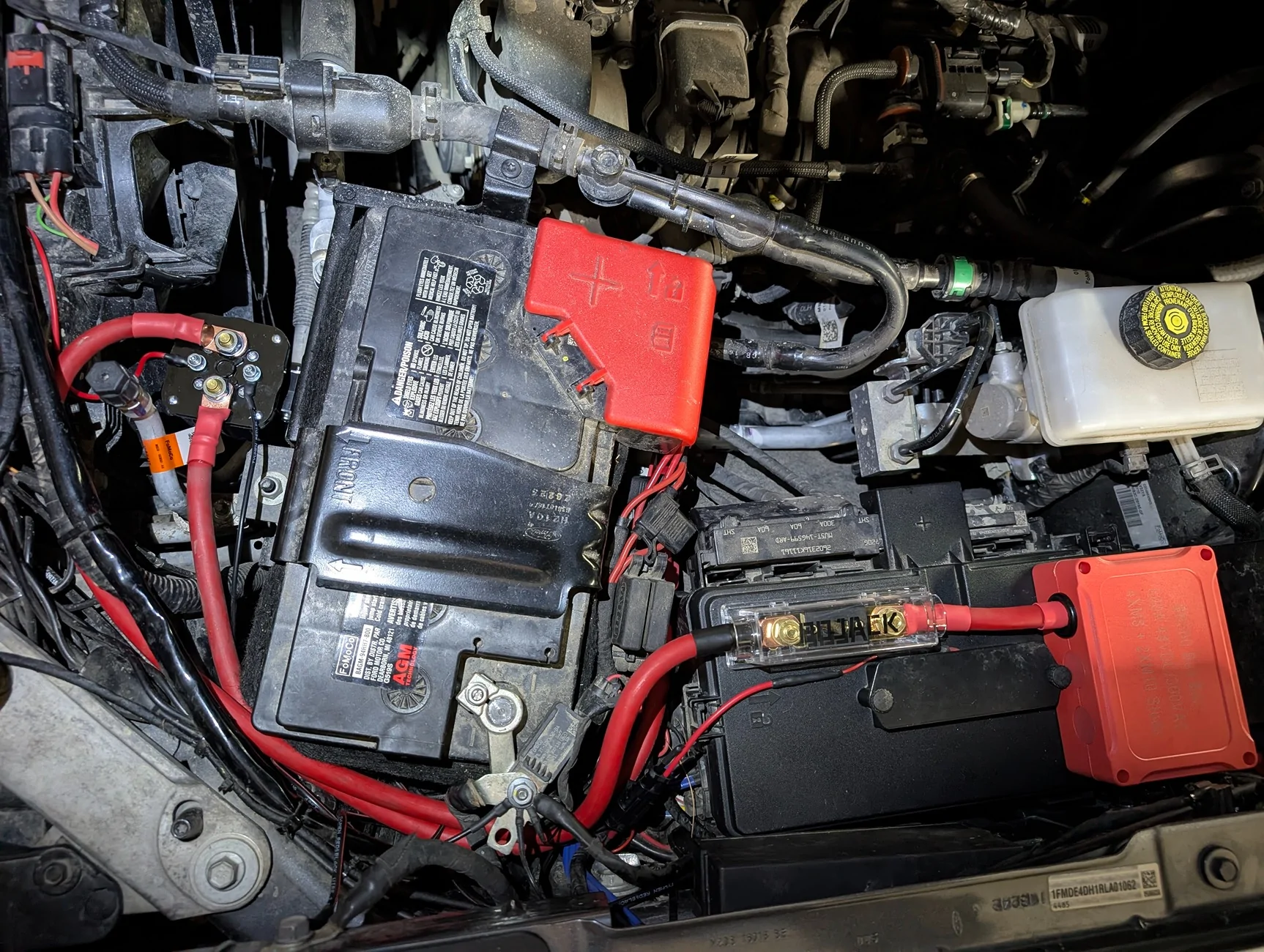

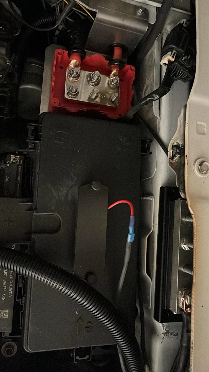

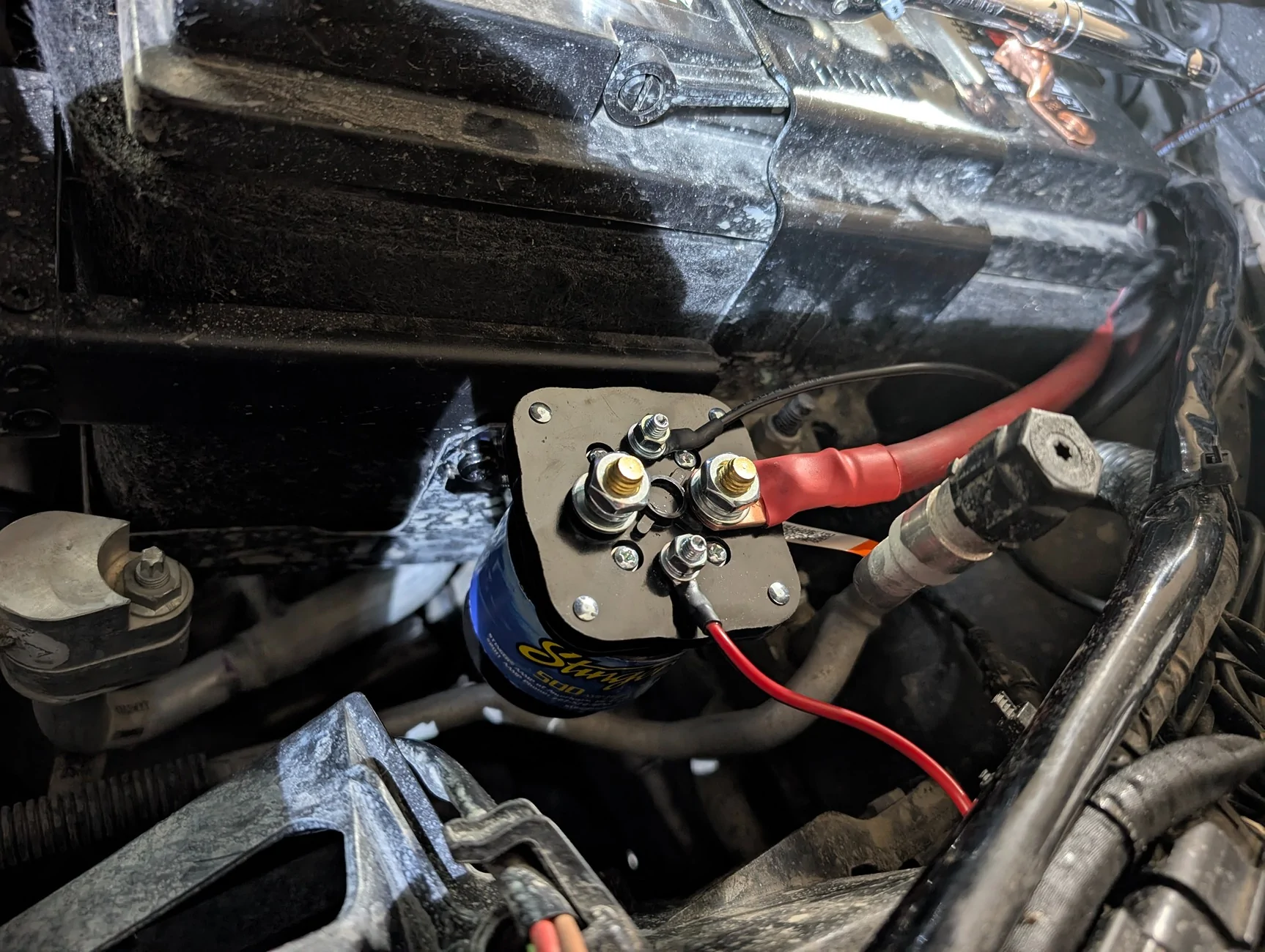

OP I got a tray from American adventure labs that tucks up by the firewall and holds a square distribution block nicely. For the grounds I put them next to the fender on the supporting structure. Adhesion promoter and quality 3M double sided tape will hold those without issue.
Ford Bronco Two Winch wiring diagram IMG_4137
Ford Bronco Two Winch wiring diagram IMG_4140

Regardless of method between relay and manual switch, either is better than how most run their winches. Assuming the power is off.
yup I got the same one but using it for aux switch rewiring

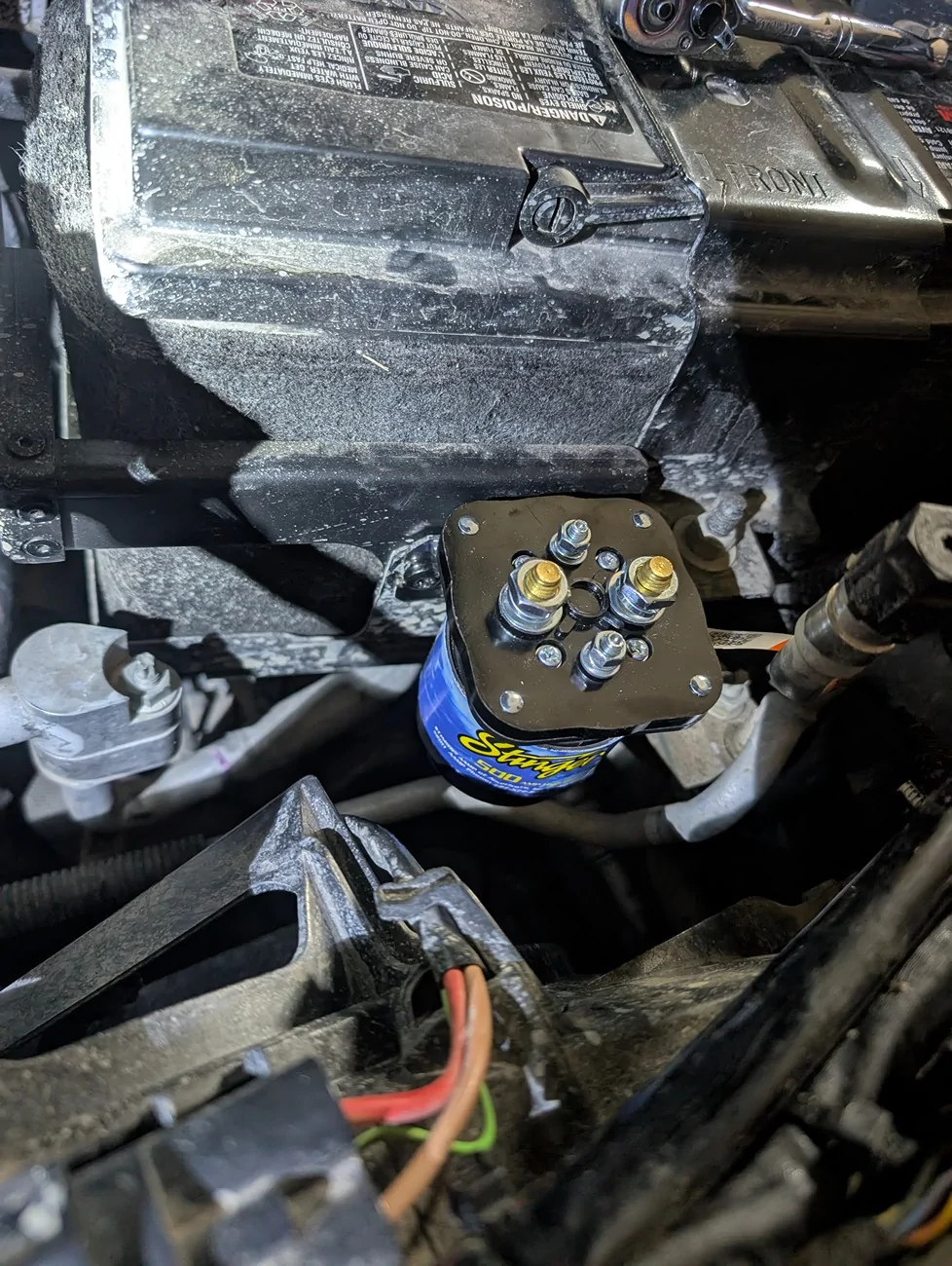

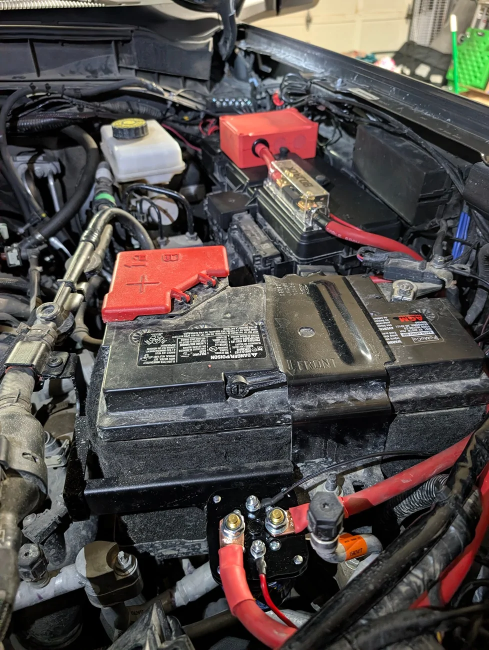

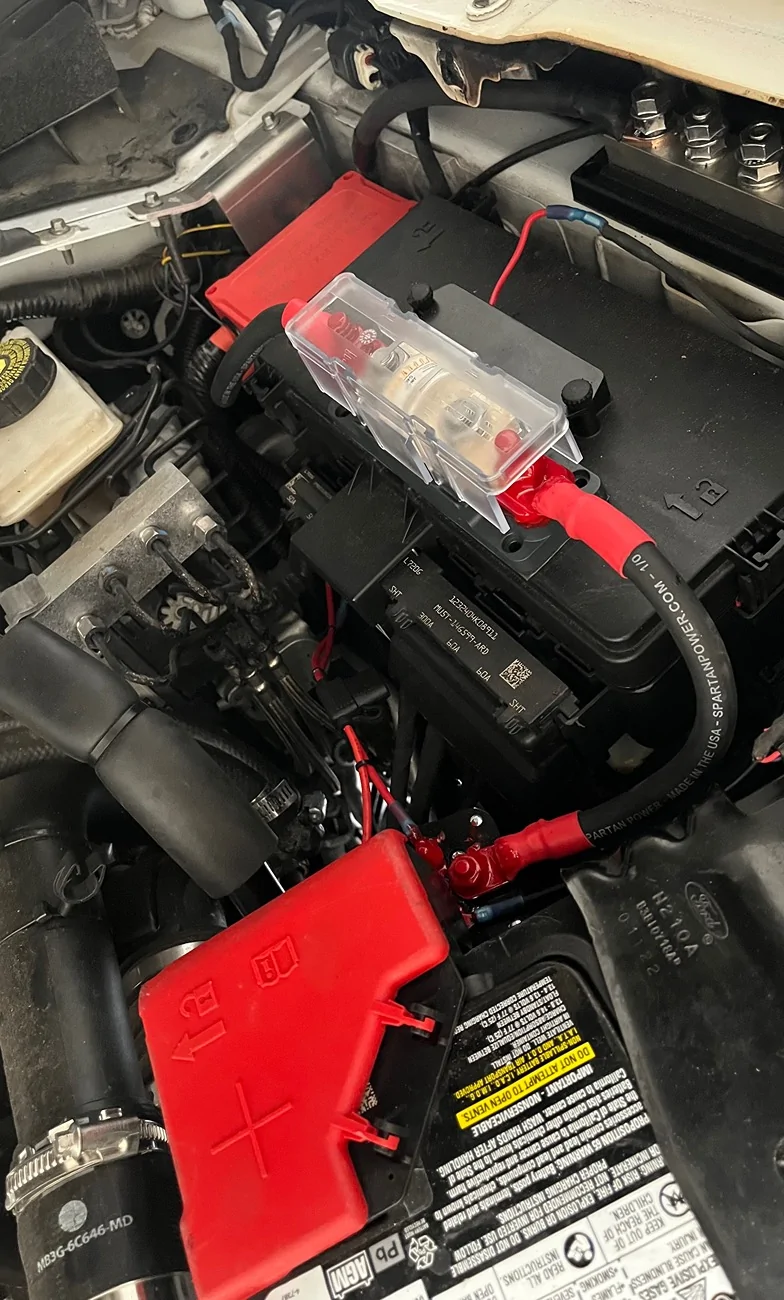

some preliminary wiring done
Ford Bronco Two Winch wiring diagram PXL_20251222_032432398
Ford Bronco Two Winch wiring diagram PXL_20251222_191318167
Ford Bronco Two Winch wiring diagram PXL_20251222_210149444
Ford Bronco Two Winch wiring diagram PXL_20251223_003848048
Ford Bronco Two Winch wiring diagram PXL_20251223_004506156

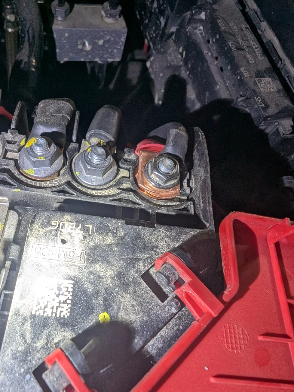

only odd thing I ran into was the battery lug didn't make good contact with the terminal so I added a copper washer (which is just a lug trimmed up, here is a photo for reference
Ford Bronco Two Winch wiring diagram PXL_20251223_004521046
SierraBronco
Mar 27, 2024
5,283
14,271
Is that an ANL fuse?

it is yeah
It’s probably fine, just check your specs and AIC. In a worst case scenario the factory battery might be able to exceed the AIC on some of the ANL fuses sized appropriately for a winch.
