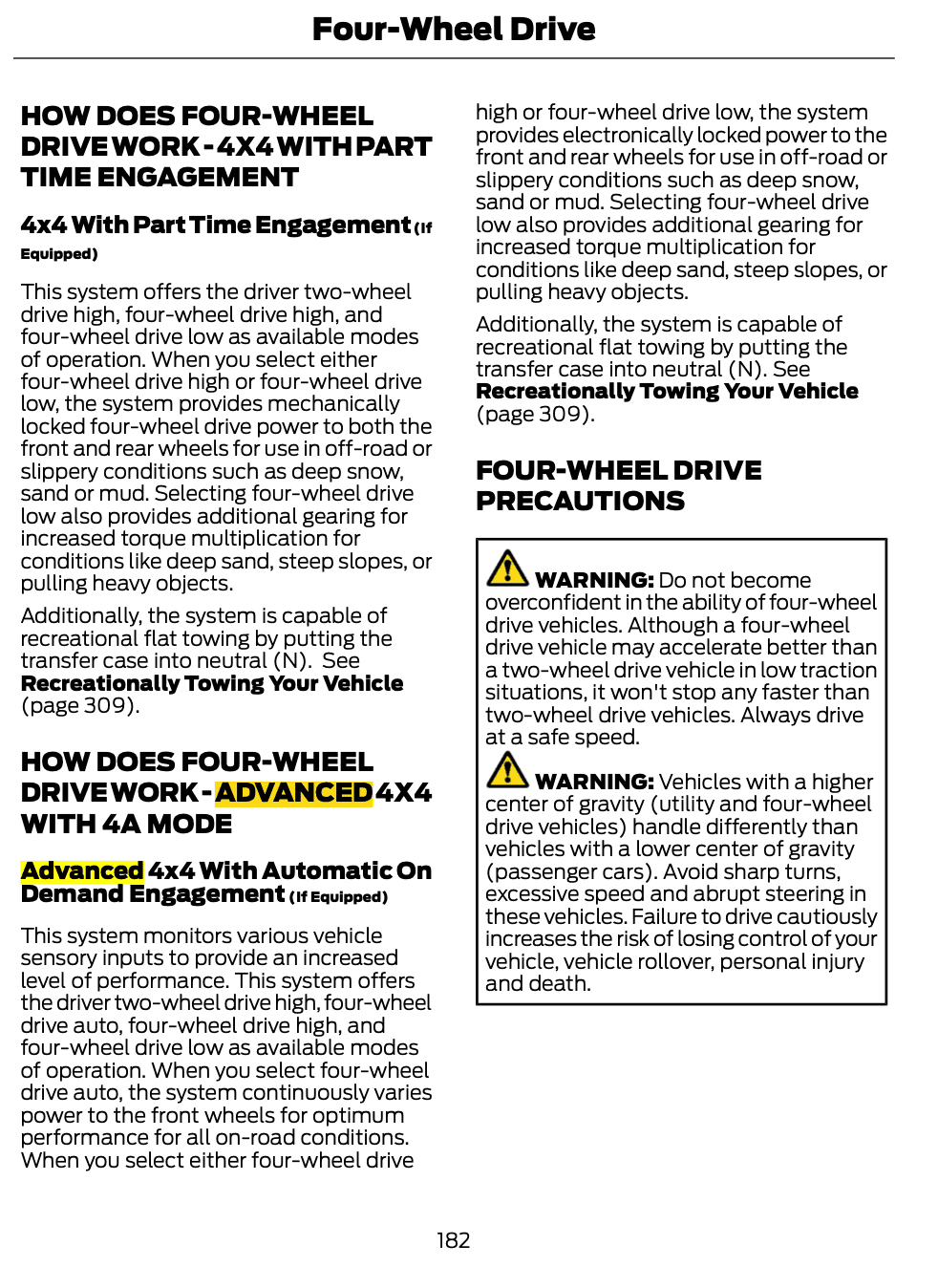

This is just flat out wrong. It will automatically shift into 4 High. It is not an AWD system. People will get themselves into trouble if they think it is AWD. Some people on the message board already have ended up on their lid by making this incorrect assumption.
This would argue otherwise...
