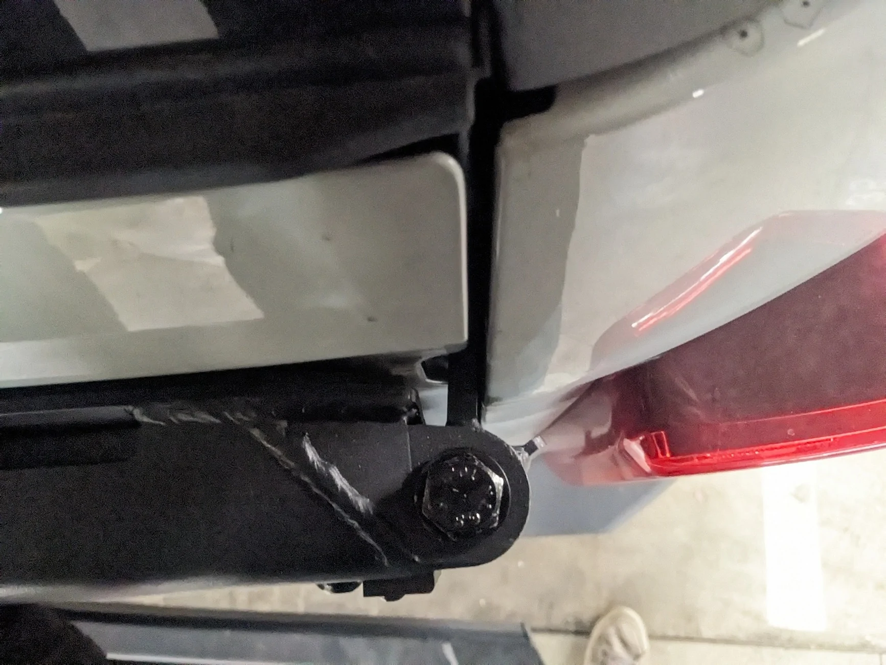

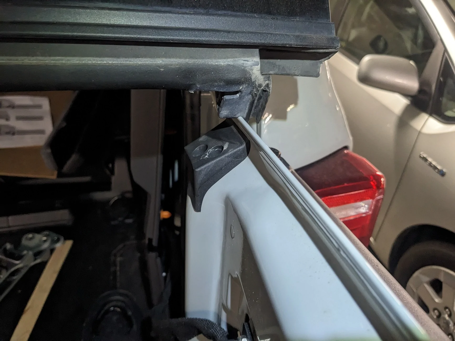

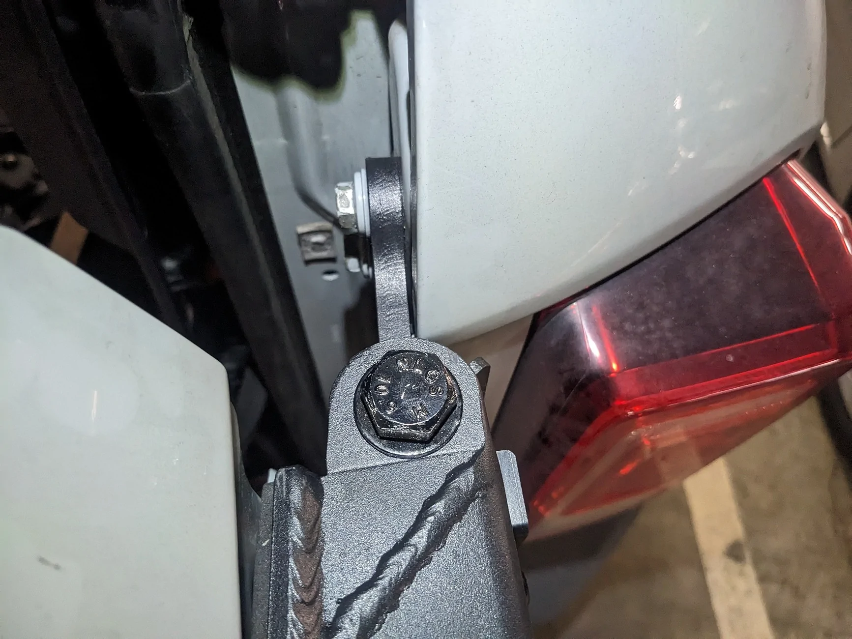

I wanted to see who else had any experience with the Turn Offroad tailgate reinforcement hinge. I ordered and installed one recently, and I found that I am unable to open the rear window when the tailgate is open to 90 degrees because the the rubber weather trim on the window hits the tailgate. The body lines and alignment are great, and the tailgate itself opens and closes perfectly. It almost looks like the hinge needs to be pushed out further outward on the passenger side, but it is already almost touching the rear quarter panel, and there is not enough room to adjust it in that direction. I have a 2 door 2024 Big Bend with a hardtop.
Does anyone have any experience with this tailgate reinforcement, know anything about potential issues with the rear window, or have any thoughts on possible adjustments? Is there anyone that can comment on whether this particular tailgate hinge works with their hardtop without any issues?
Yup that’s the way it is - have to open pretty pretty far to get the glass to clear. Just part of having that reinforced hinge plate unfortunately.
