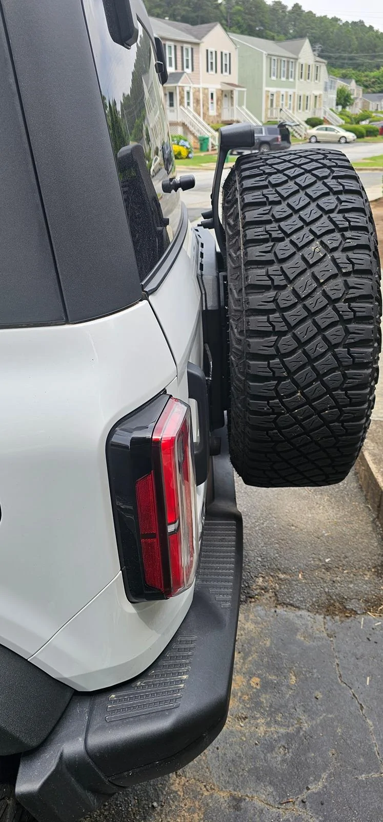

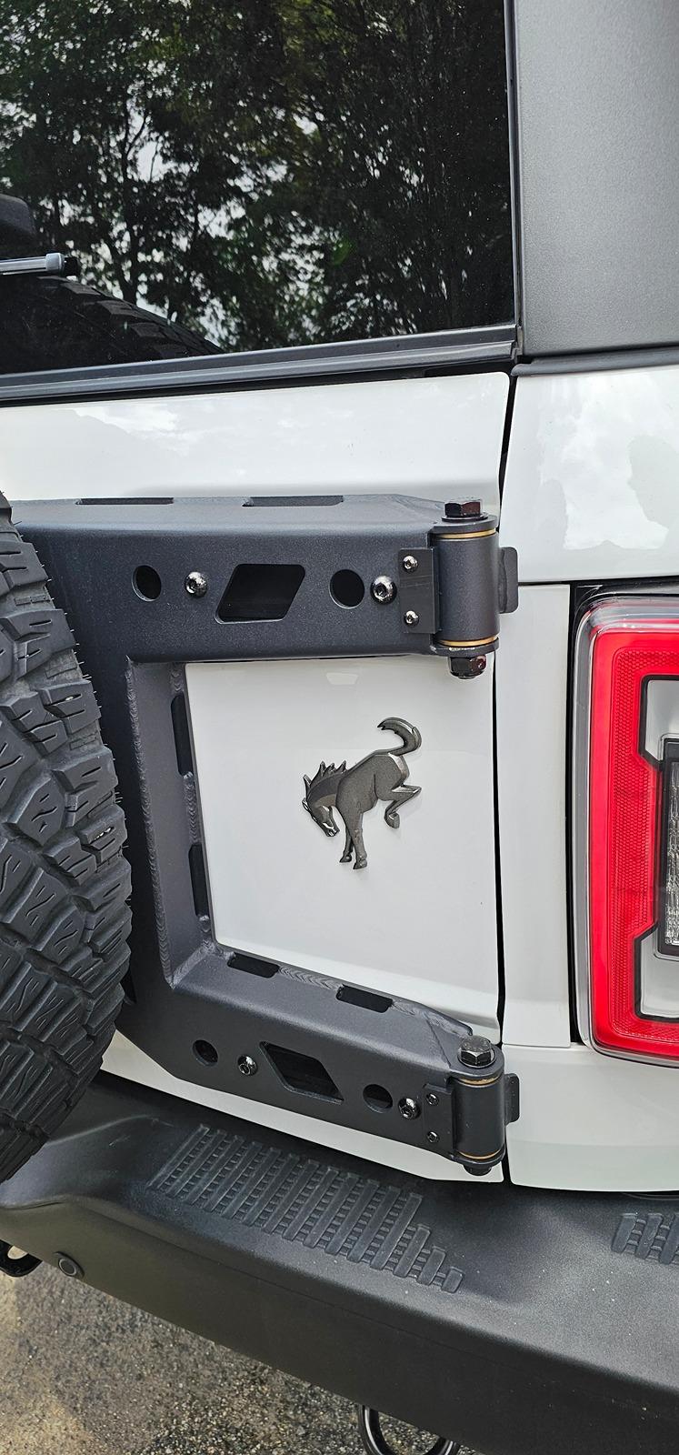

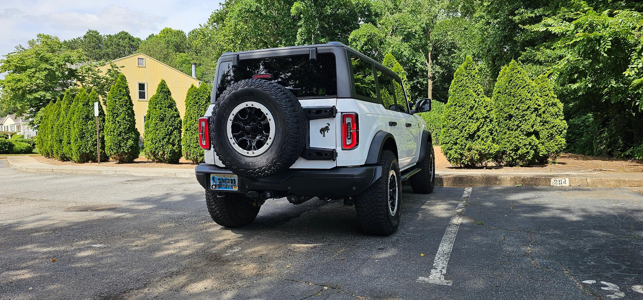

I took mine to Uwharrie and went over obstacles, slow fast etc. It didn't rattle, bounce, squeak etc. Eventually I'll add the adjustable mount, but it's certainly not necessary. It shuts as easy as stock. The modularity is awesome. I'll add the adjustable mount and rotopax later.
