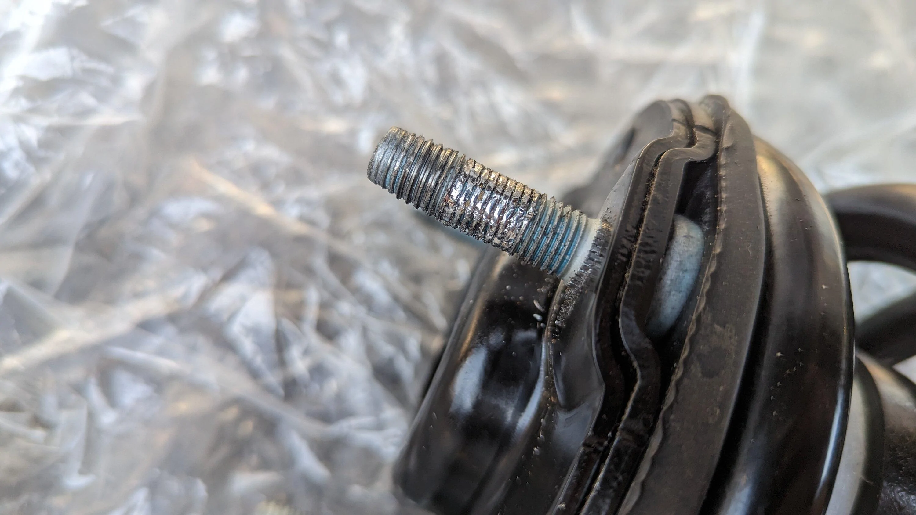

Assembly was going too smoothly until I went to tighten the top nuts. Stripped out the knurls holding the studs in, then trashed the threads trying to hold the stud and get the nut off.

Next time drill a 1/8 hole in the nut and use a center punch to split the nut.
I wanted to save the nuts because I have a spare top hat but no spare nuts. So right now tack welded the studs in and waiting for paint to dry.

Your cheaper than me lol
The nuts didn't want to go back on anyway so I ended up using the ones that came with the spacer kit (which I only used the rear spacers).

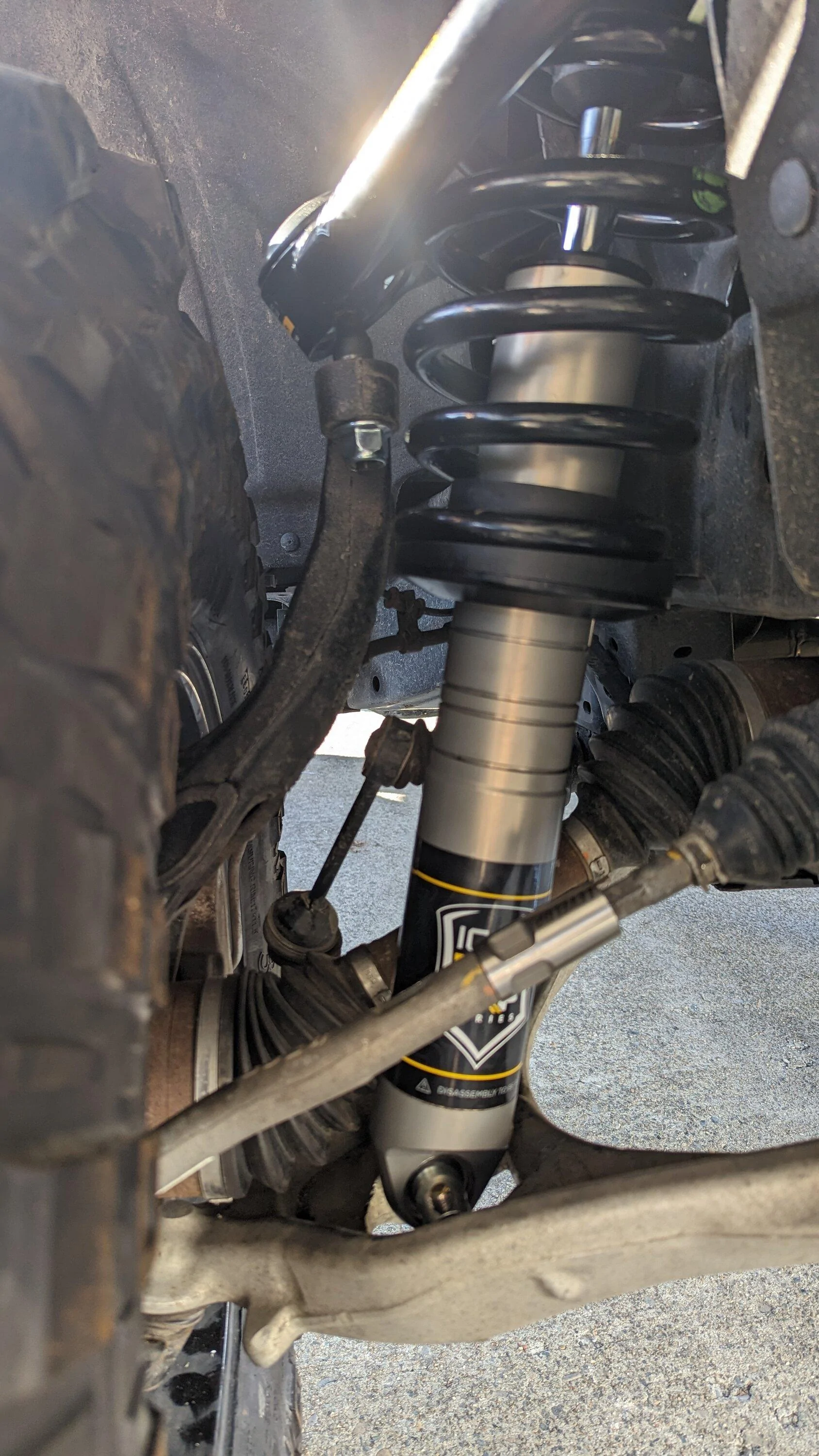

Beer break!
This is full droop, but it looks like I'll have no tire to UCA/knuckle clearance issues with the so called 37x14.5s.
Level Up tie rod nuts, Icon tubular UCA, and EXP with V6 coils at the tallest setting.
