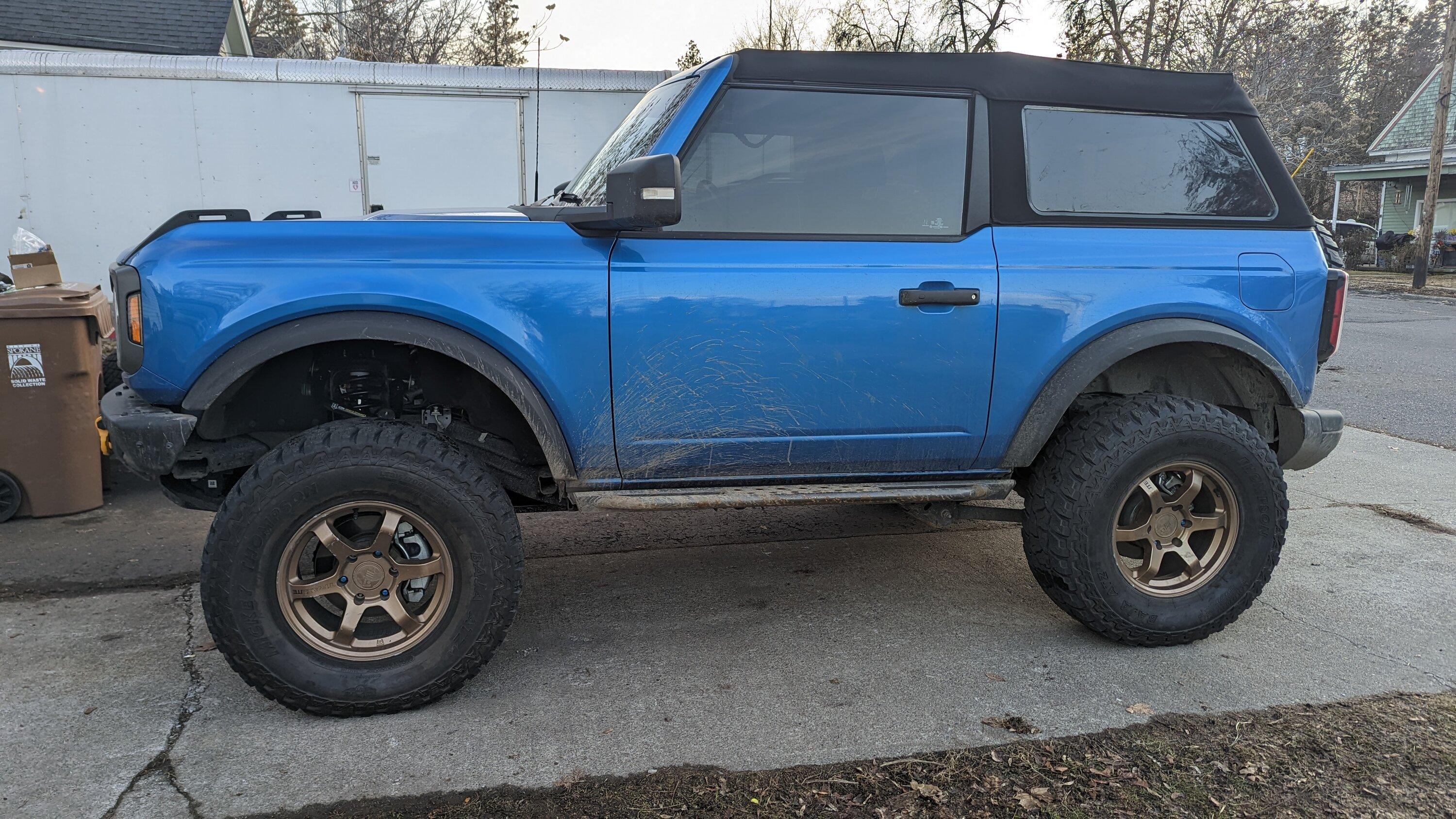

Something appears to have gone wrong. I'm at 27" from hub to fender up front and 25" in the back. Almost no droop left in front. The winch alone isn't going to drop it enough so tomorrow I'm going to try compressing the coils while installed and see if I can get enough slack to drop the C clip down to the next groove.
I have the V6 Sasquatch coils for the rear too and may need to install them but IDK if they'll fit on the BL shocks.

I think you need to raise the rear more, regardless of what you do up front.
Just for reference, I get to 29.75 inches at full droop. Is your sway bar connected?

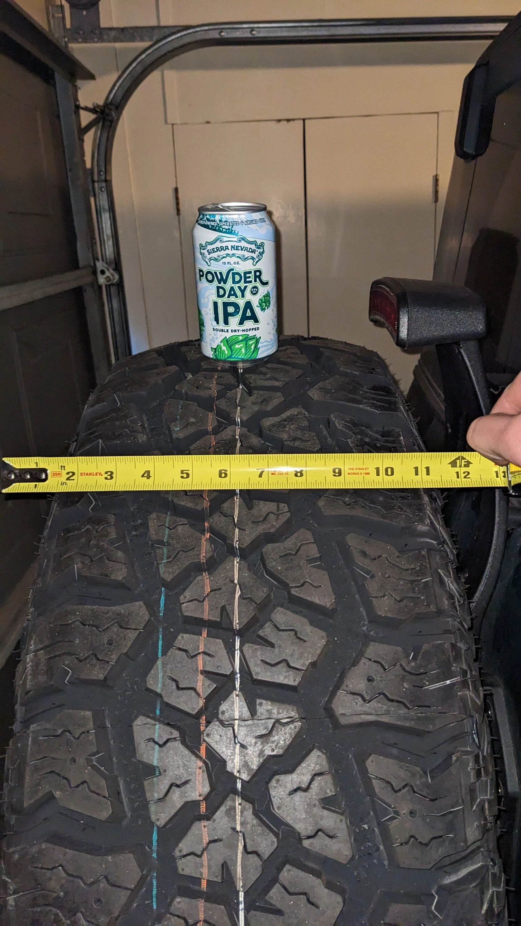

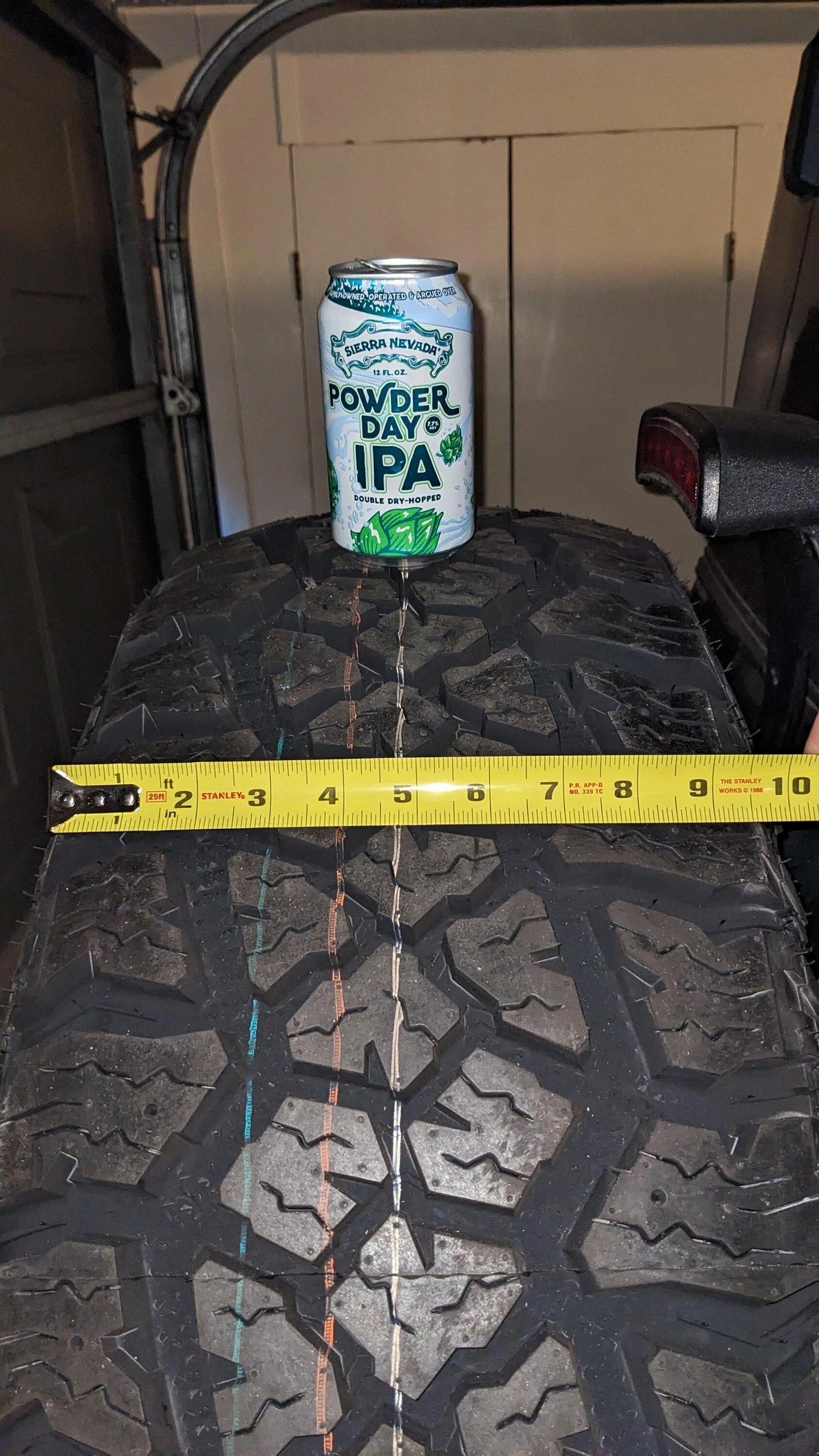

Let's see some tire measurements! My 12.5s are 9.5" wide at contacting tread and right at 12.5" carcass width.
Thats a great IPA you have there

Are those 4 door V6 springs? Looks like you netted 2" from just the coil swap.
Left over snow wheeling beer 🍻 figured I needed a reward for doing my yard chores.
They are. That did not work as intended. But I think adding the winch and moving to the 1.3" lift groove should get me to where I want to be.
I drove around the block and hit a few potholes and they did not feel harsh.

Ended up all the way down to the 0 lift groove to get to 26" from hub to fender.
@kodiakisland do you recall your pre-lift hub to fender measurement?
I'm drooping at 28.5, no swaybar.

I'm getting way too good at this. 20 minutes from tire on the ground, coilover out, adjusted, installed, tire on the ground. About to take it around the block and cycle the suspension a bit.

None of this adds up. After the drive I'm sitting back at 24" in front and it took a 1.25" spacer to get to 25" in the back. It looks really good though with 35s and is about 2" higher than stock, judging by fender gap.
So I'm going to drop them out again, and go back to the 1.3" groove.
