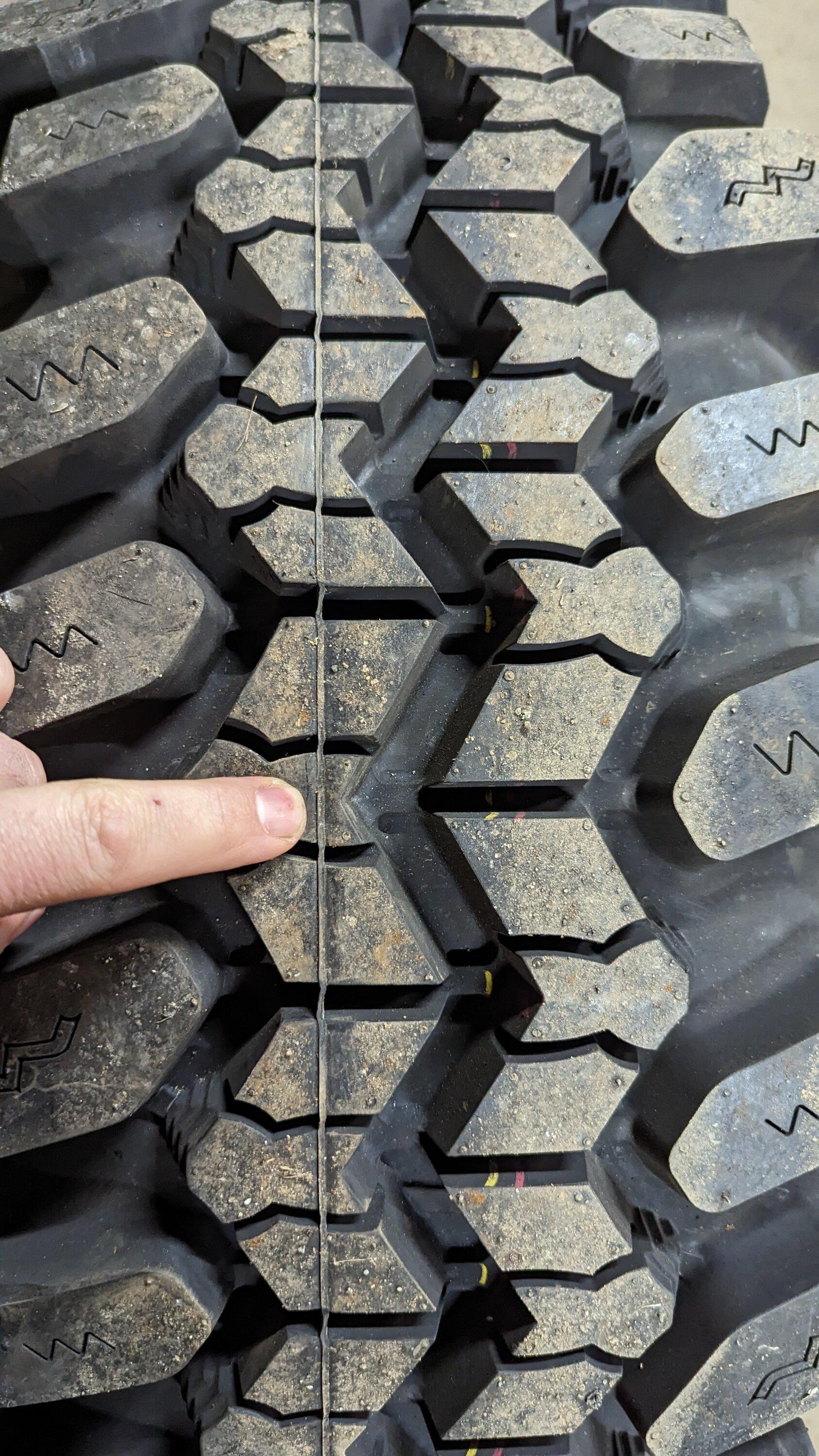

Wondering if that is why marked as blem?
Super swamper molds pre-date the current tire size system. They are their own size.
There was some rumors about Super Swamper getting new molds but they haven't released a new tire 10 years? Only new Sxs tires.

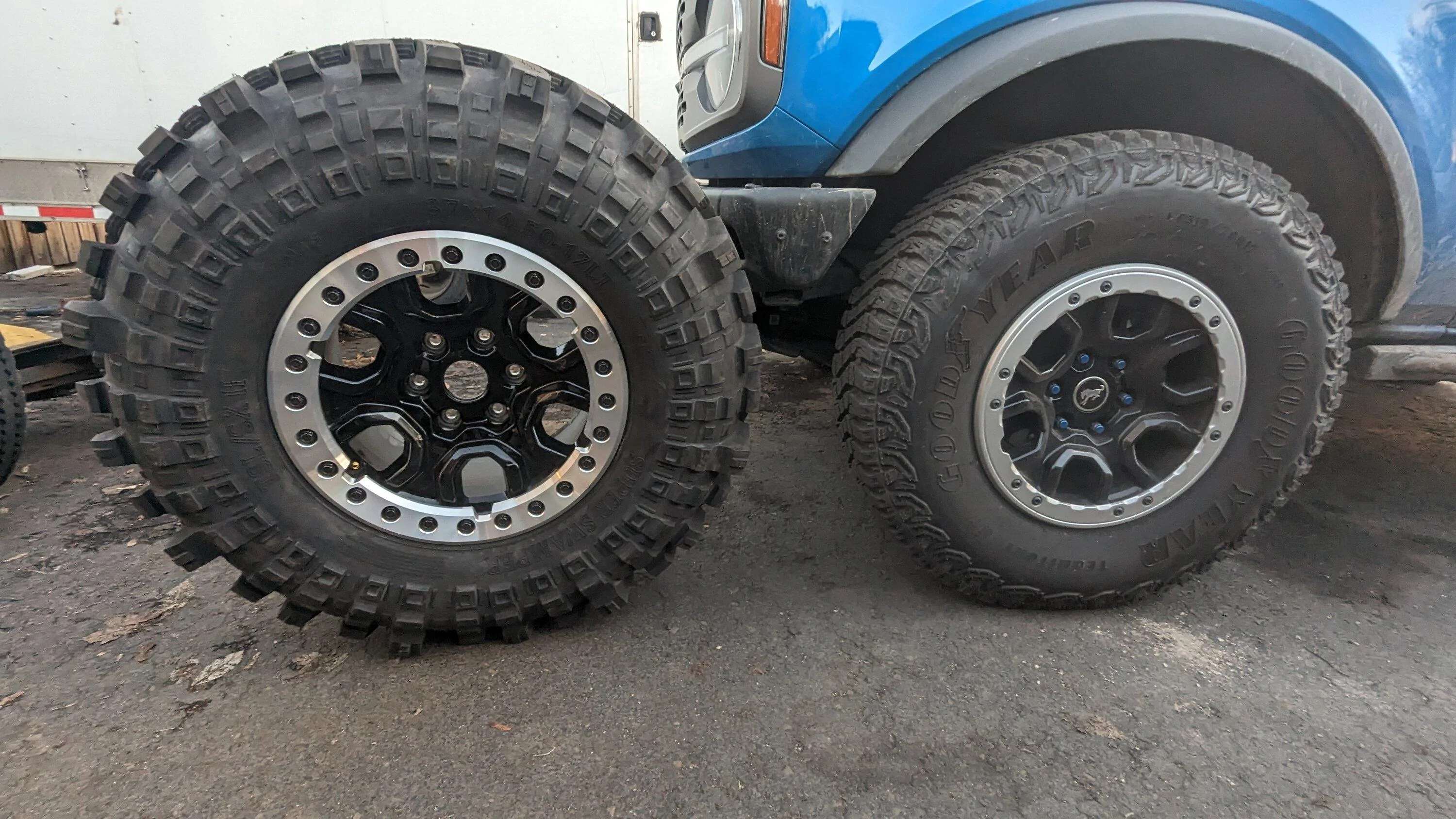

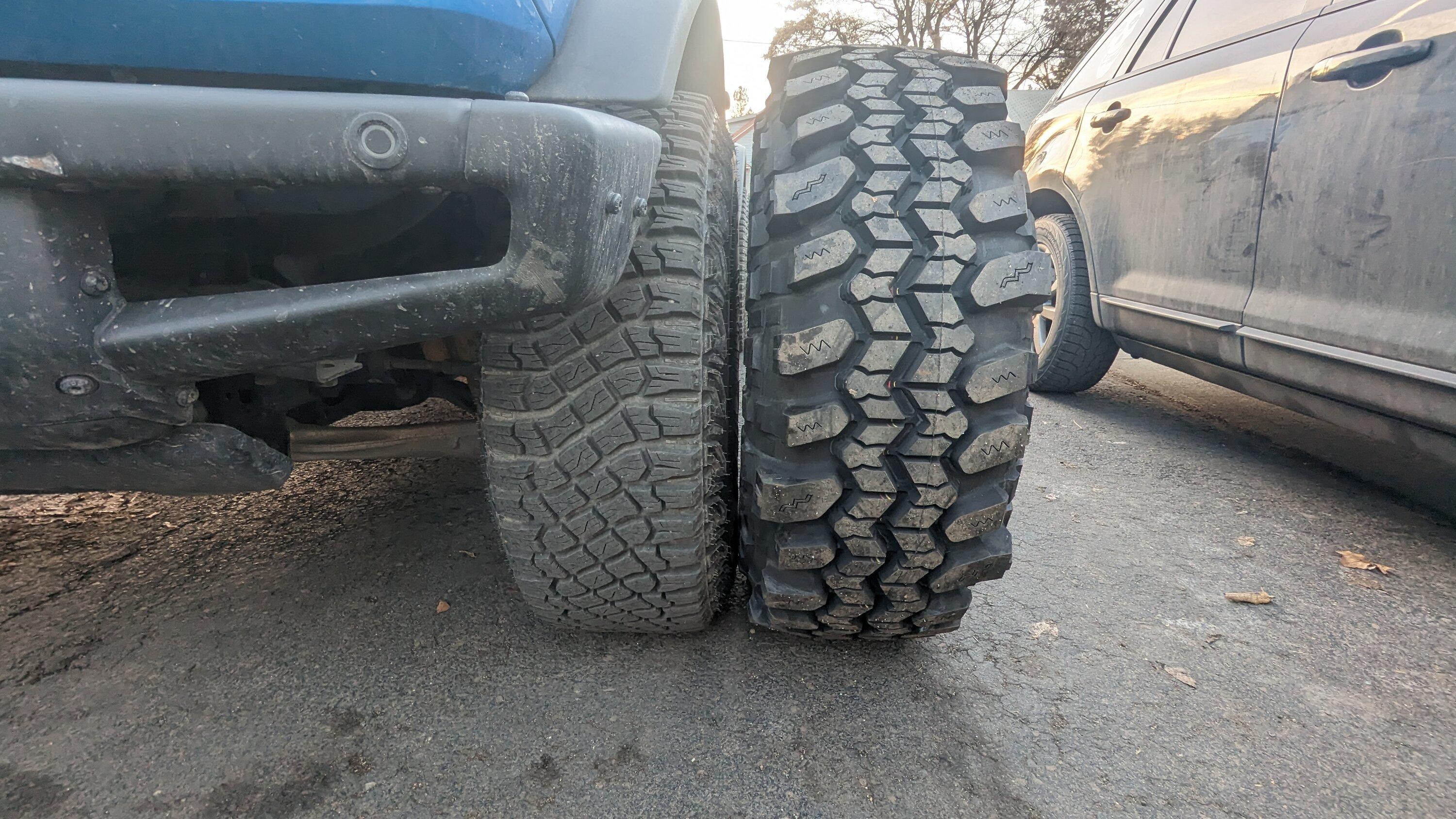

So they may be tiny 37s but Territories are tiny 35s so it's still a big step up.
Torquing these rings is unbelievably tedious. Supposed to get to 65nm. I'm made about 20 circles now and the bolts are still 10-15nm low by the time I make it back around to the start. Will I even get them done by May for Moab?
Ford Bronco Tricky Dick's Dirty Bronco PXL_20230210_004932346
Ford Bronco Tricky Dick's Dirty Bronco PXL_20230210_005020192

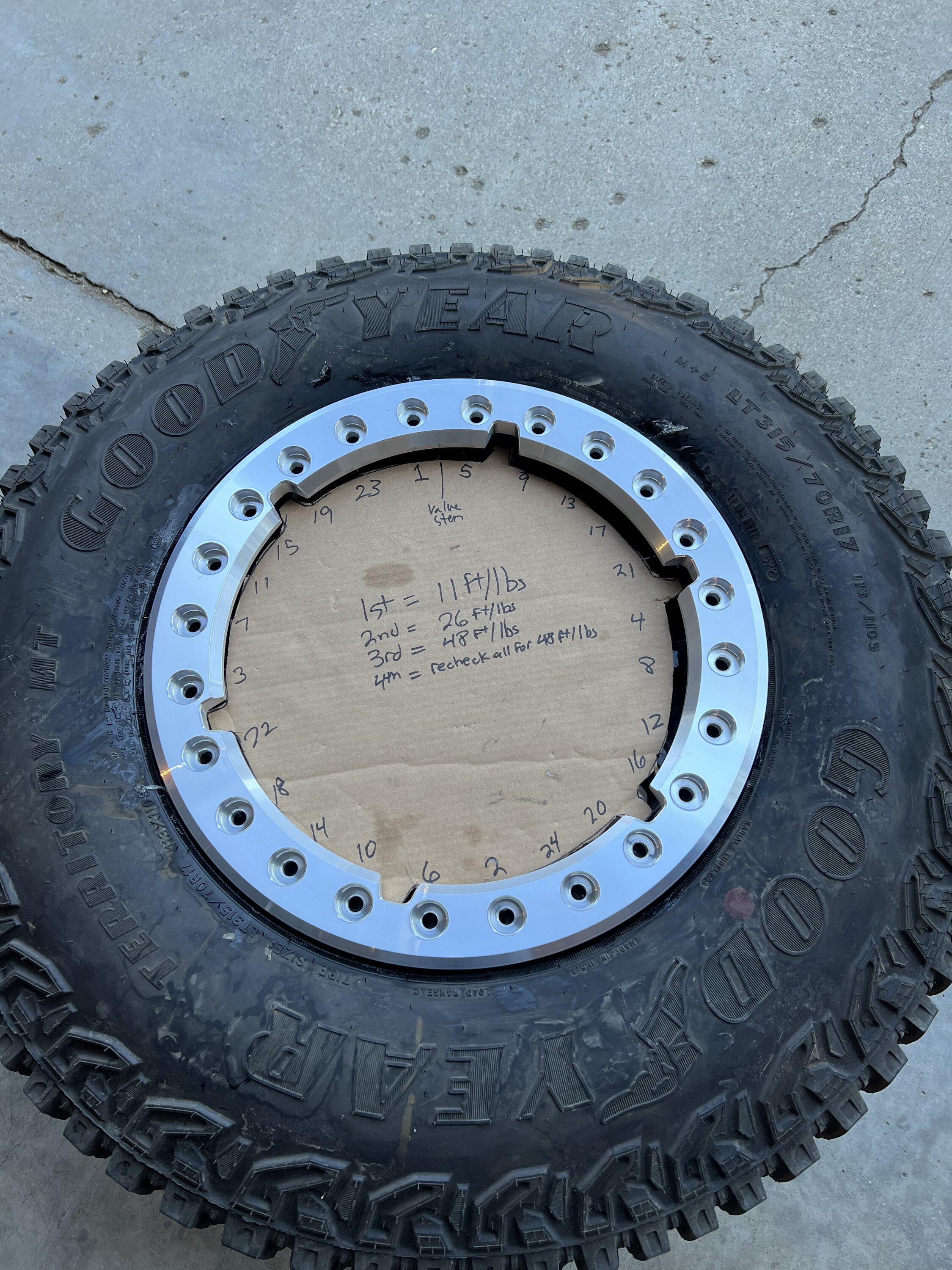

Not sure if this is helpful or not, you probably are using one, but if not, I made a template, seemed to speed things up.
Ford Bronco Tricky Dick's Dirty Bronco 93E37843-C6D1-4006-9544-85FBE83D6F58
