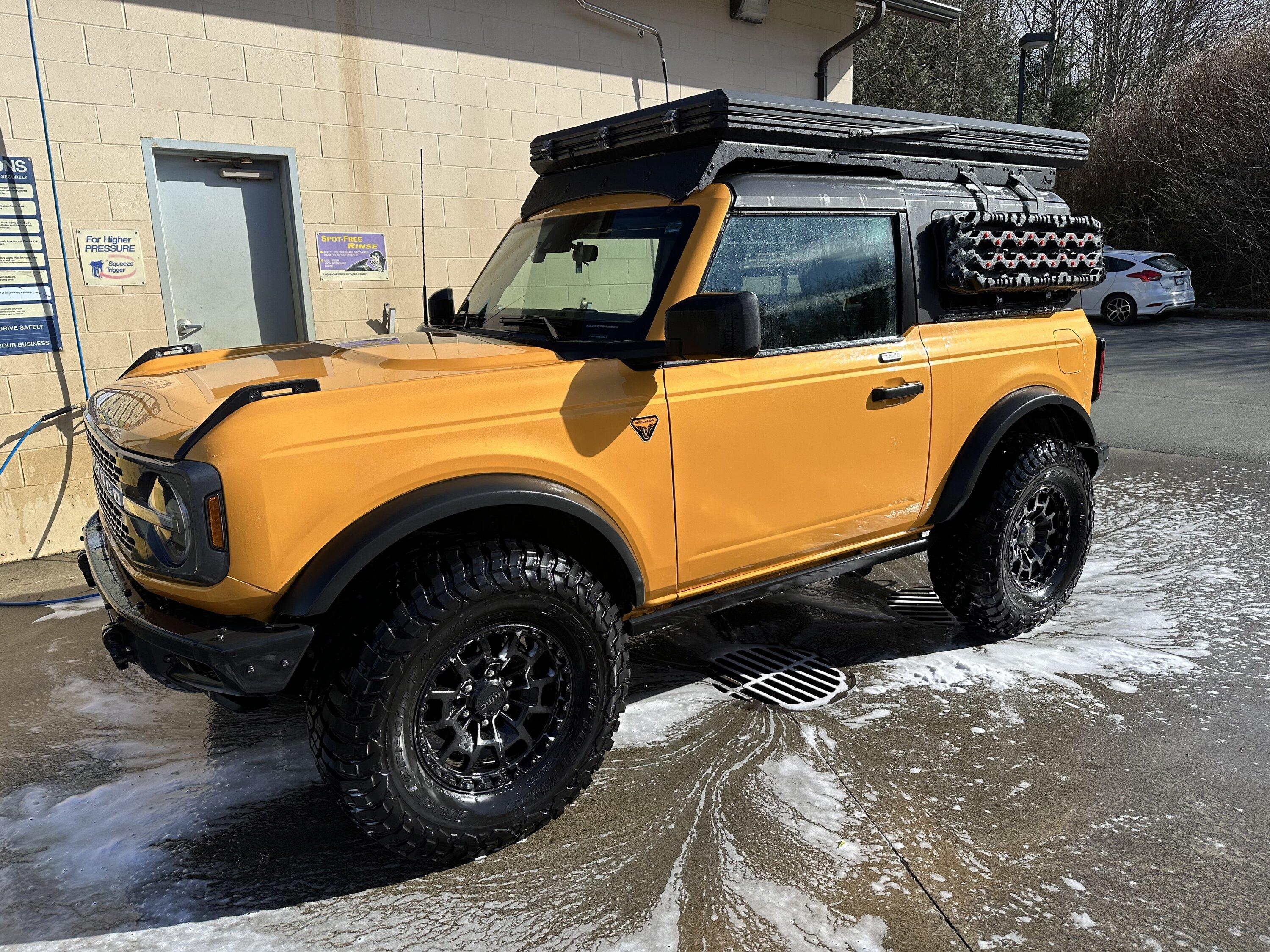

Just installed the Trailrax (with Pakrax) this weekend and got the RTT on top as well. Setup wasn't bad - the instructions on how to get the front mounts on really helped (even if my flex head ratchet never showed up from Amazon). I've got some wind noise to manage at the moment, but I think I can get something inbetween the tent and rack to help with that. Looking forward to exploring and camping!

It's an unbranded one from a local reseller - looks similar to the ones that come out of the CVT or Roofnest factory. I've got some work to do today as the wind noise and squeaks and creaks are reallllly bad. I should be able to take care of that with some foam or rubber and some pads for the tent.

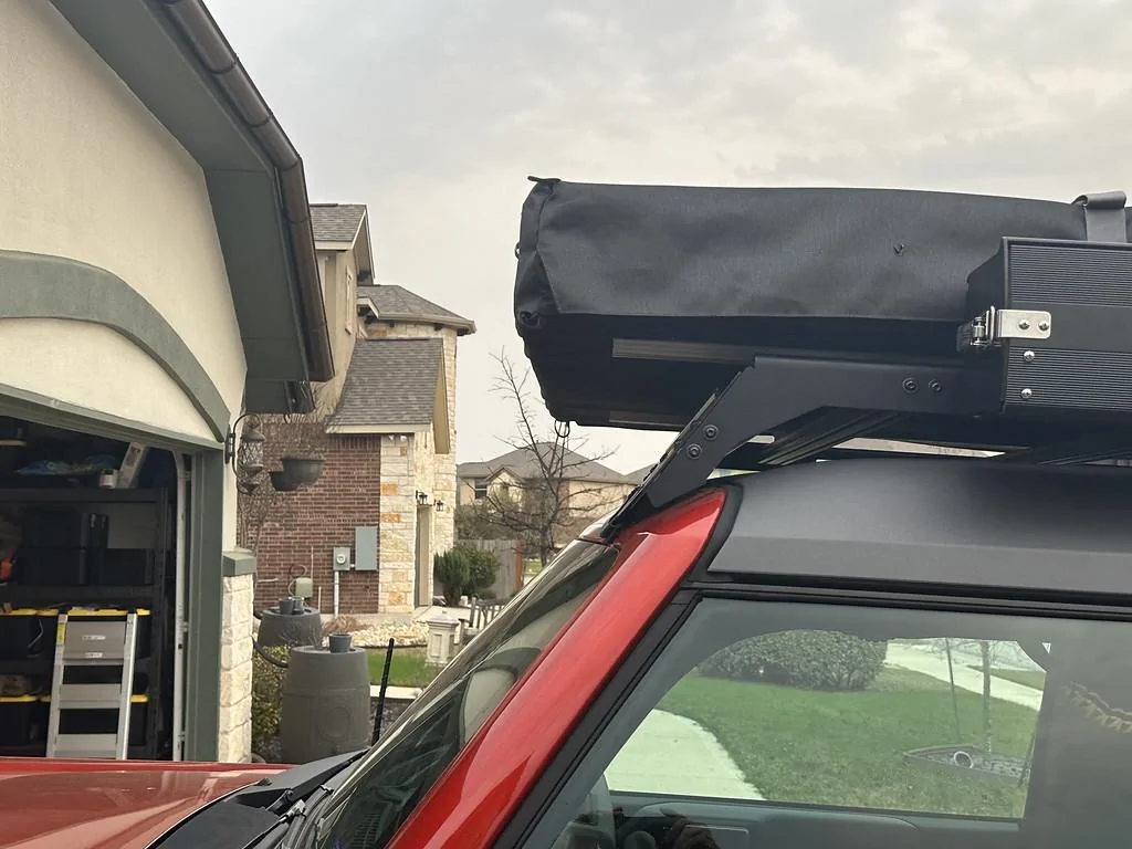

I had creaks and bad wind noise when I put my tent up on mine. From research, move the wind fairing up as high as it will go and put something (I used zip ties, others have used felt, velcro) in between the fairing and the side rails. Doing that fixed my creaks and a ton of the wind noise. Good luck and try those things first. I did put a pool noodle between the bottom of the tent and the wind fairing and that got rid of all the wind noise, I used wire through the middle of the pool noodle to tie it to the rack.

Thanks for the suggestions - I added a bunch of rubber spacers around the tent as it was resting on the outer rails. But there's something else making noise - so I'll keep investigating. It's quiet if I shake the rack or tent, but when I close the tailgate, it all rattles and squeaks. Wind noise is better after covering a few things - and yeah, I was looking at a foam type thing to put between the tent and the top of the wind deflector, so thanks for the idea.

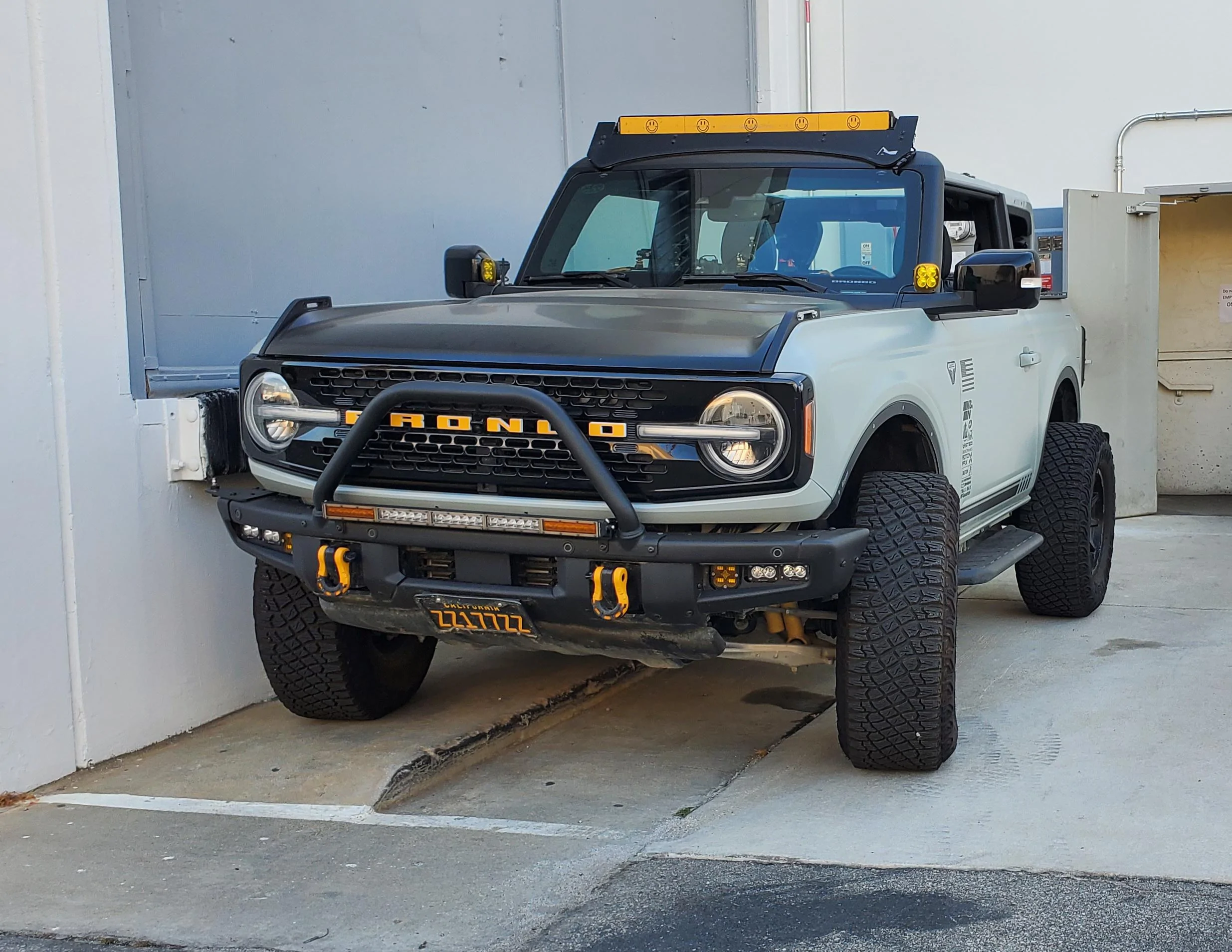

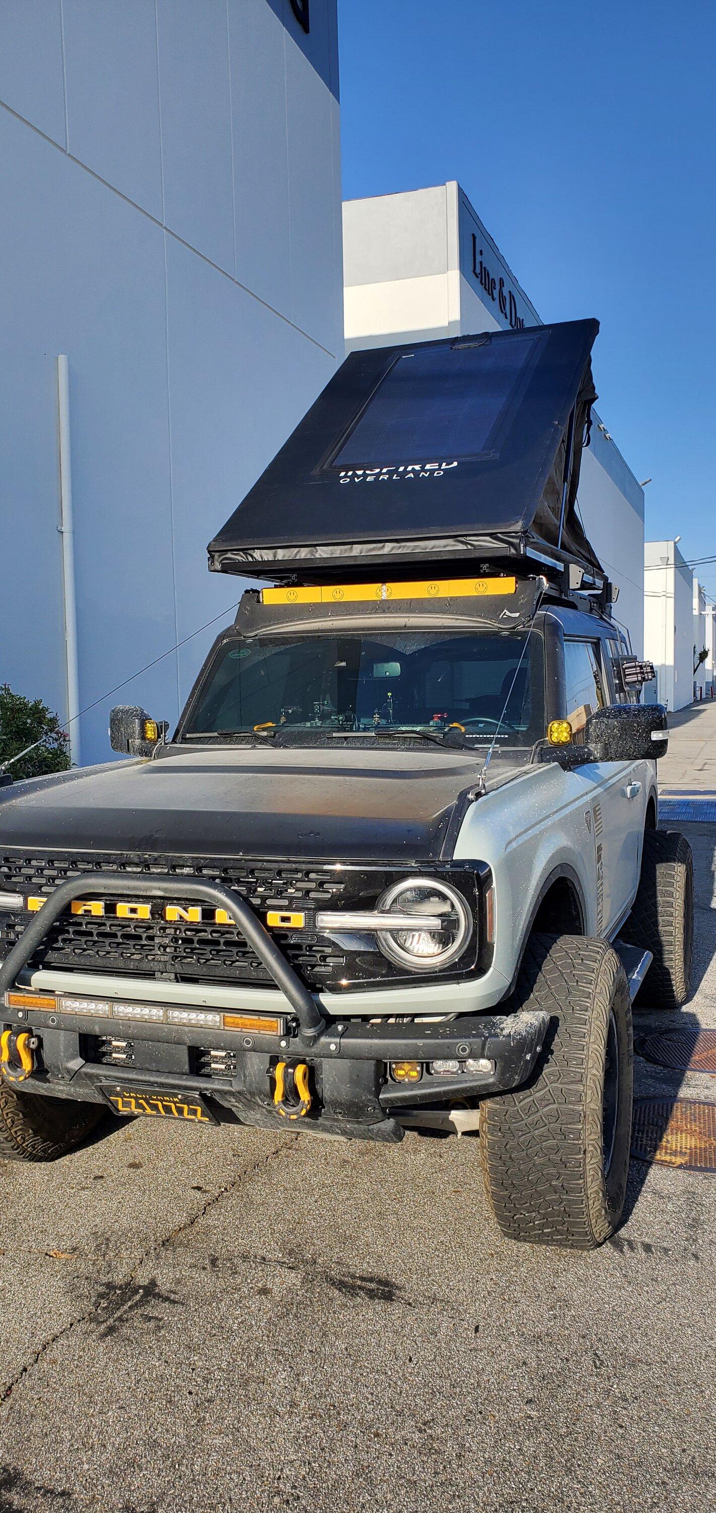

I put my RTT up recently. Due to the awning brackets, I had to raise the tent 1.5" to clear the brackets.
Interestingly, I don't have any rattles or squeaks, but there is a lot of wind noise on the passenger side of the tent.
Awning/RTT combo:
Ford Bronco Trailrax Real World Reviews? 20230517_180023
Front view:
Ford Bronco Trailrax Real World Reviews? 20230426_175032
Any ideas on how to attach a wind faring to this setup? The tent overhangs the roof line by 1/2 a foot, not enough to be able to see it from the inside, but enough to make a solution to this harder than necessary.
Thanks in advance!

To help with wind noise, you will want to push that tent back so that there is no over hang above the wind deflector, when that happens, you are basically adding a parachute to your Bronco where wind gets caught up. This could also be the reason you hear creaking, the tent is getting pushed up by the wind. Let us know if this helps!

Same situation for you, if you can get the tent to scoot back to where the objects on your roof do not over hang the front of your rack, you will experience better MPG, less wind noise, and less rack flex and rattle. Hope this helps!

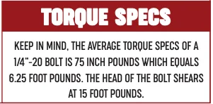

I installed mine a few weeks ago. Quick thoughts:
  • Installation of this erector set of a rack was relatively painless.
  • No directioin on torque values, even when I requested them. I found that a bit odd for a piece of equipment where improper installation could have catastrophic consequences for others.
  • Their direction on torquing the front mounting bolts was so sketch... something to the effect of using needle nose pliers to torque the nuts. This is one of the more important attachment points. I want a torque wrench on those nuts.
  • If you loosen and slide the wind fairing to the side you can access those attachment points with a regular socket and torque wrench.
  • The only thing on mine right now is a 4 rod caddy from Thule and a fork mount bike rack. It may also see a few dry bags occasionally.
  • I've done plenty of off road driving in the last few weeks. No rattles / noise.
  • It does create wind noise at highway speeds on a windy day.

Thanks for your feed back and thank you for your business, sorry about the toque specs, I will attach them below from our install instructions from our site! While there is no specific torque spec on the bolts we use described in the instructions, snug is best practice and to stay within the torque specs of the 1/4-20 hardware since that is what we use on 98% of this rack.
Let us know if you have anymore questions, happy to help!

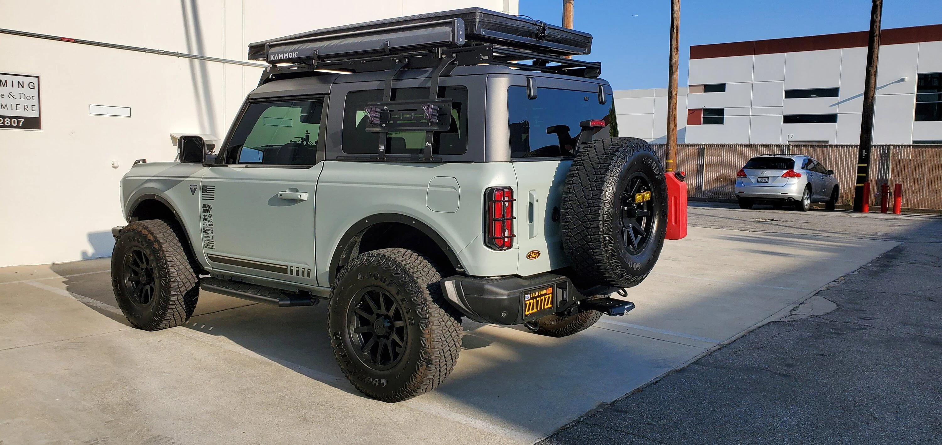

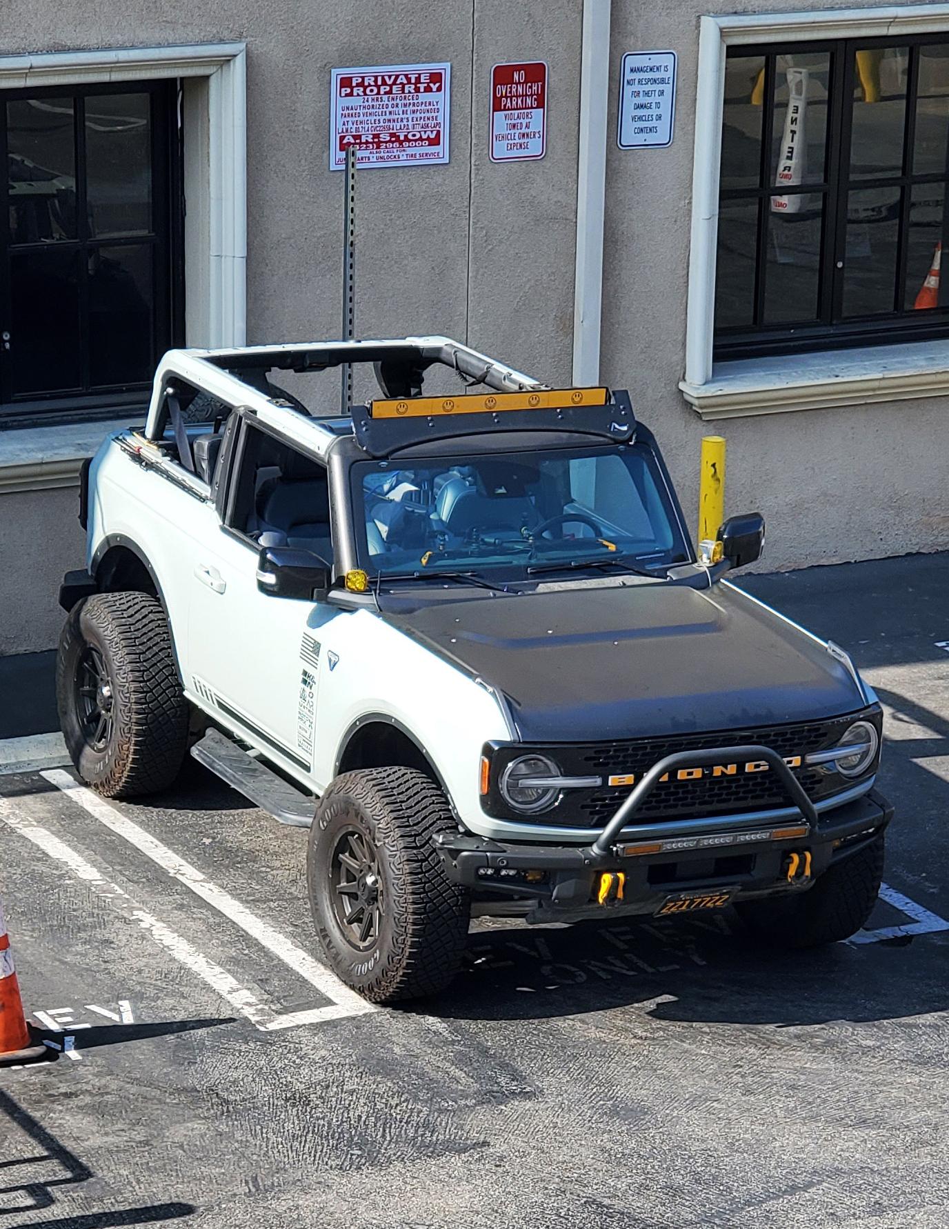

Here's a fun fact:
You can take the @TrailRax TRMR roof rack off easily by unscrewing the front crossbars where the windfaring is. Looks a little funny with just the windfaring on, but since that seems to be the hardest part, I gave it a try and it works well.
Ford Bronco Trailrax Real World Reviews? 20230728_064645
Ford Bronco Trailrax Real World Reviews? 20230729_091526
Here's the disclaimer: I haven't tried putting the roof or the rack back on so not sure how easy or hard that will be, but I was able to take the whole thing off myself, and will attempt to do the same putting it back on.
FOLLOW UP: Put the roof back on, and also put the Trailrax TRMR back on. It was too easy, less than an hour TOPS for the roof and the rack. I was worried about the screw alignment at the front but it was nothing more than lifting about 1mm to align and screw it all together. I'll be doing this from now on.
