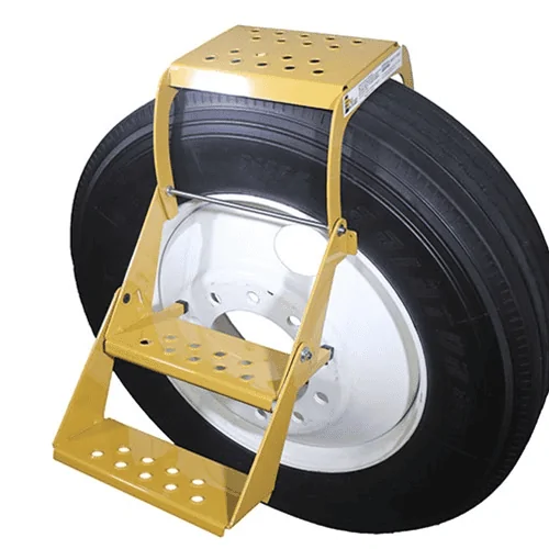

There are various steps you can use with your truck without bringing out a step ladder. For example:
Ford Bronco Trailrax Roof Rack 1688152646835
Shop around, there's something that will suit your needs.

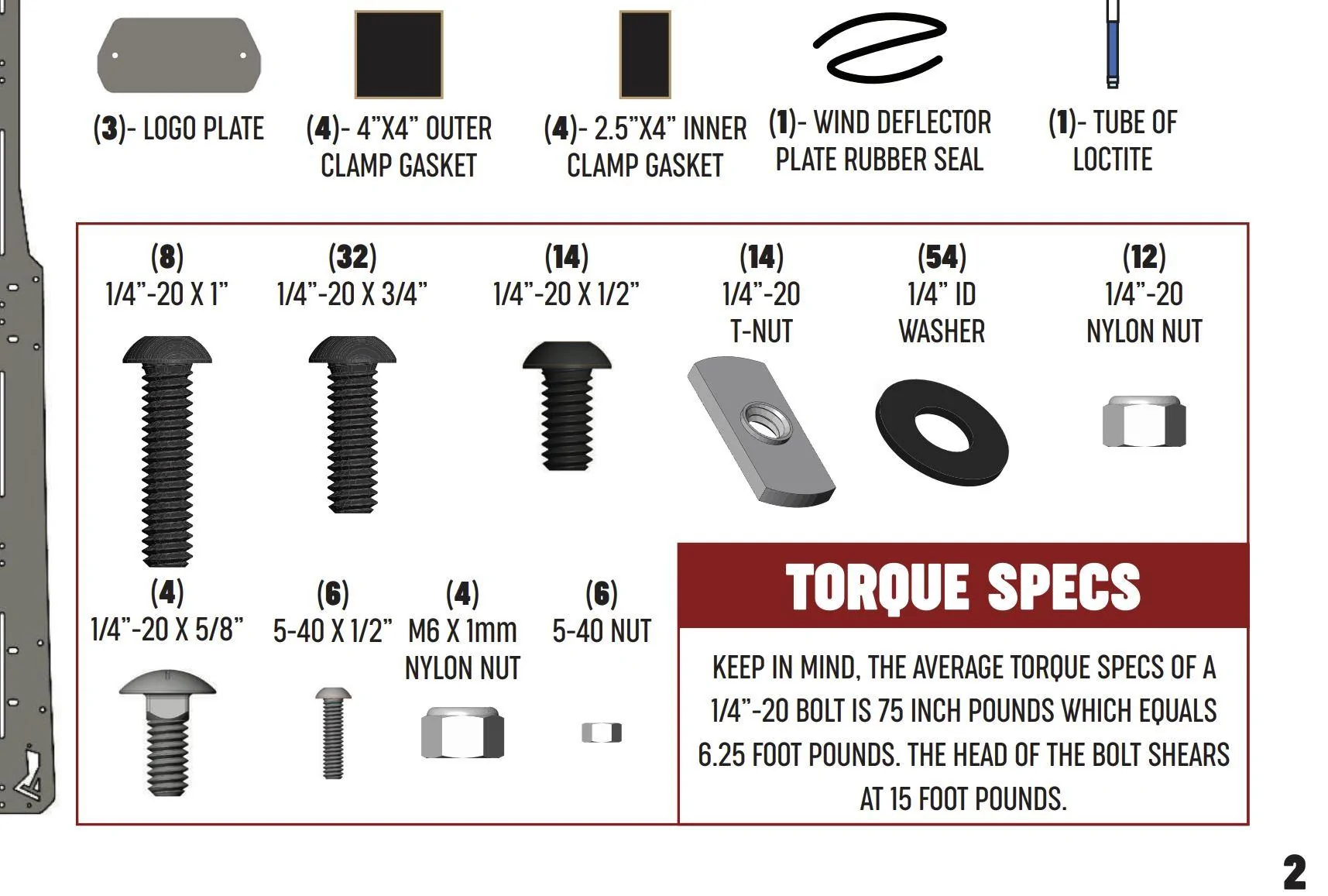

I had the same issue, one of the bolts completely broke off in the pax rax bracket. TrailRax was able to send a new part at cost, but I definitely recommend making sure everything is 100% lined up before using a wrench.
100% agree with lining up first - the frustration came from the bolts not biting until pressure was applied.
Normally I like to hand start everything - this was a "put it in a pray" situation since they didnt bite until wrench pressure was applied.
I have asked them to provide the size of the bolt, as their documentation on the instructions has every part marked as 1/4 by 20 - and none of them are.

Yeah, totally agree, my guess is that it wasn't quite threaded perfectly from the factory. But after that I started being extra extra cautious.

This has occurred to some customers so do not feel like you are the only ones. We have been trying to crack down on the issues so our customers stop seeing it, in our process of manufacturing, we have tightened our powder coating process so that we are seeing the threads completely clear after powder. Furthermore we have seen some experiences of "stainless steel galling" weird but happens. We have since changed the material of the PEM hardware to get rid of any chance of Stainless steel galling.
edit: If you are seeing any issues with tapped holes/ PEM hardware, please email us and we can get you taken care of.

Good to know, thanks TrailRax.
