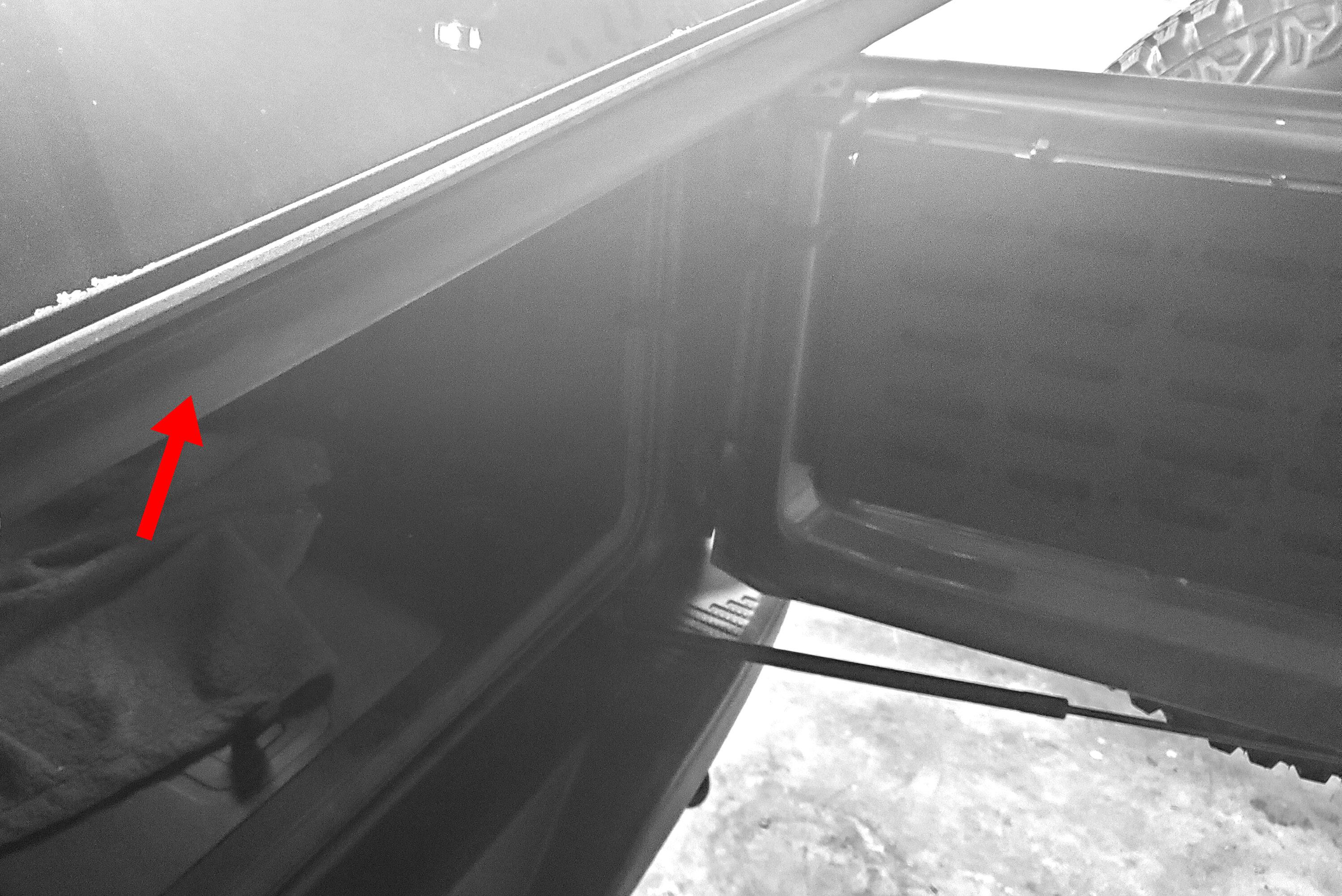

This sounds like the squeaky hardtop issue with the rear window. If thats the case, a little Krytox grease on the bottom seal of the window will fix it.
I’ve done this, and yes it solves the rear window rattles. My issues are coming front where the back cap mounts to the rollbar. Adding weather stripping to the swing gate also helps a lot
On the inside?

Between the window and tailgate
My issue sounds a lot like metal, but could you send a picture of what you mean? I’ll try it out tomorrow.

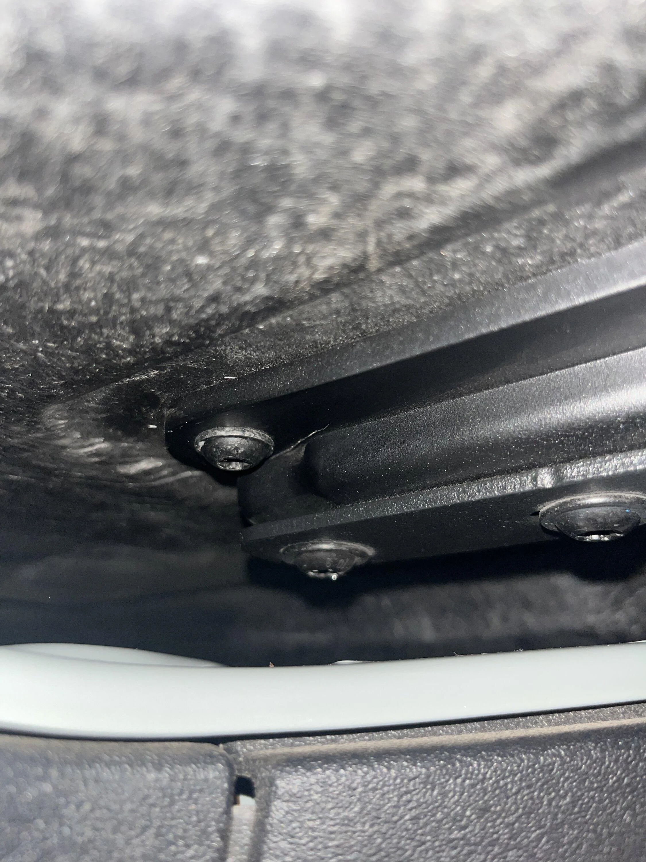

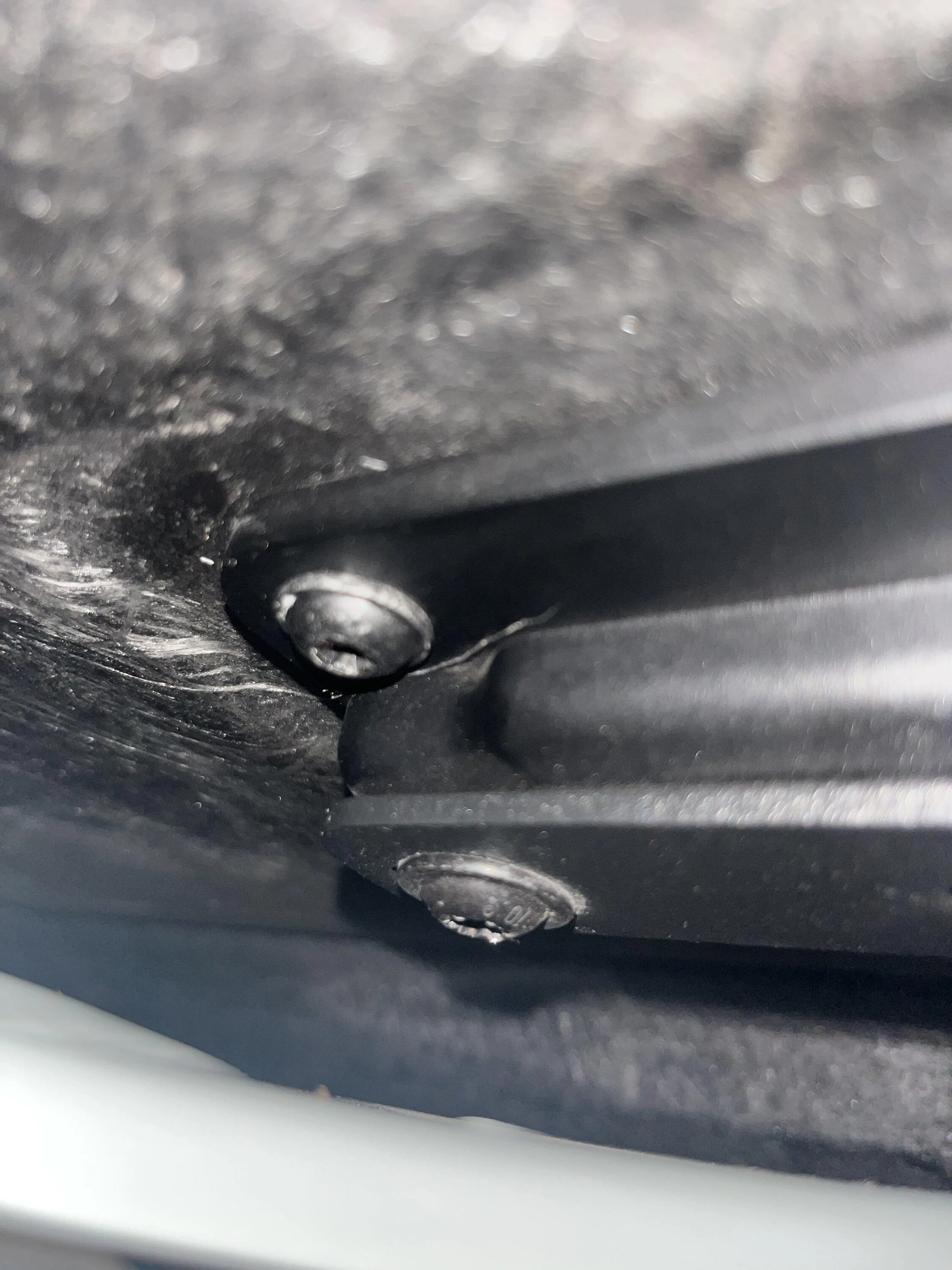

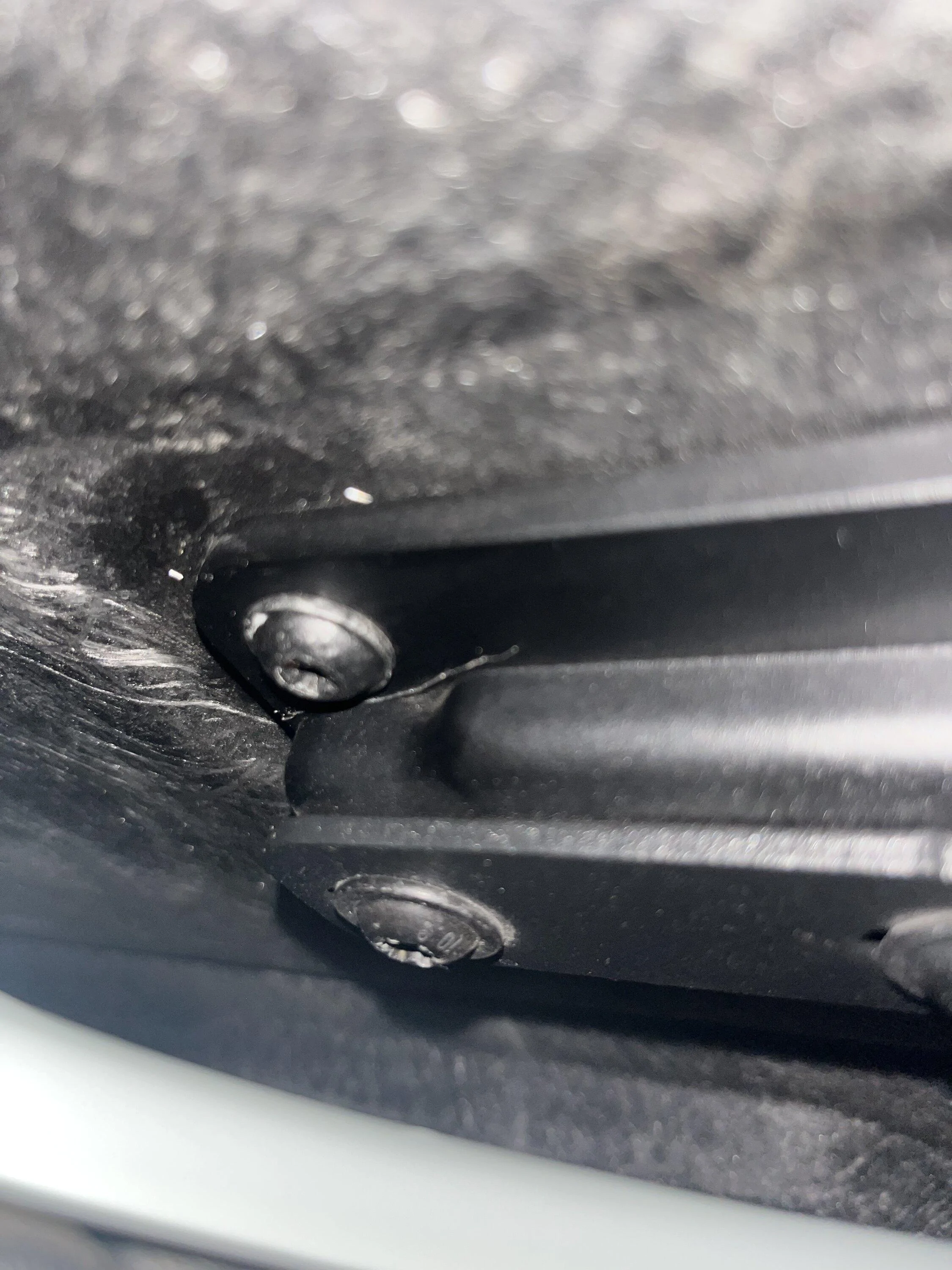

Update: found cracks on the latching points, compared to a fresh bronco and it doesn’t have these hairline cracks. Ordered the parts, hoping this is the fix.
