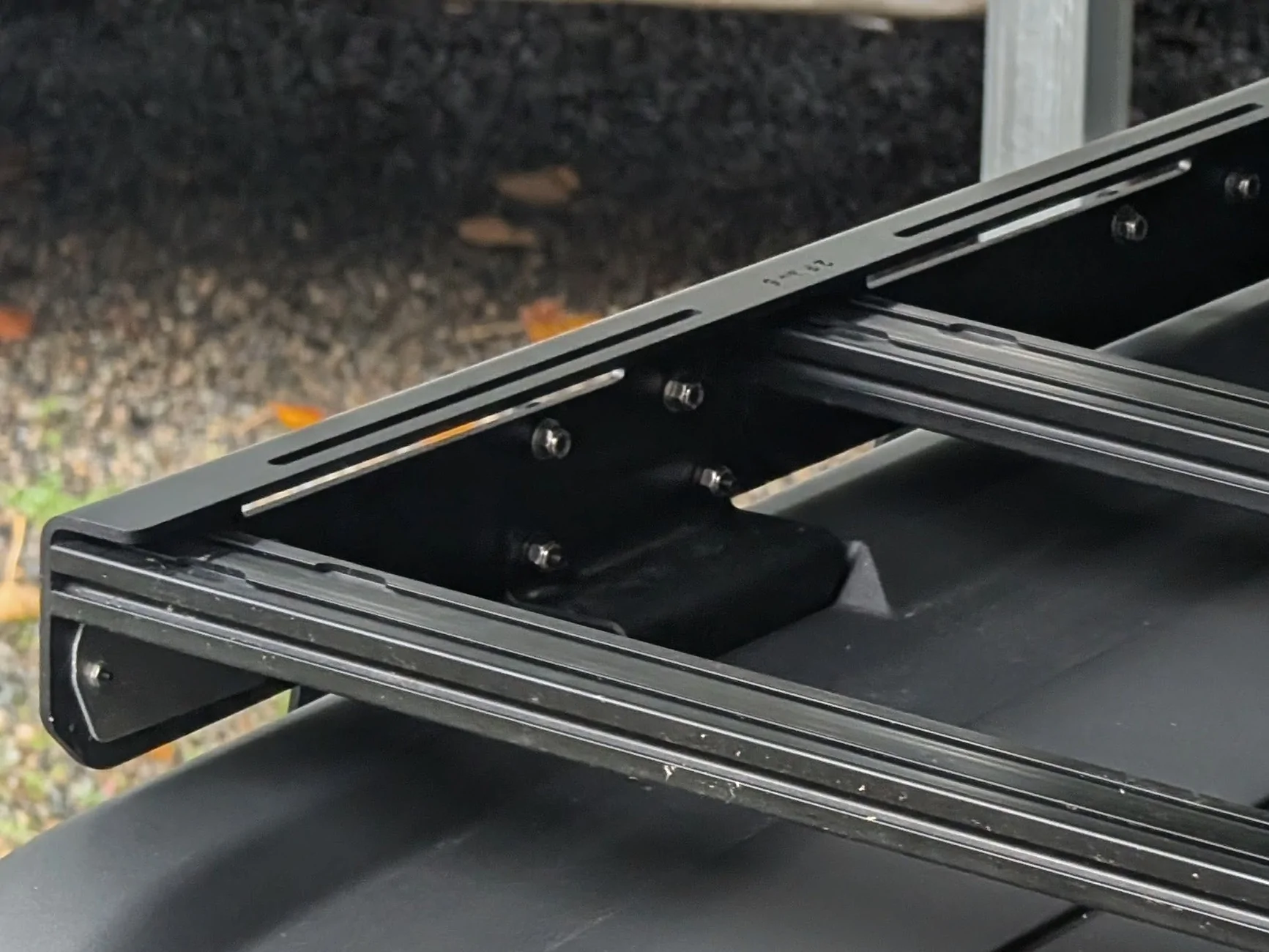

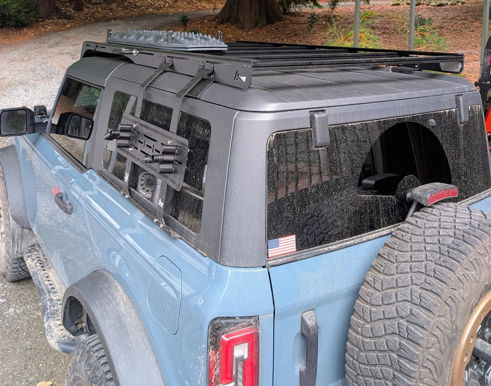

The Pak Rax attach to the rack longitudinal member at the top and bolt a fixture attached to the Bronco rear quarter panel attachment (under the top) at the bottom. If the fixture is robust and holds the rack at the same hight as the top does (which it would need to do because of the front mounts on the windshield, unless it were shimmed) it should be fine. In fact, I'd suspect a fixture made from 3/16" or 1/4" aluminum extrusion and loaded in compression directly into the steel roll cage structure would be a helluva lot stronger than the multi-piece crack prone plastic rear cap.
Edit: second pic shows the lower Pak Rax attach, roof off.

Even with the Pak Rax, the rear of the main rack is clamped to the plastic cap, much like the OEM rack rails attach. You'd need to have more support that the Pak Rax alone, or there would be minimal load carry capability in compression and little side to side stability.
