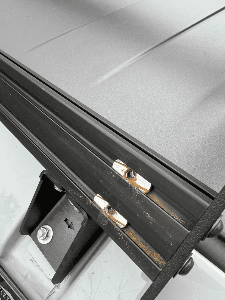

I'm looking for some guidance on where to find higher quality (preferably stainless) hardware for my Bronco TRMR roof rack.
I've owned the rack for about 9 months and have substantial corrosion of the 1/4"-20 T-Nuts that were provided in the kit and somewhat less significant corrosion on the 1/4"-20 bolts. I've been searching online to see if anyone makes higher carbon / stainless hardware that'll work for this application but haven't found anything yet. Anyone on here have a suggestion?
The included hardware seems to be made of zinc plated low carbon steel, which IMO should only be used for indoor stationary applications. I like the design of this rack overall, but the included hardware isn't seemingly up to the task. I also worry about the impact mixing metals will have over time on the aluminum extrusions, but that's a future problem.

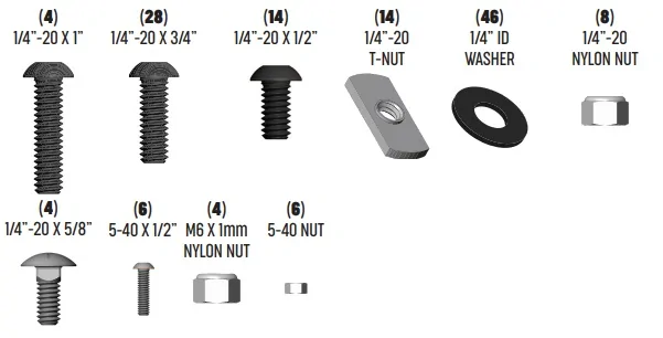

Here are the included pieces of hardware that I'd like to "upgrade:"

Hey! Email us an [email protected] and we can get you replaced hardware. We did get a bad batch a year ago and are still weeding out who got it and who didn't. Just let the customer service team know about your hardware with pictures and we will get a replacement kit sent out today. We have since upgraded our hardware to local Utah sourced.

Thanks. Just sent the email.

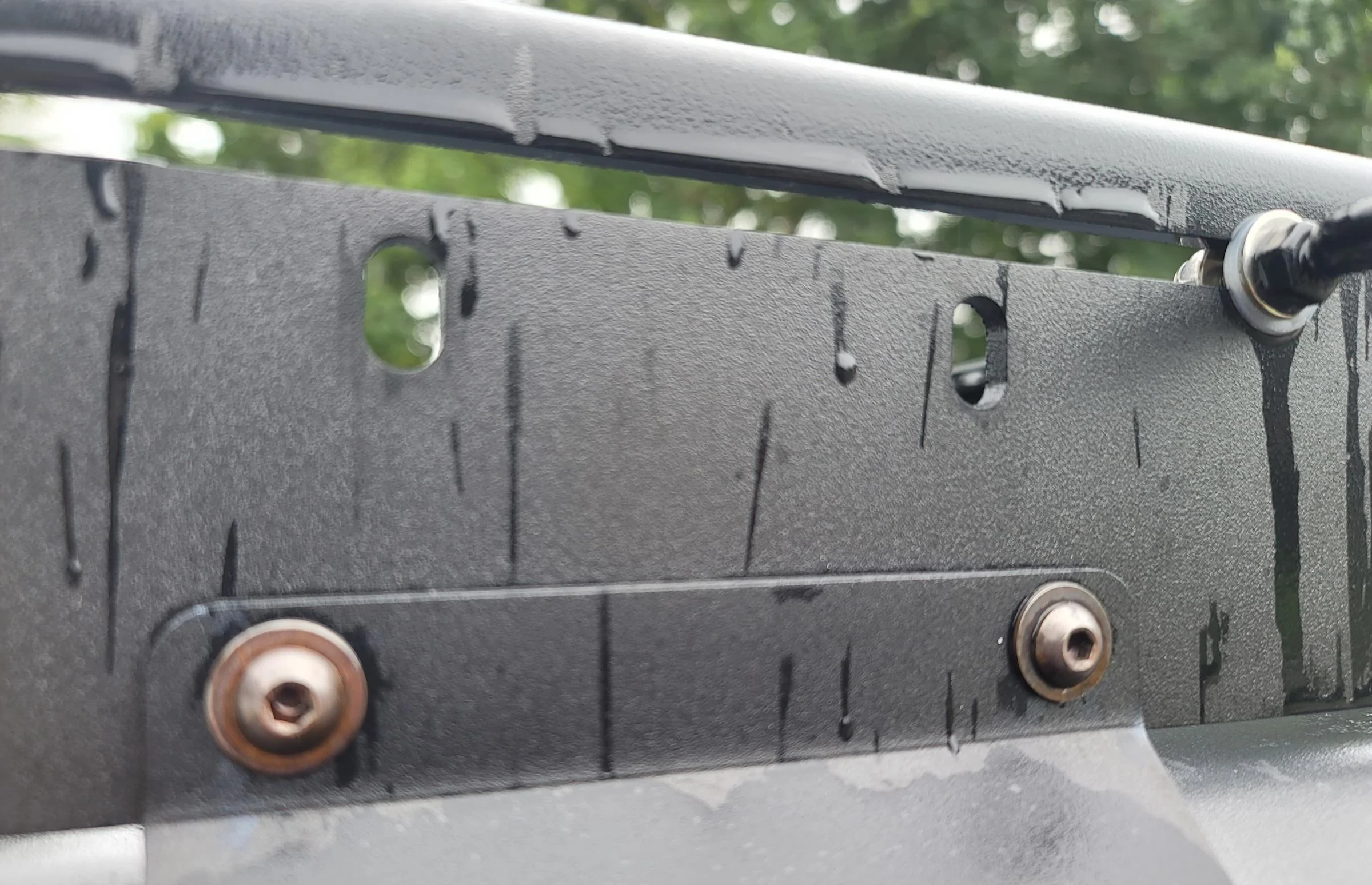

Thats good, @TrailRax , my half-rack I bought August 2022 had rusting screws as well. I mostly fixed the problem for the short-term by being more liberal with the locktite glue. Love the Half-rack!
Reach out and we can get that sorted. Like mentioned above, it has been hard to trace who got bad hardware and who didn't. There has also been instances where the black oxide on the bolts have a reaction to some sort of weathering or salt that turns the oxide into a weird color almost as if it is rusting. We do use stainless steel with black oxide coding over it so even if the black oxide faded away, you should not be experiencing rust on the hardware.
Some of the washers were miss-labeled to you, they were pretty clearly (to me) painted steel . . . You can see the rust in the photo.Which would cause electrolysis issues from dissimilar metals which I dealt with installing deck hardware & fasteners on boats over the years. Its also why coating with glue somewhat fixed the problem. Also, the hardware, when tightened, will compress the coating on the rack, also causing rust. I used plastic washers when installing eyebolts on my rack for holding down the mid-panel. Normally, I would have spray-painted all the washers, or sourced my own s steel at a marine store, but your customer service assured me they were ss.
Otherwise, such a nicely made rack. I'll email and get a set of waahers & fasteners. Whats your name, so I know who to talk to?

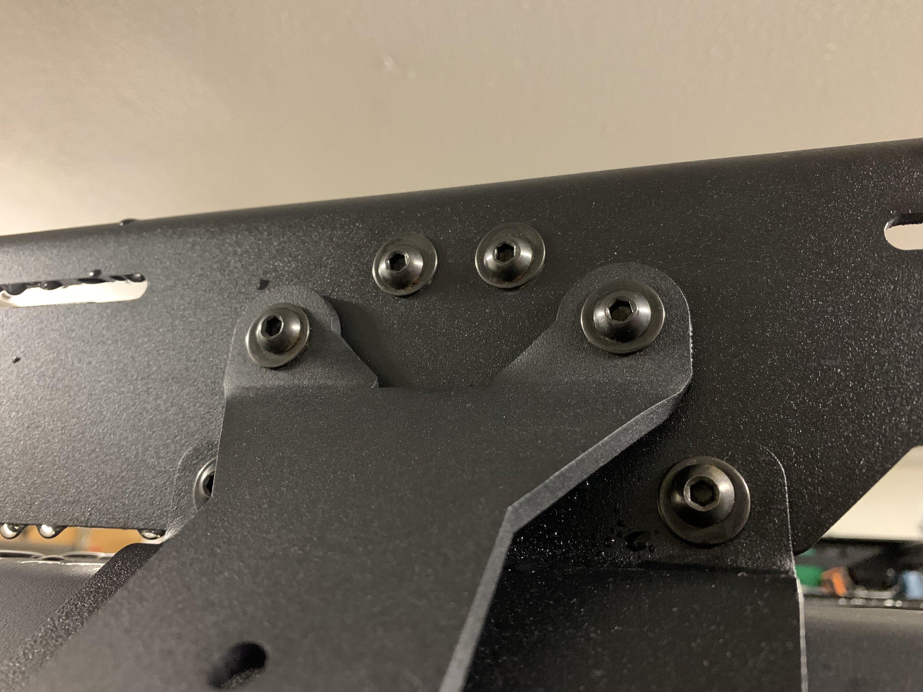

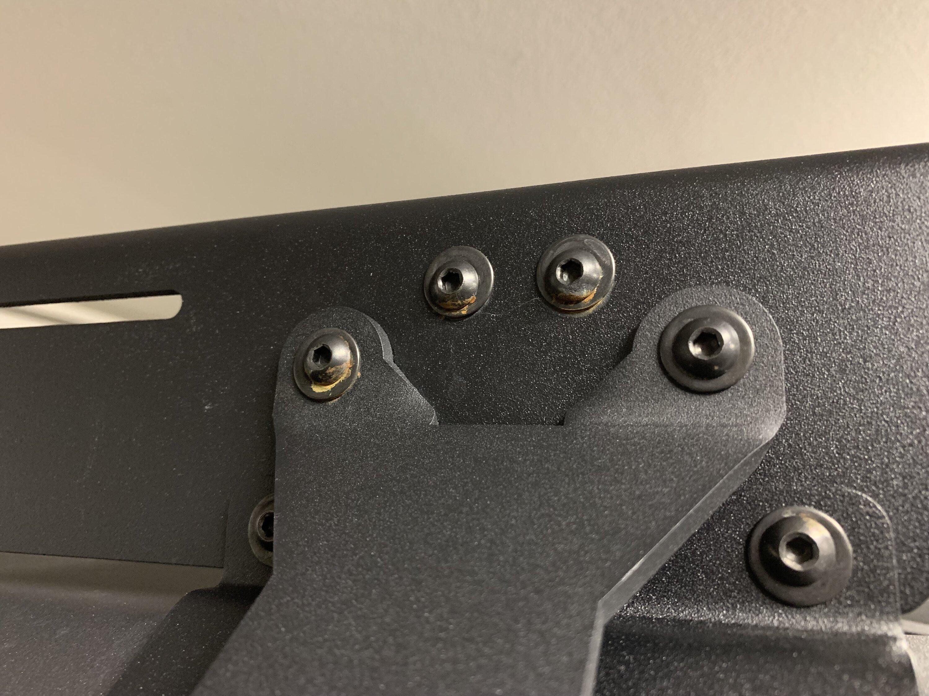

can cod There has also been instances where the black oxide on the bolts have a reaction to some sort of weathering or salt that turns the oxide into a weird color almost as if it is rusting. We do use stainless steel with black oxide coding over it so even if the black oxide faded away, you should not be experiencing rust on the hardware.
Can confirm, this is what was happening to mine. Bought the rack earlier this year but just installed it a couple of weeks ago and noticed what looked like rust. Following your advice, I was able to just wipe it off with a cloth. Everything’s back to looking new again!
Great product, I would not hesitate if I was in the market for a roof rack.
Here’s the before/after:
Ford Bronco Trailrax TRMR Roof Rack Issue (Rusting Hardware) IMG_8434
Ford Bronco Trailrax TRMR Roof Rack Issue (Rusting Hardware) IMG_8503
Yeah sorry that oxidation color looks so much like rust, Glad it just wipes away! Do not hesitate to reach out if you need any support from us!
