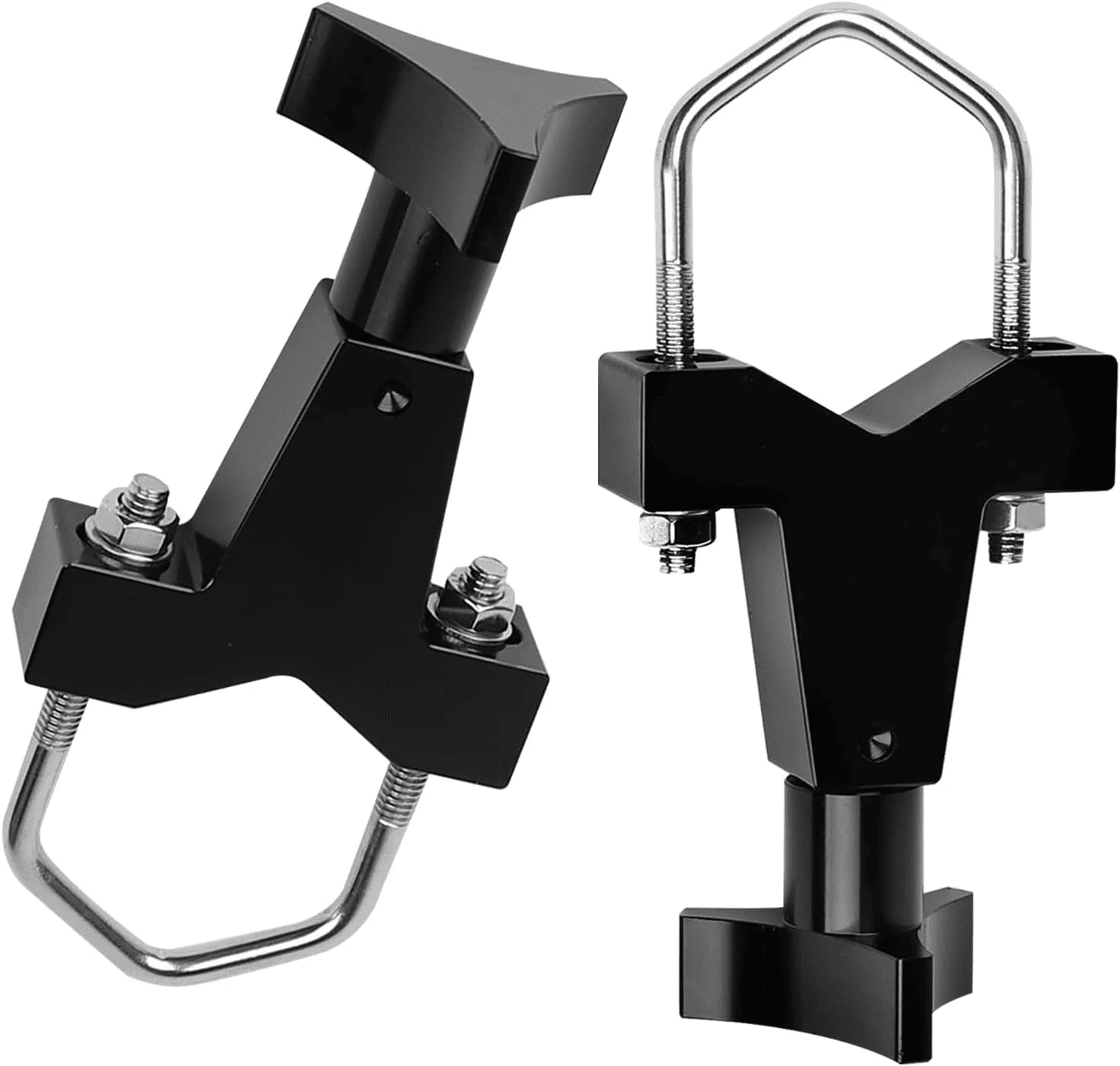

Here's what I'm ordering for my farm jack: I'll use 1/4-inch bolts, instead of the U-bolts the seller provides, and bolt it down to the T-nuts in my TRMR.

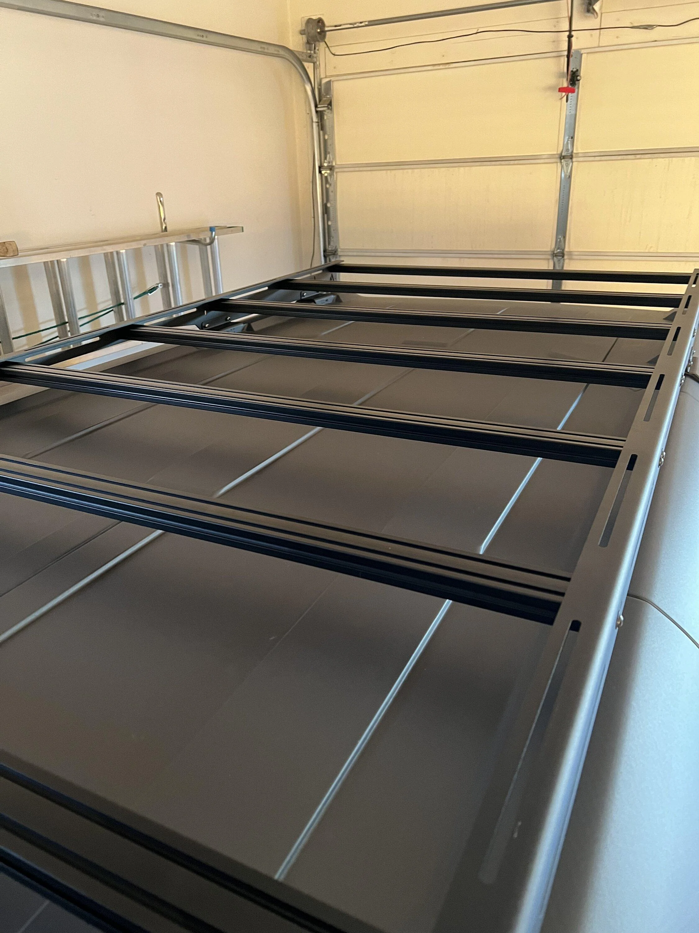

I've just finished installing the @TrailRax TRMR roof rack. Through a complete lack of planning on my part and admittedly poor forethought, I had a competitor's roof rack (which I loved, though it was heavier) that unfortunately wasn't compatible with my recently purchased RTT (OVS Bushveld--love it!). So, off came the barely two weeks old competitor rack and on went the TrailRax TRMR. The nearly brand new one will be listed for sale shortly.
All-in-all, I'm quite pleased with the rack. I tested it today at 75MPH+ on the highway (with the installed light bar--see below), and it didn't make any kind of noise at all over the normal wind noise in the Bronco at that speed. I'm very pleased with that result.
The only issue I had is that, when I picked up the rack (I'm relatively local--I live an hour away from TrailRax HQ), I asked the gentleman who helped me if the cutout version I bought would work with my lightbar (Rigid). "It will work with the mounts that came with your light bar." I know, again, poor planning on my part--I should have known the answer to that question BEFORE I ordered and picked up the rack.

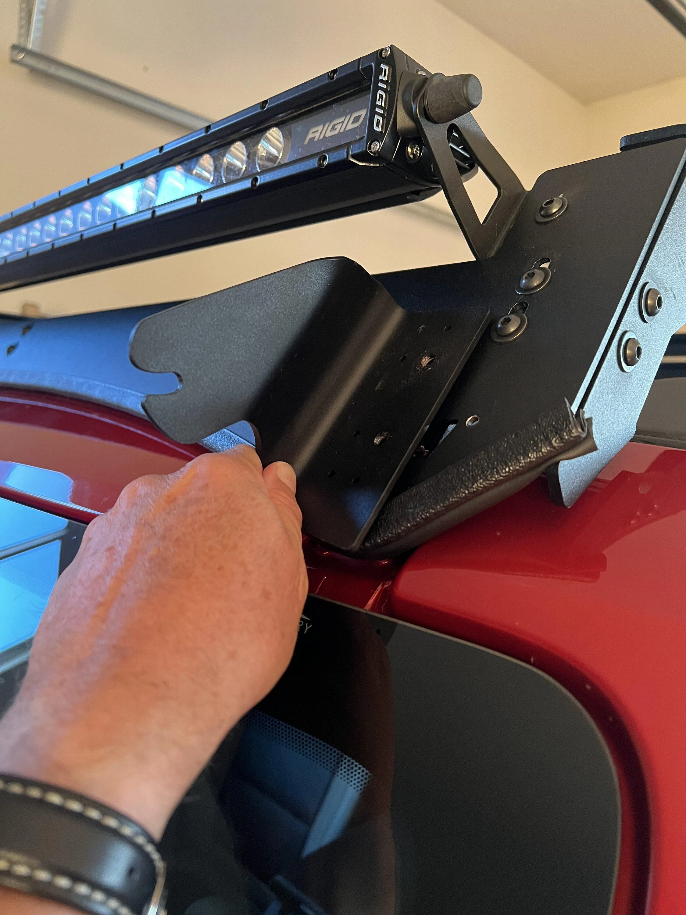

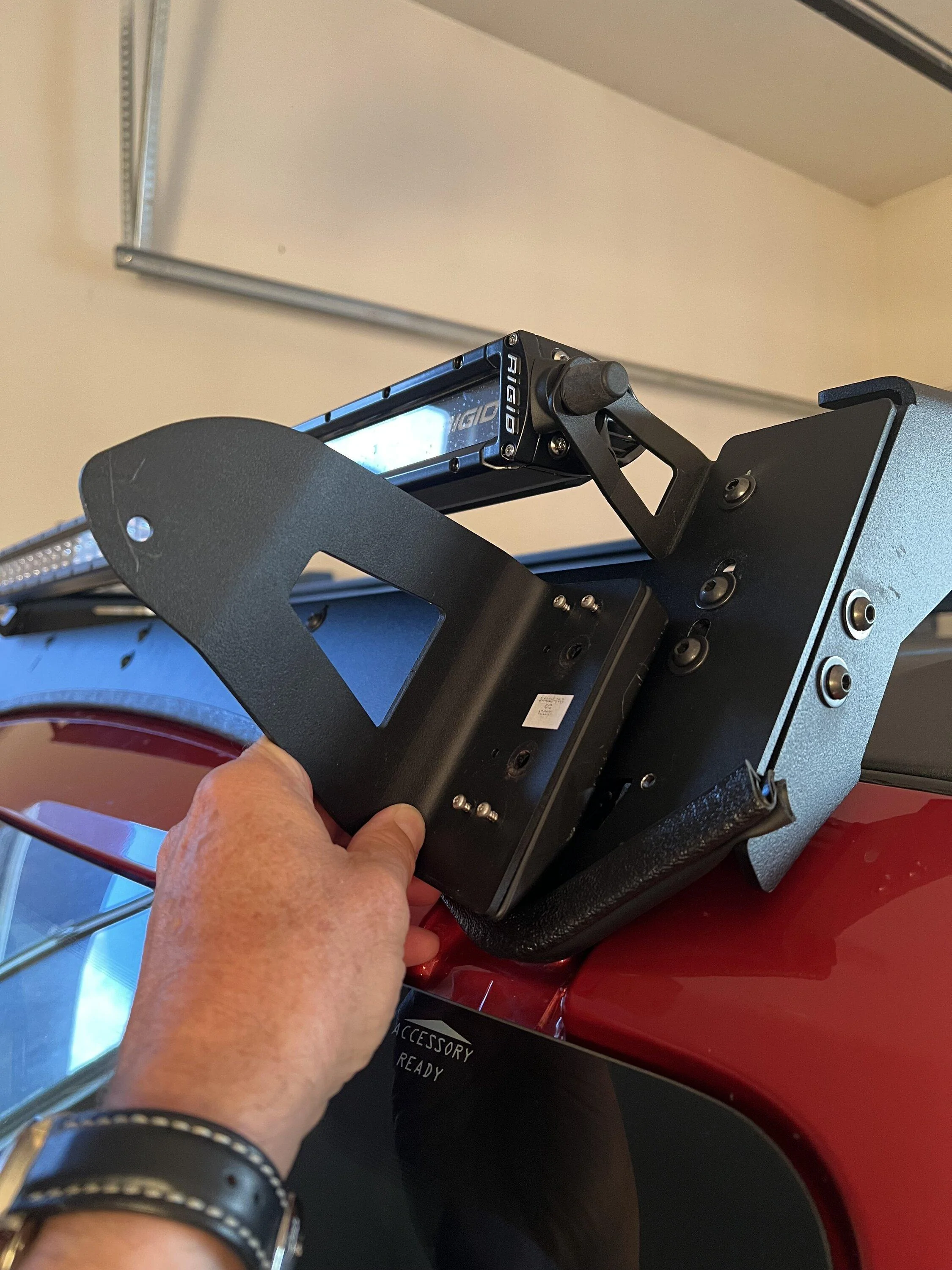

Well, to my dismay, after a couple of hours of repeated attempts to prove the gentleman correct, I must report that the Rigid light bar cannot be installed with the TrailRax TRMR with the OEM brackets that come with the light bar. I know--I tried extensively. Unless there are yet other Rigid mounts beyond the two that I tried.
Here are two photos of the rack with the OEM Rigid mounts--please tell me how these could possibly work with the cutout on the TrailRax rack! If anybody has done this, please come forward and tell me, because I couldn't figure it out.
Ford Bronco Trailrax Real World Reviews? IMG_6648
Ford Bronco Trailrax Real World Reviews? IMG_6649

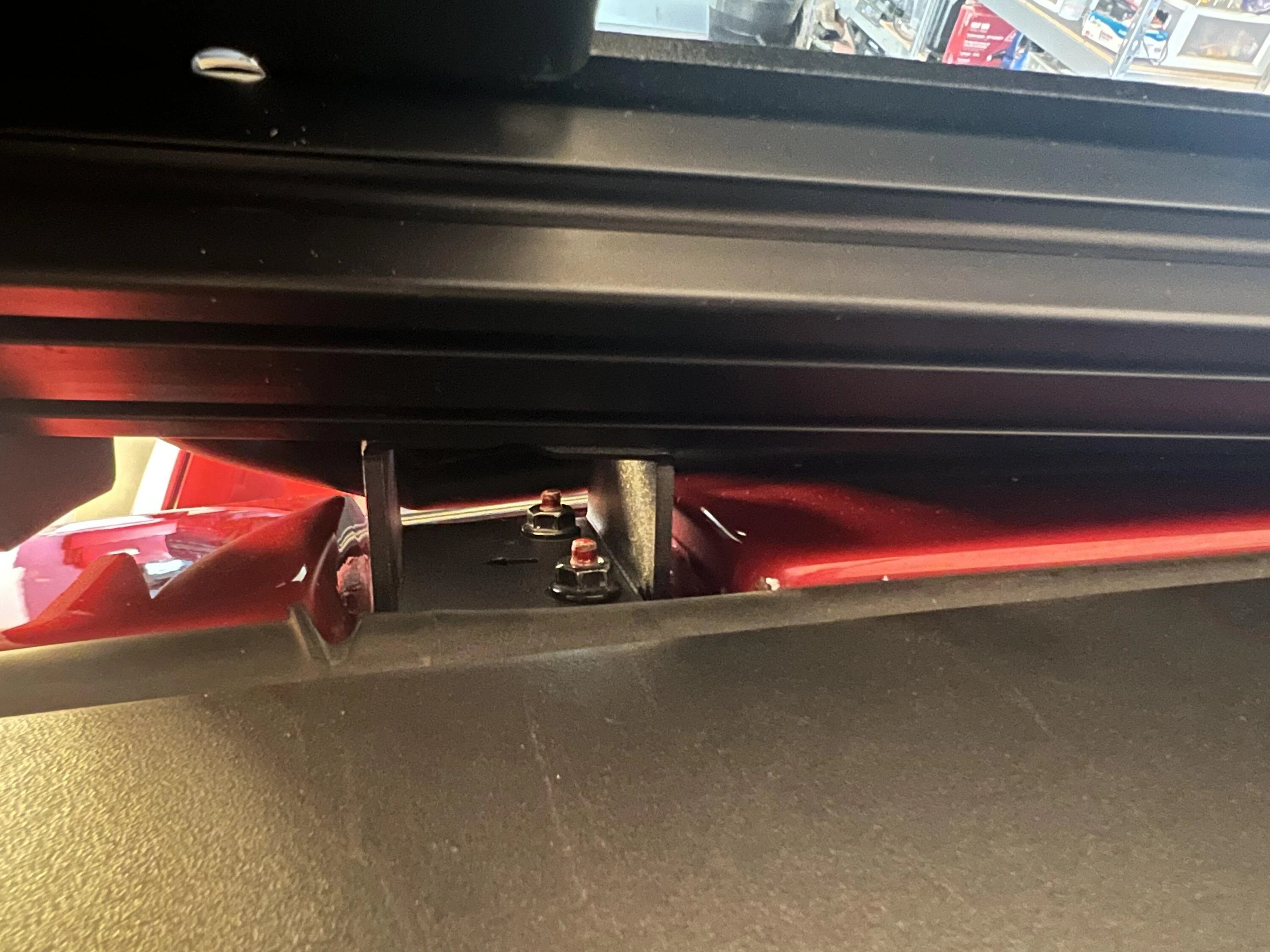

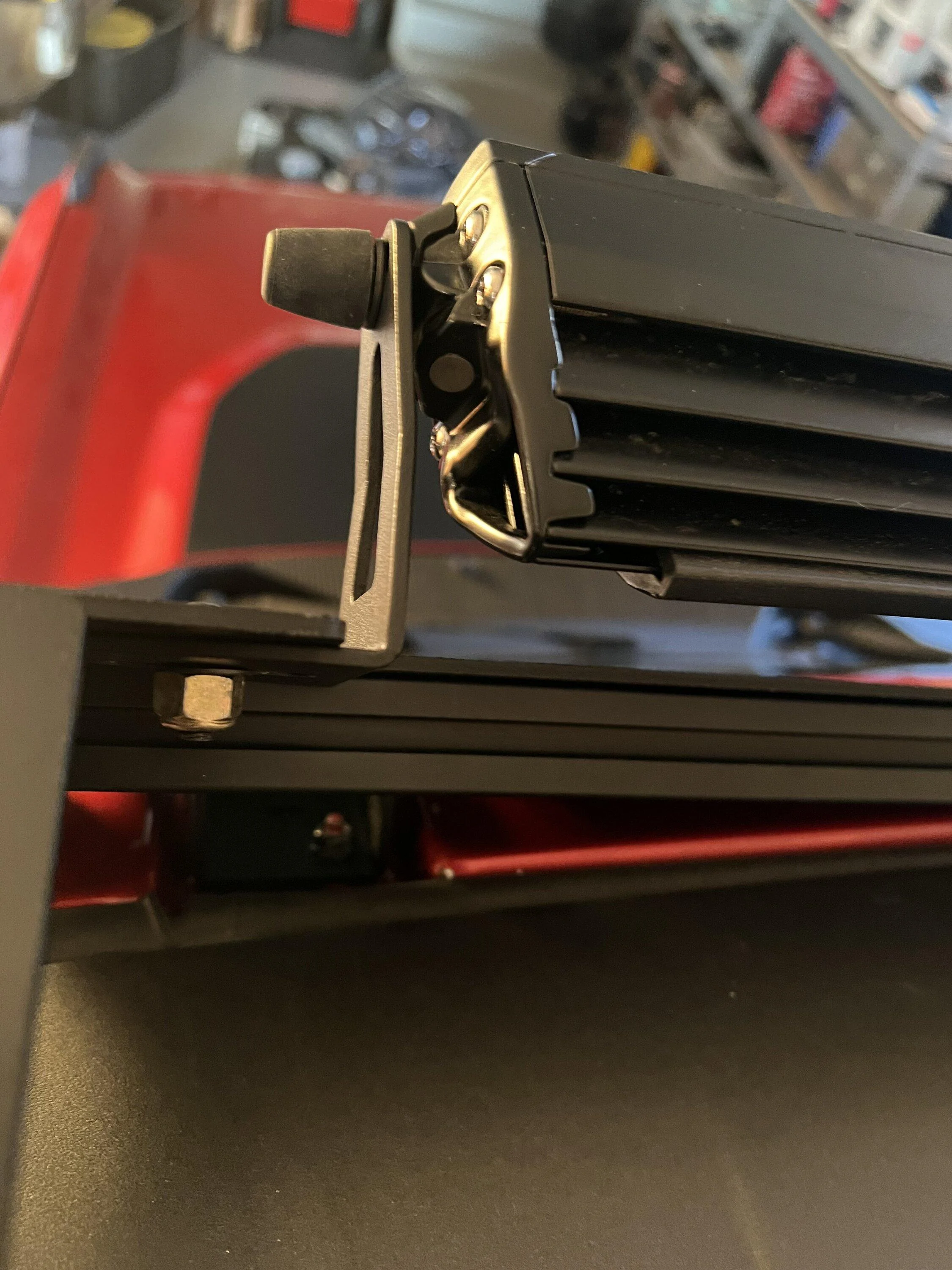

The second one seems sort of promising, but there is no clearance for the block into which the TrailRax faceplate mounts. And it's too low for the faceplate when it's in the mounted position. How could those mounts possibly fit into this space:
Ford Bronco Trailrax Real World Reviews? IMG_6653

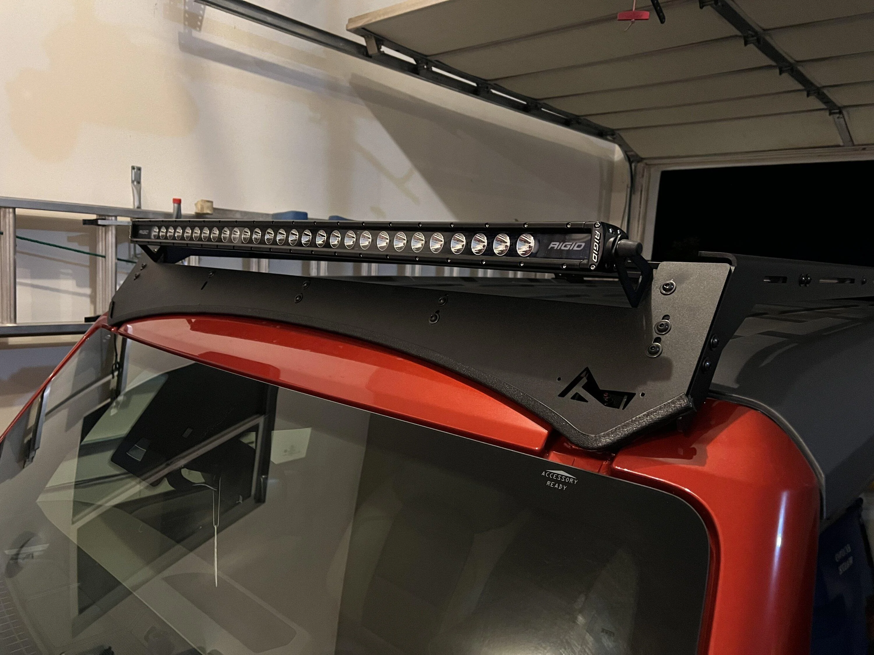

I ended up using some OTHER brackets I had laying around from another application and drilling a hole near the top of the cutout (horror!!!! drill a brand new rack????) and mounted them like in this picture:
Ford Bronco Trailrax Real World Reviews? IMG_6652
I had to do this because this is my DD and I had to put it back together so I could drive it. I'm considering going to a fab shop and asking them to make me some better brackets to get the light bar closer to the cutout, but not sure where to go to do that (Northern Utah if anybody has any ideas).

Other than that; I love it. I'm going to put the Bushveld on tomorrow (when I get some help--it weighs 150 pounds) and I'll report back how it works with the rack. I'm hopeful it's going to work very well.
Some more gratuitous photos. Here, with the Rigid light bar mounted, but well above and in front of the cutout. The bolts on the Rigid would APPEAR to interfere with any attempt to mount the bar in the proximity of the cutout. Ideas, @TrailRax?

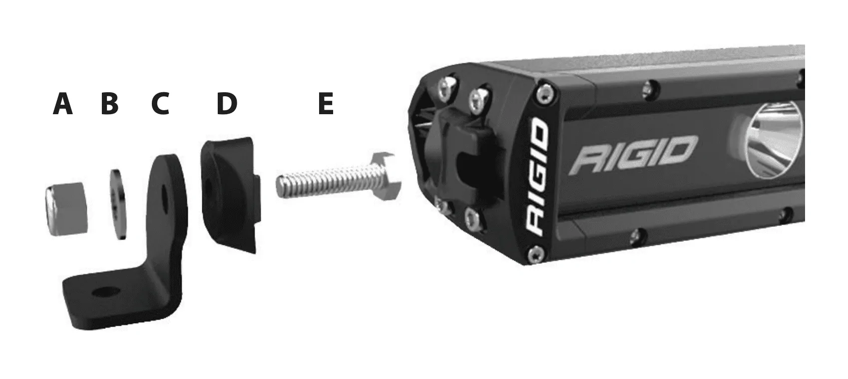

Did your light bar come with any non-vehicle-specific mounting brackets? I'm seeing this in their installation instructions:
Ford Bronco Trailrax Real World Reviews? Screenshot 2023-09-10 at 10.38.52 PM

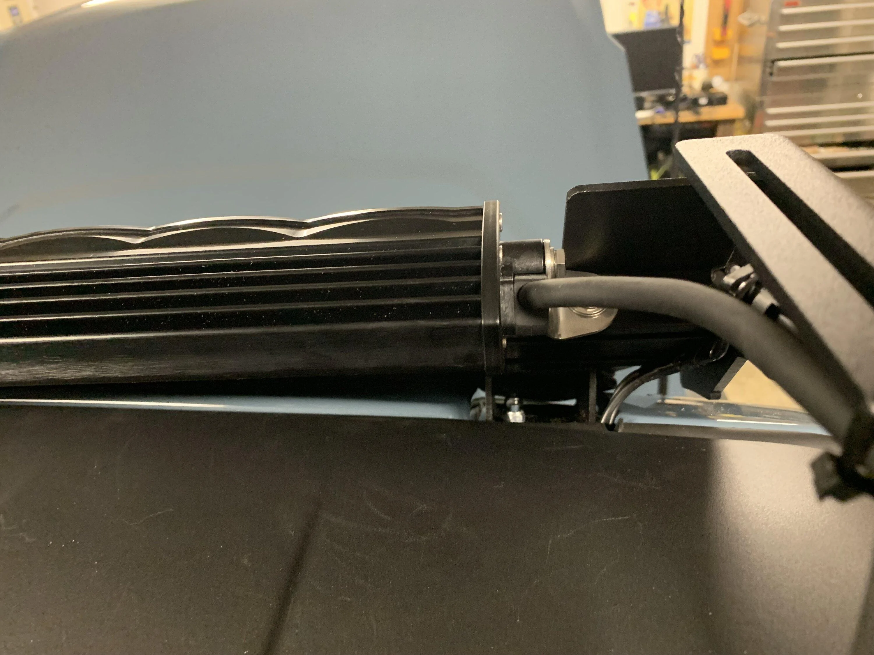

This kind of setup should work perfectly with the TRMR wind deflector cut out. It appears to be very similar to how I have mounted my 40" Baja Designs light bar:
Ford Bronco Trailrax Real World Reviews? IMG_8453
I have all that except part C--the bracket. Where did you mount the bracket for your BD light bar? I can't quite tell from the photo.

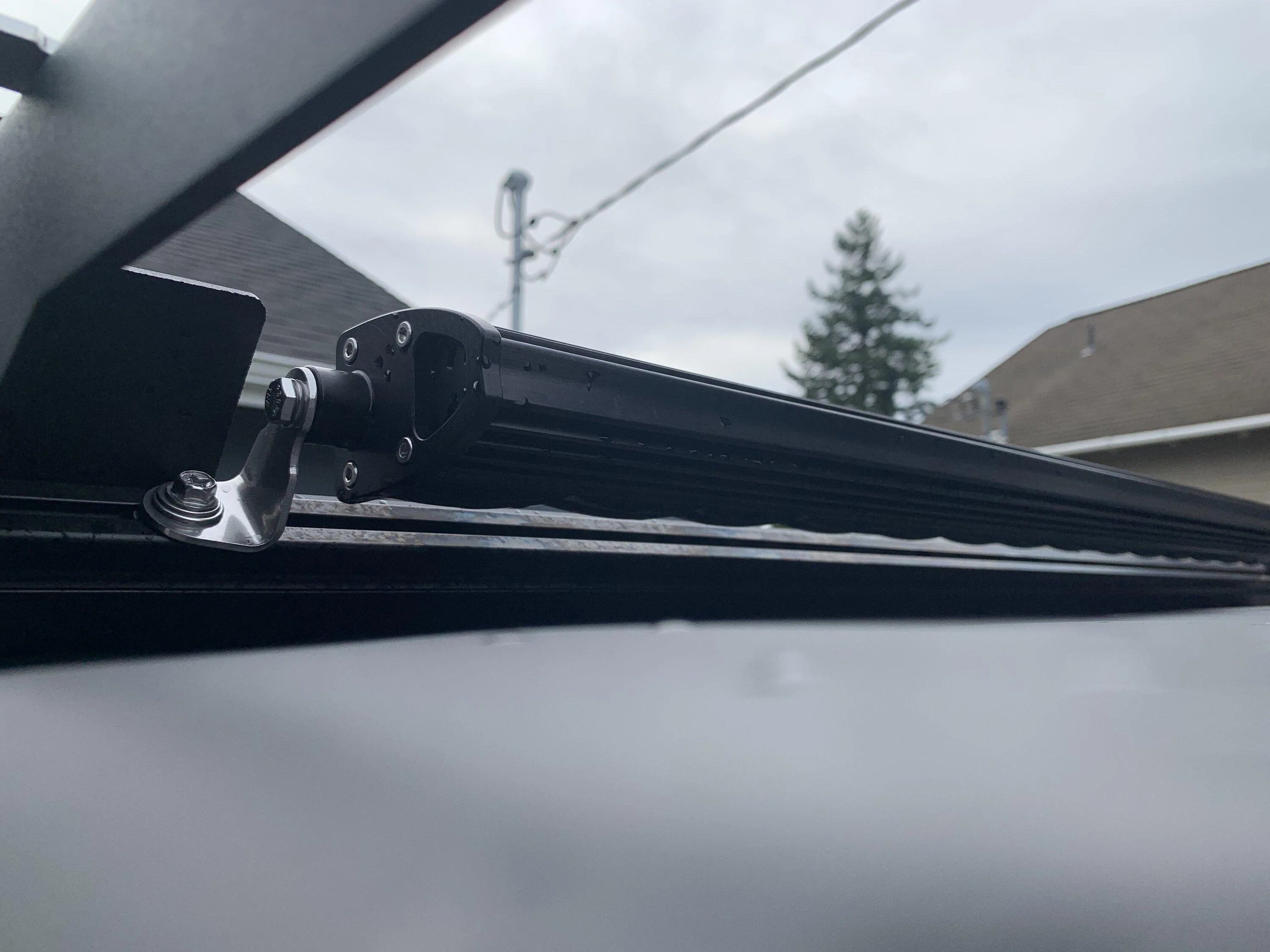

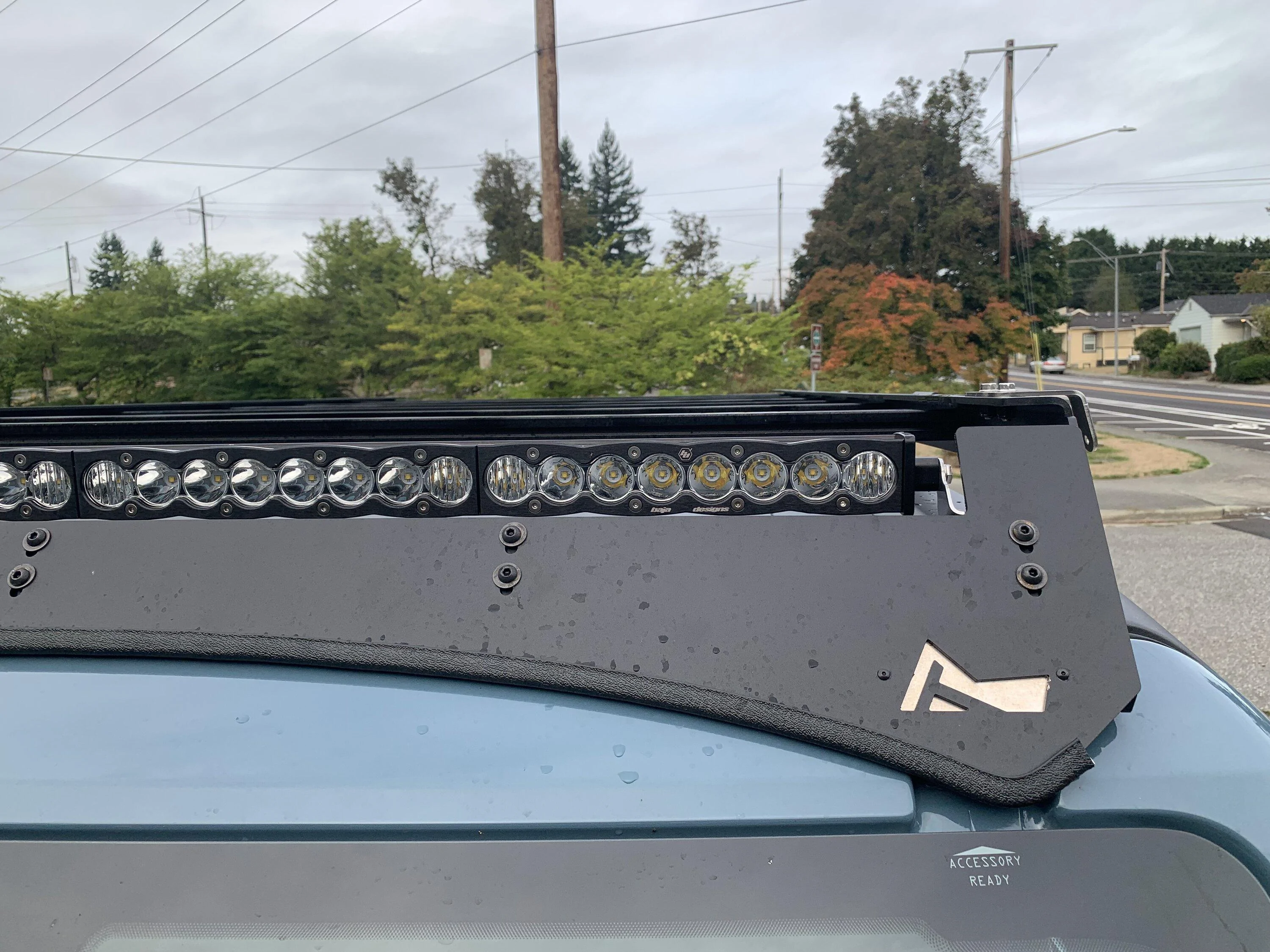

It’s mounted to the top of that front crossbar behind the wind deflector.
Ford Bronco Trailrax Real World Reviews? IMG_8626
Ford Bronco Trailrax Real World Reviews? IMG_8625

Got it--beautiful! I can likely do something like that. Thanks!
