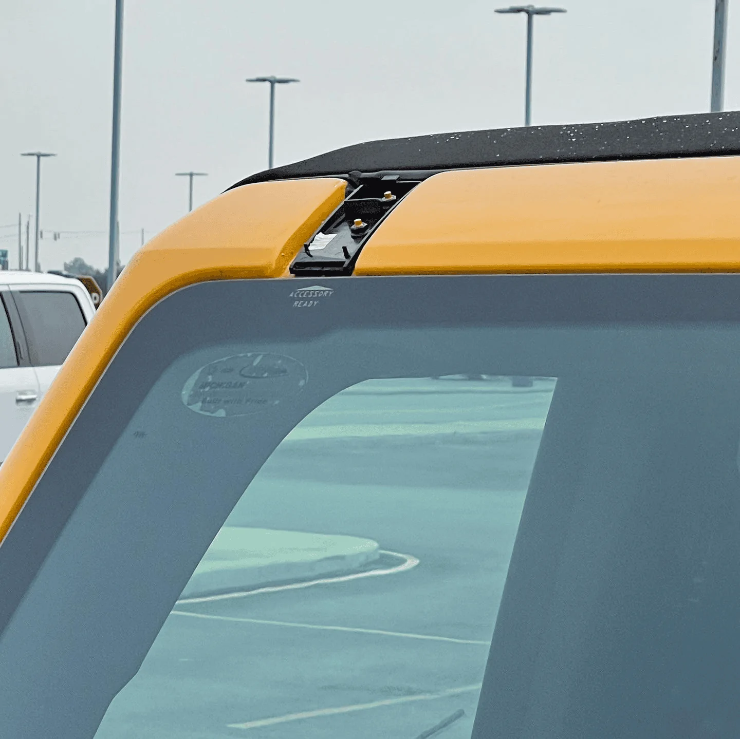

Thanks, this is helpful!
Do you have a link or part # for the extended stud Ford has available in case I decide I want to order that soon before i install my rack for the first time?
Ford Bronco Trailrax Real World Reviews? 1674061503084
Not the greatest picture ever but the top part of the stud is unthreaded and allows a nut to align and drop onto it without having to start threading it. This small part makes it super easy to install compared to not having it. Also, We have attached out new install instructions as well that we have worked on for the past 4 months.

Also... just to note for anyone doing the install.
That stud is apparently not galvanized or stainless and rusts very easily. So if you accidentally chip the paint when doing the install of the TrailRax rack (or any other rack for that matter), make sure you somehow protect it... nail polish is a personal favorite of mine.
Definitely does not look like something that could be easily replaced if it rusts out.
(To be clear this isn't the TrailRax rack itself, but rather the stud attached to the Bronco at the factory.)
