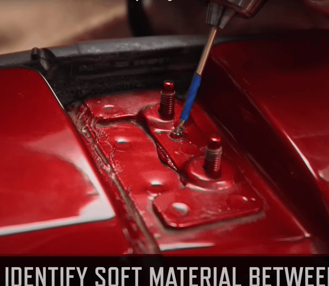

Not the greatest picture ever but the top part of the stud is unthreaded and allows a nut to align and drop onto it without having to start threading it. This small part makes it super easy to install compared to not having it. Also, We have attached out new install instructions as well that we have worked on for the past 4 months.
Perfect! Thanks for the picture and clarification

Just clarifying here. We are simply placing the 10mm nuts over these studs that are already there correct?
If so, this should be just placing the nuts there (with needle nose plier if needed), and then fitting the 10mm ratcheting wrench over these and tightening, right?
That is correct. We should have an install here in the next 30-45 mins that has been scheduled. we will show how it is done shortly.
