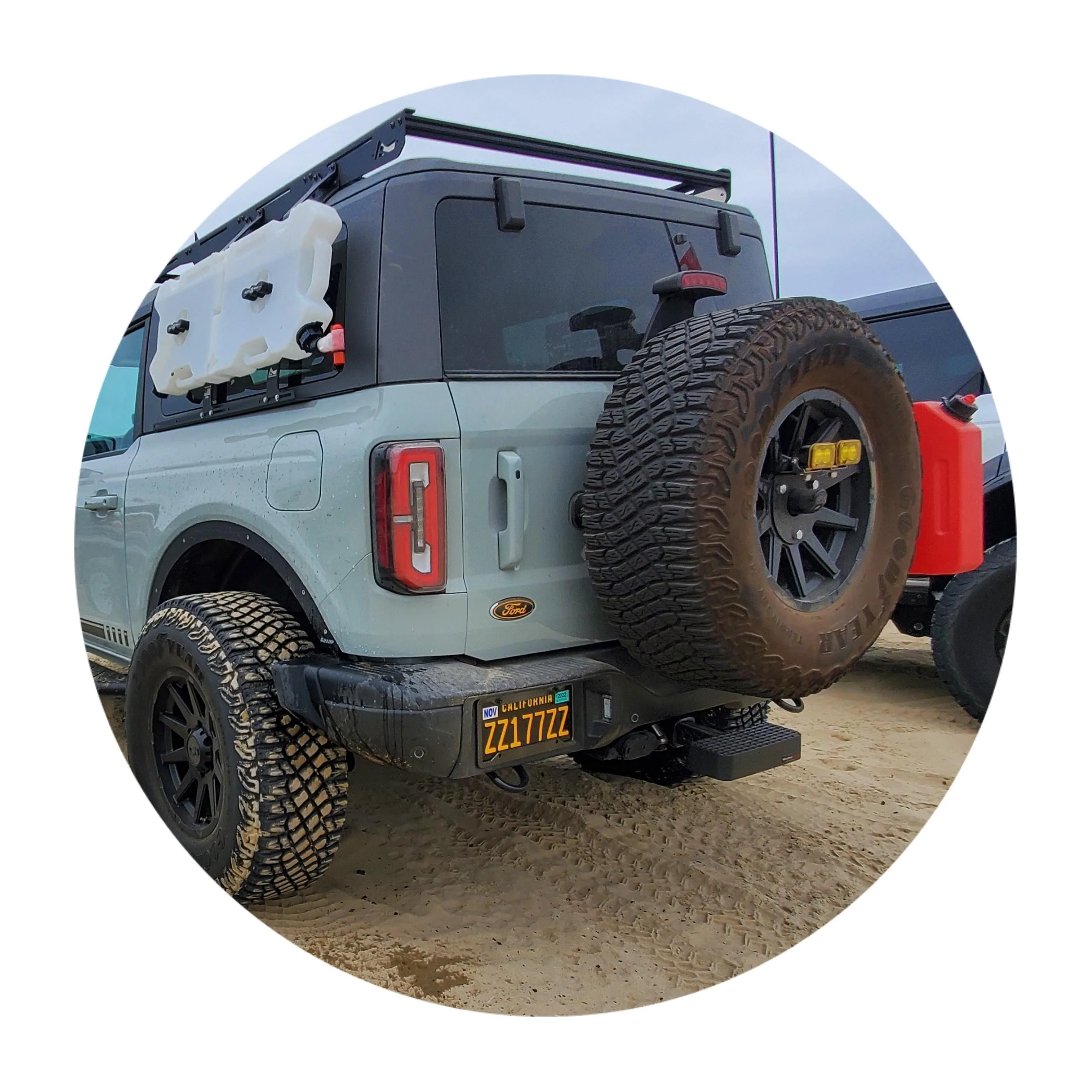

I installed my TRMR/Pakrax a few months ago and absolutely love it. Also gave me and excuse to take the top off and ride top/doorless for a few days during summer, ended being almost the entire summer.

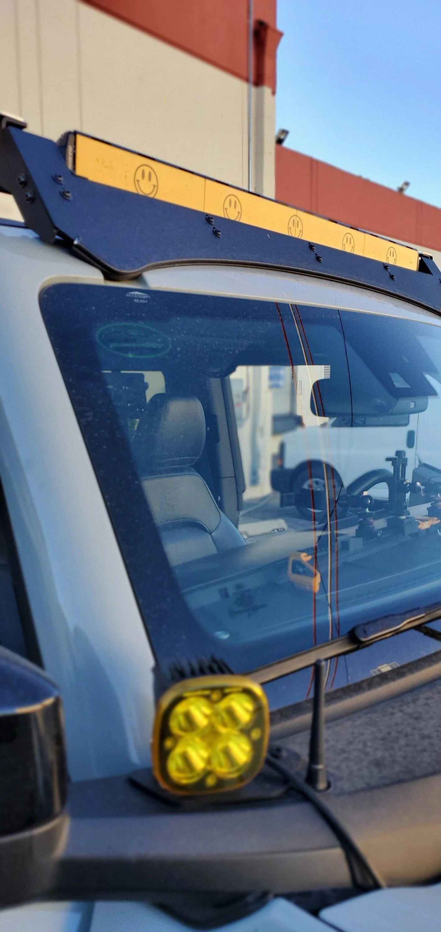

I got the wind deflector with the light bar cutout, and am using a dual row LED light bar, and it fit just fine. The best thing about it is that there is no wind noise coming from the light bar now, and no noise coming from the gear on top. The fit up there is pretty tight, and it is probably the hardest part of the install, but aside from this part, everything else was a walk in the park. The roof light bar covers are in there pretty tight, but I can unsnap them and slide them under the bar to get them off, which is an easy trade off for the noise it used to make.
On the Pakrax, I have two 2-gal water tanks from Rotopax. Keep in mind, when mounting, you do not need the mounting plates. It has been months now and they have yet to budge or rattle. I have a quick release fire extinguisher mounted to the side of the passenger side railing, and that's stuck there, too.

What light bar do you have? The heretic?
Thx Mark.
It's this dual row LED light bar. It was the brightest and most water resistant light bar I could find, rated at IP69K. It was a risk but I'm quite pleased with it, as it lights up the dark like the sun.

Oh wow. Figment looks great.
How was install and how is fit in the trailrax windshield bar?
also, did this take up 2 aux switches.
this might be a great option and cheaper than the heretic

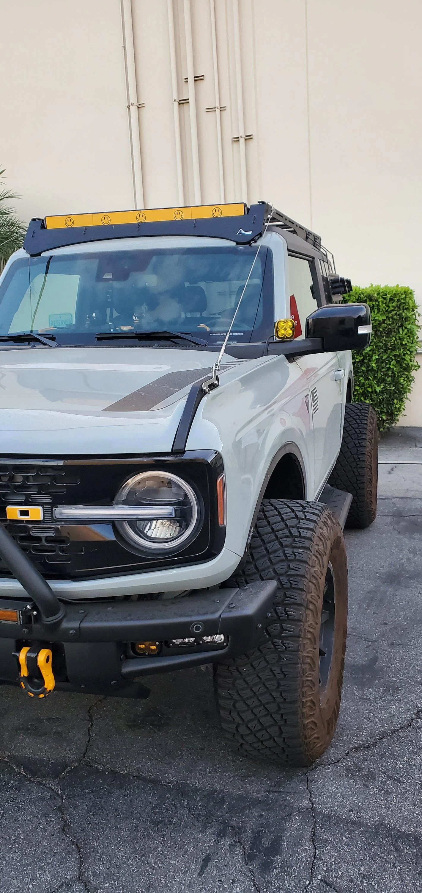

Here's a side view and front angle view.
Ford Bronco Trailrax Real World Reviews? 20220926_183714
Ford Bronco Trailrax Real World Reviews? 20220923_175014
The install was super simple since your mounting the light bar mounts to the 2x1 bar behide the wind deflector. I had the light bar before the rack and it was pretty loud, but I get zero wind interference from the roof now.
The only thing I'd suggest is that the parts surrounding the windshield, get wrapp/PPF in a matte black before you install this, because the cuticle above the windshield bothered me a it.
