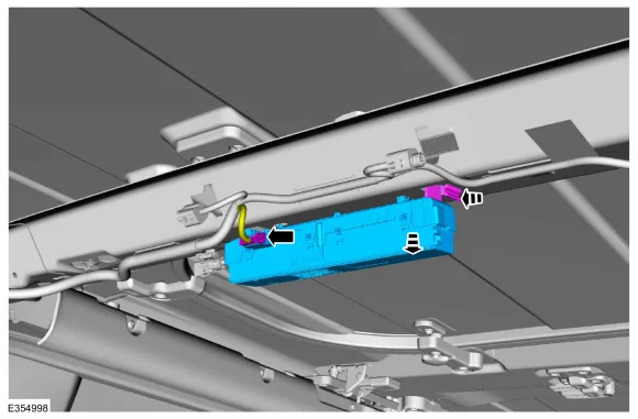

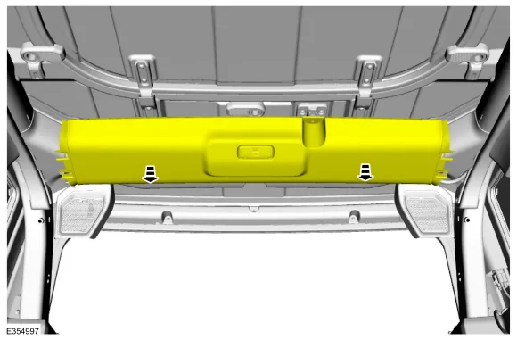

TPMS uses the RTM (radio transceiver module)
It’s at the very rear/top of the roll bar under the trim:
Ford Bronco TPMS Module not picking up sensor 1787451188234-gf
Ford Bronco TPMS Module not picking up sensor 1787451374037-vq

@Ducati1098 now that really throws a wrench in my thinking that I was obstructing the signal some how? Must be the module as I can't get a reading off drivers rear no matter how I rotate the tires.
Ducati1098
9,997
23,246
Midwest
Could be RFI maybe? Hard to say. The RTM receives the signal from the sensors, then communications all the information to the BCM.
But it communicates to the BCM over a LIN network, so if only one sensor isn’t working, it can’t be the LIN. I suppose it could be an issue with the BCM still though.
