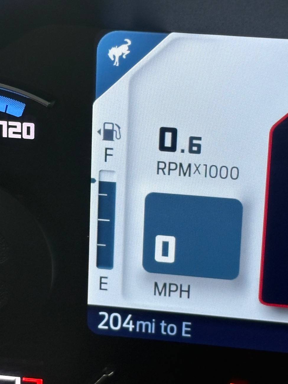

Took a road trip, a couple “full” tanks seemed like they were working down quickly; paid closer attention at a fill up:
Ford Bronco Fuel tank not filling IMG_1139
Can’t top off the tank, the pumps shut off. This is a new one to me. Level ground, level unloaded Bronco, nothing serviced in or near on the gas tank recently. Never ran it down to empty. Any ideas?

Could actually be full and something wrong with the sending unit instead.

Thanks. That would be a straightforward, if unexpected one at 14K miles, but what else is new on the list of odd things that fail early on.
I’ll put some fuel cleaner in and run til the next dealer visit, maybe they will warranty it if it doesn’t clear up.
Or do myself if they don’t - I have half dropped the tank, to put armor on, is it easy to pull out all the way and put a sending unit in?

Yeah once the tank is down it takes 5 minutes to swap it out. You’ll need the whole pump assembly unless you can find something wrong with the factory one and fix it. Ford doesn’t sell the sending unit separately

Did your range go down?
Yes for sure it did - per the tank screen and the “50 miles til empty” message. But I have not tried to drives at empty for another 40 miles or something.

I tried that, and used to pump gas for my job. No this is a brand new thing. It’s probably the sending unit and “float” if there is one that failed for one reason or another.

I'd run it to empty then fill it up n see how many gallons it takes n maybe watch the gauge as it fills.
