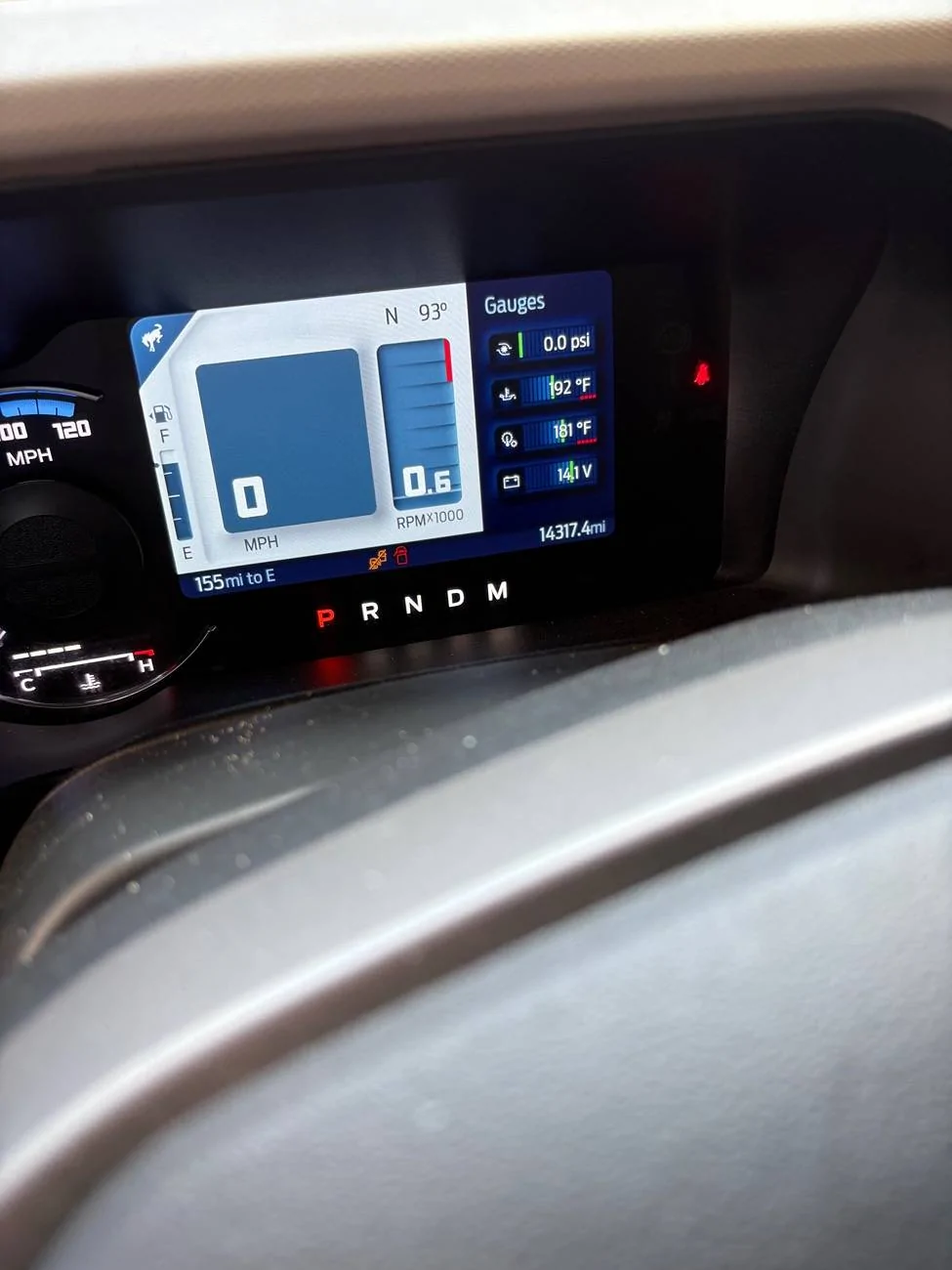

Still have not driven to empty first, after which I will test another fill up and count the gallons added- another 60 miles to go.

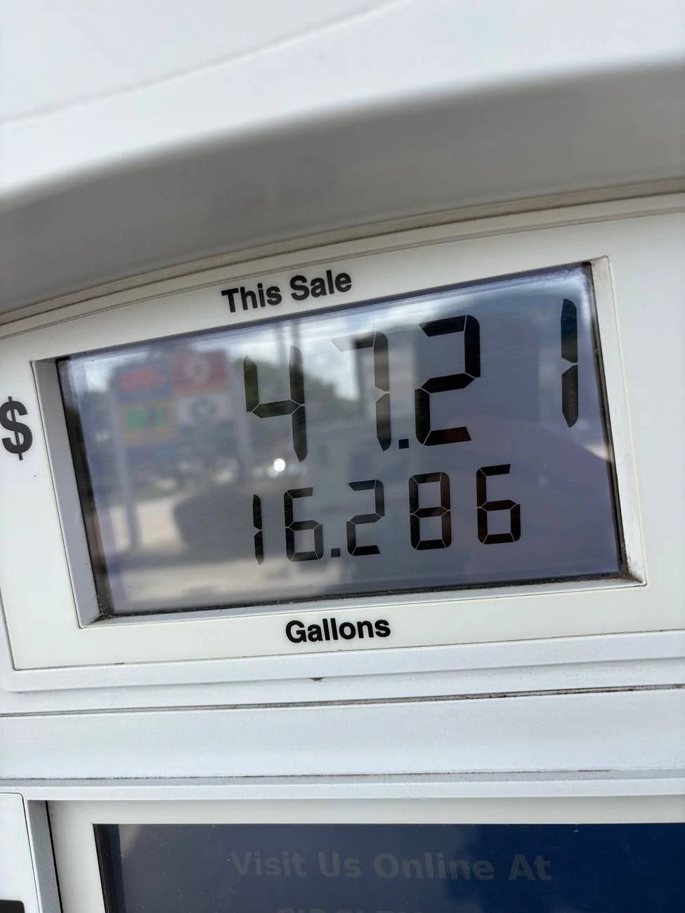

Gas fill up at 4 miles til empty; 20.8 gal tank capacity, only took about 16. Damifino. I’ll let the dealer figure it out.

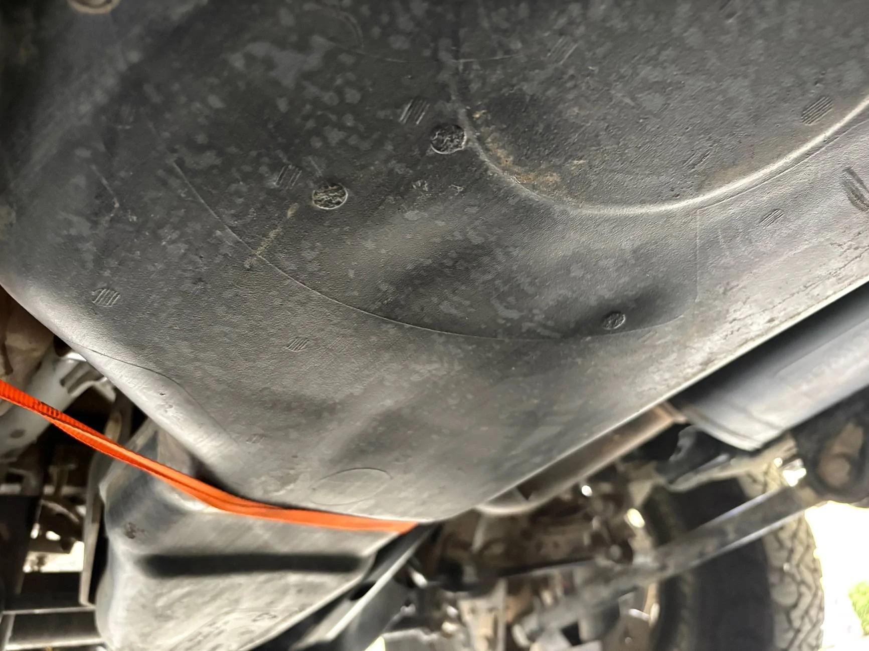

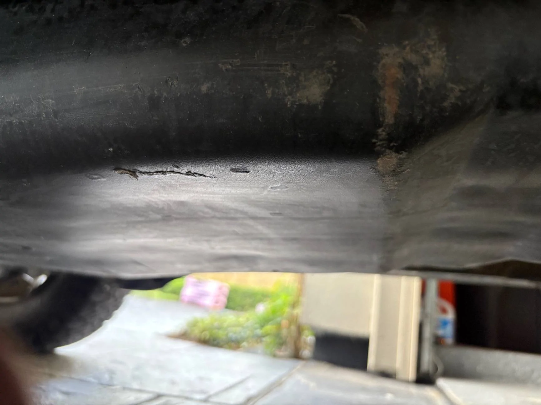

Dealer said drop the tank and replace the internals, after seeing a dent that I missed in the tank’s bottom. I have a dent puller I’m going to try, on the chance it pulls the float system (assuming that’s the problem) back into alignment. If that doesn’t work I’ll drop the tank out and go from there,

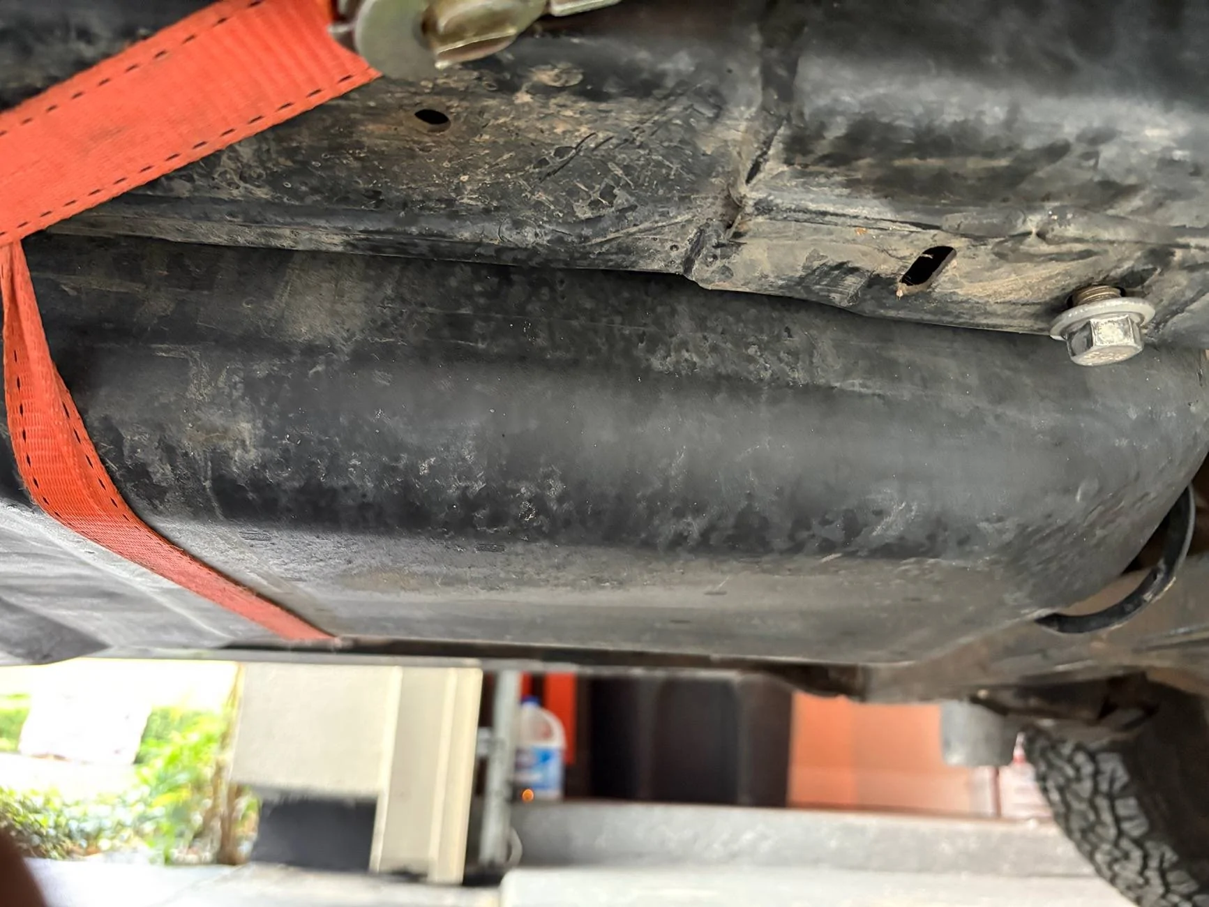

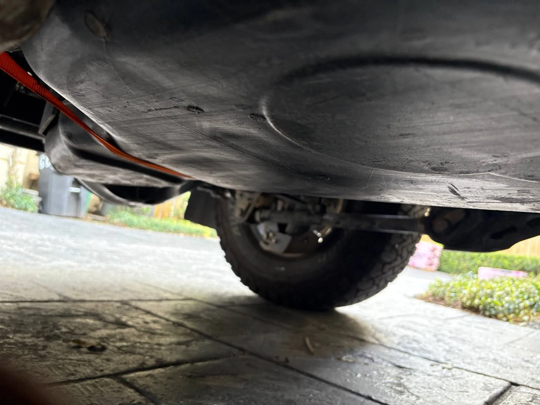

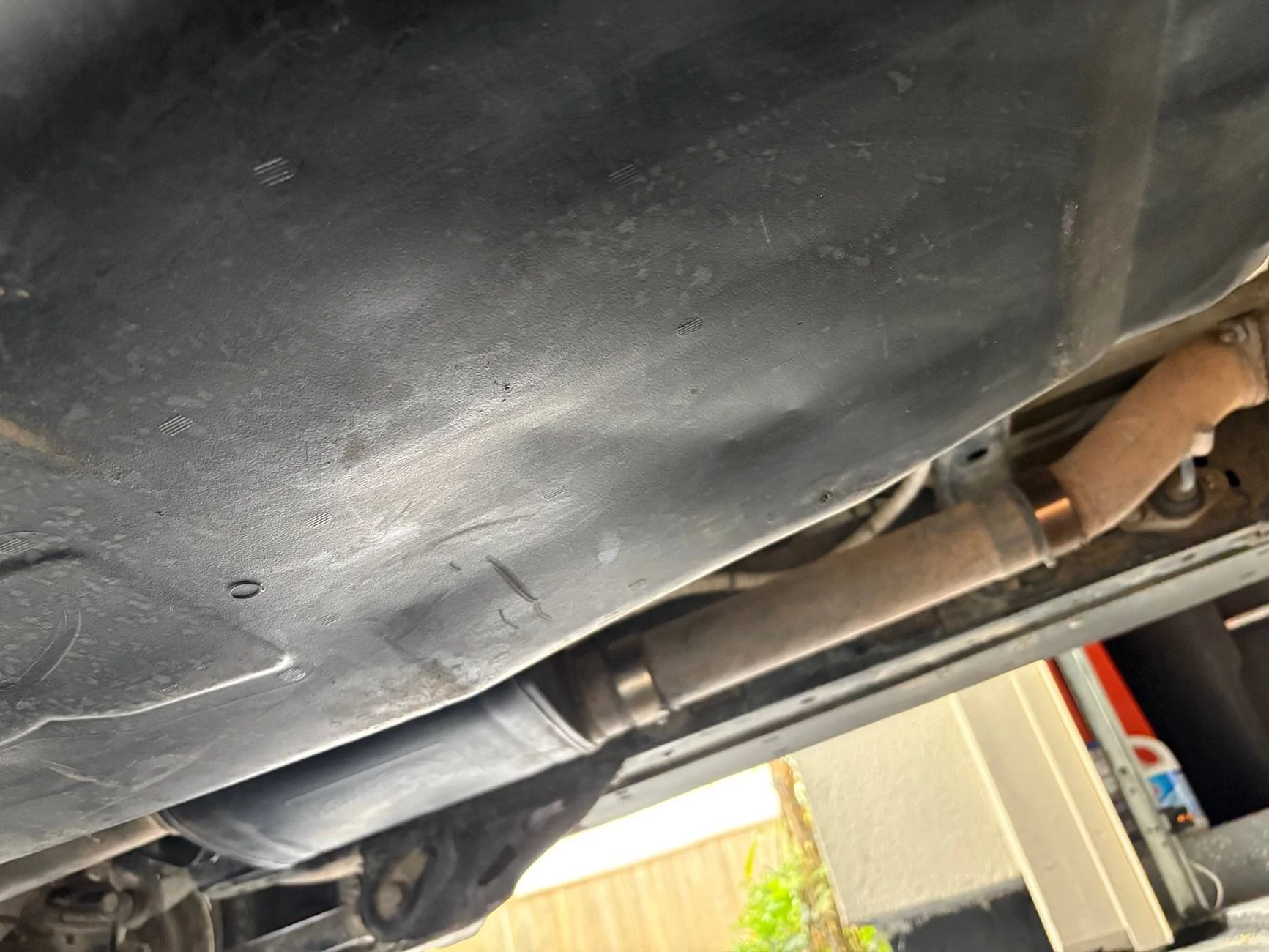

Some pics. Hard to see dents well, and I don’t know where might have impacted “the float”.
I'snt your Bronco still under warranty, then take it to a good dealer and let them fix it. That dent was likely there from the factory unless you had an incident that caused it.
