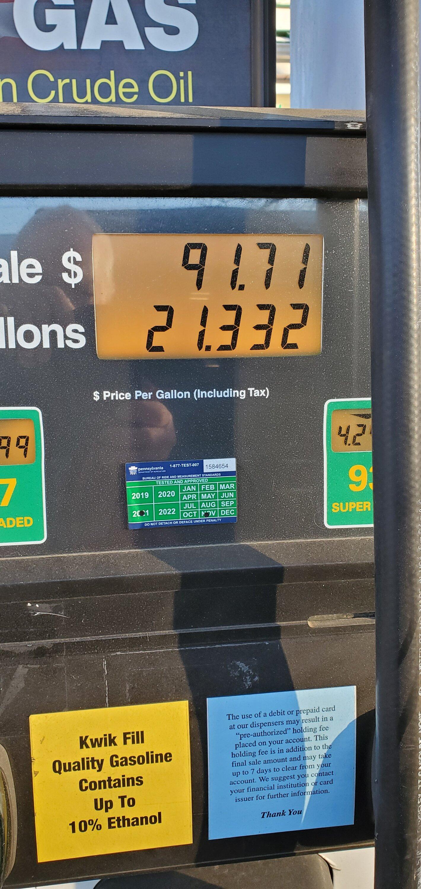

And what is the max fuel you ever added to your 4-door? Stated fuel capacity on the 2021 (maybe all years) 4 door is 20.8 gallons. I filled up the other day with gauge showing 15 miles til empty, which "should" mean around 1 gallon left. Nozzle clicked off promptly and I never add more after that as it causes havoc with the vapor containment system and charcoal containers, but that aside, I was shocked somewhat when I ended up with OVER a half gallon more than factory spec for a freshly built vehicle that had no other fluids added. Yes I understand that the tank itself may be 20.8 as spec'd but i would actually think that the 20.8 includes all hoses on the fill side plus lines between tank and engine but my first thought is that the county weights and measures department is long overdue to test this pump (and I plan on reporting it as charging for more gallons than are actually pumped is a crime)
IN any event, has anyone topped 21.3 gallons or waht is the most you have ever filled?

Listed capacity should be roughly 80% total liquid capacity of the tank which leaves room for vapor expansion during warmer temperatures. If the vehicle is not perfectly level it can allow extra fuel to be added. Generally the fill hose enters a vehicle tank slightly below the highest point which allows the hose to fill with fuel and activate the shutoff on the pump faster than the trapped air can escape back up the fill hose.

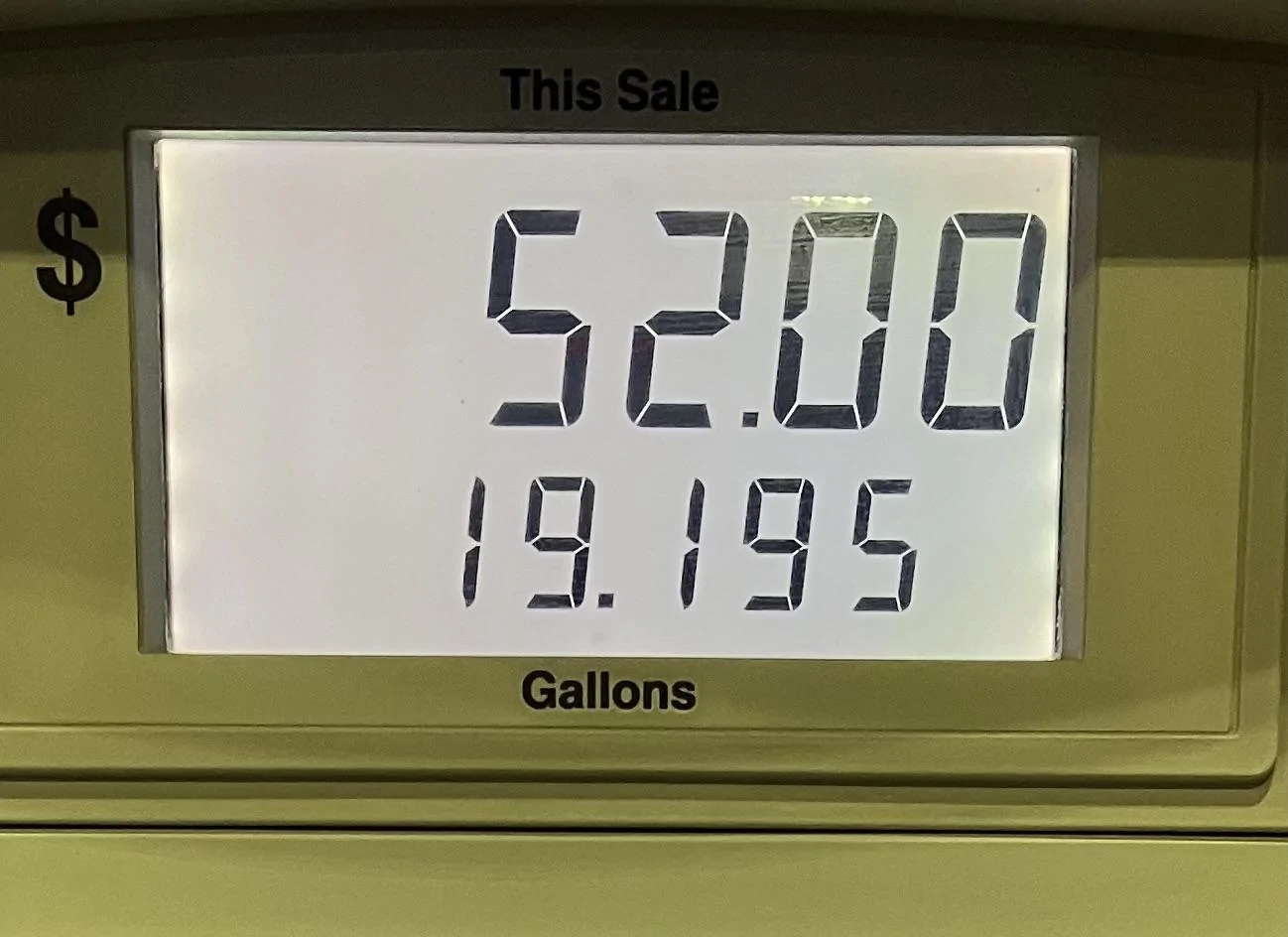

I have never exceeded 20 gal and today with 30 miles to E i was shocked to put 19 gallons in my 22 4dr Badlands. So I took a picture thinking my pump may be off ad well and checked the forum to verify tank size. With gas mileage 16 mpg that would give me two more gallons if empty (21.19 gallons). Take it for what its worth.

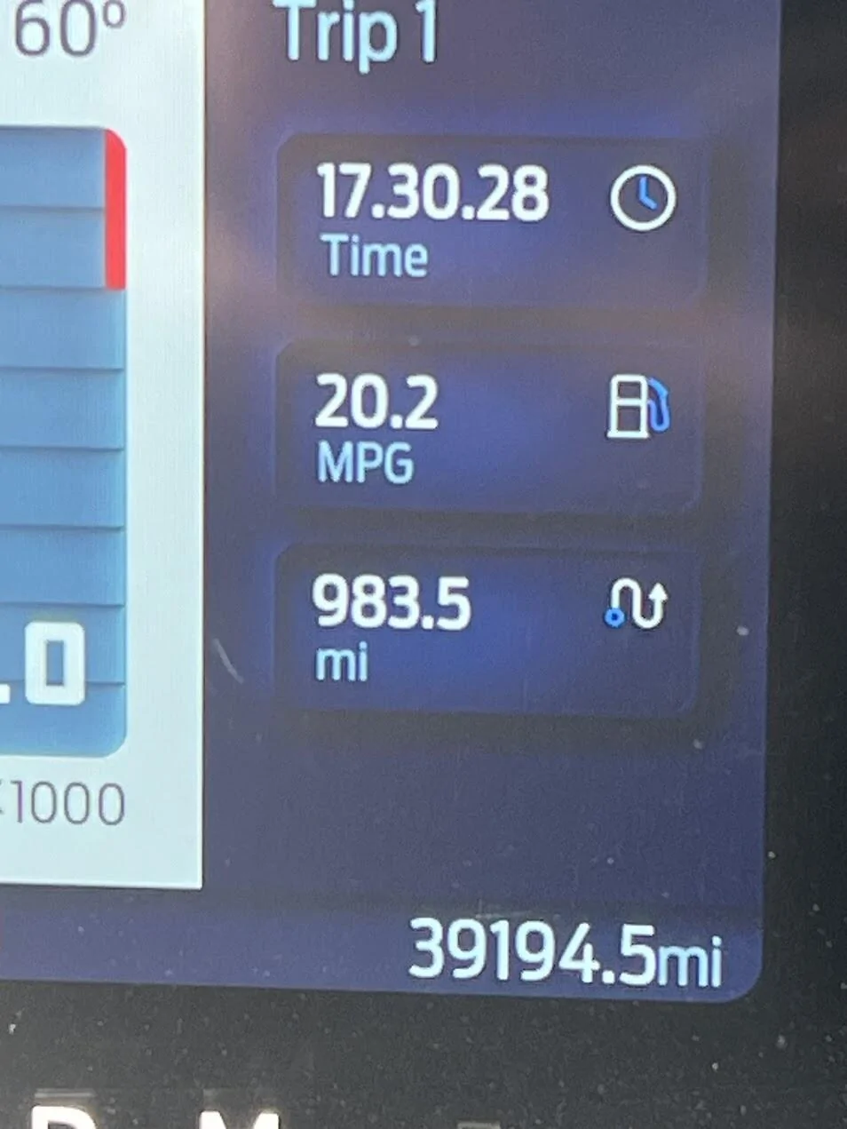

That first trip getting 20.2mpg was probably under 20mpg actually due to speed reading a little fast. Tires were worn down and had ~38psi.

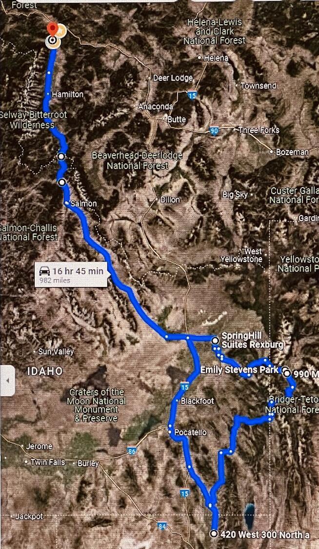

More recent big trip:
Ford Bronco How BIG is your fuel tank? 1725505899212-i8
Ford Bronco How BIG is your fuel tank? 1725505935954-se
With 35" KO2's at 35-40psi (cold to warm) and 10/32" tread depth. Speedo almost dead on, so probably close to actual 20mpg. Average speed 56mph. Not too many mountain climbs. Pretty much under 73mph the whole time, no interstate driving, quite a few miles of under 60mph. Oil was pretty damn hot again (220°F) due to ambient temps being in the 60's so grille louvers closed - that might help a little.
I was just putting 87 or 85 octane in it since I wasn't getting into boost much. I use Costco 91 for in town driving, especially with my lead-foot wife driving it since it's her car.
I screwed up and didn't get the brackets for the soft-top that I got from a lady in Jackson, WY for $200 brand new. She doesn't have a socket wrench so I'm sending her a prepaid shipping label and box with a wrench in it for her to get the brackets for me, since Ford has the main set of brackets on perma-back-order and the rear receiver latches priced at $1340. I bought the top brackets since they have those in stock and don't want to make the Jackson lady take her top off to get to them.
The stop in Utah was to get Hoss 3.0 Fox shocks that I put on already and am enjoying. When I filled up in Rexburg, ID, my range for the tank was 450 miles. I haven't let it get low enough to see another 22gal fill-up that still baffles me, lol!
