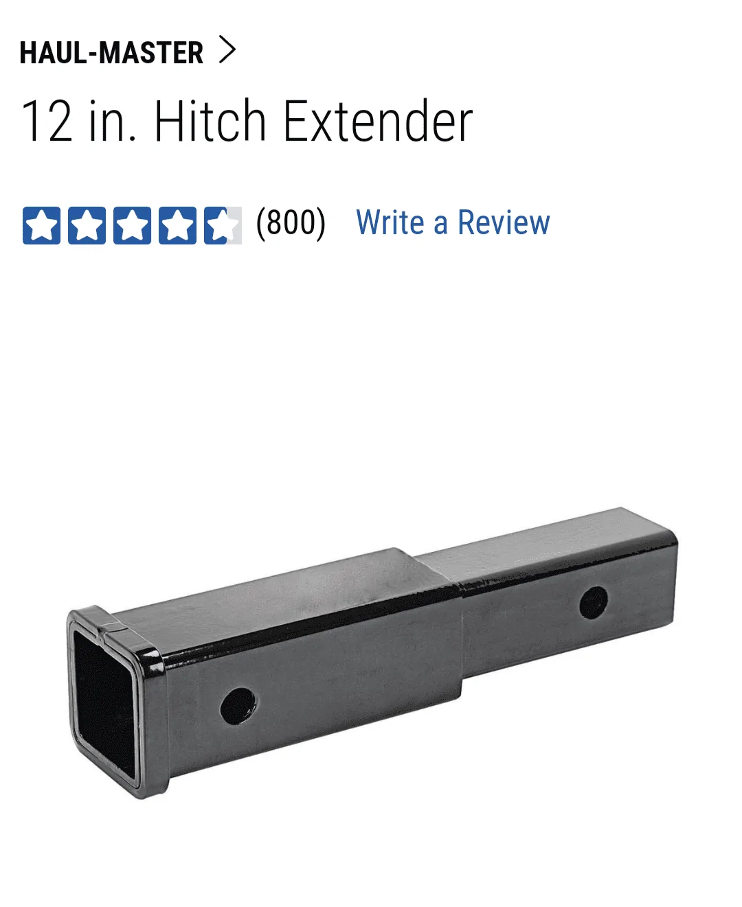

Here is a link for many lengths of extenders. If you go longer... you can push out your trailer hitch enough that you can open your tailgate without hitting the ski's hand crank.
https://www.etrailer.com/dept-pg-Hi...GarqYkF1p-B4caZu56SwWQMayOvsPASxoCkUoQAvD_BwE
Find what you want then search amazon...
With an extension, the coupler would clear the tire and I wouldn't need to open the trunk anyway.
I had bought one a while back but never used it. I think a lot of extensions really shouldn't be used to tow, but rather be used for bikes and what not. LocknRoll as mentioned above is probably a solid option. thanks Gary
