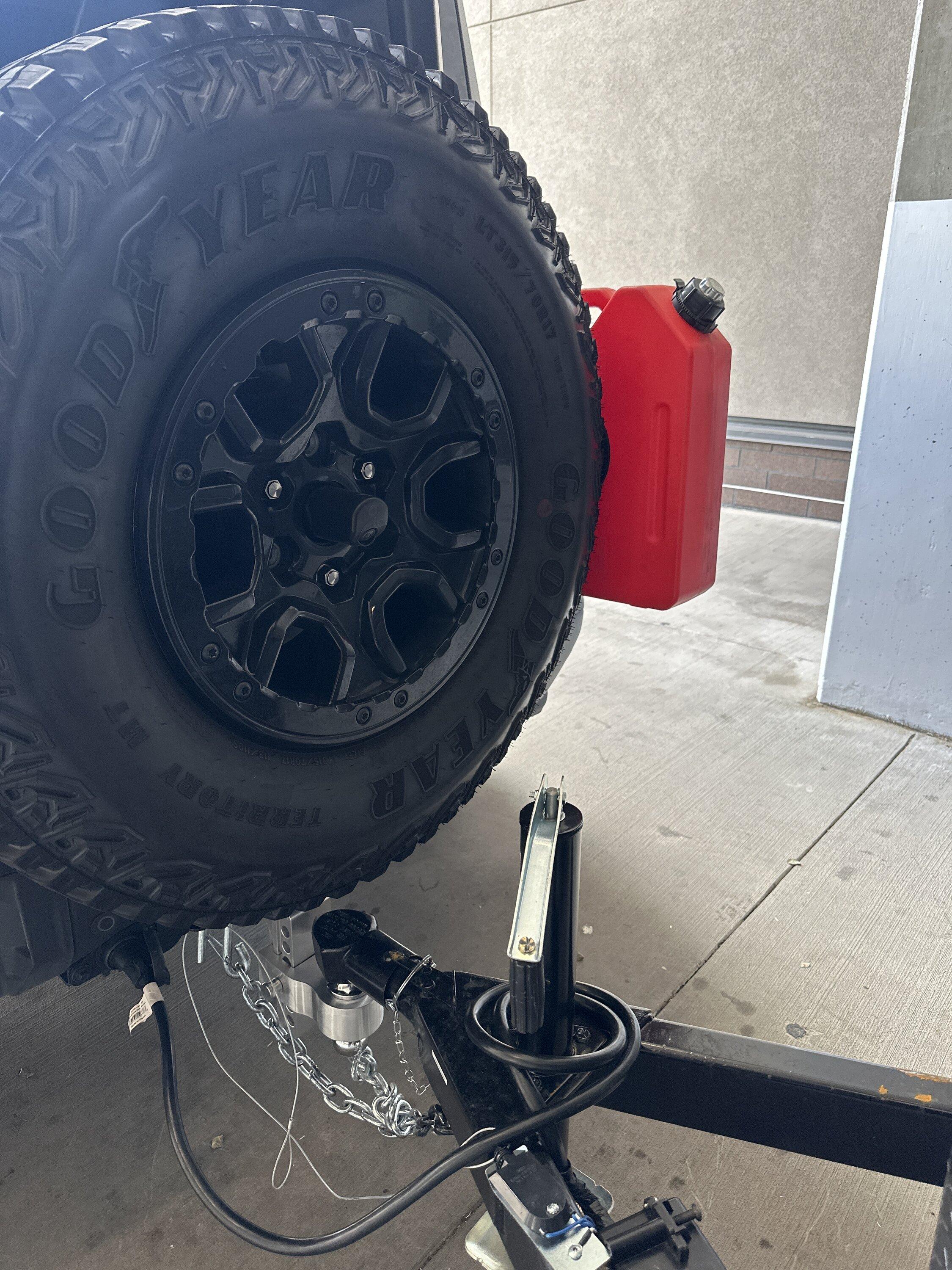

Nice trailer setup, make sure the tongue jack does not hit the spair tire in a tight turn
electric brakes (y) tongue weight will be your freind as well to keep it from swaying back and forth. Can be a little scarry with a short wheel base like a Bronco

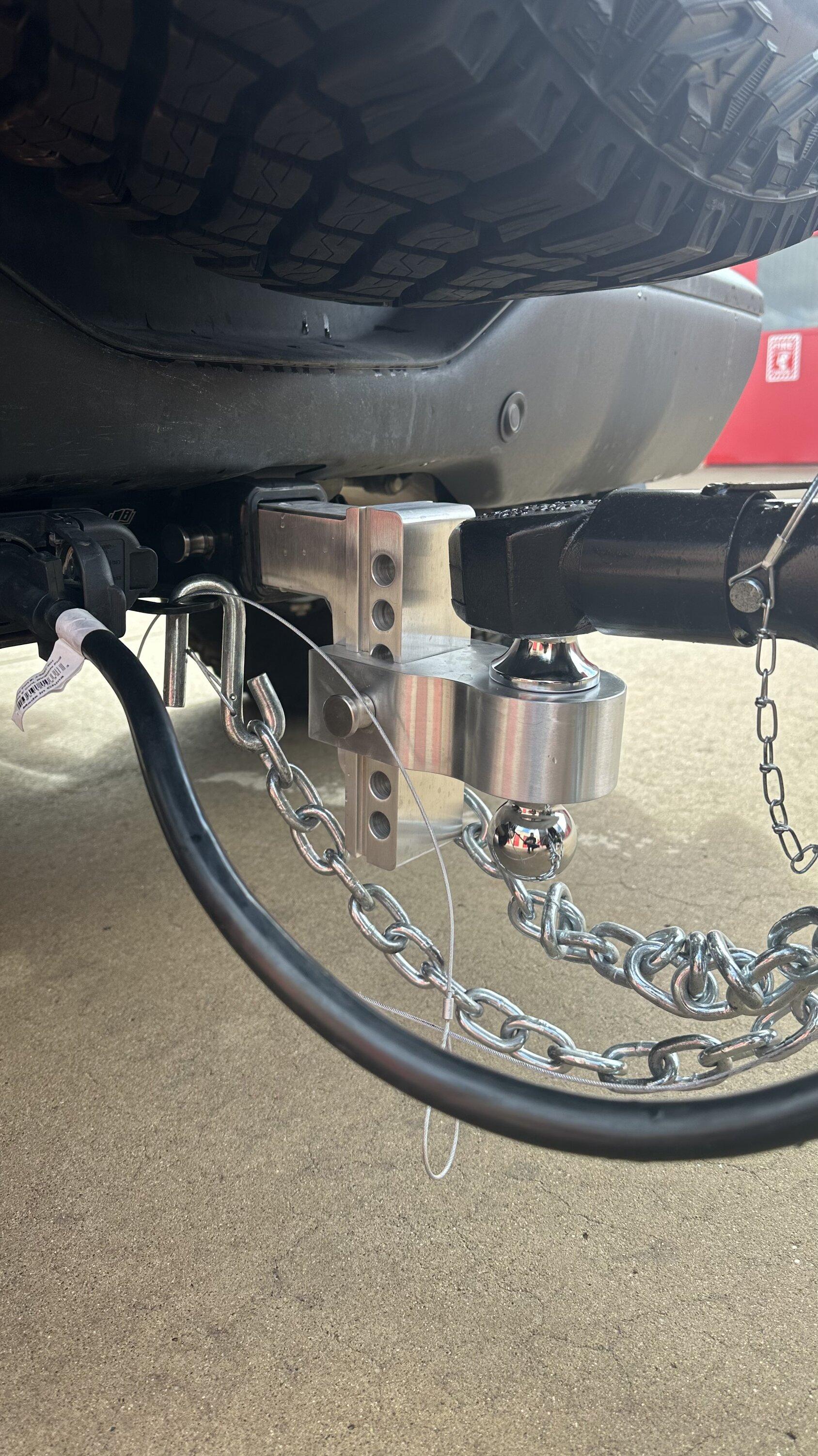

This is the trailer hitch that I bought. I wanted a cushioned one as suggested here but it wouldn’t have arrived on time.

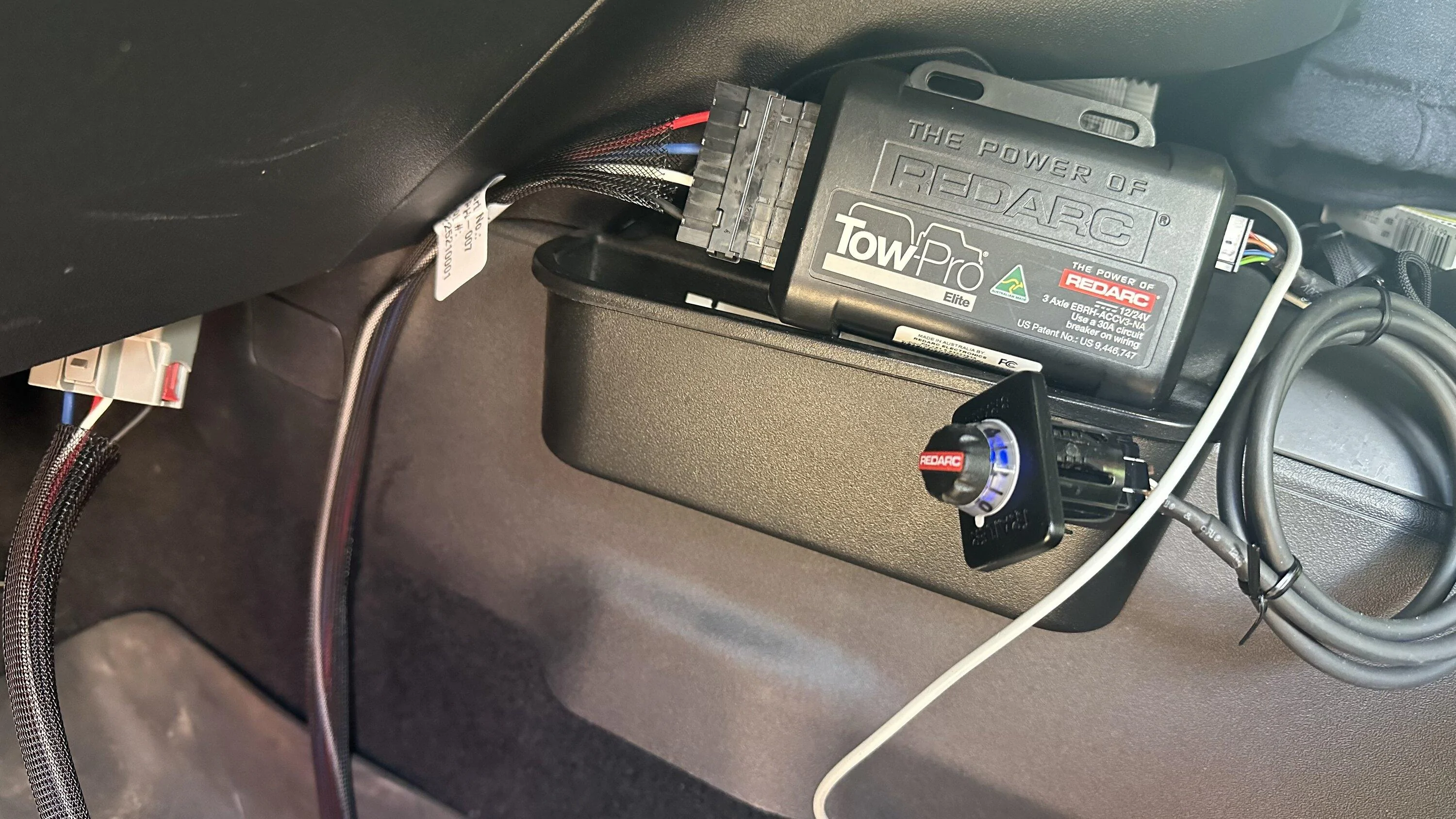

I bought a redarc tow pro elite from Amazon (Tow-Pro Elite Electric Brake... https://www.amazon.com/dp/B08TPS46BX?ref=ppx_pop_mob_ap_share)
Though I missed the fact that It didn’t have the Bronco specific harness (duh!) so I ordered it separately (Tow-Pro Brake Controller Harness... https://www.amazon.com/dp/B07GNM9V4N?ref=ppx_pop_mob_ap_share)
Installing it was a breeze but definitely watch out for the sharp edges under the steering wheel! I don’t have time to drill so it’s just a hanging wire for now, but will do so when i settle!

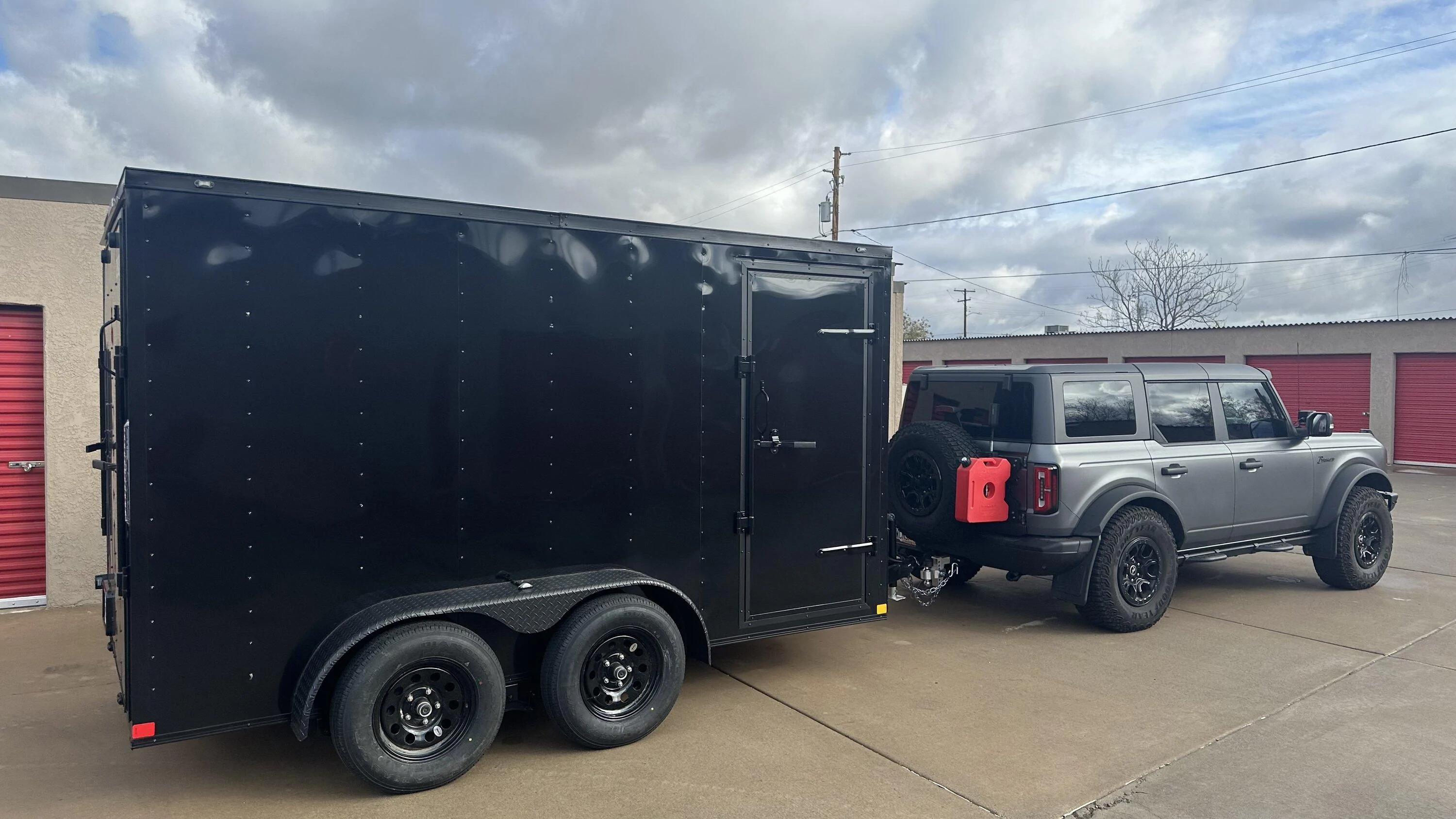

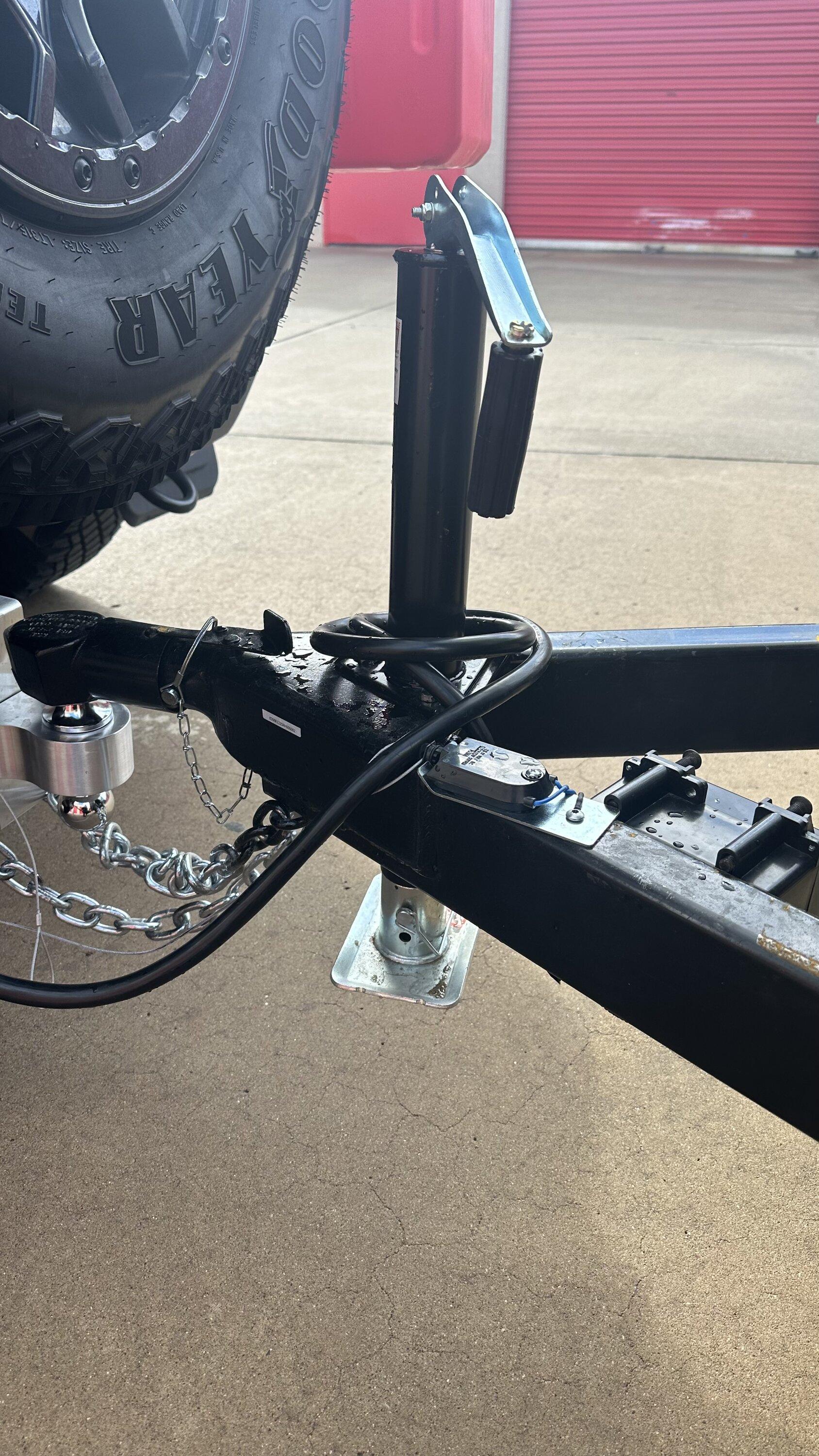

I didn’t have to get an extender (and honestly preferred not to based on my reading on this forum) though I didn’t have to take off the spare tire. I did try to take a sharp turn and the tongue jack barely misses the tire, but I’m still worried about the gas can in the back. I’m taking the least number of turns possible haha! But I’m mindful of that and thank you all for the reminder!
Also, I have no way of measuring tongue weight but I was mindful of placing some heavy stuff in the front to avoid sway as you all suggested. A post on this forum recommended 10-15% of the weight to be placed in the front for this reason!
So far, I’m running at 12mpg which is phenomenal all things considered.

Wow. That tandem axle makes a huge difference in the way a 6*12 trailer looks. Pretty sure it’s gonna be more stable as well.

I got a 6x12 trailer that weighs 2000lbs with a ram coupler.
trailer brakes: redarc tow pro elite. The dealership was out of it so I had to order it straight from the website not knowing that I needed a specific harness for it. Which I ordered separately.
I bought an adjustable tow hitch as well cause I didn’t know the height of the trailer. It goes down to 6”.

I know this thread is a bit old, but I came across it when looking for solutions to the trailer tongue and spare tire clearance issues.....
My rule of thumb is that if the trailer has brakes and has a load on it, use a brake controller (unless of course it has surge brakes already). There's a reason that the rental companies use surge vs electric because they know most don't have or know how to use electric controllers.
I've essentially resolved to dealing with moving the spare to the trailer to get the best overall result - keeping the tongue weight as close as possible to the rear axle, keeping the ball height as close to level for the trailer under load, coupler clearances to allow connection/disconnection, trailer jack clearance from obstructions (spare tire).
I hope that the OP's travels went well. The picture of the main brake control unit sitting in the center console shifter box does not tell the whole picture, but I hope it was not loosely free to move about during its use. The controller box (whether old school decades old, or new), uses inertia sensors to activate the proportional trailer brakes. It should be solidly mounted to the body - preferably a metal structure frame member like a dash support. The manual switch will still work, but the proportional function will not be reliable if it's not essentially solidly mounted to the body.
