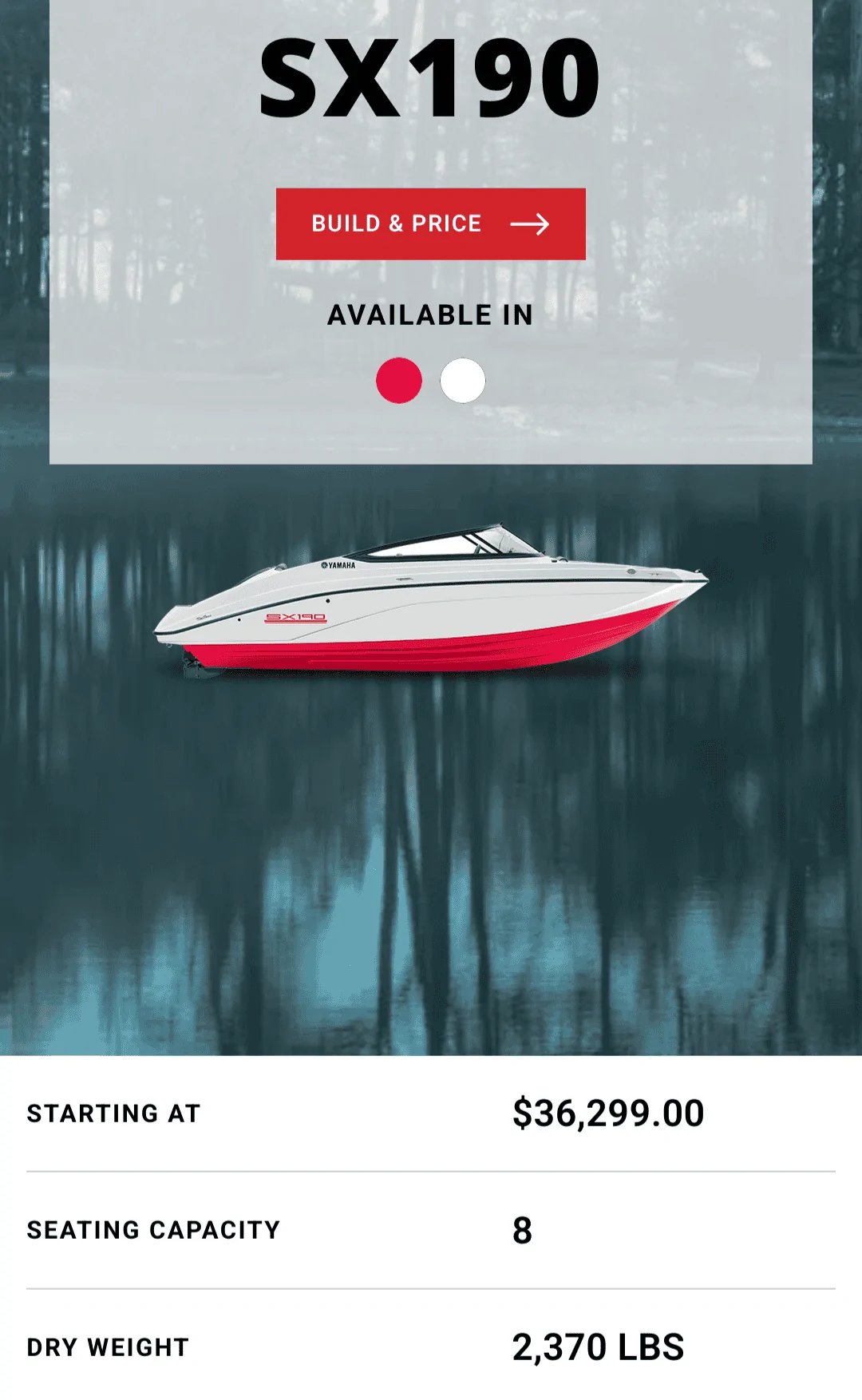

Not sure why you said that your boat has a dry weight of 3050lbs, but best I can tell is that your boat has a dry weight of 2,370lbs. so even loaded up plus a trailer you should be good to go.
Ford Bronco Towing 1000020816
Seems everyone is super paranoid about towing with the Bronco. As long as you stay within the ratings, you shouldn't have any problems.
I have a 2dr with the 2.3 and 7MT and have no qualms about using the towing ability to the fullest.
