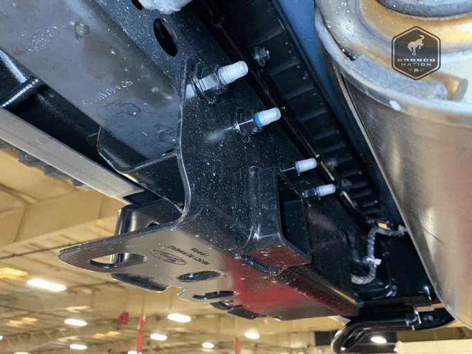

So, for like the third time, could you please quantify for the class why this design is "weak."
I don't know if this is helpful or not, but this method of mounting is exactly how the class-III receiver on the WK Grand Cherokee I used to have was mounted as OEM. I had it off once because I had to shorten up the receiver tube that extends forward weld and the two center bolts in order to fit a 32" spare in the underbody tire carrier (it was that close).
But my point is that this configuration can be reasonably stout; the WK was rated to tow 7200lb, as I recall. I only went up to about 4500 myself. But you had to have the tow package on a 5.7L model to get that rating, which is what I had. V6 models were only rated to 3500 lb, but they also only got a class-II receiver for a 1.25" drawbar.

The formed cross member on the frame will be between 16ga and 18ga material... those “generic” receivers are 3/16ths to 1/4 wall thickness. The bolts, whether in shear or tension, are not the weak link.
