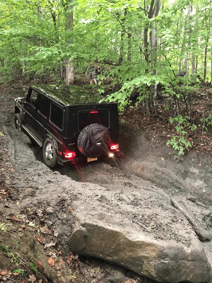

So we agree, bigger tires, more lift, heavier duty axles / drivetrain make for a more capable off road rig.
Wrangler Rubicon, Merc G, and (hopefully) Bronco Sasquatch/Badlands are engineered from the factory to handle the load from 35" tires.
Here's an obstacle I couldn't drive past in my G with 34" tires and 40mm (1.6") spring spacers. Wranglers with 35's and 2.5" lift were able to get past. There is no bypass, so I and another Wrangler with 33's (no front locker) back-tracked and met up with the group on the other side. No big deal, but a real world example where I (not some arbitrary 98%) got to the limit of the truck.
And yes, some of us will not be afraid to scratch and dent our brand new Bronco's to find their limits.
I'm glad your SUV works for the trails you want to drive. The GC Trailhawks are very nice.
BTW, this is a road in Vermont. Think it'll be part of the Brondo Off-Roadeo? :)

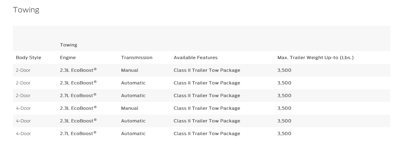

What's been confusing some people is that it's still a 2" receiver... which some think makes it a Class III...
But it is *absolutely* a Class II
Ford Bronco Towing capacity Tow Ratings

Agreed. But I think they put a Class II hitch on it because the tow rating is Class II not that the tow rating is Class II because it has a Class II hitch. There is nothing wrong with the factory hitch, It attaches to a cross member that is welded to the same frame that a Class III receiver will bolt to. The bolts that hold the factory receiver hold tongue weight in shear, tow weight is held in tension on the cross member. After market hitches hold tongue weight in tension and tow weight in shear. I might argue that the factory hitch set up is actually superior.
It is something besides the hitch that is limiting capacity.

Ford's own GCWR numbers show a TWR higher than 3500lbs for most builds. That's all by their own testing. The Class II receiver definitely pulls down the tow cap of the lower trims as currently tested.
