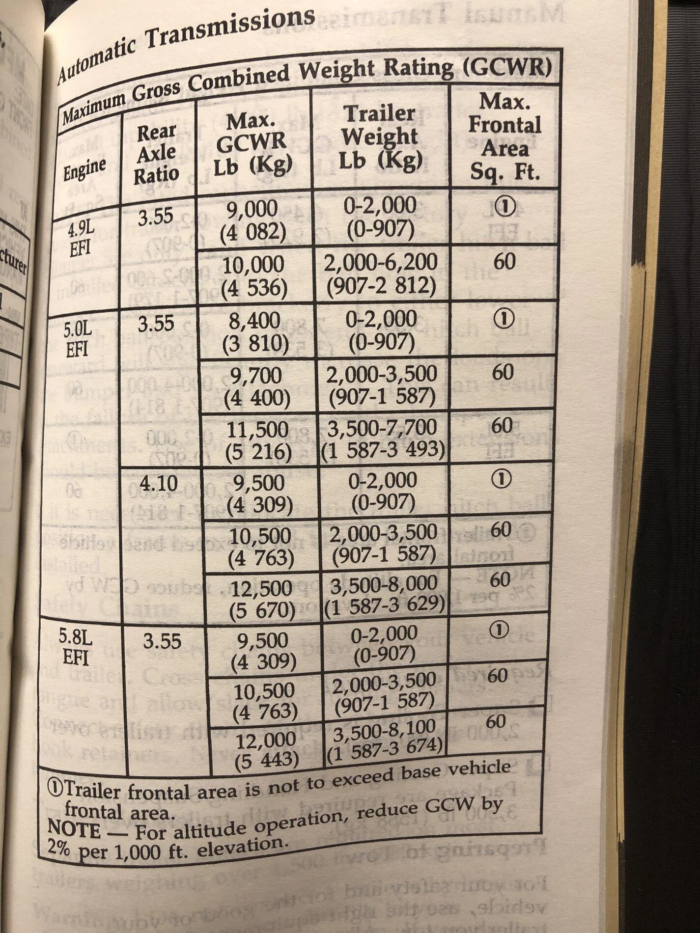

Is there a small chance that we can reduce the "towing used to be better" mantra (similar to the hp lamenting)?
Just to point out this is rather misleading, the tow caps varied in the 90s broncos based on engine and option packages, but had as high a 7-8k variations available.
straight out of a 90s bronco original owners manual... all engines had options up to 6k, the bigger engines up to 8k.
Ford Bronco Realistic 2.3L Towing Capacity? 18422330-2ADD-41CB-B12C-720C0149B042
This one is from a 91, so 4th gen as the 5th gen started 92, but tow caps had similar changes between engines/options(carried over same engines and basically same chassis). Have an owners manual from a 95 somewhere as well, had a 7k tow cap with the 5.8. I’ve towed 6k behind both a 95 and a 91 bronco.
