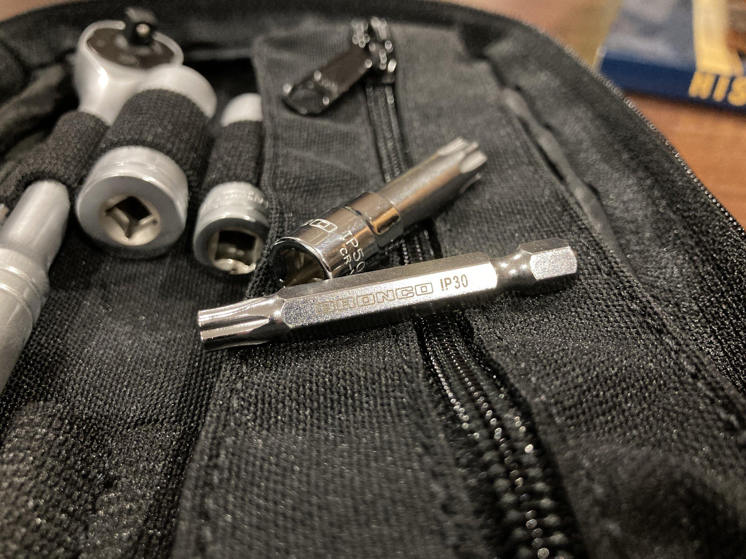

Just an FYI for anyone planning on working on their bronco with the Torx bolts on it.
They are a mix of Torx and Torx PLUS. Torx PLUS is not the same as Torx even though they are the same size.
Take off your beauty rings with a T45 Torx bit and you risk stripping them at worst and frustration with the bit "camming out" at best.
Wheel trim rings are regular Torx. Bronco bolts are Torx+
I talked to TWO different auto parts stores. The individuals I talked to had never heard of Torx PLUS and assured me that Torx bits would work fine.
$24 to me is a cheap investment to make sure you have the right tools for the job: https://smile.amazon.com/Neiko-10086A-Tp8-Steel-Socket/dp/B004UC9WJE/
Courtesy of @VoltageDrop a very reasonably priced set Made in USA:
https://smile.amazon.com/gp/aw/d/B005OH0MES
Apologize if this posts belongs somewhere else but I feel like it should be more prominently displayed if it is somewhere else.
Thanks for the US alternative, just ordered!

Torx Plus = TP45
I believe Bronco Bolts are TP27
Can anybody confirm this? I ordered a TP45 (got the size from another thread here) and it doesn't fit. I don't have any others to size it to so hoping someone in this thread has done this and has the right size to pass on. Thanks!
Koz44
Alex
Dec 29, 2021
152
177
Westchester County NY
2 Door Bronco Outer Banks
There is another thread about this right now as well. You will need several different Torx+ bits and at least 1 standard Torx (that was supplied with my kit). The various size bits are listed in that thread. I purchased a Torx+ 40 for my modular bumper and it worked.
In that thread they are saying NOT to get TP bits. Apparently there are Torx, Torx+ and TP Torx.
