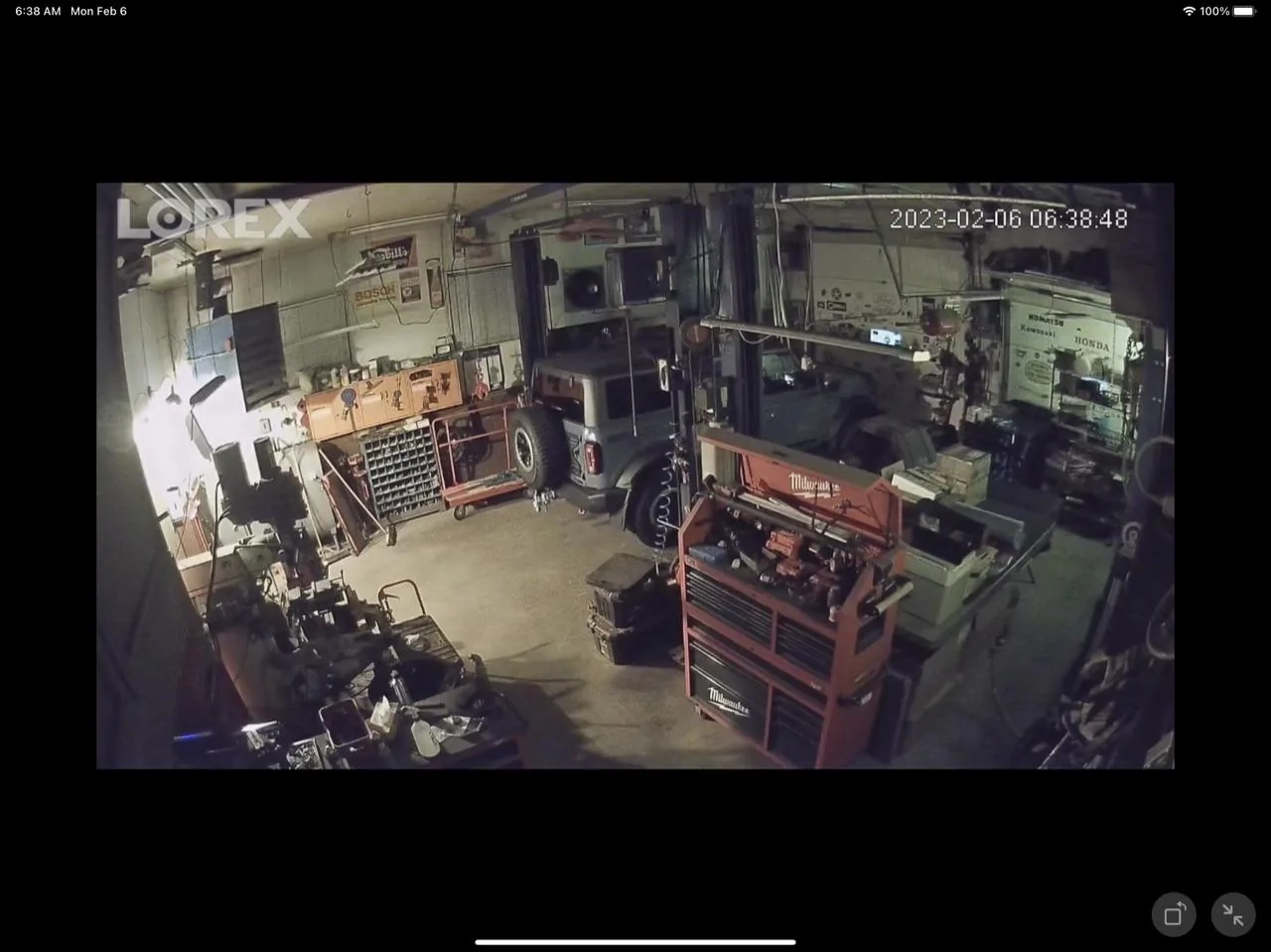

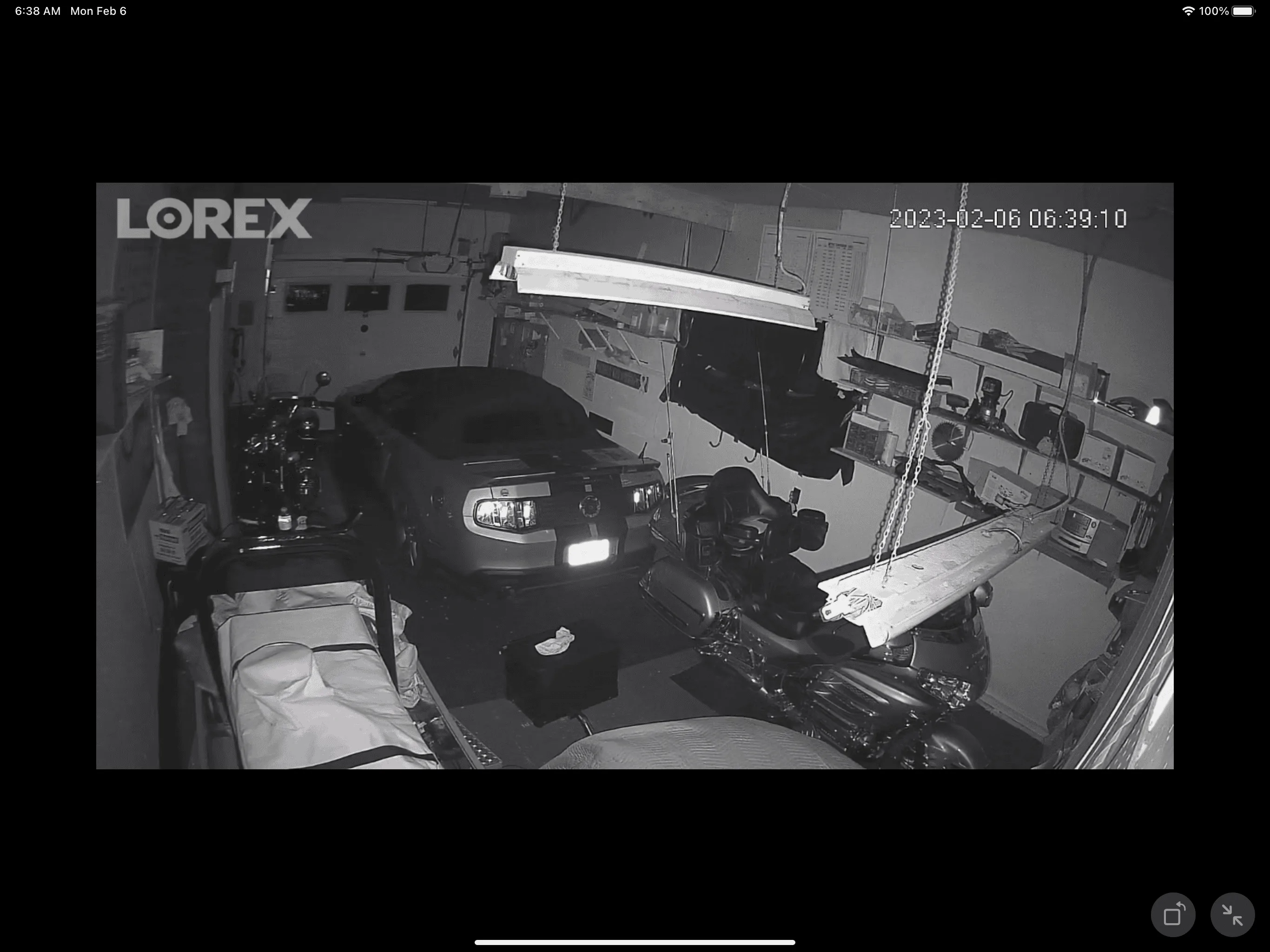

Well I keep my Mustang in the garage. It’s only used in the summer months. The only thing I’ve ever done with it was regular maintenance and a battery Tender on it when not used. It’s a 2012 and never had an issue doing it thus way. Same with the motorcycles. Put them up on their double stands, drop some fuel stabilizer in their tanks, plug them in and wait till spring. Bronco is the same way.
