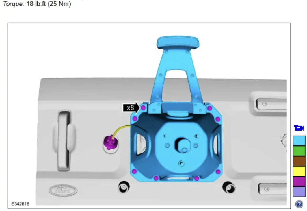

Anyone have the torque specs for the spare tire carrier itself, for the bolts to the tailgate?
(not the spare wheel)
I'm trying to cover bases for the tailgate click back there.
Ducati1098
10,008
23,280
Midwest
Ford Bronco Torque Spec Reference List IMG_8814
