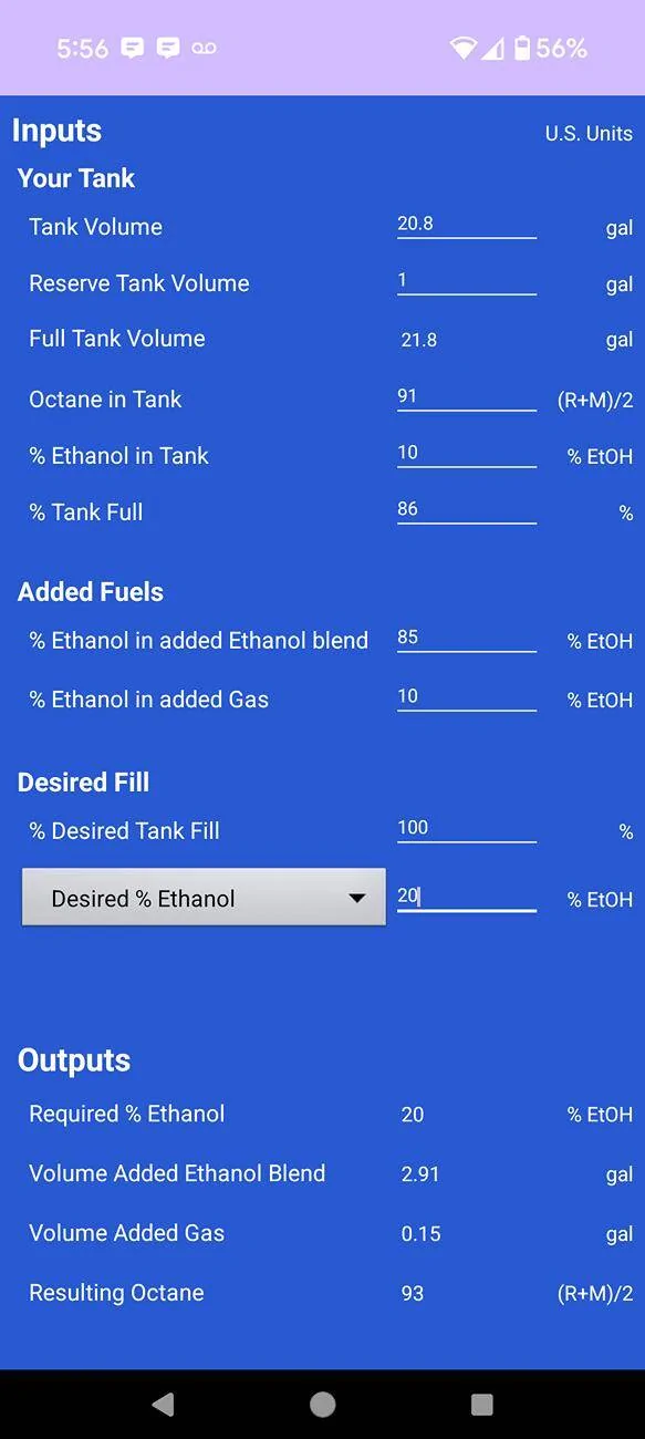

Your mix numbers are spot on. Coincidentally, given the total lack of an ability nor information anywhere on how to calculate octane from %EtOH (as well as a lot of free tables and information online that are completely wrong...), I will be bringing this octane calculator app to the Google Play store. It's based on actual lab test data and published research out of University of Melbourne and Princeton.
Since E85 has to be 85% minimum %EtOH there in NM and assuming your 91 gets there with 10% EtOH, here is your quoted mix. It is indeed E20 and 93 octane.

I have the FP tune on a 2.3 manual. Would like to have an app now that you mentioned it, never thought to look for one. There are a few online calculators, all of them that I found wonky to use, I have a couple bookmarked on the desktop somewhere…
Interesting. I suspected that the FP tune would adjust beyond 93 octane, perhaps 94 or 95, but your data indicates not.
I am going to log mine (Raptor with FP tune), 87 and 93.
I hope to have the app in the Play Store very soon. It will be paid, not free. Its been quite a project actually...
Yep I agree - my data/experience suggests that the FP tune for the 2.3 maxes itself out (i.e. -1 indicated on the Lrnd_Knk_Mod gauge on the ProCal) sometime around 92 octane, not having the ability to utilize more.
I calculate my octane conservatively - assuming the E85 I'm using is a "winter" blend of at most 70% ethanol, and possibly as low as 98 octane. I should test it of course (for ethanol content) but I'm lazy. Since I don't want to push my in tank ethanol higher than 25% or so I don't want to mix in more, but with the tune maxed out what would be the point 🤷‍♂️
You're in NM correct? I believe NM regulations require 85% EtOH in E85. Oddly here in CA it can be 79%.
As posted prior, right about 3 gal of E85 will get you 93 and E20.
