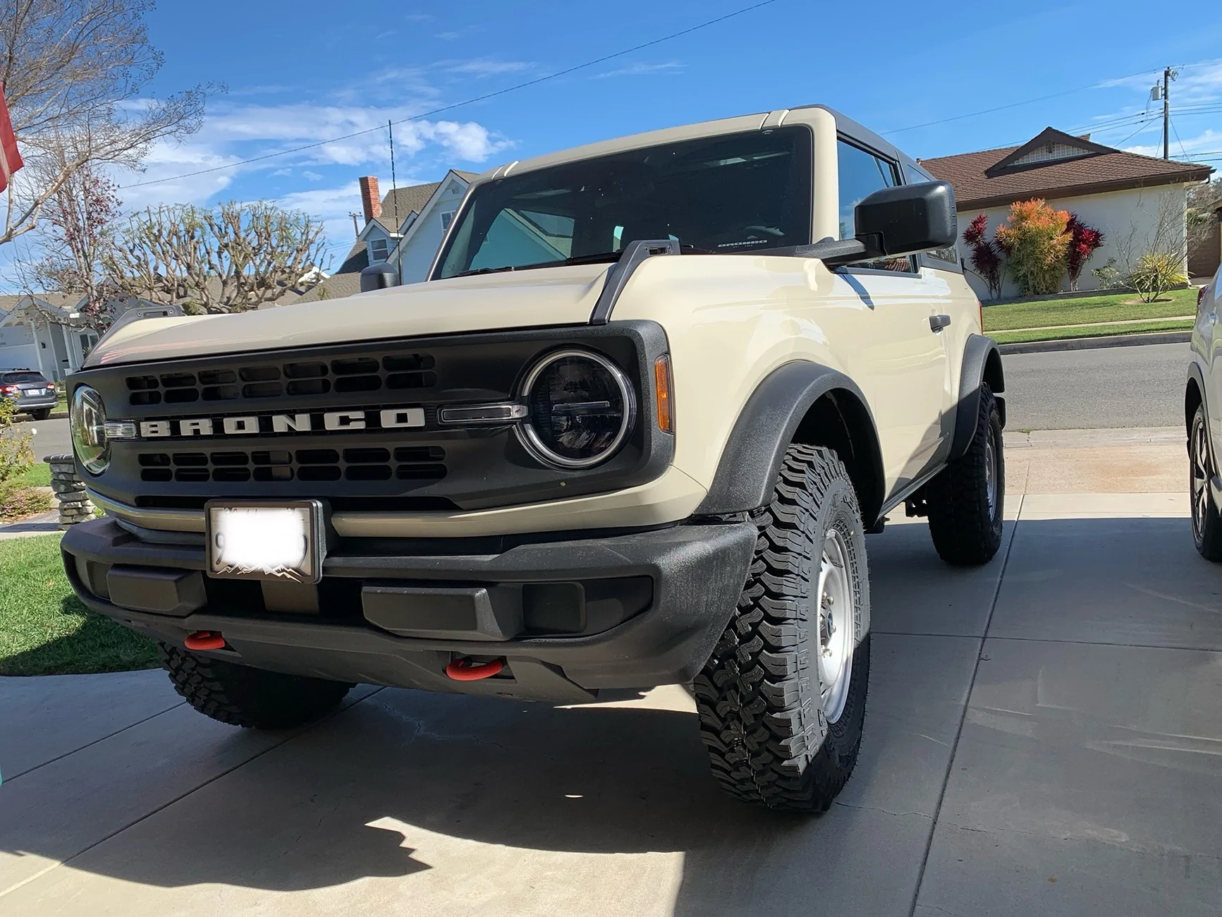

Ford Bronco Tire size and weight - Base Bronco 20240219_173941
I've got a few thousand miles to figure it out.

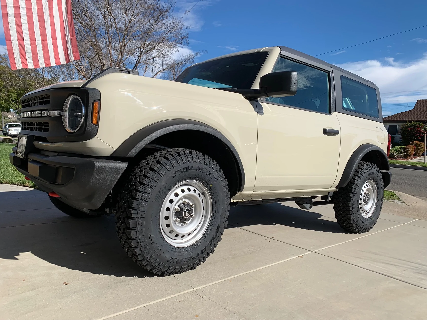

DONE!
255/85 16. Falken MT01.
Still feels peppy and agile. MT road noise is noticeable over stock. Seems like a natural and capable fit for a run about and occasional desert runner.
Looks bitchen as far as I am concerned.

Very nice. Trying to wear out my 265 Falkens so I can get that 255x33 goodness.
