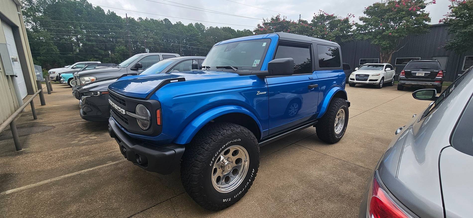

33s (295/70r17) 17x9 -6 offset non sas suspension. Its a perfect setup for every day driving. I have pro comp coilovers waiting to go on and gonna need tires soon. At that poing Im going bigger.
I do like silver rims. Looks good.
