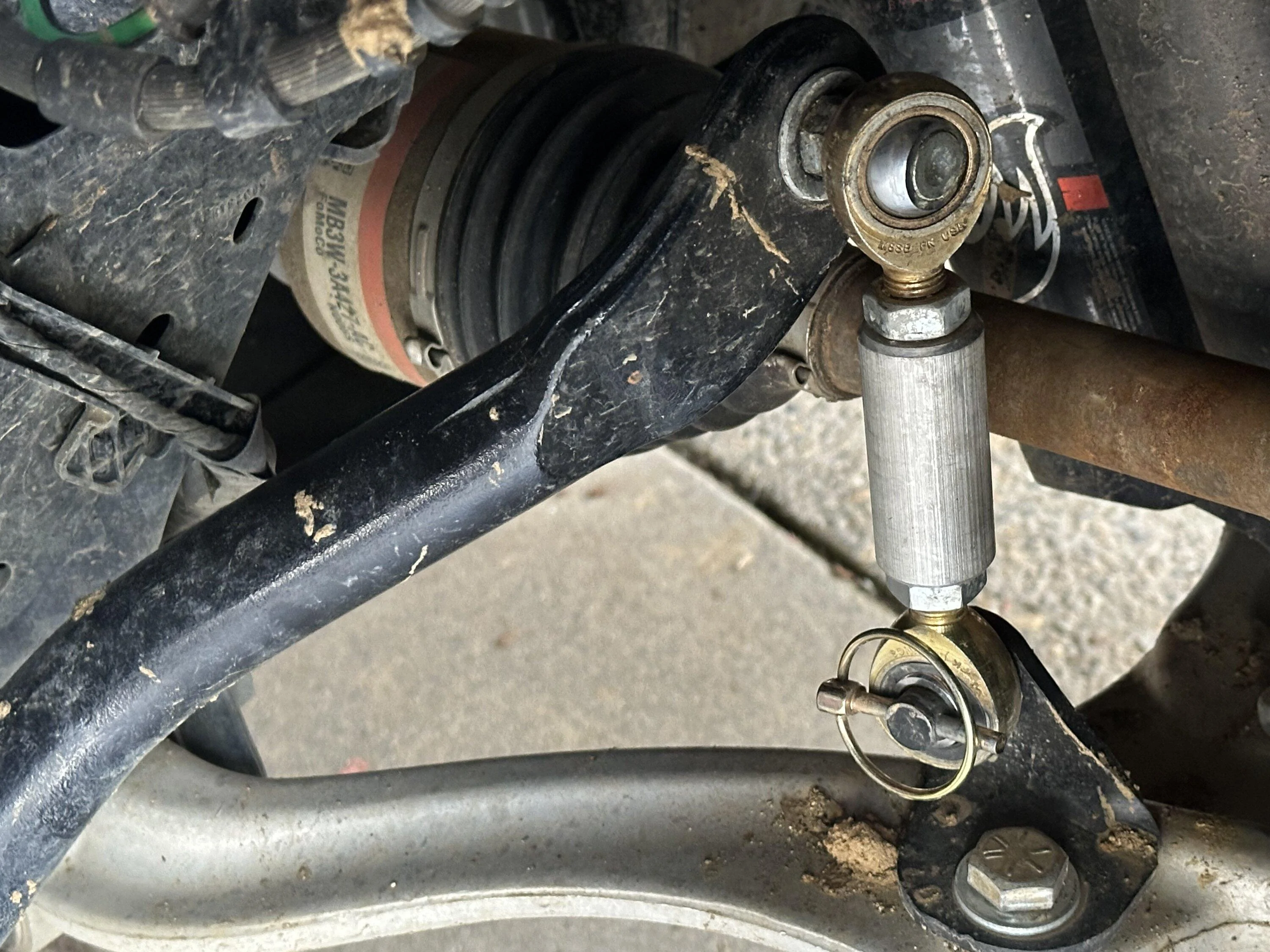

I’va had the AC fab quick disconnects on my 2023 wild track for the last six months. I have only disconnected them once several months ago and they have been super quiet until recently. They are making a lot of noise going over bumps while driving on the road. I have checked them for tightness. it appears to be the piece that is connected to the lower A Arm. Is this normal for quick disconnects to be noisy or does anyone have any suggestions?

Replace the rubber o ring on the lower mount I use one on the back side and on the front.

Mine does the same, ever so slightly. Mostly at lower speeds.
The o-ring front and back is interesting, mine would be way too tight and would take quite a big of force to get that pin back in. I've been contemplating adding in some more rubber but it would need to be thinner than the o-ring thickness to run both.

Yeah, the O-ring is in there. You can’t put one on the front and back at least with the AC fab kit, way too tight. I don’t think the O-ring is the issue it seems to be the joint.

looks like your upper Heim joint is not aligned properly, binding possibly causing premature wear on lower pin. Jim.

Yes, exactly my AC fabs have been on for six months and now all of a sudden are making tons of noise and seem to not allow proper articulation and causing premature wear on sway bar mount bushing
