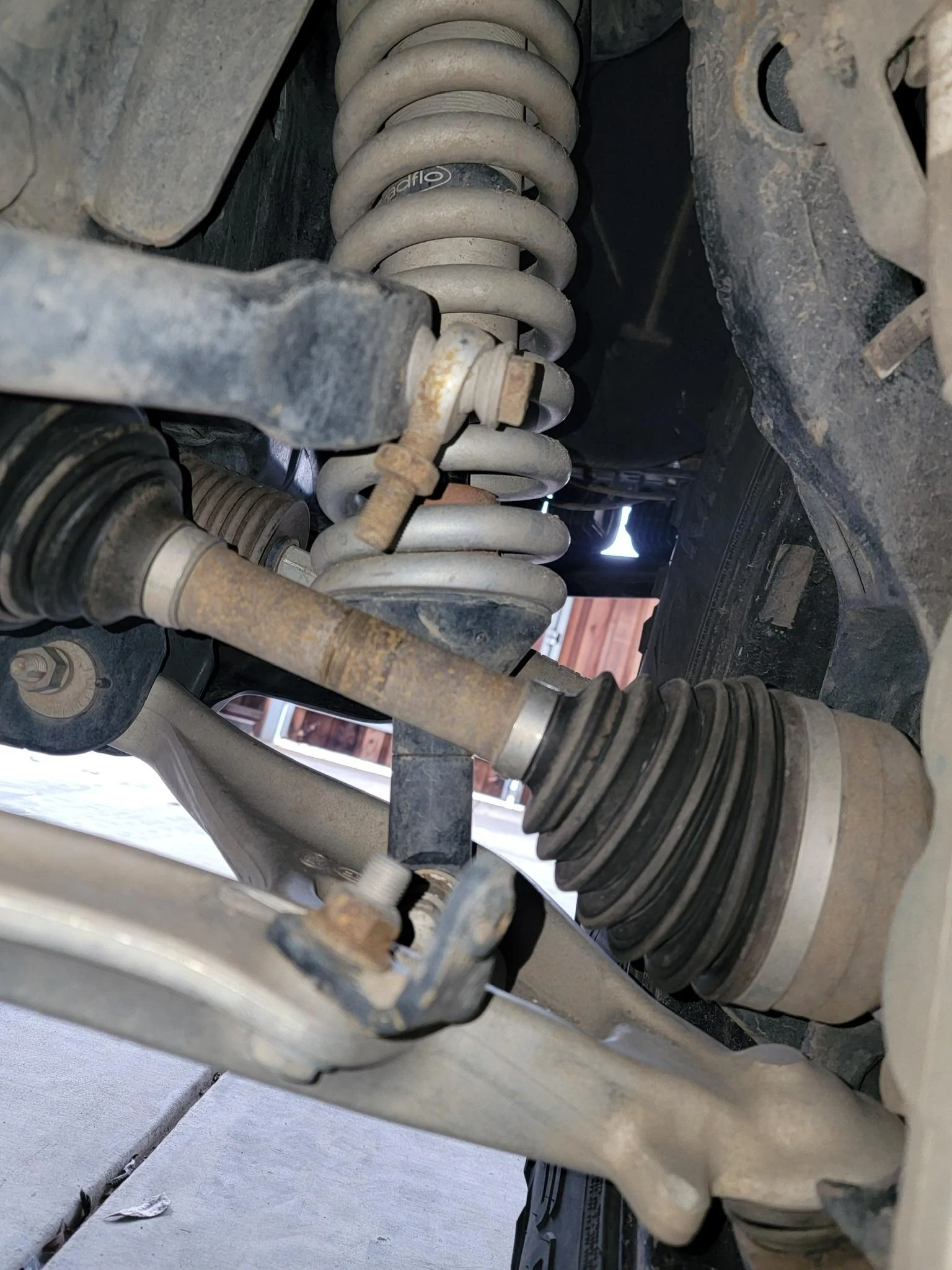

Yes, exactly my AC fabs have been on for six months and now all of a sudden are making tons of noise and seem to not allow proper articulation and causing premature wear on sway bar mount bushing
Is your lower mount welded or bolted on? He started welding them and will send you a replacement. I also just keep it lubed up with fluid film. No noises. The o-ring is a wear item.
The new weld snapped on this one. This is the owners 3rd set. From the original to the latest model. All have broke. We do run our stuff hard but my Jeep has been running the same set for a long time with no issues. The geometry just isn’t there, and difficult to disconnect and reconnect (just due to location, not design).

@popo_patty - damn! But, why are they attached while wheeling to cause the failure? It’s definitely not super convenient - but, I disconnect for any sort of technical trail and drive home with it disconnected and use a jack to realign. It’s not terribly time consuming. But, I definitely don’t wheel as hard as you guys.

Have the same issue about every 6 months. Spray with lithium grease and quiet for another 6 months.

Yeah, I sprayed them, but that didn’t seem to help the saying seem to be deteriorating pretty quick they do not stand up in the environment

quick disconnects are not louder than a standard bolted in sway bar bushing. Benefits of being easily disconnectable and having more articulation. downside of having upgrades, keep a bottle of spray silicone dry lube on you and youre good.
But the ones that are available are louder...Find me one that isn't and I'll buy it.
Its a double heim over OEM being a rubber bushing. So the heim is not a "louder" component by nature as much as its a much stronger, mechanically, component for better articulation and the ease of being able to disconnect is from the hardware being not bolted in and held in with a pin. The pin is what is going to be the culprit for most "noise" as it allows the link to slightly move, that is unavoidable in a "quick" connection process as it isnt "bolted" tight.
If youre looking for dead silence, an OEM link is the only silent option. Otherwise I use TriFlow and it keeps my heims nearly silent. Theyre not quick disconnect but I like Foutz' sway bar links and my customers running them (with proper dry lubricant) dont have noise issues.
