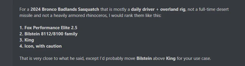

ChatGPT's response to nephew's write up:
My read: he’s mostly right, and for your Bronco as you’ve described it before, I’d land in almost the same place with one tweak.
My plain-English takeaway
For a 2024 Bronco Badlands Sasquatch that is mostly a daily driver + overland rig, not a full-time desert missile and not a heavily armored rhinoceros, I would rank them like this:
1. Fox Performance Elite 2.5
2. Bilstein 8112/8100 family
3. King
4. Icon, with caution
That is very close to what he said, except I’d probably move Bilstein above King for your use case.
