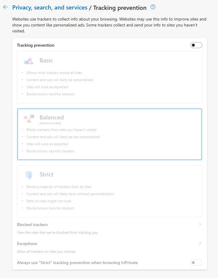

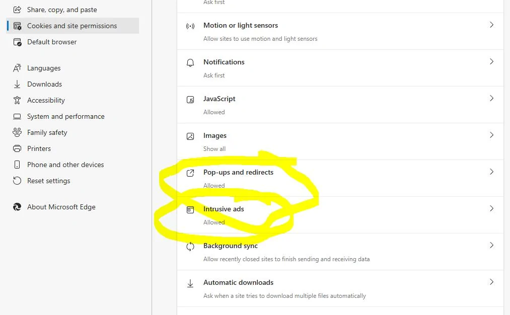

Broke down and paid for FDRS, but... of course, log in servers appear to be down. Trying @Snacktime tricks to see if it's Ford or Win11 Shenanigans
https://accountmanager.ford.com/

Servers are down
Yeah I got all the updates done and I get "No healthy upstream" ... whatever that means.
So I drug out my ancient W10 laptop and let it take 30 minutes to boot up. It doesn't even give an error - just closes the login screen before anything happens.
So I figured they must be down.
