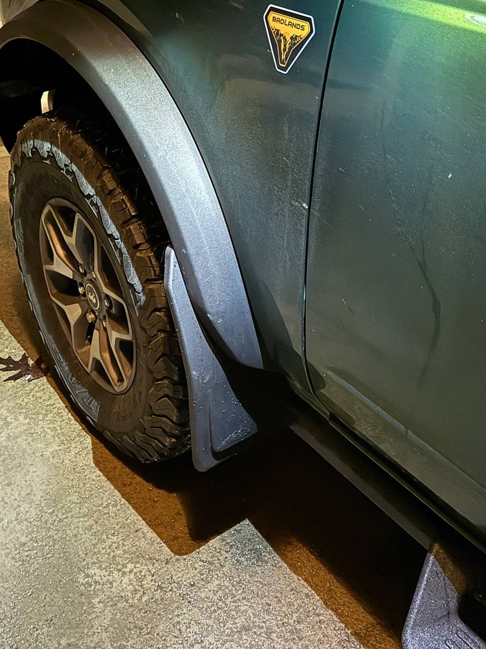

Was trying to put the IAG mud flaps on and two of my fender liner clips are stripped and I can’t get them out. Any suggestions for getting these out? Can they just be pried out if they’re entirely plastic ? Can I just cut the heads off ?

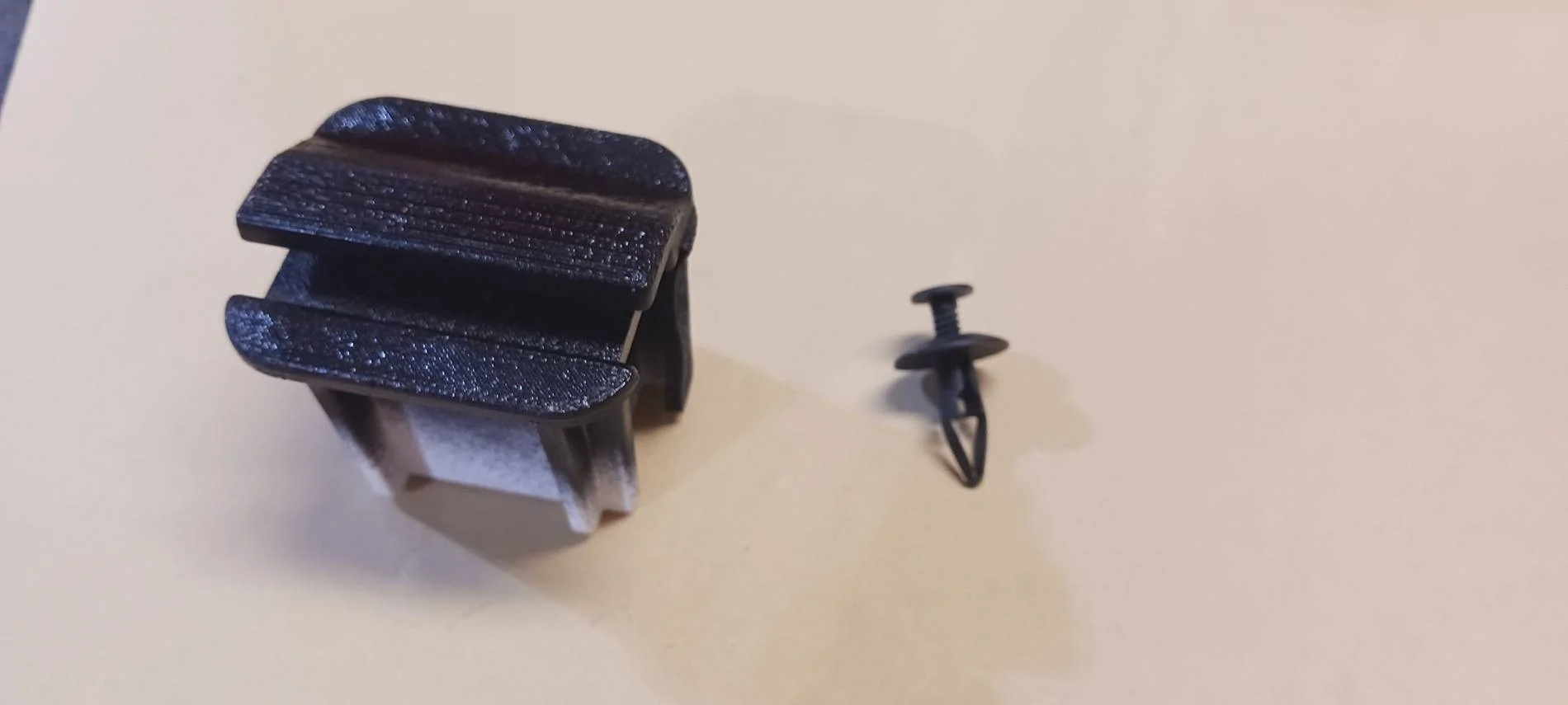

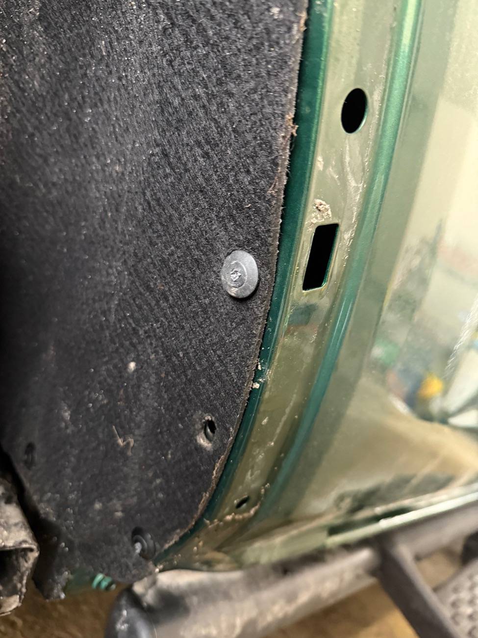

I installed the IAG mudflaps on my '22 BD. The inner fastener is the one that is a real pain. I made some 3D printed 'hooks' that slide into the crash bars (which I think I see in your picture) that eliminates the need to mess with the fender clip shown just above and to the left of your crash bar. If you have the ability to 3D print, I'd be happy to send you the file. I printed these in white because it was the material I had on hand then painted it black. The
