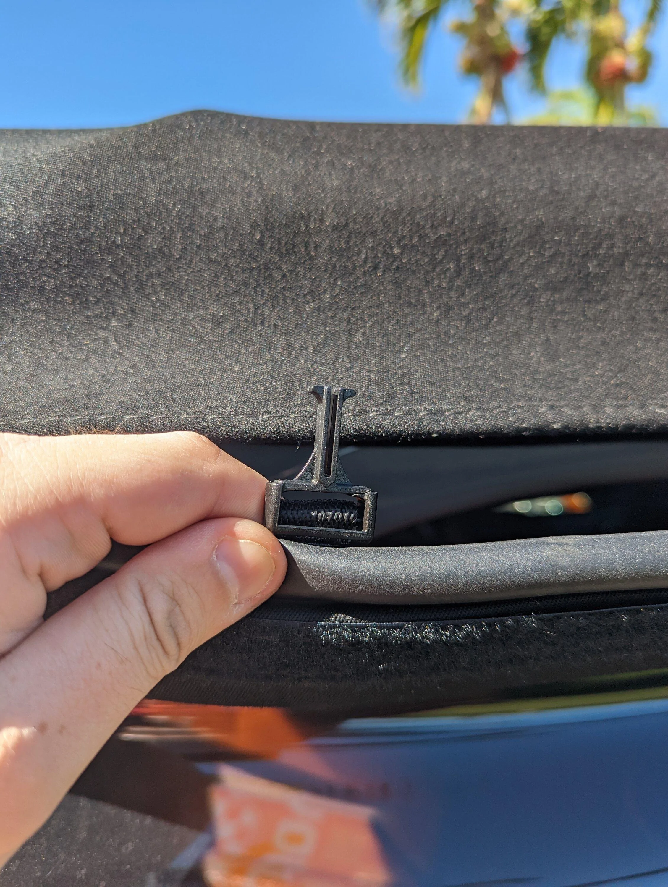

Was riding around with the top down and when I went to put it back up realized a clip on the window had broken. Can this be replaced or does a new window have to be purchased?

Wanted to update this thread now that my issue has been fixed. Took it to my local Ford dealership and it seemed as if they were going to replace the clip only. Come to find out after moving this up the ladder within Ford they ended up replacing the entire window under warranty.

How? I don't understand. Unless you had top half down and windows in?
