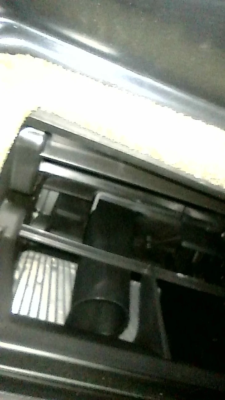

Recently bought a new endoscope and used it this morning to go hunting for the EVAP coil for the AC. I've done this procedure on many cars over the years that we've owned, works every single time with no issues. Many say the stinky AC is caused by the in-cabin air filter. I disagree, partially. Yes, you have to replace a cabin air filter every now and then, definitely plays a fact. But that nasty, stinky, "gym sock" smell is actually coming from the EVAP coil itself, which sits in a dark box that sweats condensation and does get dirty with pollen and junk. The environment is perfect for mild/mildew to form, causing the stink. I remember it happening all the way back to our 1986 Acura Legend as a teenager. Thankfully on the Bronco, it is going to be extremely easy to fix and prevent, perhaps the easiest I've ever encountered thanks to common sense engineering.
If you take a flashlight and shine it into the dash vents on either side of the dash screen, behind that screen you'll see the cutout on the bottom of the hvac tubing. The EVAP coil is sitting right there, down in there. Attached is a picture from the camera this morning. It's the aluminum tray in the photo. Mine is but a year or so old, so mine isn't bad yet, no stink.

Just shine a flashlight into either of the vents next to the infotainment screen, you'll see the opening behind the screen. On mine, it's easier to see and get to from the passenger side vent, the opening seems a little larger on that side (which is the side I used to take the picture with the scope).
