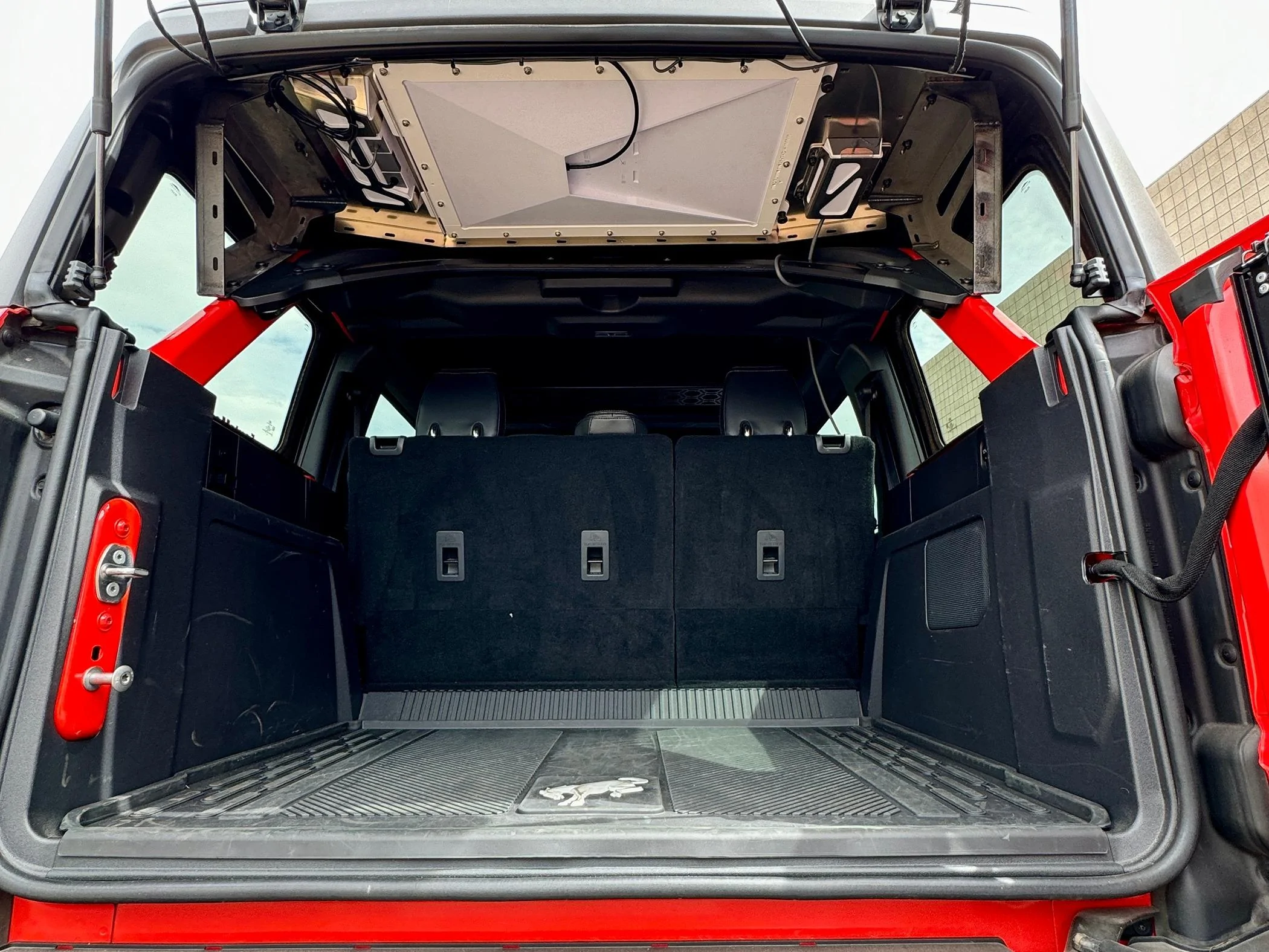

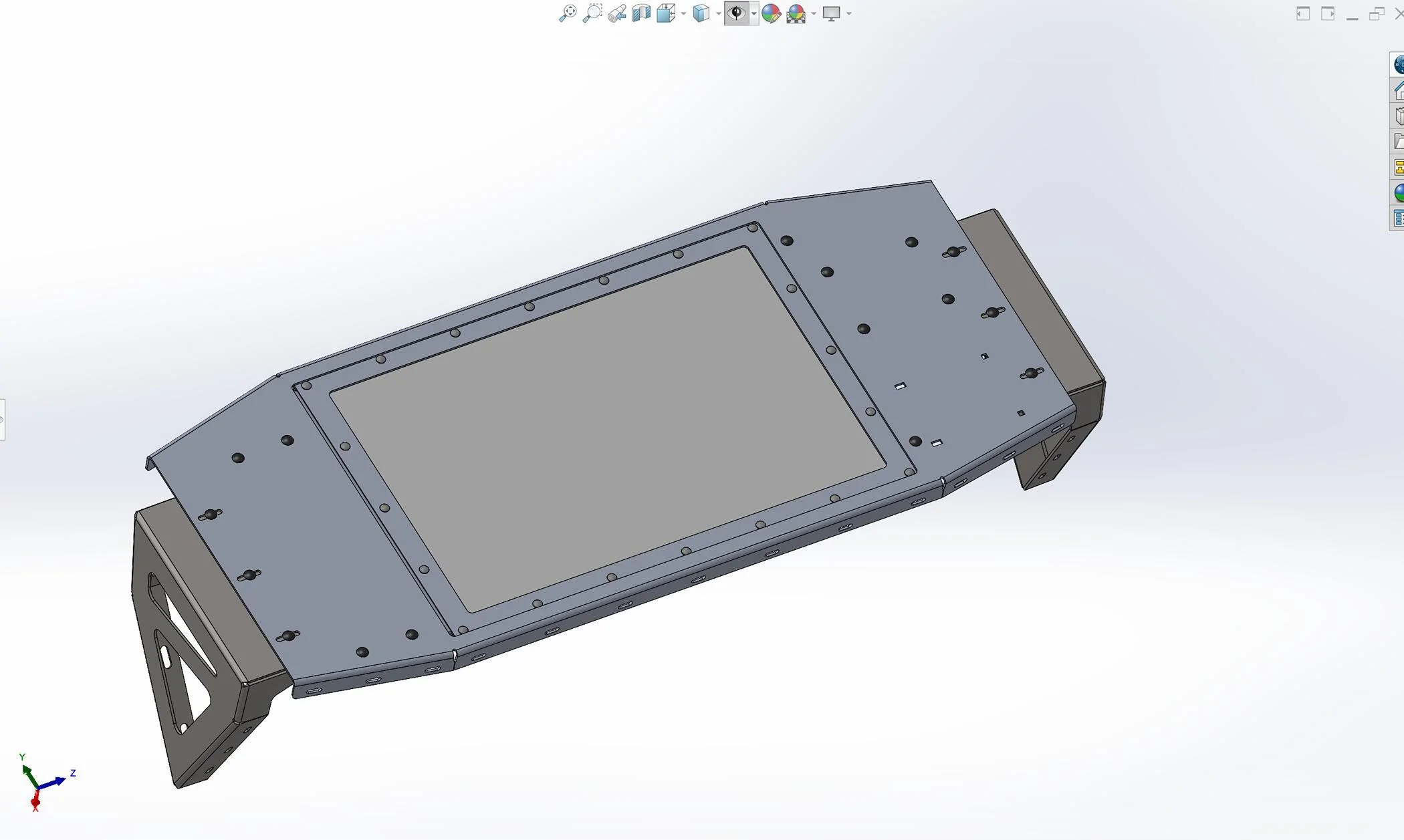

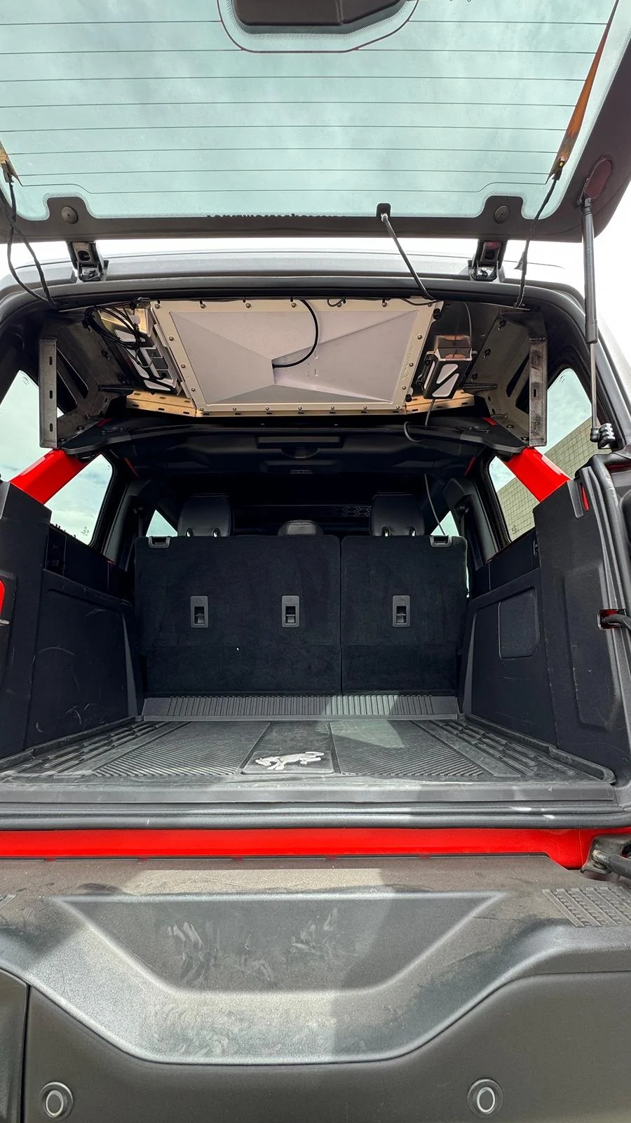

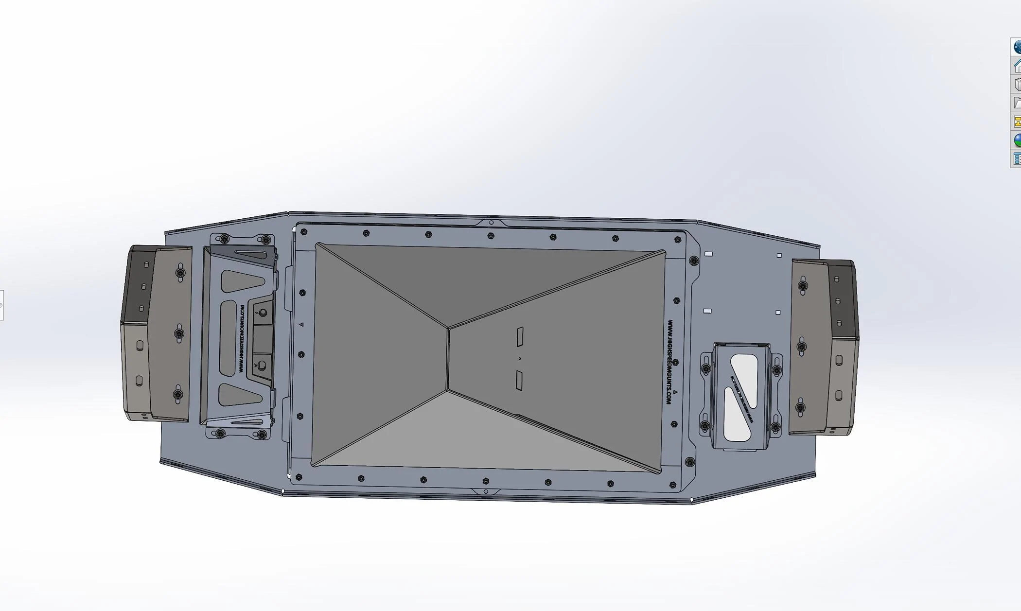

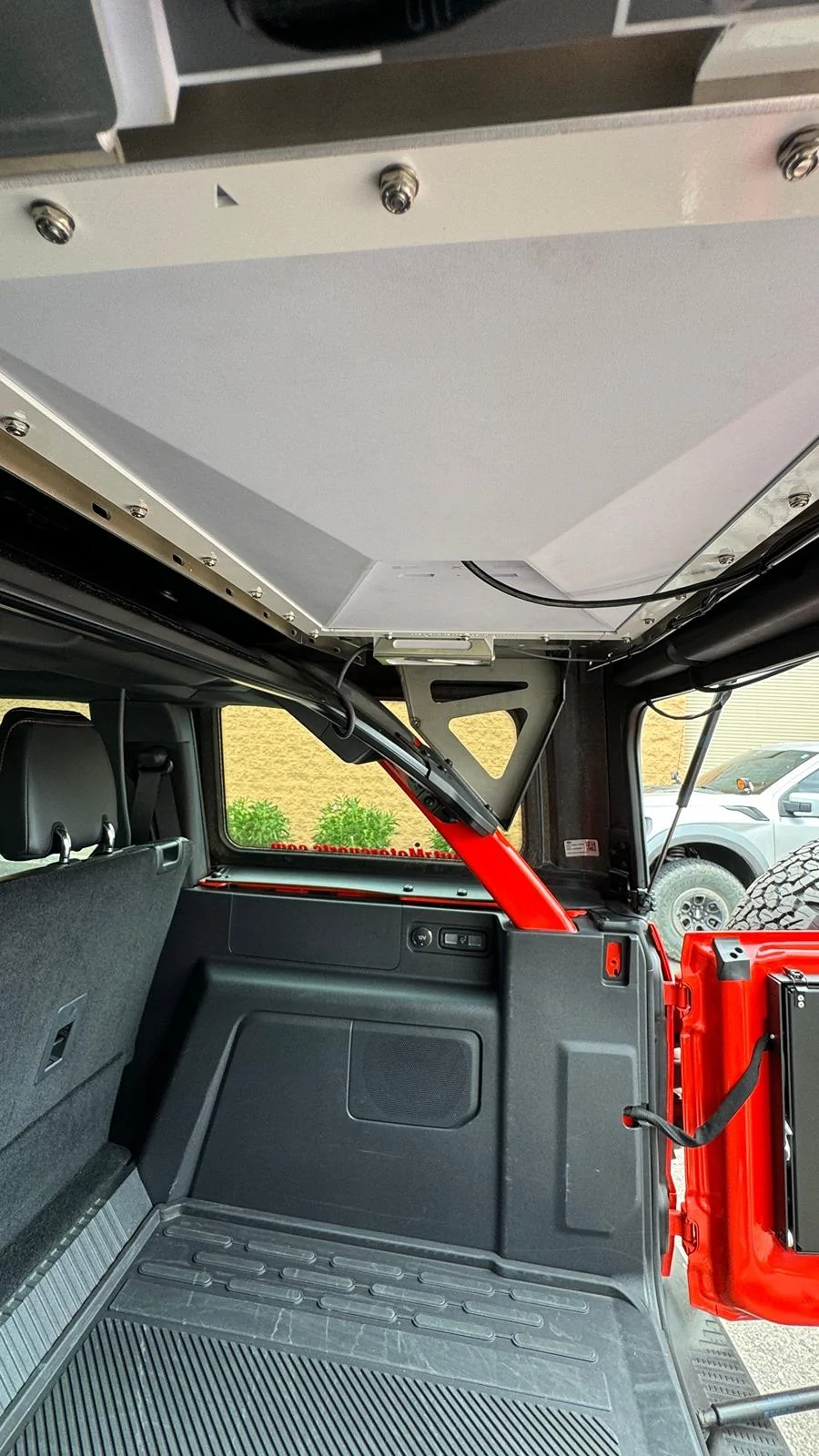

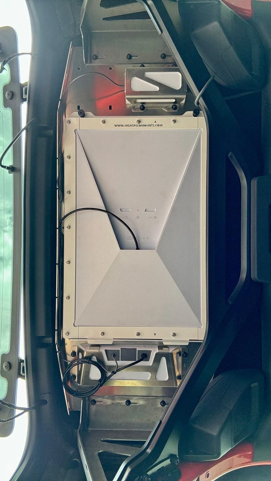

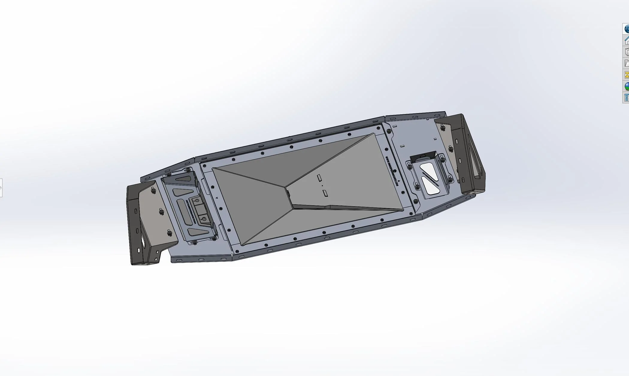

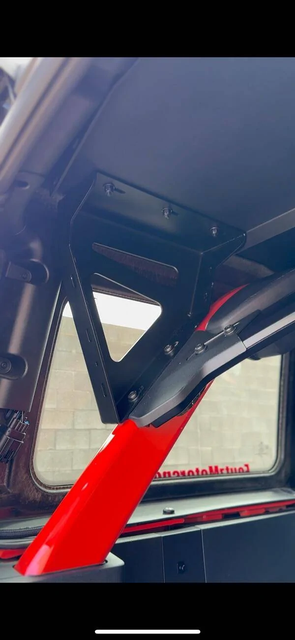

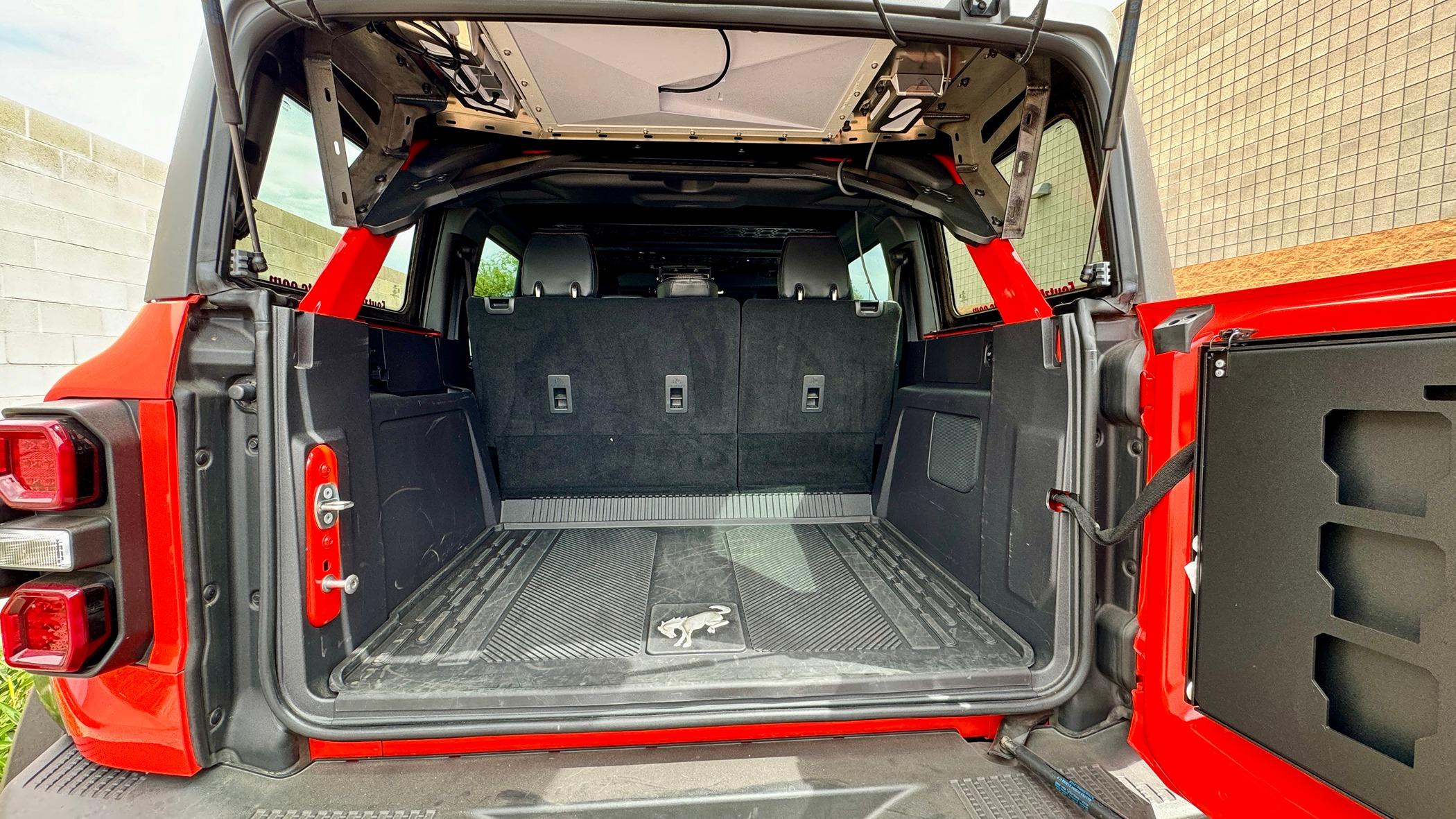

Check out this cool new Starlink mounting kit for the Bronco and Bronco Raptor. This is one that has been in the works for several months now. Been testing on the road with great success.
Mounts on the inside in the back section and bolts to the roll cage existing bolts. uses the Gen 3 Star Link system. I have been using the factory installed 110 AC inverter with the stock Star Link power supply and router and getting great connection speed. Fits right up tight to the roof. you cant even see it in the rearview mirror. You can also use a 12V power supply and plug into the 12v cigarette adapter in the back of the Bronco. Check it out. Super clean installation.
The mount has a quick release feature to remove the dish quickly and you can interchange mounts with a fixed mount you would use on a boat or RV and also a suction cup mount that you can put on the roof of a truck (maybe an F150 Raptor). Quick and easy to swap over with no tools.
Here is a little video clip of it in the Bronco Raptor.

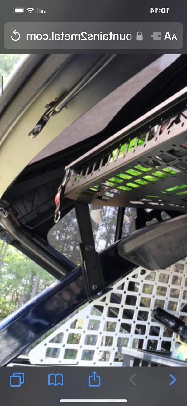

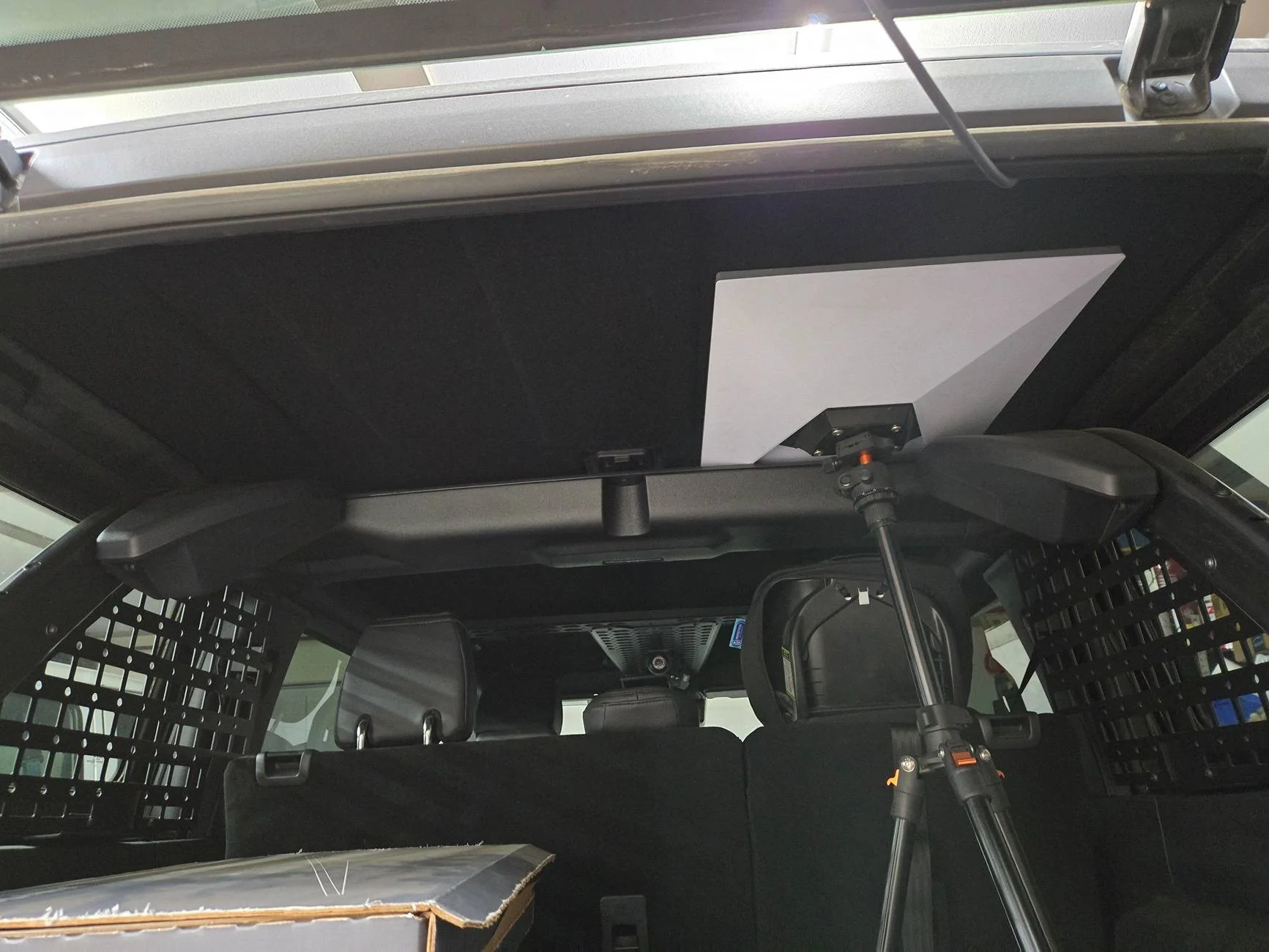

I'm thinking of this orientation instead of side to side. It is tighter to the roof this way. (The tripod is just being used to hold it up there for pic, not the way I plan to mount it.)
